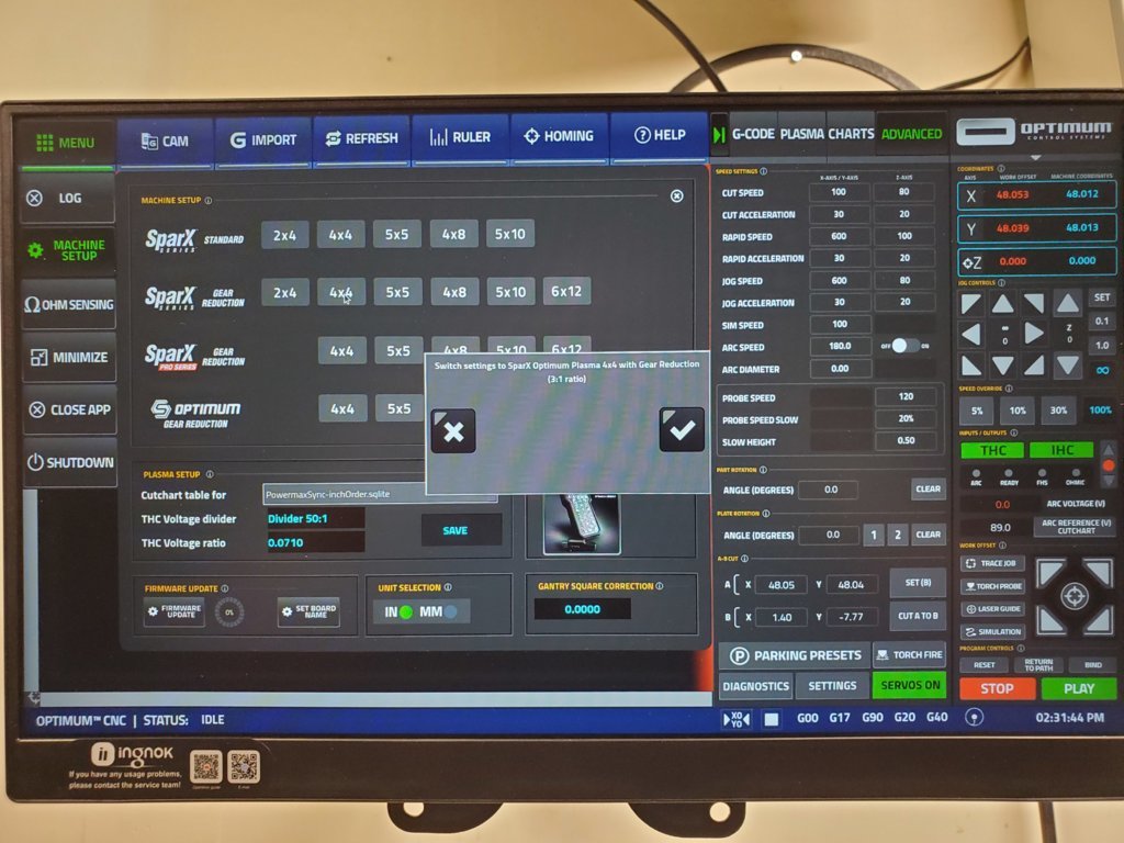

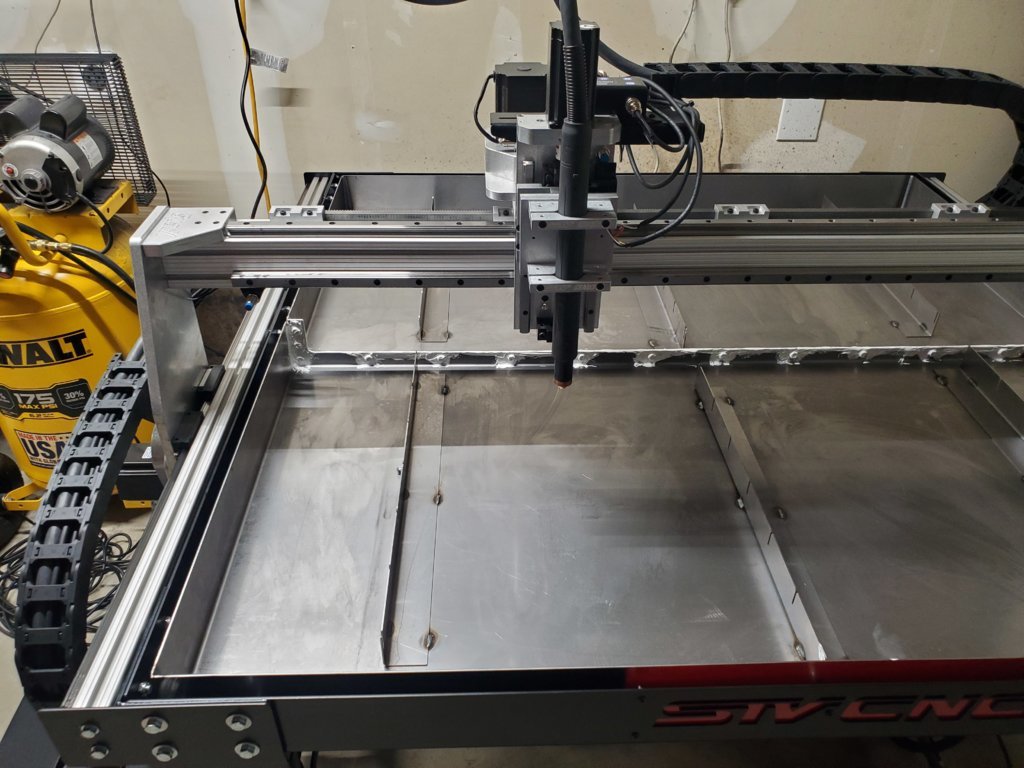

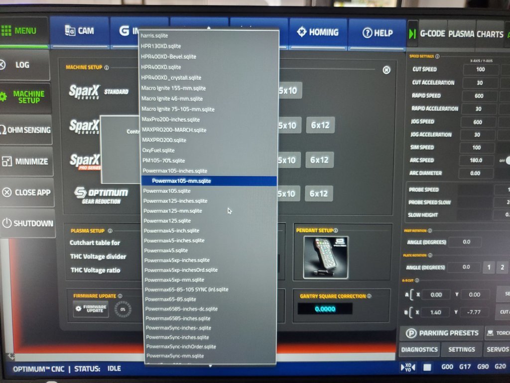

    Table is running! However, with a minor hiccup.
    As I jog the torch, it thinks it's moving for 600ipm. I have it set to 600ipm, but it's running significantly slower than 600ipm.
    Distance traveled, it believes it ran for 48" until it hits a soft limit, but has only physically traveled about 16" to 17" roughly.
    Same goes for both X or Y. This is where it sits when it thinks it traveled +48" X and +48" Y.
    There's an option in Machine Setup (on the computer) to tell the controller that I have a (specific size table) as well as the motor setup (1:1 or gear reduction 3:1). This tells me the controller and its drivers handle everything without the use of dip switches.
    If my theory is correct, the file used to flash the controller (when choosing the correct table) may be the wrong one (incorrectly named?) because the travel and speeds are the same regardless of the option I choose whether 1:1 or 3:1.
    I did try the other table options as well.
    However, Optimum is locked so I can't manually choose what to flash as the software itself does that based on your choice.
    Restarted both the controller and computer multiple times to no effect.
    I bet it's something simple I'm overlooking...

  5. May 18, 2025 at 3:02 PM
    #545
    Pyrotech
    Pyrotech Well-Known Member
    Nov 25, 2018
    #273741
    3,036
    did they send new firmware update with the 3:1 gear reduction motors?

  6. May 18, 2025 at 3:07 PM
    #546
    Kwikvette
    Kwikvette [OP] Well-Known Member Vendor
    Feb 27, 2019
    #284735
    82,741
    Fresno County
    4 run, 2 don't

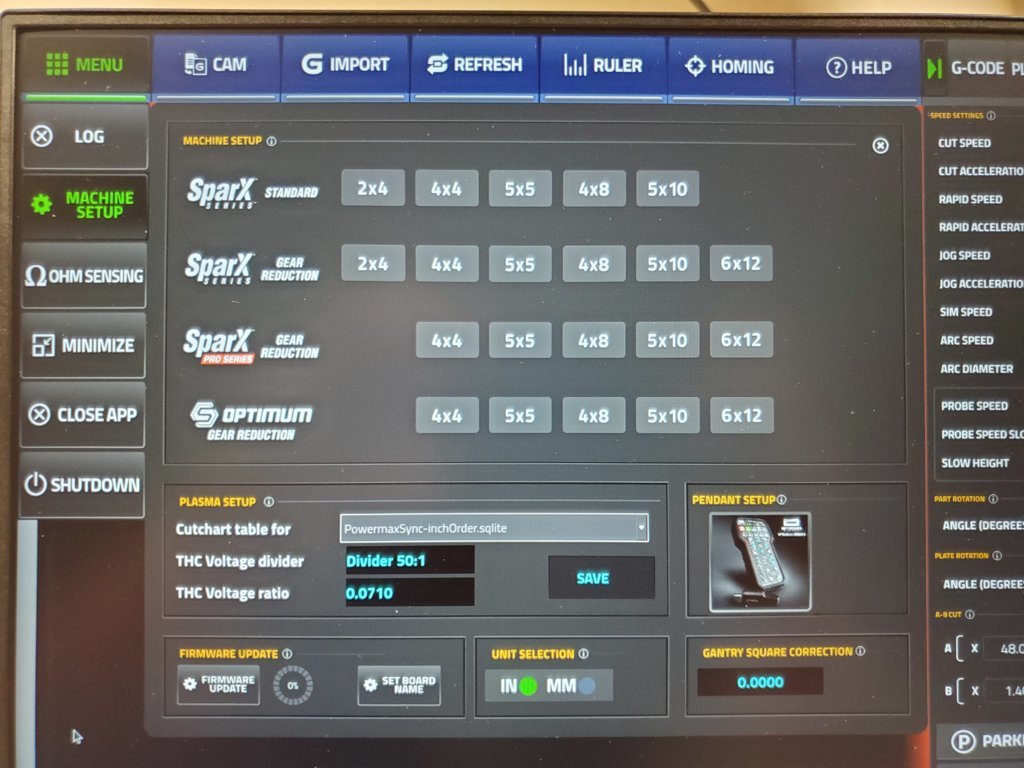

    It's all built in to the Optimum system; just got done doing a software update and I am already on the latest.
    You choose the table option you're running, and it flashes to that table configuration that you choose - options are only 1:1 (standard), gear reduction (3:1), and servo.
    You get nothing sent to you if say, you bought a gear reduction kit and installed it on your setup. You just change what you have on the computer that's connected to your controller.

  7. May 18, 2025 at 3:32 PM
    #547
    OldSchlPunk
    OldSchlPunk I'm not sick, but I'm not well
    Feb 13, 2022
    #390091
    5,873
    Rich
    East Central Wisco
    '17 AC OffRoad Silver Sky Metallic
    Small lift, slightly oversized tires, well...
    Interesting. 16" is 1/3 of 48", which says the table thinks it's got 1:1 gearing instead of 3:1.
    Drainbung and Kwikvette[OP] like this.
  8. May 18, 2025 at 3:37 PM
    #548
    Kwikvette
    Feb 27, 2019
    #284735
    82,741
    Fresno County
    4 run, 2 don't

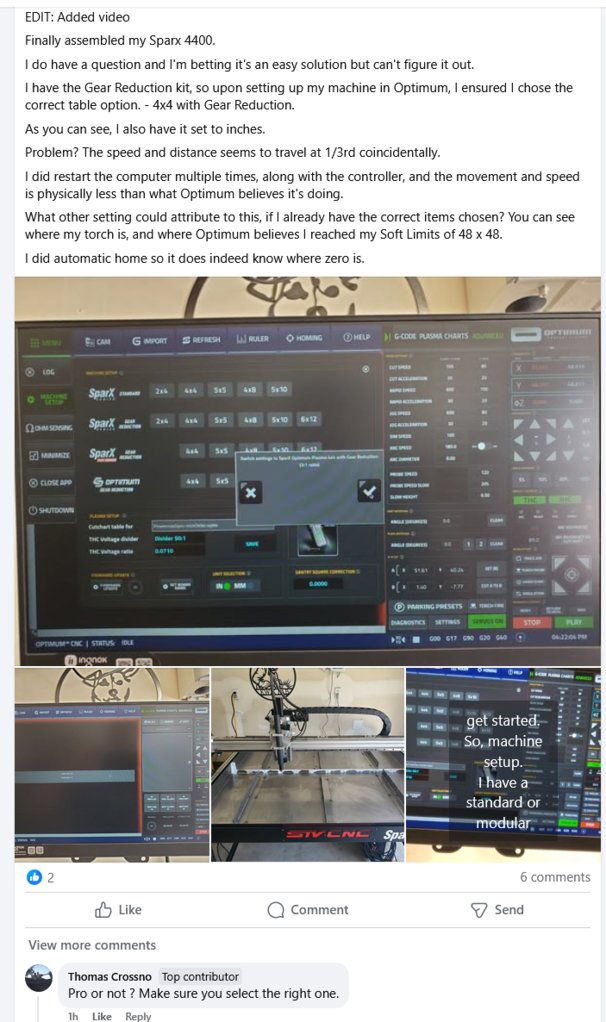

    Yep!
    Exactly why I posted on the STV group that it "coincidentally" moves about 16".
    I provided this information thinking it'd be a light bulb for someone, but the only response I got so far was to "choose the correct table" in Optimum. I stated I had done so in my initial post but, you know...people sometimes don't believe what you say I guess.

  9. May 18, 2025 at 3:56 PM
    #549
    Kwikvette
    Feb 27, 2019
    #284735
    82,741
    Fresno County
    4 run, 2 don't

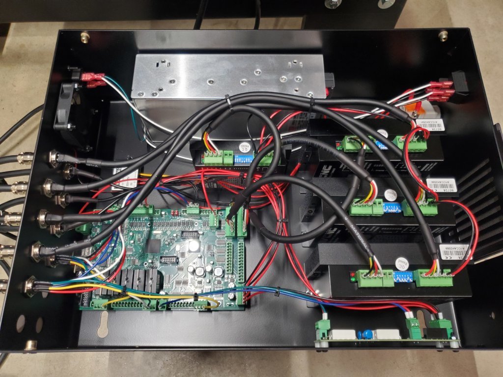

    @Pyrotech
    I stand corrected on my own statement.
    No one responded, but I opened up the control box myself and I do indeed see dip switches!
    So it seems what I read (in old posts when I searched) is just for the software side but people worded things in a manner as if it applied to the physical movement as well.
    I'll call STV tomorrow to see what the proper positioning for these is.
    I'm betting that's what it is considering my table arrived with a 1:1 drive setup, but the 3:1 gear reduction kit was given to me after the fact.

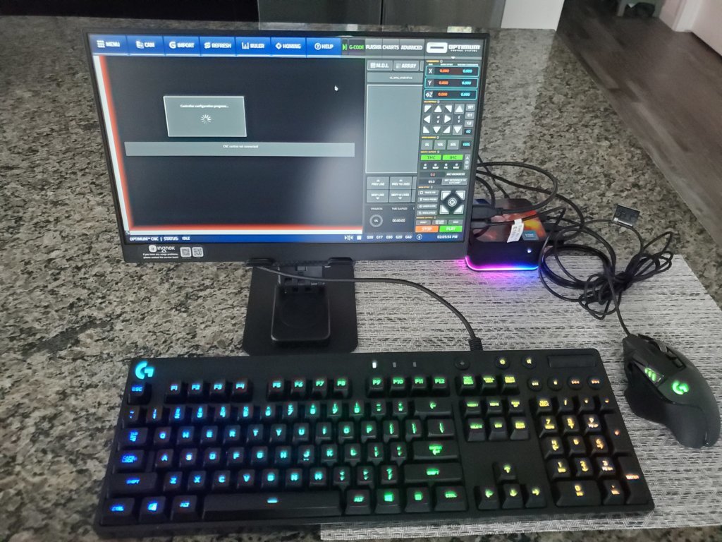

  17. May 19, 2025 at 7:10 PM
    #557
    Kwikvette
    Feb 27, 2019
    #284735
    82,741
    Fresno County
    4 run, 2 don't
    Fucking aye :rofl:
    Stand arrived for my controller, so I got to putting it together and of all fucking things :annoyed:
    Dude in Malaysia just had to put in 4 coarse, 2" long bolts and 4 coarse 3" long bolts.
    The bolt in the middle? A random ass bolt that threw me for a loop. I carry tons of hardware but mostly all metric so I said screw it and skipped using it.
    Everything is fully wired up and tucked away!
    Keyboard arrived too, but I've got another monitor coming in to replace the small one I recently purchased. Decided it's too small to work on.
    But here's the layout and how it'll sit!
    Super stoked. Now to wait for everything to cure.
