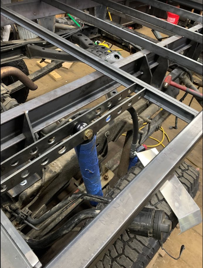

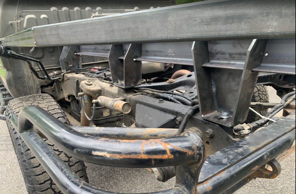

    Why did I not get this table sooner? The only issue I have had were tipups so far. What kind of consumable life can I expect? Still cutting fine at 1/2 hr cut time, I forget the pierce count. I'll check tonight. IPT 60 hand torch cutting mostly thicker stuff(3/16-1/4)
    Building a flatbed for my truck and these mounts took a half hour to design and cut out....
    If Interested you can see more here.
    https://www.tacomaworld.com/threads/flatbed-information-thread.558179/page-26
    Shock mounts? 5 minutes....

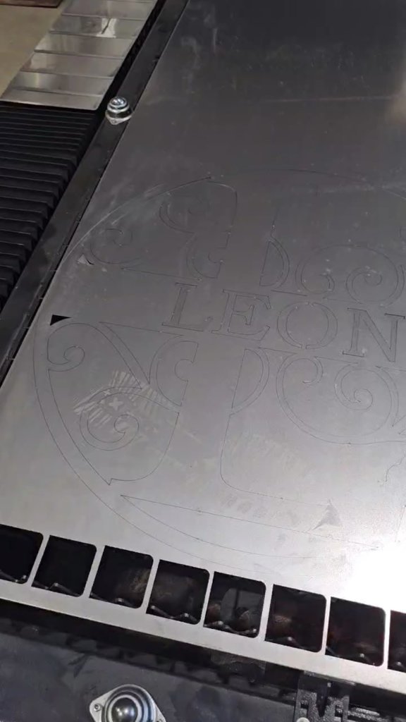

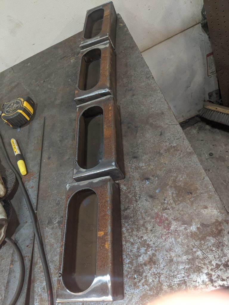

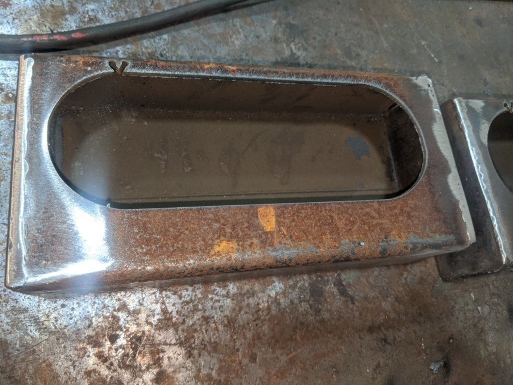

    Reserected from the dead.
    Cut me some tail light boxes.
    Guess who forgot to change his lead in?

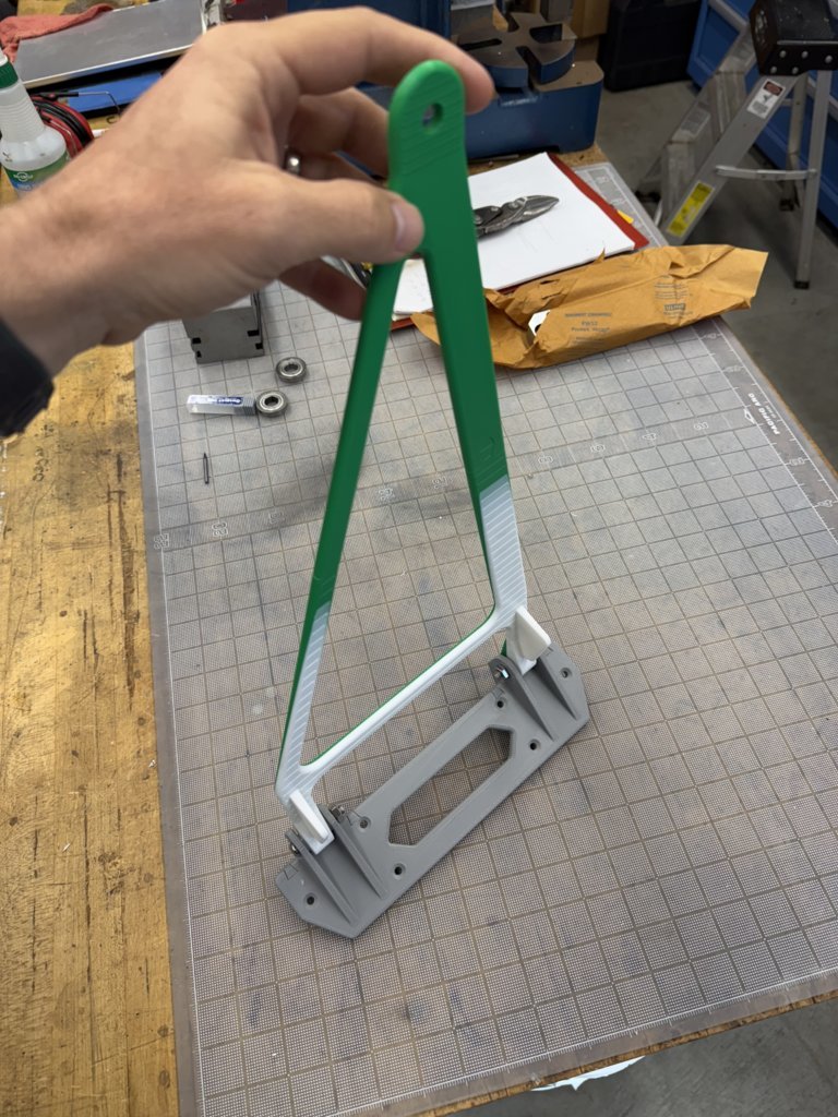

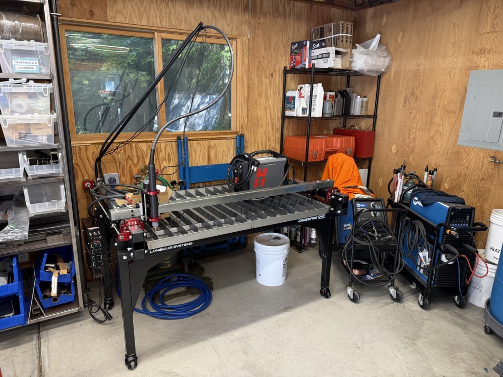

    That is so fun. Some day I will join in the joy. My wife is on sabbatical and so we're going to Maine next week until fall. Between that, HS robotics and that boat... damn - I miss my shop! I did get in there and clean up a bit after the chaos of the last weekend before our last robotics tournament (I think I machined 70 parts in 7 days). 3D printed some patterns for some boat parts I'm going to try to cast in Maine... Made room to move the table where I think it's gonna live. But now I'm headed out!

    The casters though :annoyed:

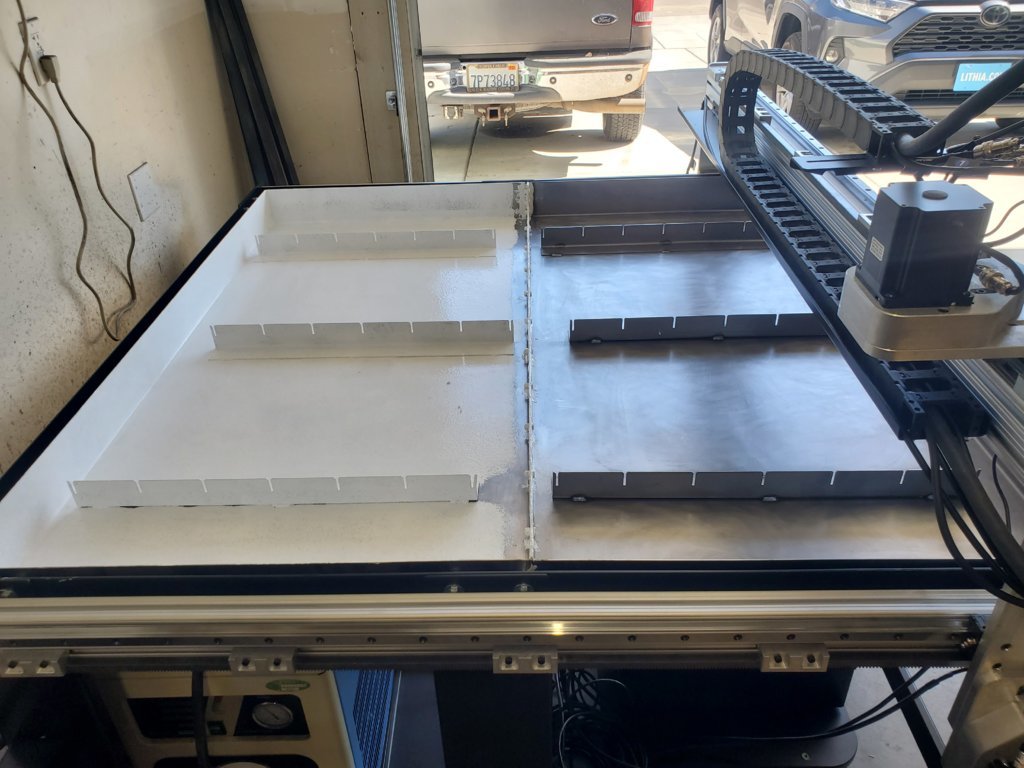

    Scuffed up the water pan as best as I could so I can flex seal it tomorrow.
    Plan to do a thin coat really as it's more to keep from letting the surface rust and less about leaking.
    On the plus side, I have a whole 53" of travel on the X axis. On the Y I'm keeping it at 48" so I don't have to worry about my sprinkler system power cable.

    Can't live without 'em! I'd have put my mill and lathe on casters if it wouldn't mess everything up.

    Big fan of casters myself, but just keep an eye out if you ever decide to move it.
    Tons of those tables go out of square when moved even the slightest on casters.
    Lots of new threads with "my Y axis is binding" :bananadead:

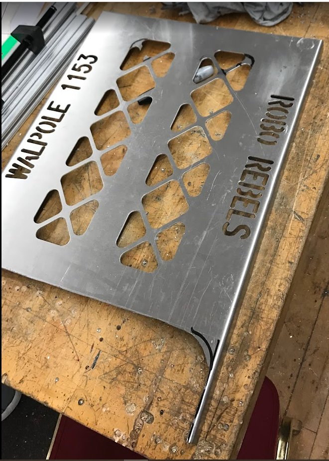

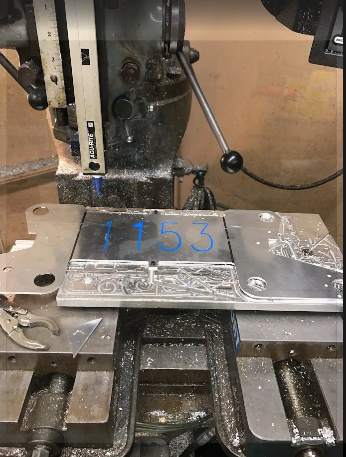

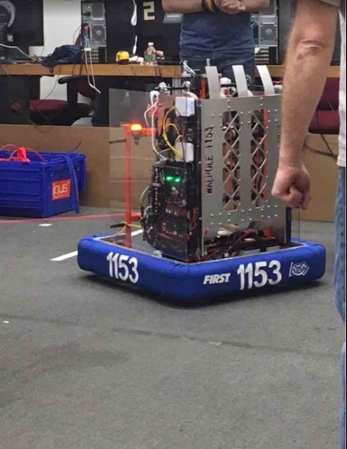

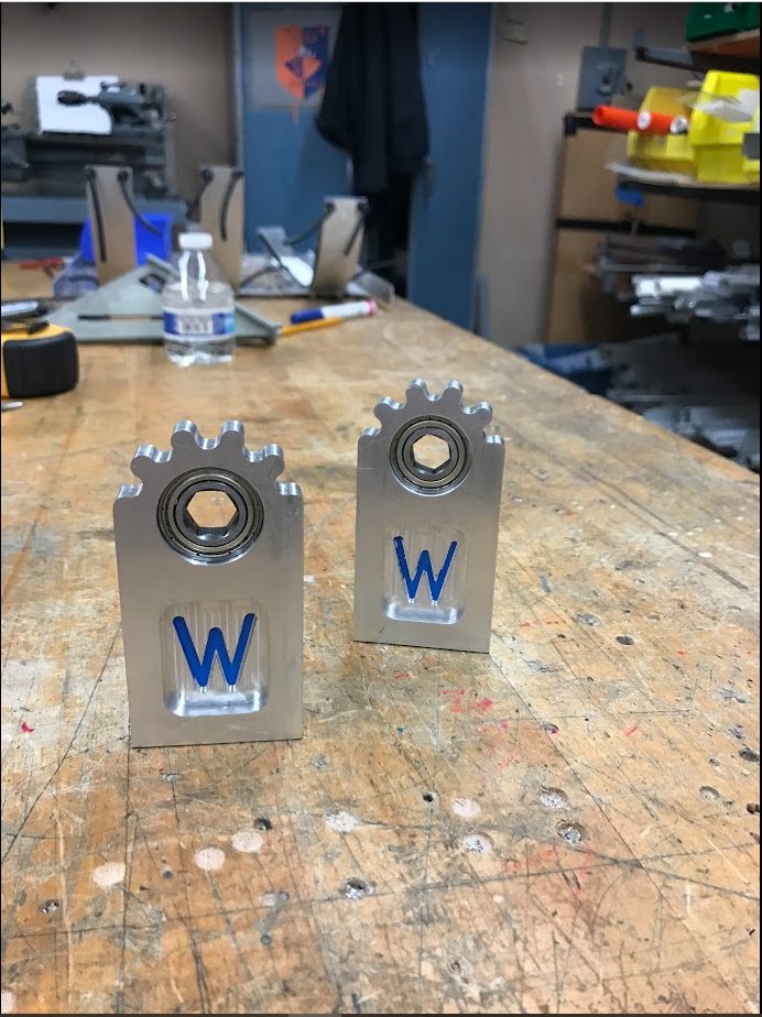

    Yeah I was on 1153 and made a whole mess of parts. All on a bridgeport with a prototrak.
    This was 2017, I was 17-18. It was pretty funny cause I'd go straight from lacrosse games straight into the shop. Cup still on

    Good to know! Out of square x/y? (like... parallogramming?) or just not level?
