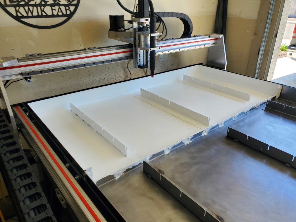

    Added racing stripes to my CNC table :laughing:
    (Need a small strip for the right side)
    No but the real update being that the flex seal was really dry already so I laid on a second coat.
    Tomorrow my second can of flex seal arrives so I can run the first coat on the second pan.

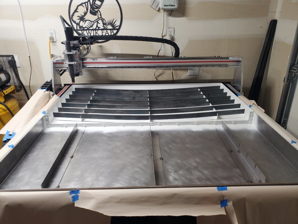

    Well, Flex Seal delayed for a day. It's ok cause it's for the second pan anyway.
    Used the aerosol can I had also purchased and I hit all the small areas between the bolts as well as the corners.
    Slats are installed and the second half of the table is ready to start getting Flex Seal tomorrow.
    This means by Sunday I should be applying a second coat and maybe cutting by Tuesday :angrygirl:

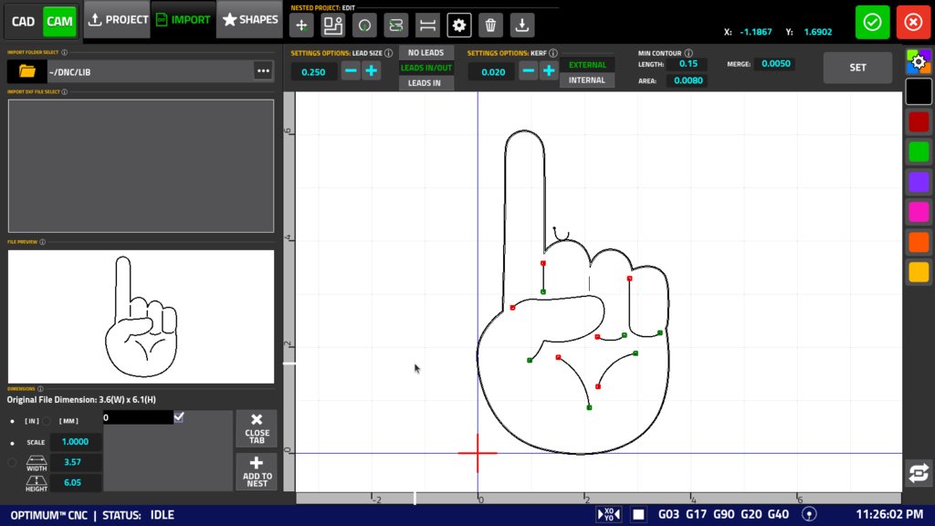

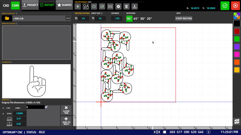

    This will be a slightly lengthy post so bare with me.
    Those of you who have gotten to know me, talk to me offline, know that normally rely on my nights for leaning when it comes to software - it's when the family is asleep and I can really get to messing with things without interruption.
    Since I can't run my table, I thought I would play a bit with the Optimum software as I've toyed with it a bit over the last few days and share some of the functions I think are really neat.
    For starters, Optimum has it's own CAD, CAM, and controller built-in to its software. Now I haven't touched on the CAD side, and most likely never will, but since I want to steer clear of purchasing and learning Sheetcam, I thought I would give Optimum's CAM a try.
    Just like any other CAM software, you need to load up your image file which I've done so right here. In this particular case, I already clicked the "ADD TO NEST" there shown at the bottom but normally you would have a blank sheet on the right side of your screen.

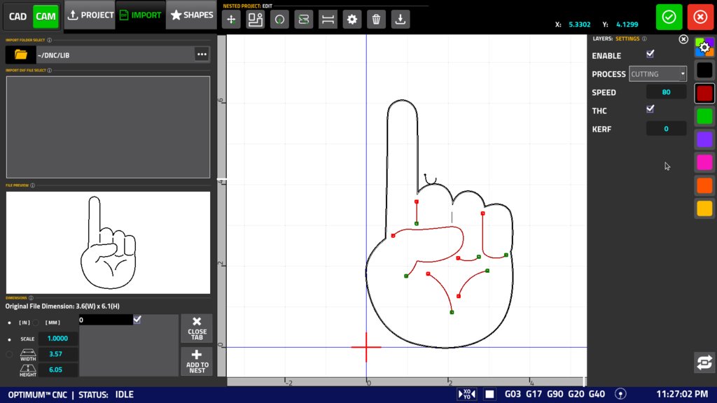

    What I found most interesting is that, Optimum instantly generates cut paths for you just the same way Sheetcam does when you load an image. I did not have to manually remove any lead ins/outs on my open loops, or set my lead in on the correct side of a cutout as it recognized the hand as being an outside cut. All of the guesswork was instantly done for me.
    Now, if you're like me and you specifically work on parts, then you know cutting certain geometries at different speeds (in thick material) is important so that's where the right side of the screen comes into play.
    By creating what is called a "layer" and choosing lines/contours you wish to change color, you can create independent settings for both kerf and cut speed.
    I cannot see why anyone would need so many layers as the most number of speeds I could think of in a realistic scenario is maybe 3 - one for an outside cut, one for a hole, and one for an even smaller hole. I find that if a hole is about .25" that I need to cut it an extra 5-7ipm slower than say a hole at .45" to achieve an accurate dimension.
    Well, I would venture to guess that maybe the reason for the many layers is in the event that you have nested a ton of different items all together.

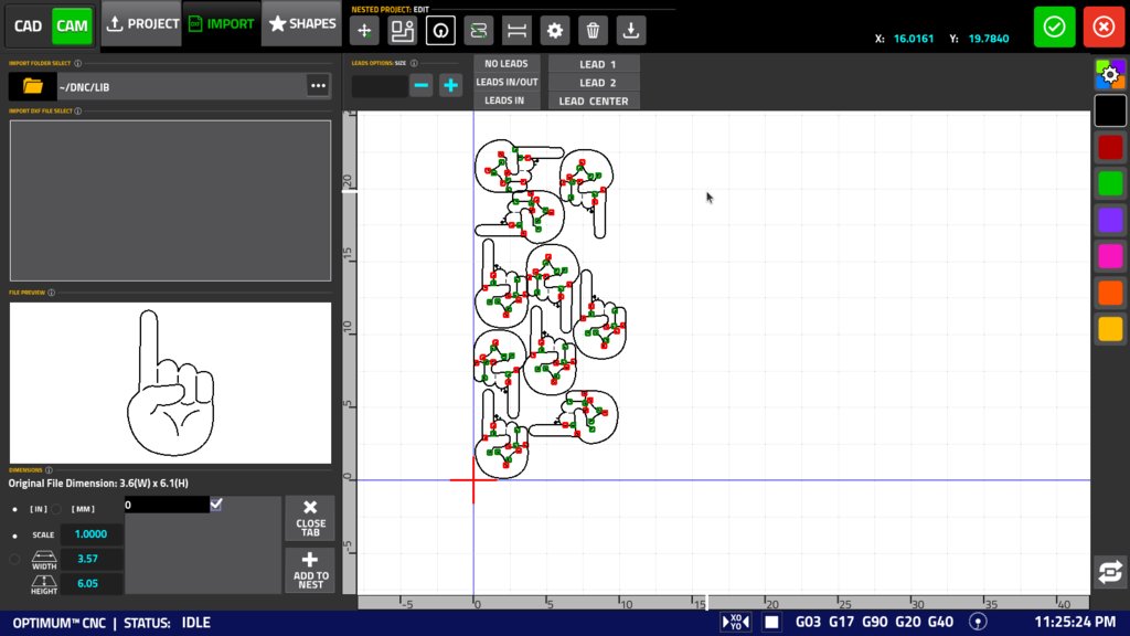

    You can import multiple image files into your "work area", create the size of your material, and simply let the software nest everything together like so.
    As you'll notice up top, I can determine the size of the sheet I'm working with as well as the distance between parts and the angle of rotations. The angle of rotations is important because too severe of an angle means contours that require many X-Y transitions, one major strength in having either servos or gear reduction kit like I do.
    Whether you're working on a nested setup, or an individual item, you have additional options where you can set your lead in and out points if different than what was automatically set.

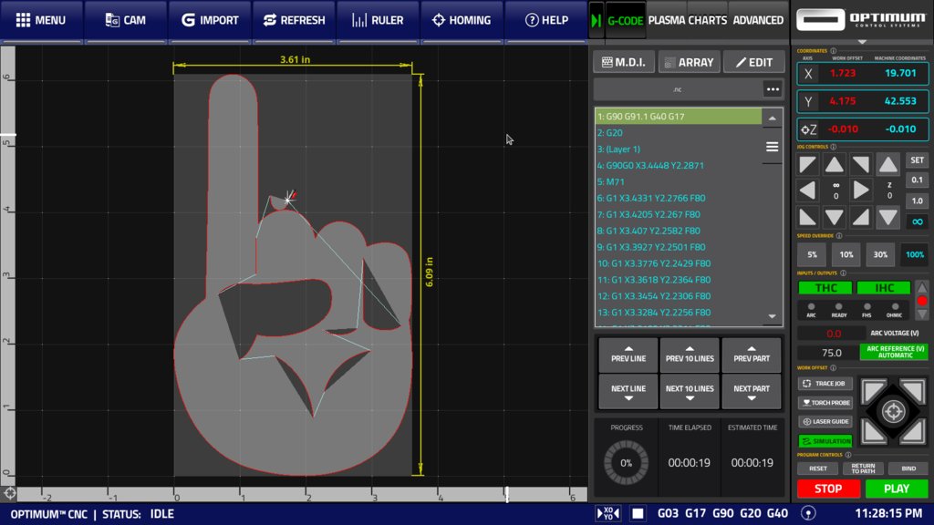

    After which, you can actually determine the sequence of the parts being cut. Noticing here you'll see that the software sides with performing one complete cutout before moving onto the next. I think this is smart as it can prevent large tip ups from occurring.
    And of course the important detail here, your actual lead in and out distances as well as placing them in or out of an object. Another thing I also noticed is that you can just as easily grab a lead in/arc and simply move and drag it elsewhere while also making it bigger or smaller with a scroll wheel. They make it super easy to adjust on the fly.
    Anyway, once that's done you just hit the green check mark up top and your g-code is created and loaded right into the controller part of the software. At any time you can simply click CAM and it'll go back to your project you're working on without having to start all over again.
    I confirmed this as I toyed with nesting, then back to one part just as quickly.

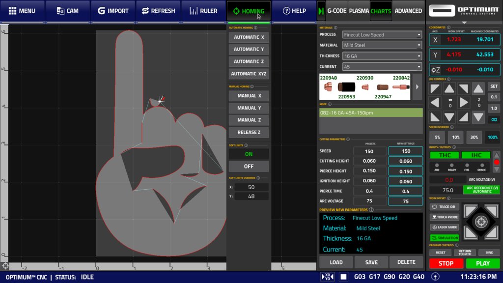

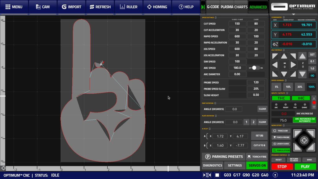

    Couple of misc items here, just two options over from G-Code you have Charts. Optimum, as I showed the other day, has a huge library of cut charts from lots of different machines from different manufacturers. You can see it has not only my speeds, but also the correct cut and pierce heights as well as pierce delay and voltage. If I wanted to order more consumables, the screen shows me right there what set to buy as it lists part numbers.
    Moving one more over to the Advanced tab you'll see the many other settings you can change which effect both cutting and jogging.
    If you noticed at the bottom, you will see Parking Presets. This is actually something I had asked Langmuir about a long time ago and they never incorporated it into their software. Well, Optimum has user-adjustable presets for up to 10 parking locations where you can click on and make your torch go at any time. But the best part is that you can actually set it where your torch will always go to the park preset after it cuts your design out.
