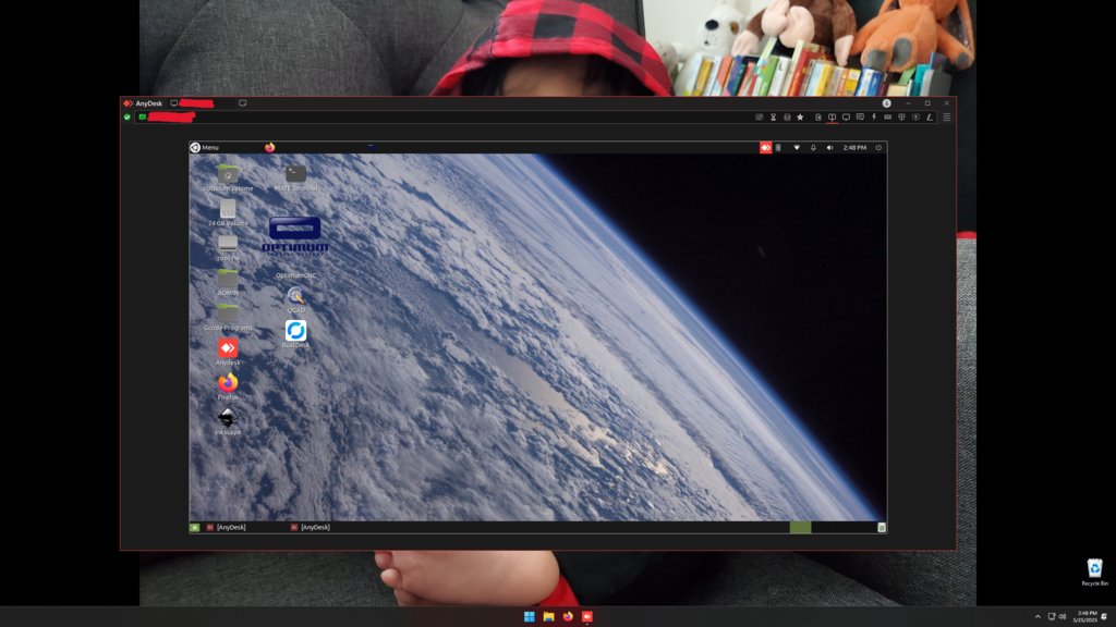

    So, something I've been accustomed to doing when it comes to CNC plasma cutting is by doing all my drawing and CAM work inside the house on my gaming PC.
    I do this on Fusion, drawing up any and all parts and/or designs followed by opening up my tool library and getting my cut paths set correctly. Well, now with Optimum being my CAM software I'm having to do that stuff in the garage which isn't really all that big of a deal.
    Well, Anydesk is already fully setup on the mini PC with an account (this is in the event that the end user needs remote help from STV) so I thought I'd try it out and yep, I've got full access to my pc and CNC table from my bedroom!
    These guys really thought of everything, and since I can just save my DXF onto my cloud, I can access them between computers without ever having to get up and transfer media physically.

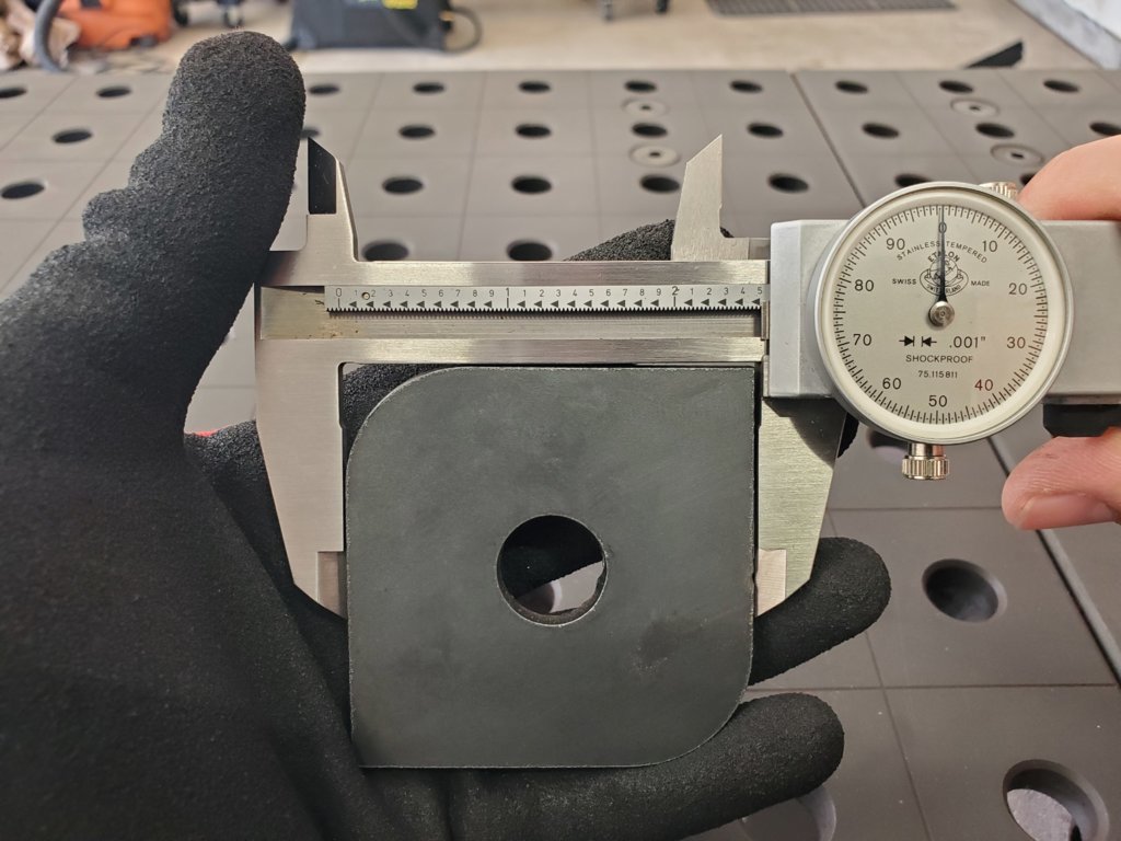

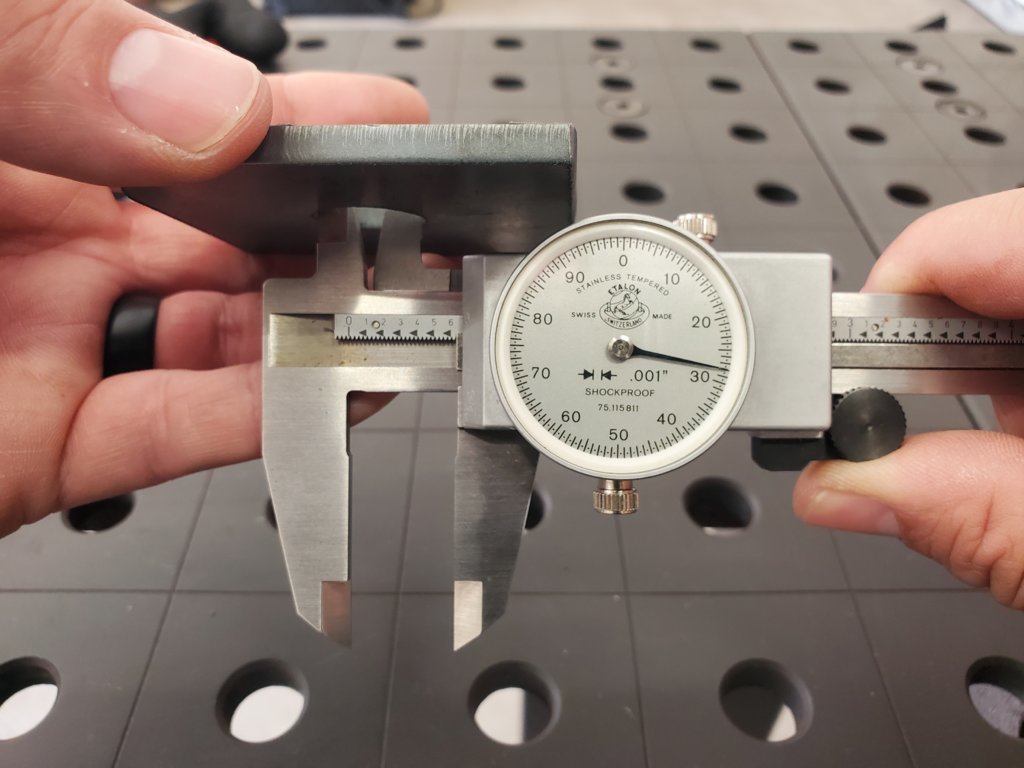

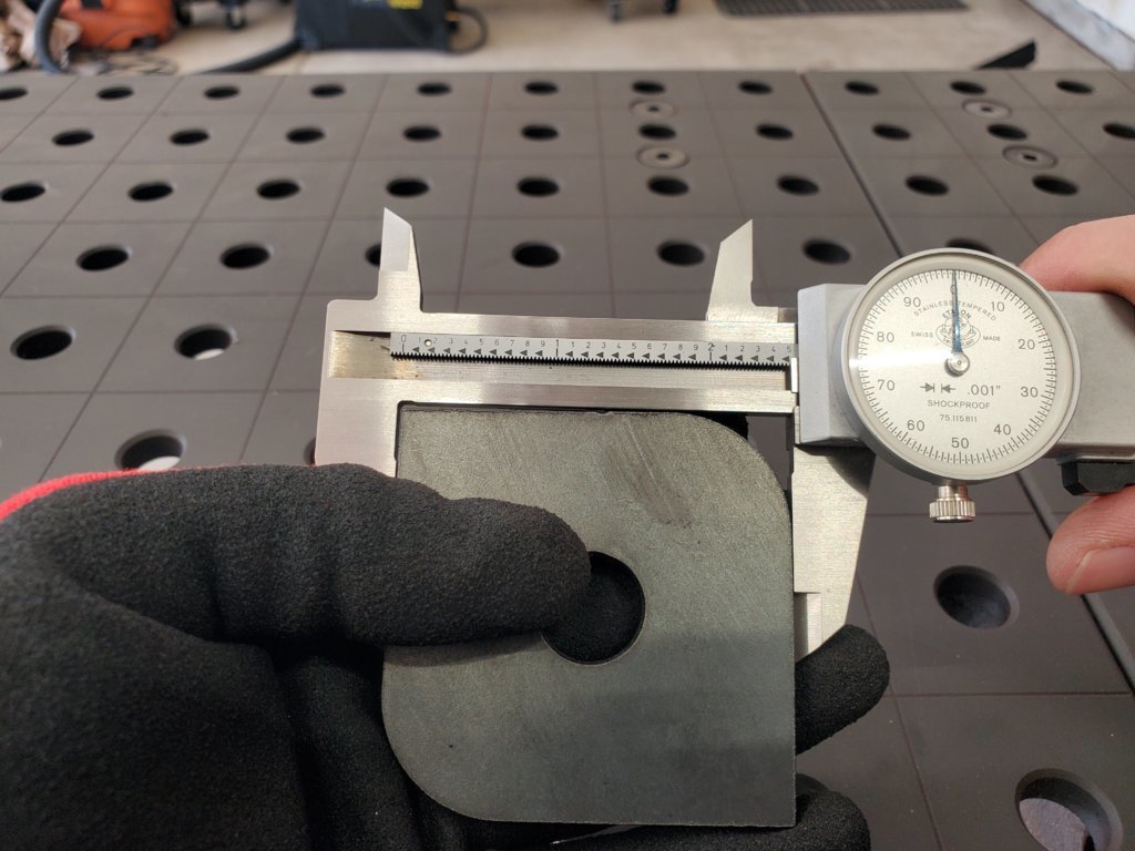

    Just got off the phone with STV - I called because I had a few technical questions for them which I'll share.
    During the CAM process in Optimum, I mentioned a feature called 'Layers' where you can basically color a cut path a different layer, and apply its own individual cut speed and kerf value.
    My question was, if I left the kerf value at 0.0 (since the box for kerf, THC, and speed exist in each layer) if it would default to the global kerf value used in my CAM process or if it will override it and actually use the 0 value. I was told that yes, if I left it at 0.0 it will indeed run the cut path as having no kerf. He said this is because sometimes cutting much slower (or larger) of a speed with the correct kerf width can still lead to a correct outer dimension, but incorrect inner dimension and vice versa so it allows the end user to really dial in their setup for the most accurate parts.
    Pretty cool actually because normally you just have one kerf value, and cut paths are offset (whether it's an inside cut or out) to compensate for that kerf. However, anyone that has cut anything will tell you that sometimes one item is a hair more off than others such as my test cut out below.
    Achieving a 2.5" x 2.5" for the outer dimensions, but the inner circle of 0.625" actually coming in at 0.628".
    Knowing now just how much adjustment is allowed on their CAM side prompted me to ask about doing CAM inside the house. Well, another mini PC with their Optimum software installed would be about $300 which breaks it down to $150 for their software and $150 for their mini PC which is seriously not bad at all.
    And the last thing I mentioned was Fusion 360. They're keeping it under wraps but their developers have been working on a post processor for those that use Fusion 360 but it still has a major bug where it's incorporating tool changes. I made a few remarks about machine setup and tool library, and offered myself as a 'guinea pig' if they need someone to test their stuff out.
    In the next day or two I should be getting this post processor emailed to me so I'll be stoked to try it out seeing as how I'm a strict Fusion user.
