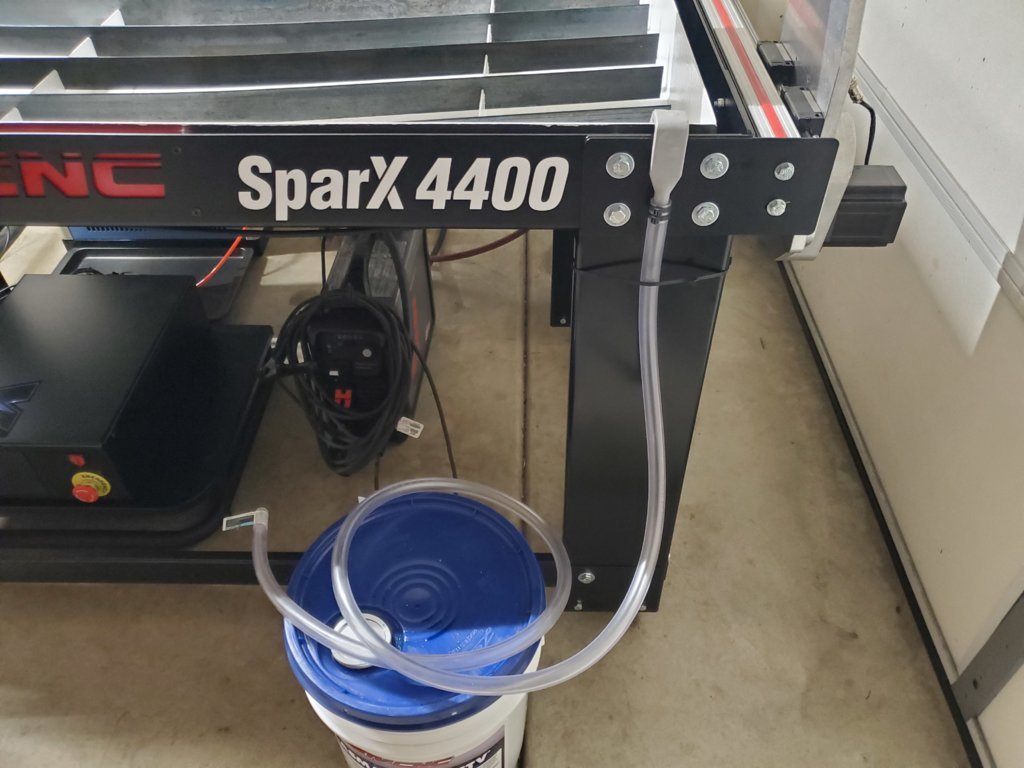

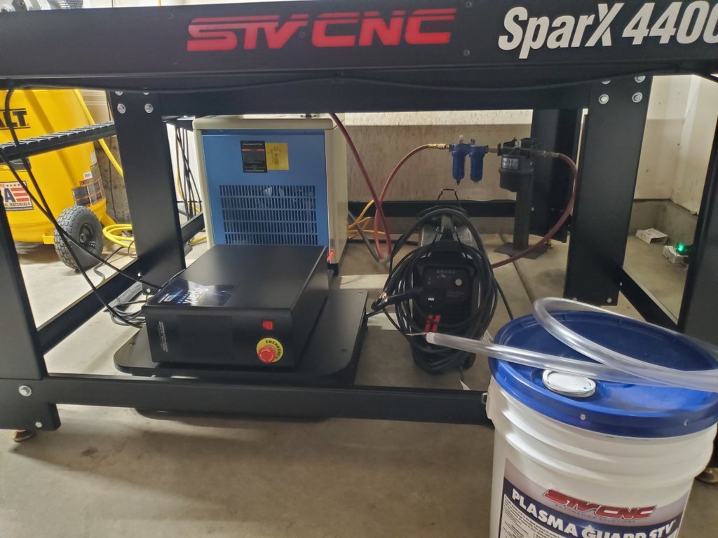

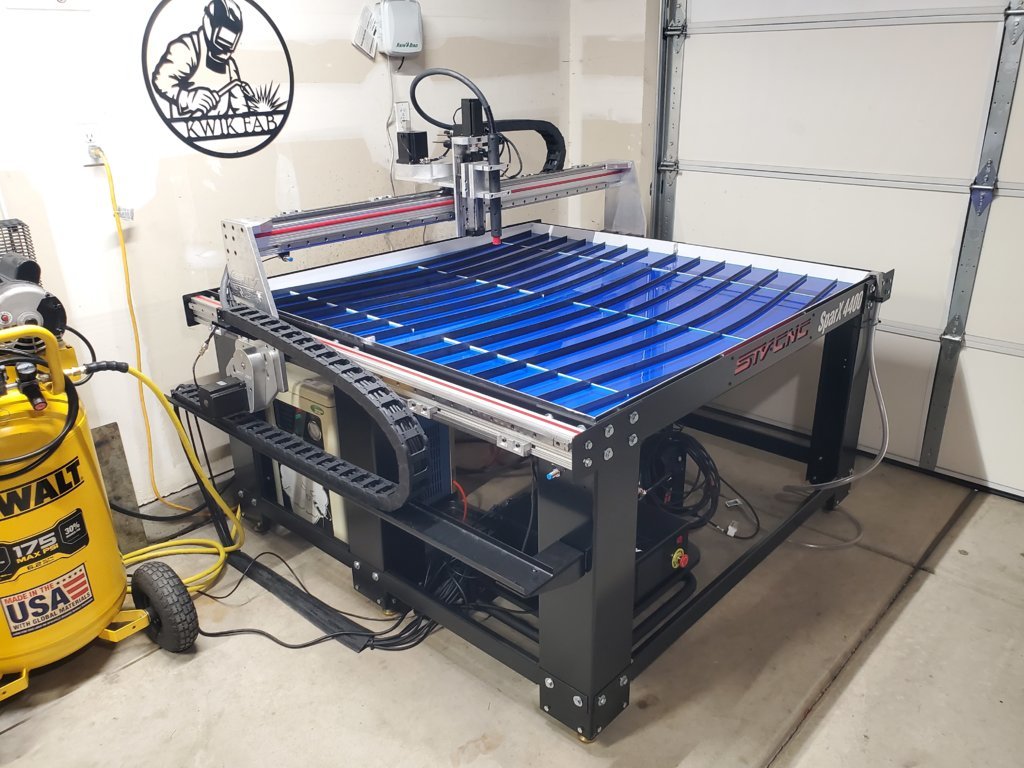

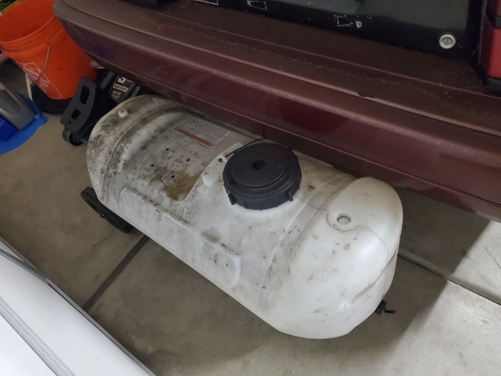

    @Pyrotech forgot to update you but my plan to run an easy drain/fill system was put to a stop.
    I don't have enough room underneath to incorporate a tank decent enough to use.
    I even asked a local Langmuir user if she wanted my tank, she's welcome to it for free but no go. The tank is too long to fit anywhere.
    I should reiterate; the tank is too long to allow me to situate anything underneath that'll keep things in an easy-to-reach manner.
    As for the printouts, the two I originally intended to use are also a no go. Not knowing how the water pan sat on the frame didn't allow me to account for the sides being blocked off underneath.
    On the plus side, I was able to incorporate the other style nozzle once I scored and broke off the tabs sticking out.
    Looks cheesy, but it'll aid in filling with either water or fluid whenever needed.

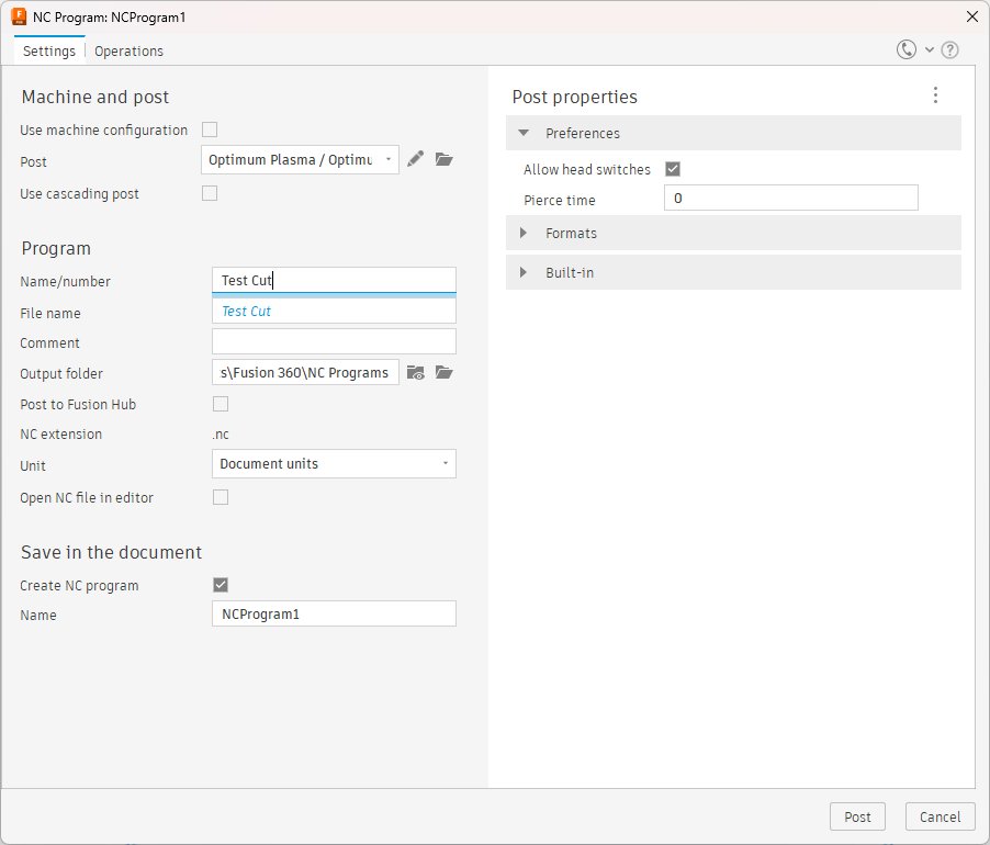

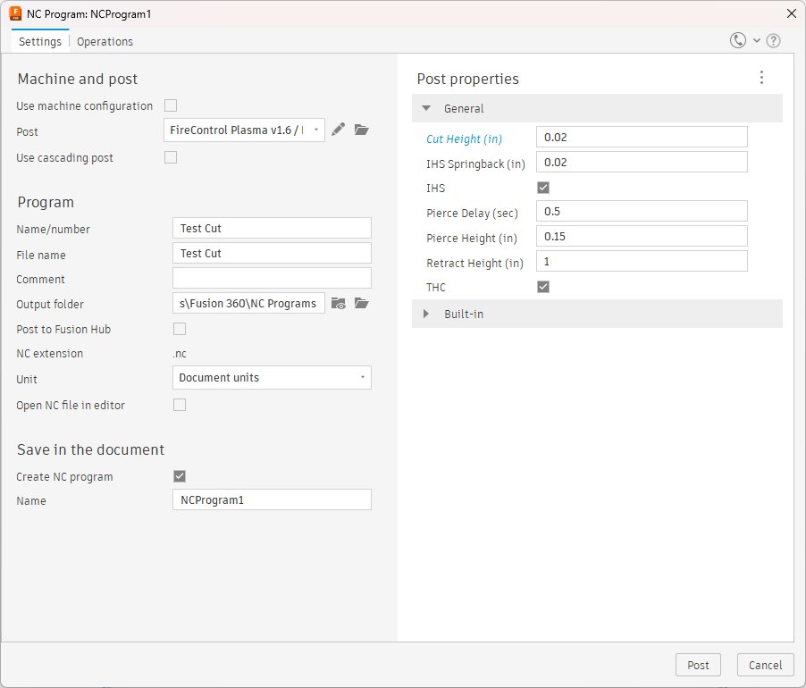

    So, I got the Post Processor file!
    Interestingly enough the post process prompt is a tad different than Langmuir's.
    Here's Langmuir, where the end user must set their programmed cut height along with the proper pierce delay for one's material -
    Then there's Optimum, which basically has nothing except a tool change -
    Now, Ivan himself handles tech support so he isn't involved with any part of the actual software development. He knows Optimum very well but not Fusion 360 at all so he couldn't really tell me much about the post processor for it.
    With that said, now that I've got it and looking at it, I assume the "head switches" is an option for their CNC router tables in case the end user wants to replace a bit for whatever they're cutting out of wood. This is the only thing that makes sense really, and the lack of pierce delay and other such options is strictly due to those functions being handled in the Optimum controller itself.
    As I demonstrated in the CAM process of Optimum, all you're really doing is creating your cut paths, setting your kerf, creating different speeds for different geometries (layers) and that's it. Arc voltage, cut height, and pierce delay are all done on the controller screen.
    I just post processed a file and ran a simulation on the table and it ran as expected with one weird action - when I run the program, the table does a quick "home" job before it proceeds to simulate cutting. I think this is cool as fuck but I was already getting the hang of homing the table each time I fire it up.

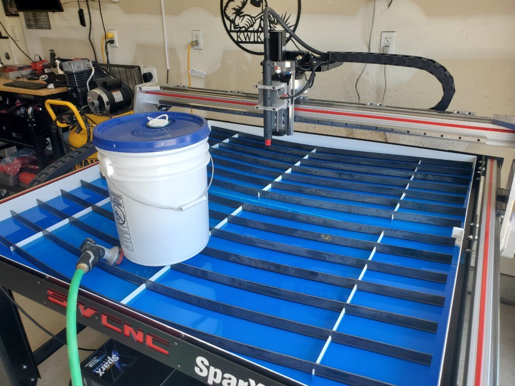

    Water pan so big you have to sit there and wait while you fill it with a garden hose :burp:
    Didn't mean to go this high but that's fine, we'll let evaporation bring it down a tad

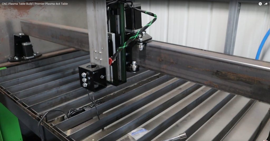

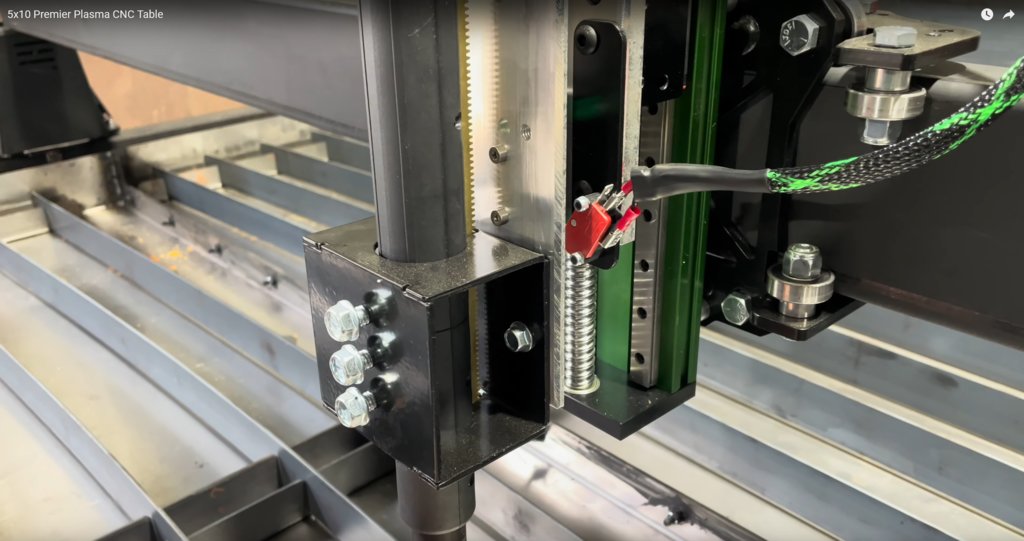

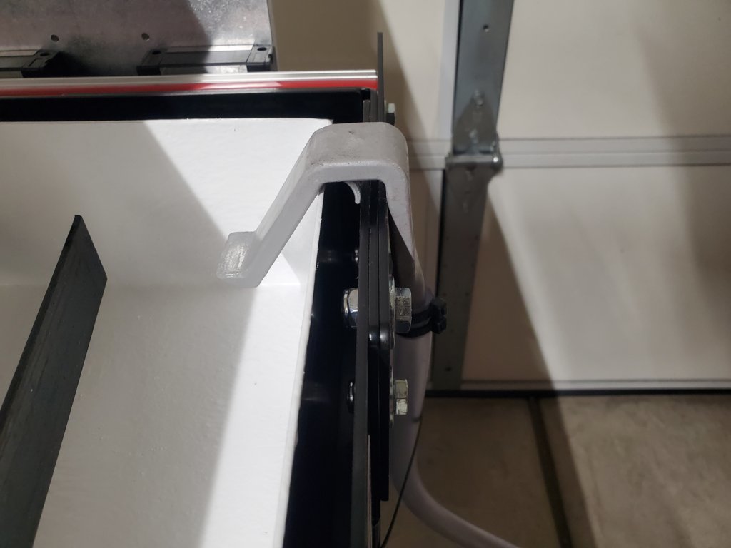

    Also, and this of course is just my own personal opinion, but often you'll get someone asking about "other table brands" in the FB group.
    Most that comment just stick with Langmuir, but every now and then someone has a Spark Robotic or an STV table. The only other company I see mentioned quite a bit though is Premier Plasma and I always wonder "why"?
    To start, if went to look at "comparable" tables both in terms of price range and cut envelope, they're not much less than the competition.
    Let's say you want their 4' x 8', they have a "regular" table as well as a "flat top" table. The modular setup is pretty similar to most other companies, I mean there's only so many ways to skin a cat. But once you add things like THC (a must have for anyone) along with a water table, you're at $6k for the regular and $6.6k for the flat top respectively.
    If you compare it to the popular Langmuir Crossfire XR, you're right between the regular and flat top, but get what I would consider a better table. The Langmuir is reinforced quite a bit more all the way around so I expect it to be much more rigid than the Premier Plasma, and is packaged pretty much as a "complete" system with the touchscreen, mini PC, and all.
    Premier Plasma does include a desktop PC (looks like a refurb Dell Optiplex), but runs on Mach 3. Then there's the whole "after thought" of a Proma THC controller as it's not even built-in seamlessly within their setup since THC is an option even on a $6k+ table.

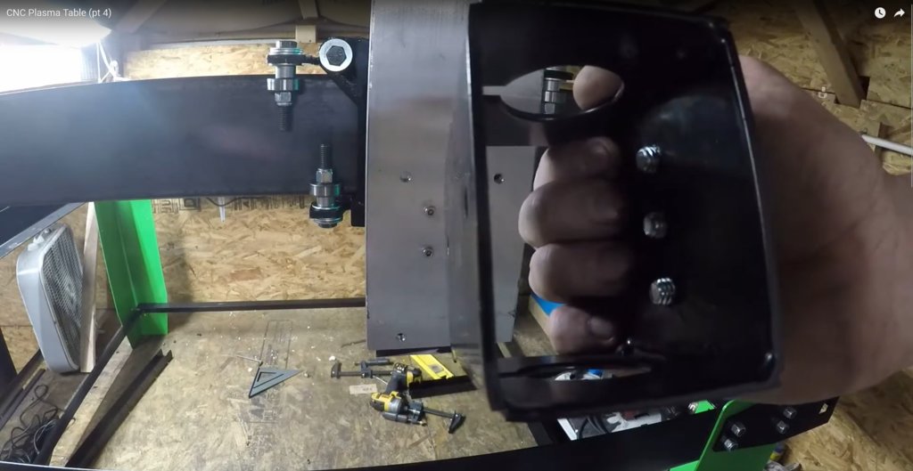

    But if there's one thing that bugs me more than anything, I'd say it's their torch mount.
    (This user had to slot their torch holder, the drilled and tapped holes we're done too wide. That and he had to cut down the hardware since it would hit the rear linear guide)
    Over the years, the setup has not changed one bit. I guess it works for them? I just can't imagine that being good for the torch head/body not to mention ensuring that you have a perfectly trammed setup.
    The whole thing rolls on ball bearings as well, just like the XR, so that's a wash for both of them really. But after reading so many comments, seeing posts in different threads and groups, and watching videos, the whole thing seems like a kit cobbled up together selling for as much as a well-thought out system from the other guys. The real take-away from this though are the many complaints about the lack of fitment across many different parts, customer support that taking +2 weeks to send you replacement parts (the user in one of the videos above never got his replacement part), and overall bad customer service. And once you're up and running, owners themselves complaining about inconsistent cut quality when it comes to dimensions on many of their parts (oblong circles are common) however I would chalk this up to assembly maybe.
    And if for some reason you fancied yourself an STV table, you're only $200 away from the Premier Plasma flat top but gain more like significantly more robust components that are machined in the US, a setup that's much easier to square up (you have to manually adjust all the bearing blocks on the Premier Plasma), as well as a magnetic break-away!

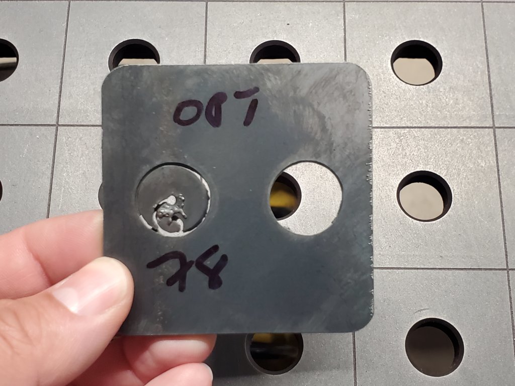

    Oh man, today was not the most productive day cutting.
    Did some test cuts but I kept getting beveling. Going to see if there's a step I need to take in setting things up as I keep getting possibly an incorrect cut height and/or arc voltage during cutting.
    Also the holes aren't great.

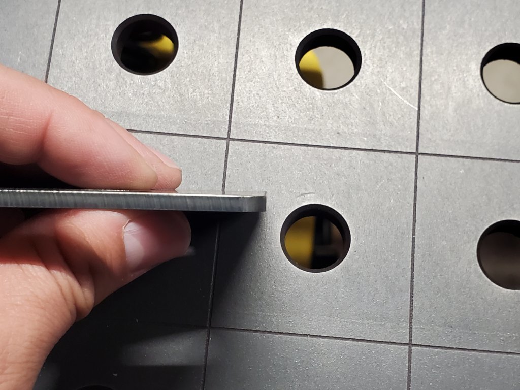

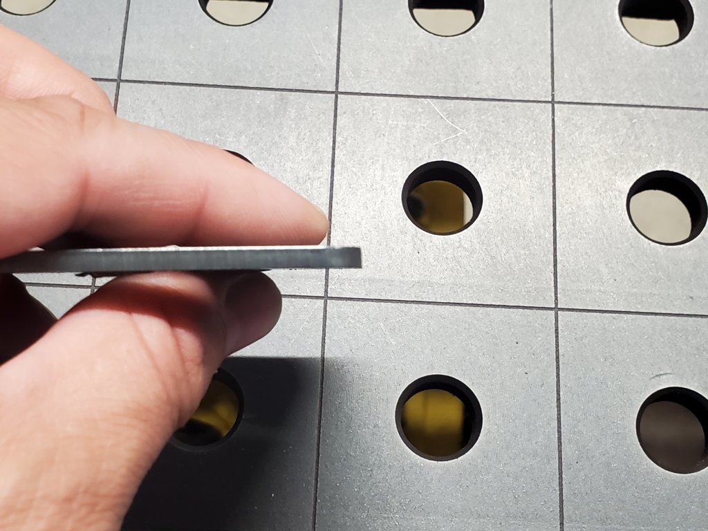

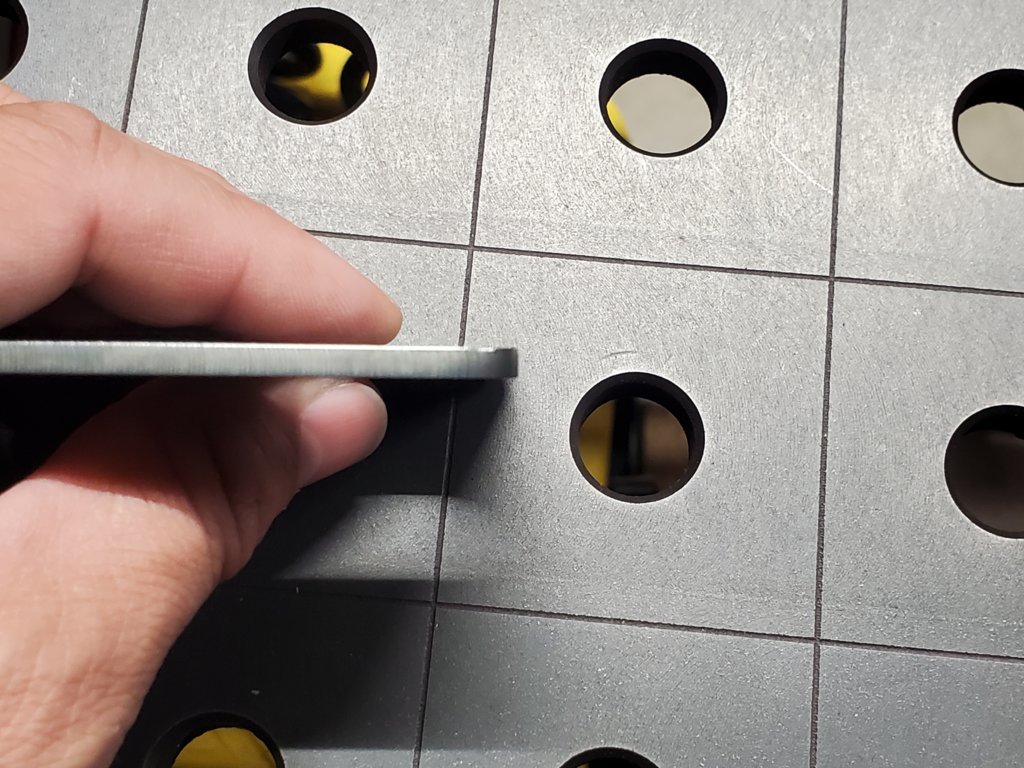

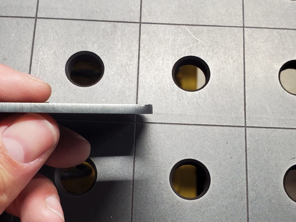

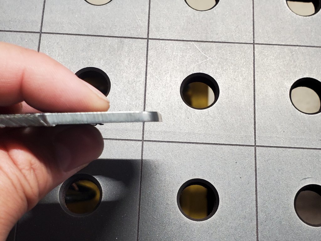

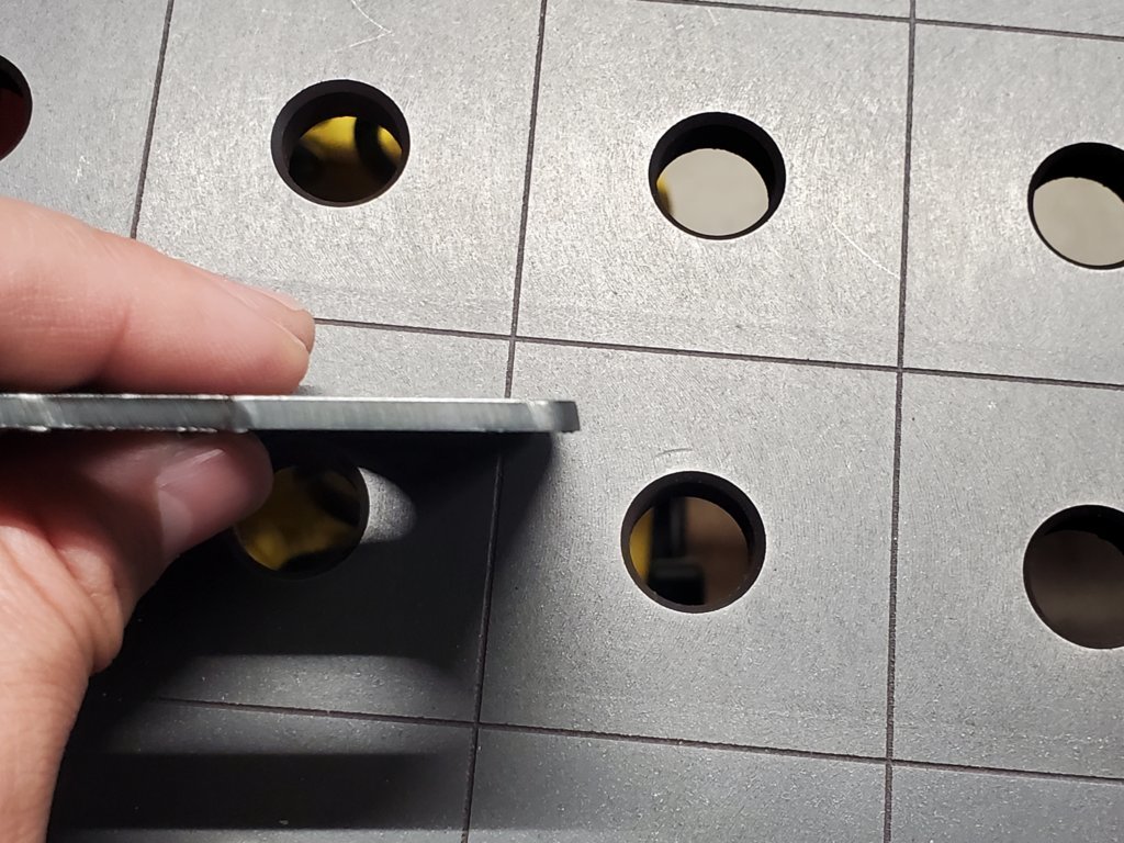

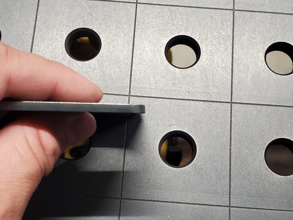

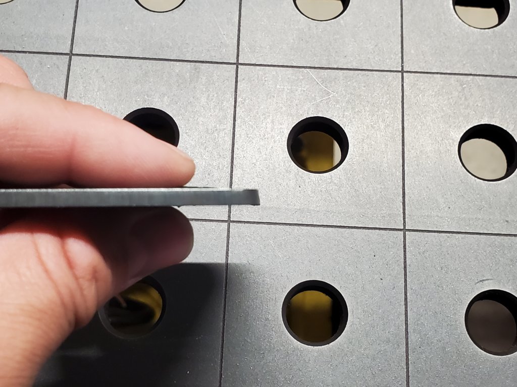

    Normally I'm pretty thorough when I post, and I couldn't leave my earlier post hanging like it did.
    So I ran multiple test cuts, a few being the same run just to 'test and confirm' and the result really was inconsistent beveling. I ran both the file I post processed in Fusion, as well as the file I post processed with Optimum itself.
    Rules were slightly different in terms of lead ins and outs, but I ran the same speed and tested both with arc voltage, as well as automatic height control.
    Well, I fucked up the first 3 cuts as I didn't realize I had left my cut chart loaded on a different tool in Optimum - let me explain.
    Optimum has a tool chart as I mentioned earlier, with your settings being cut height, pierce height, pierce delay, but even arc voltage. When you load an NC or TAP file that includes F code (speed), Optimum will prioritize the g-code's speed over the built-in chart. I knew this, so naturally I ignored what was loaded however I failed to realize the chart was loaded for 3/16" so while the cut, pierce, and delay were pretty much the same, the arc voltage was a good +100v for cut height.
    It wasn't until I had the torch rising while it was cutting the outside that I realized it did so in order to achieve my arc voltage setting. I think this is where I partially ruined my nozzle.
    Well, after I switched to 10 gauge (Hypertherm only has 10 gauge or 12 gauge, no 11 gauge for the material I was cutting), I made sure it was also set to Finecut and Quality which puts me at the correct arc voltage of 78v. Huge difference from the other setting at over 100v.
    Unfortunately, the circular cutouts didn't fall out right away so it's fair to say I'll have to dial in my speed all over again. I had 110ipm set on my Crossfire Pro, but 90ipm seemed to cut better on my STV.
    Anyway, going on to the next few cuts I had weird beveling that wasn't consistent at all so I called it a day.
    Here are the last two parts I churned out, at 100ipm using Optimum and auto torch height -
    And the same but at 78v using arc voltage settings -
    I'm taking tomorrow off to enjoy the new artificial grass we got put in earlier, and will come back to this Saturday. I will say during everything, I was largely suspicious that my cut height was a lot lower than it was supposed to be.
    The beveling isn't all that terrible really, but it could be fixed and again I think it's due to bad cut height.

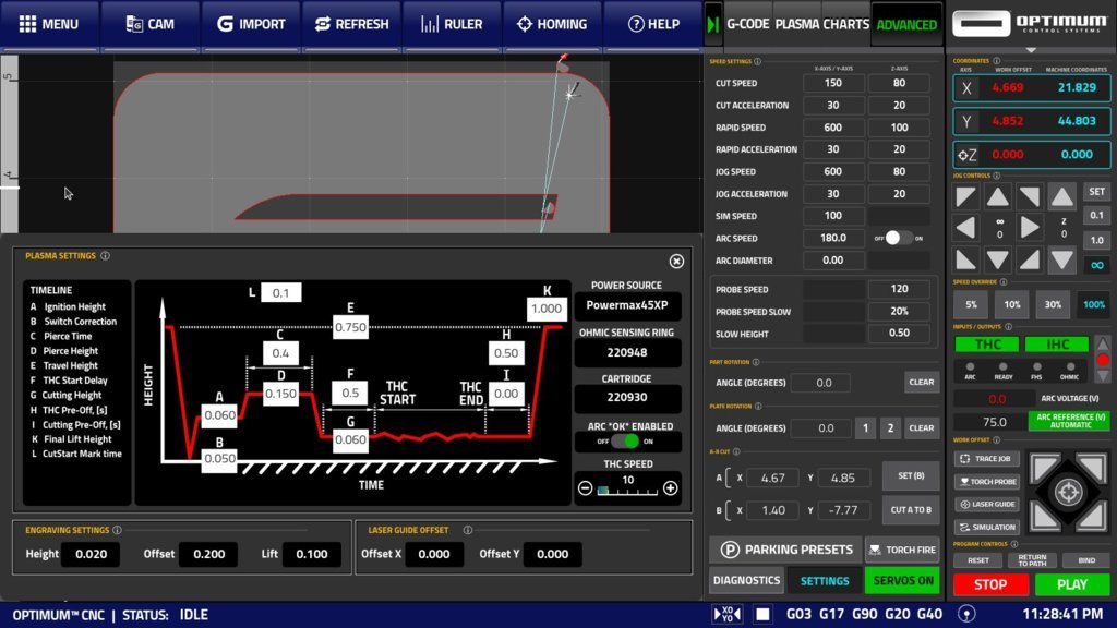

    Couldn't well enough leave things alone so I got to digging into seeing if there's something I need to "fix" or "adjust". Well, that's when I dug around and thought I'd do my own calibration of the Switch Correction which basically means the adjustment needed for when the floating head touches off the material and regains control.
    The default value is set to .05" for Switch Correction, and the cut chart has an Ignition Height of .06" as shown here -
    Rather than type what I did, here's a short video -
    https://youtu.be/Nw9gPH43Qsg
    So I wonder if now with the correct Switch Correction if I'll see any difference in my test cuts. Worst case I start messing with different arc voltage settings.
