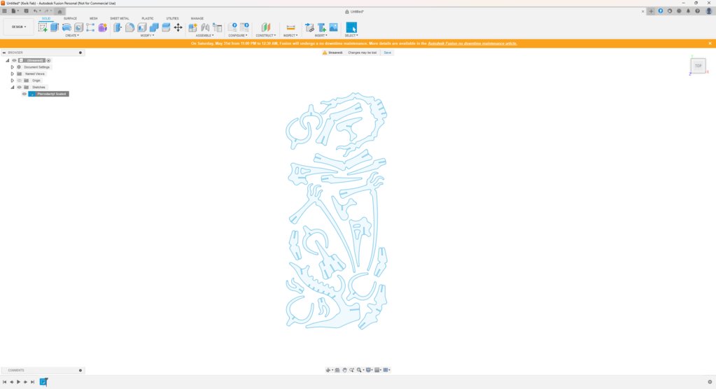

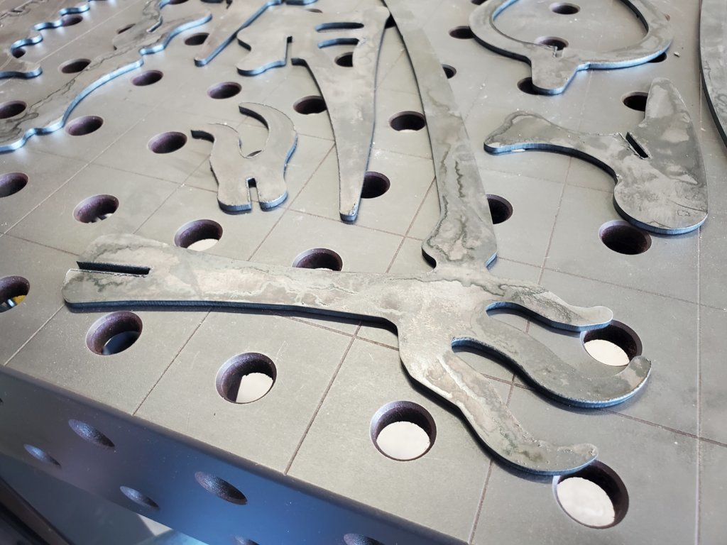

    And with a "good enough" chart established, I thought I'd run what I sort of call the "benchy" version of CNC plasma - a dino cut.
    To start, I opened up the Pterodactyl file I've shared here before. In opening it on Fusion, I measured out my manually nested layout which turned out to be just over 680sq inches.

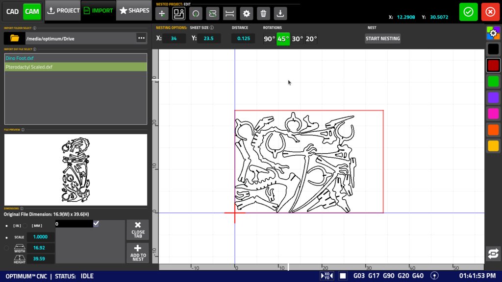

    I mention this as I'm now working to implement Optimum as much as possible and get familiar with it on the CAM side.
    Bringing that same DXF over, and utilizing a very conservative rotation of 45 degrees, and 0.125" of spacing, we end up with a nested area of just under 620sq inches. You can see there are still a lot of voids and that's due to the limited angle of rotation I implemented. I guarantee we can bring this down and still achieve great quality due to my gear reduction.
    A learning experience surely, but it's ok because we're still on the same steel plate I'm doing test cuts out of.

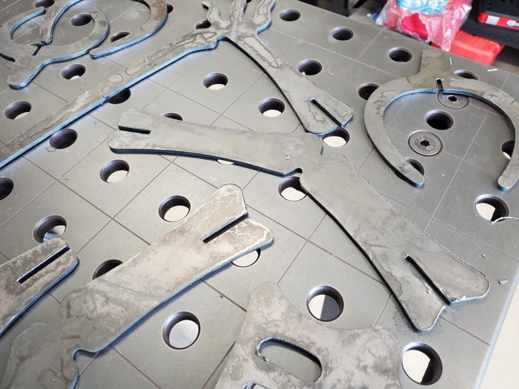

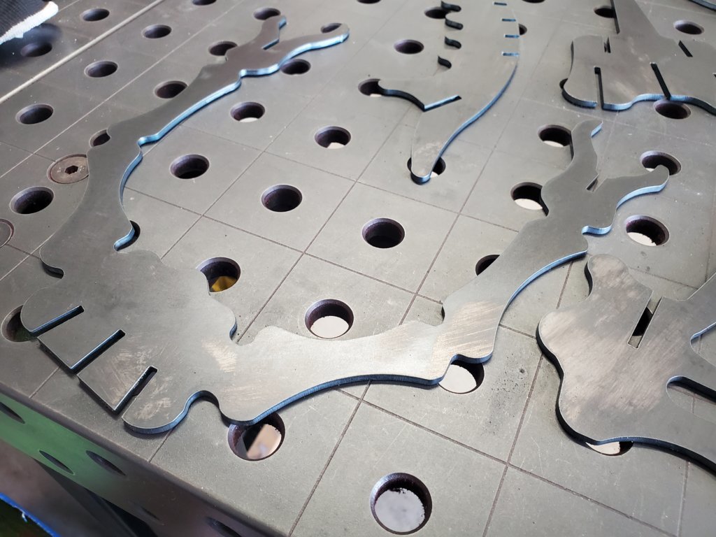

    So, how'd it cut? You guys can be the judge.

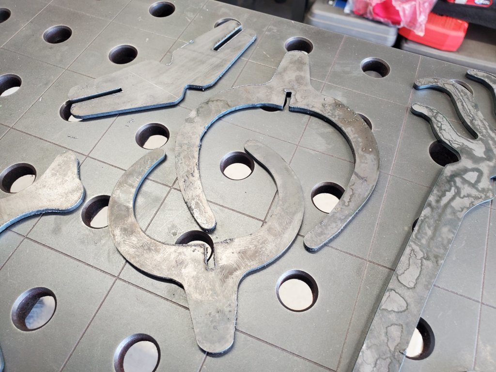

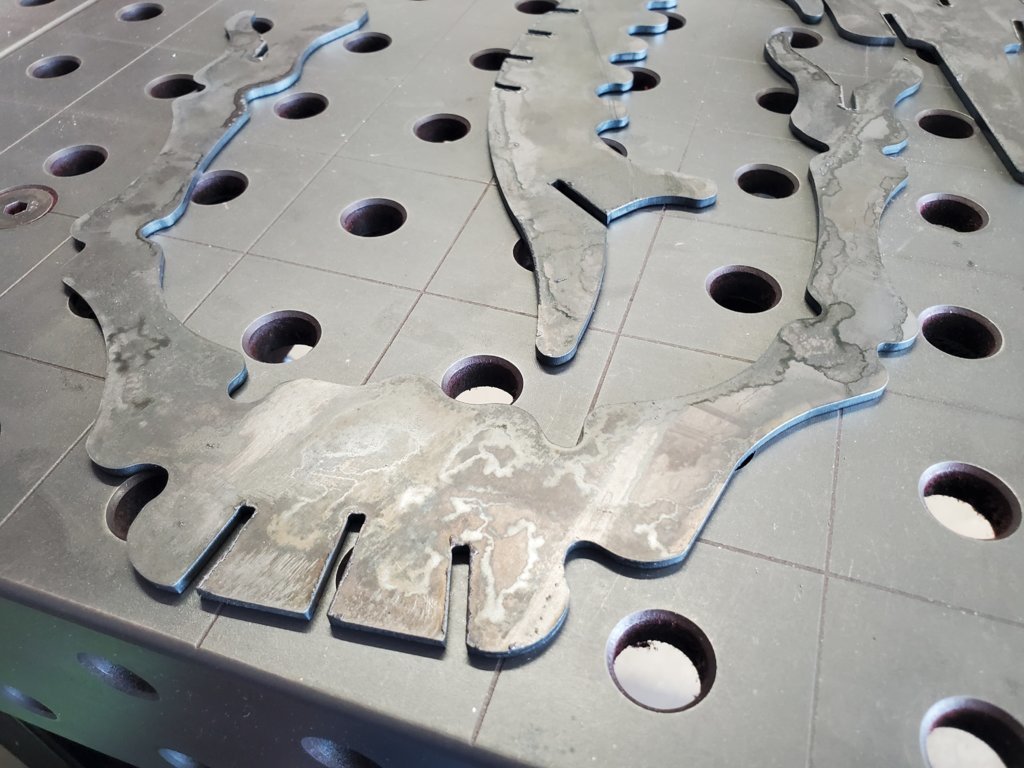

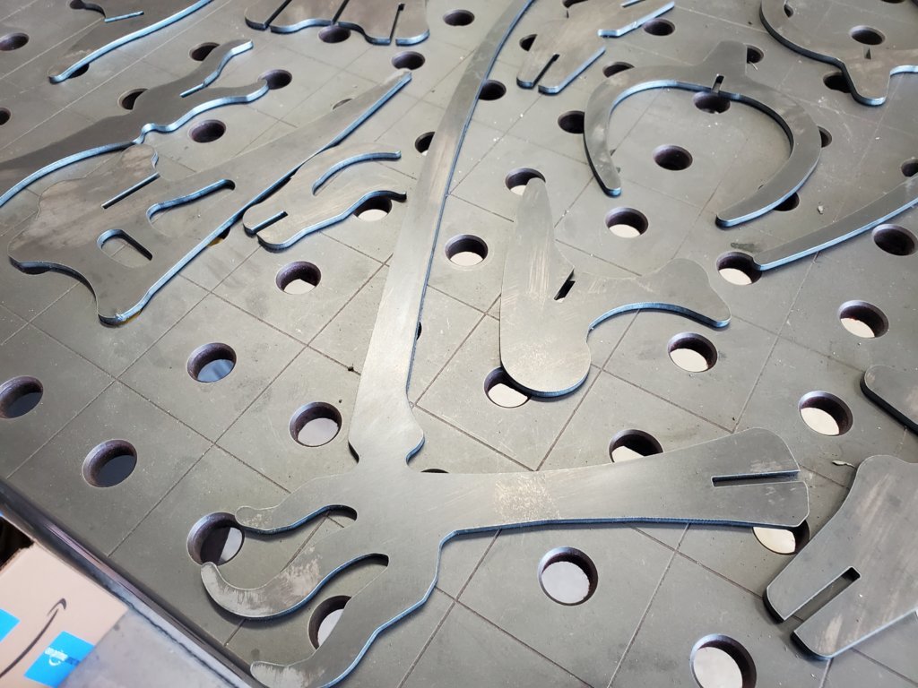

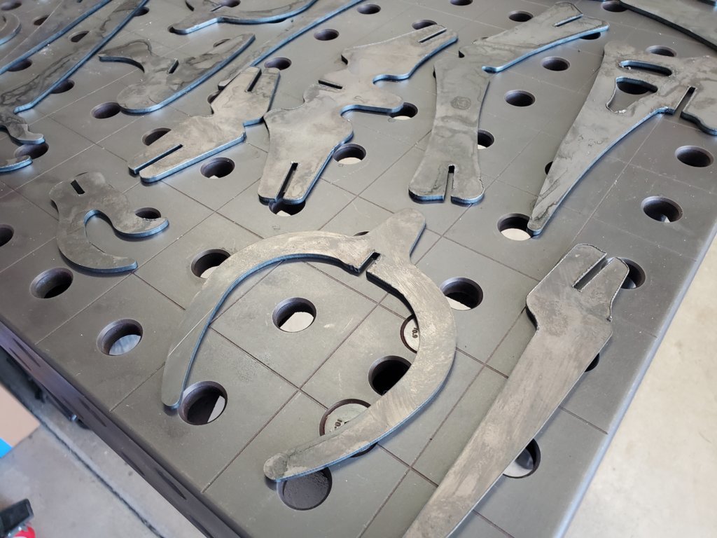

    I put every piece out on the table, with the underside up so you can see all the dross right off the table.

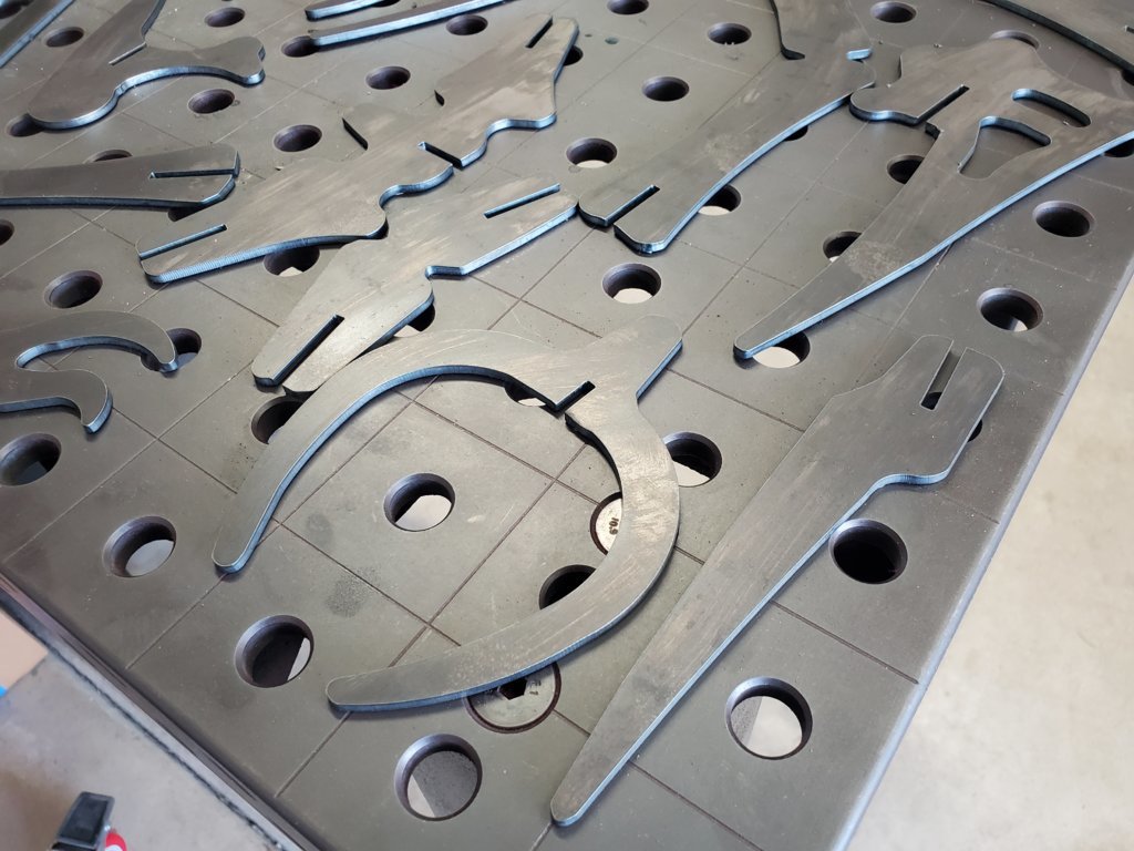

    And the top side.

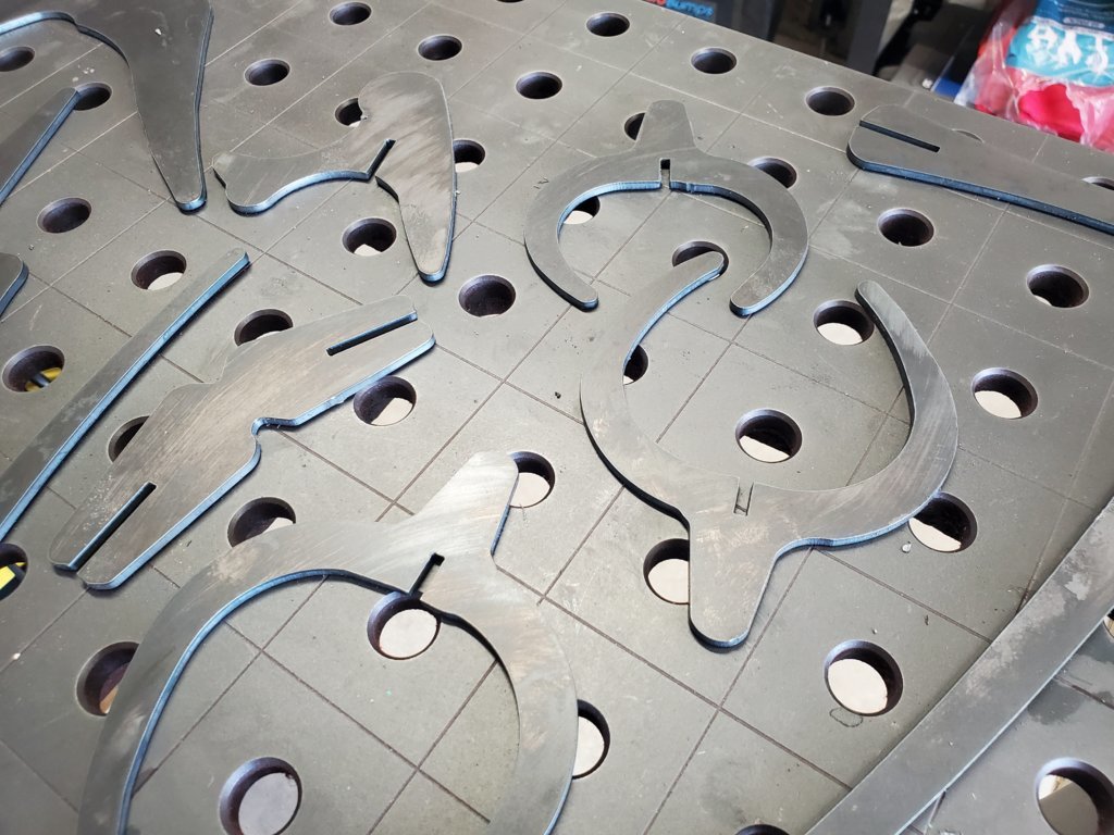

    And the reason why I called this test run "benchy" is because in all my experience, getting square cut slots is probably the hardest thing to do.
    I won't say that there isn't any beveling, but it is really minimal with many edges being perfectly square. Expected due to the many X-Y transitions and the fact that the speed is the same all throughout the entire design.

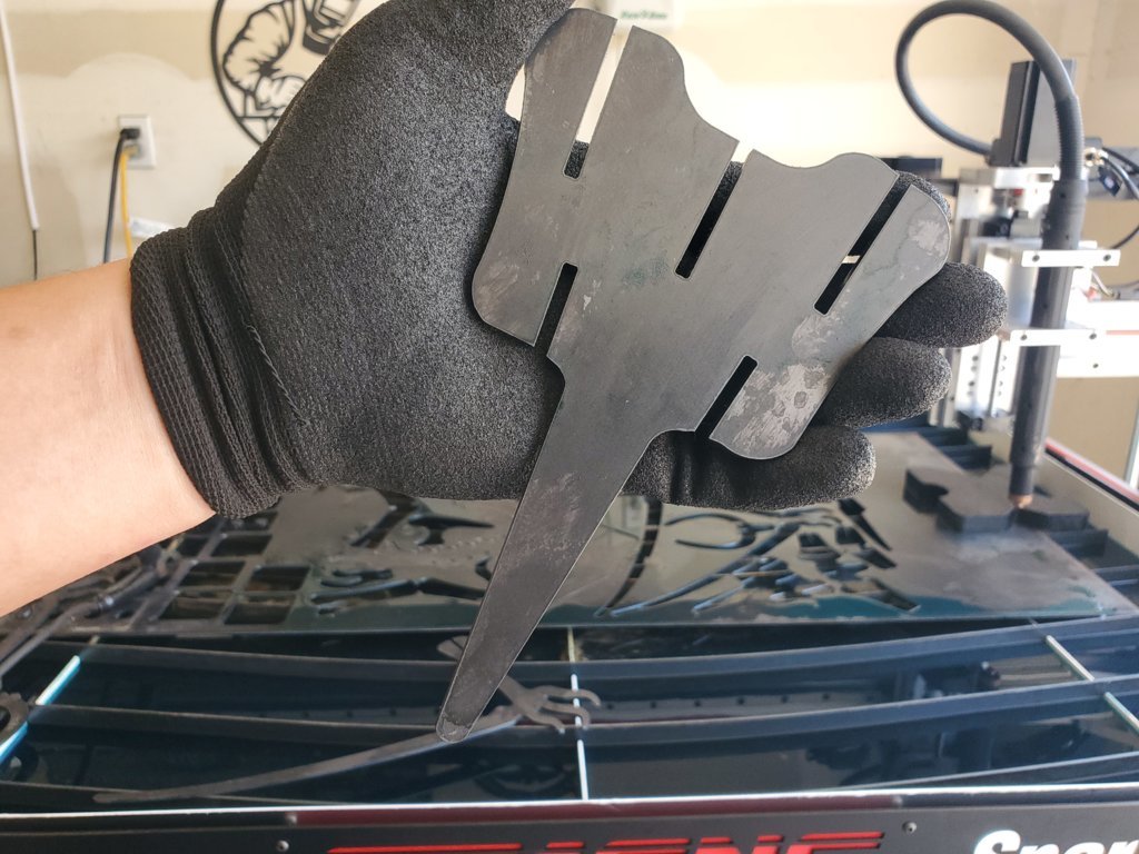

    I have to say, I'm super stoked with how today turned out and I really wish I had a video to upload. Unfortunately I'm poor so I use my phone for all my Youtube videos and pictures; I had a recording for this cutout going on until I received a call or messages at the 9:41 mark, just 1-2 minutes shy of completion. Really wanted to include the park at the end of the cut where it utilizes its "park" feature as shown in the above picture automatically.

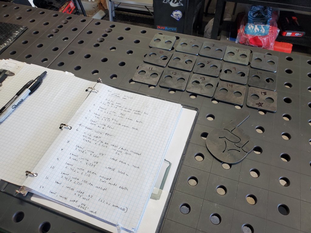

    Also, revisiting my results in my binder I found that cut outs 8, 11, and 15 yielded the best results which will make me go back and dissect those settings further and perform more test cuts tomorrow.

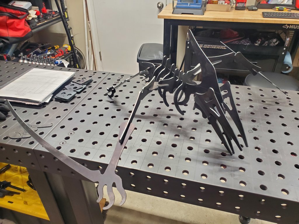

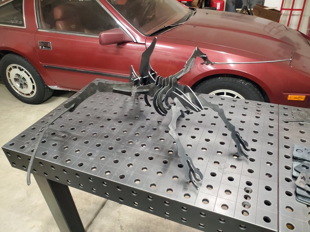

    I didn't realize how big it is once assembled.
