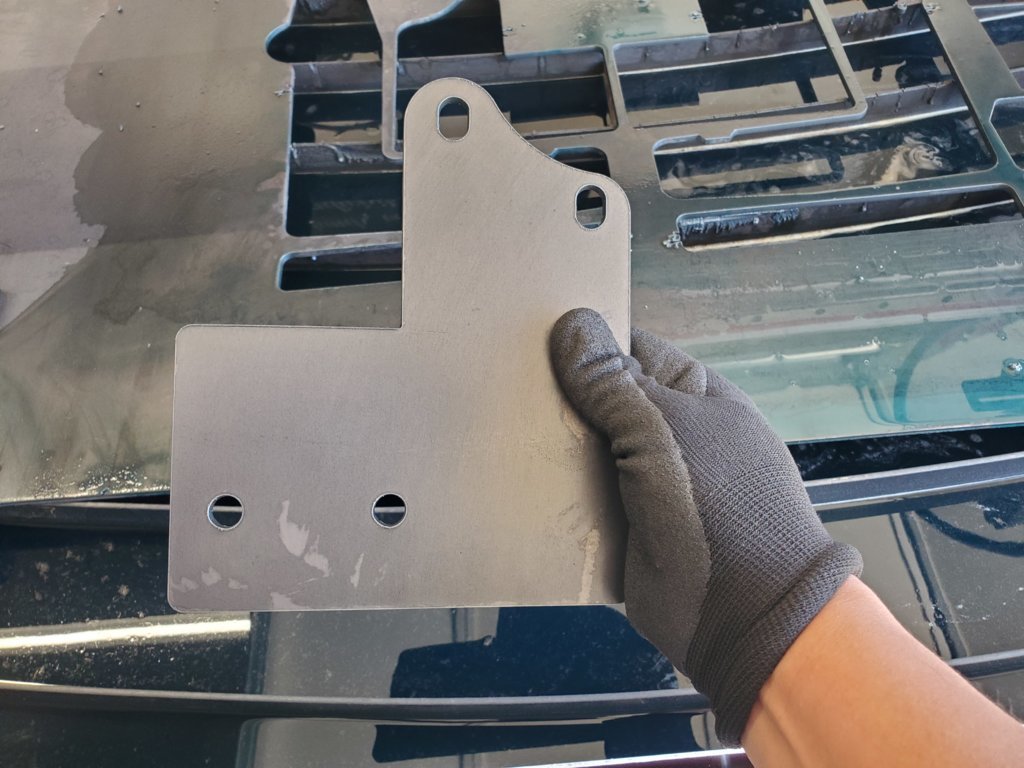

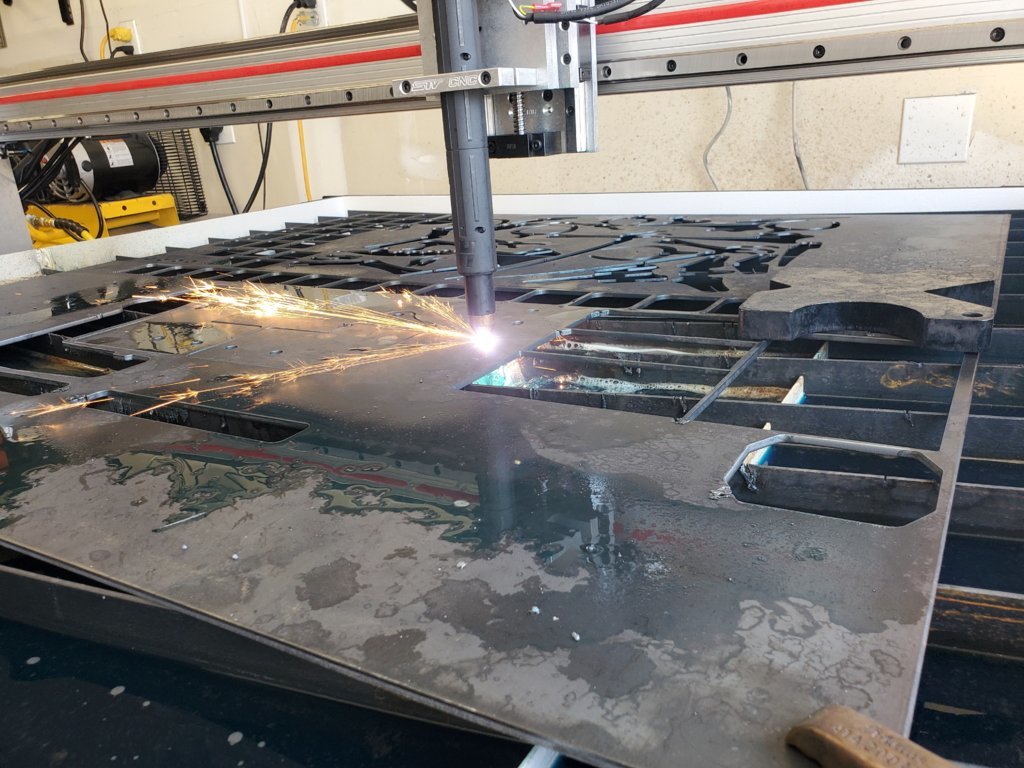

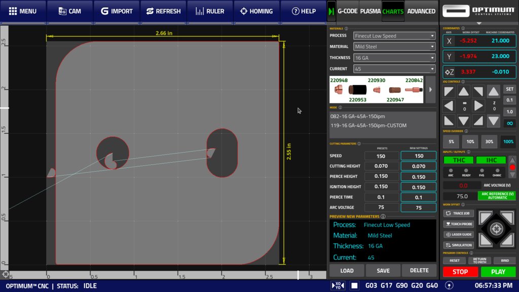

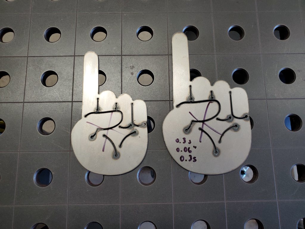

    Wife got home at a regular time today from work so I took advantage of it and thought I'd cut a bit of 16 gauge. I'm just using left over scrap I've got laying around but it's got plenty of space for a lot of cut outs.
    Rather than do the traditional "square with holes", I thought I'd skip right into the Pointer design and toy with pierce delays.
    https://youtu.be/6WOy9a0rWvs?si=KTvZGn-9aCKuzzt1
    (Not to worry, after I watched this video, I adjusted the slack for my cables on the Z axis assembly)
    I gotta say, I do love the parking feature that I leave enabled for after every cut.
    Here are the results of those cutouts.
    The numbers here refer to a few things - pierce time (for initial height/THC), cut height, and pierce time. I even toyed with THC delay but it made no difference with the actual pierce itself.
    I also messed with ignition and pierce heights and found it best to leave them both at the same height.

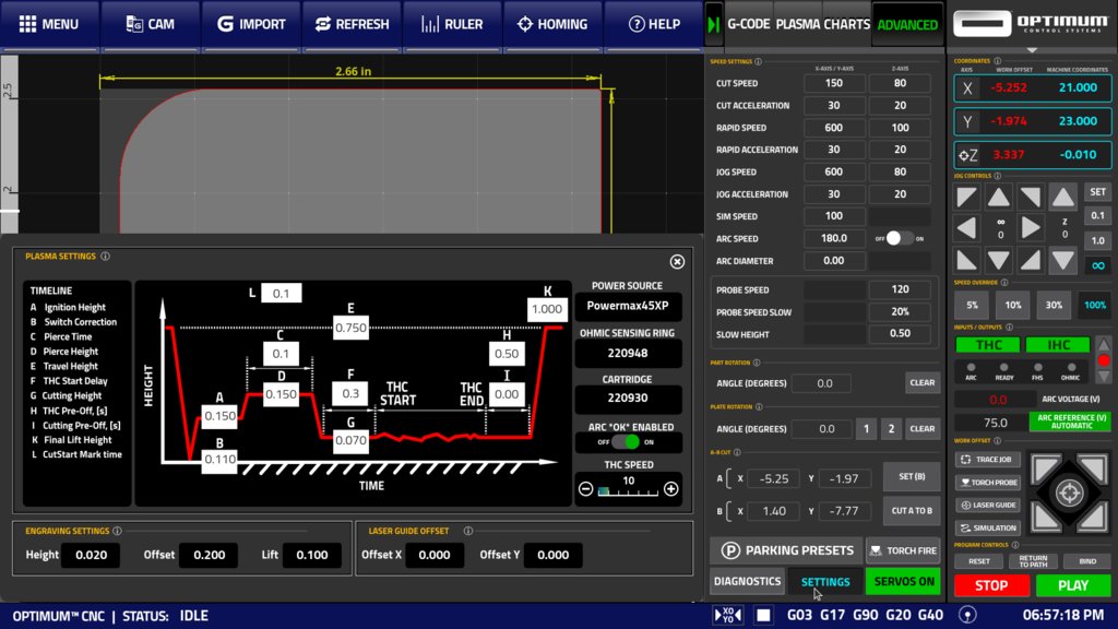

    And for those wondering how those screens look like in Optimum, here they are.
    What's nice about the Charts section here is that I can save changes shown below so I don't have to remember arc voltages, cut heights, and all the other details outside of just cut speed.

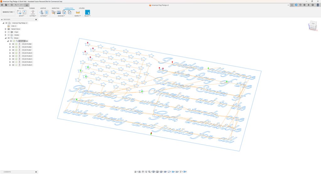

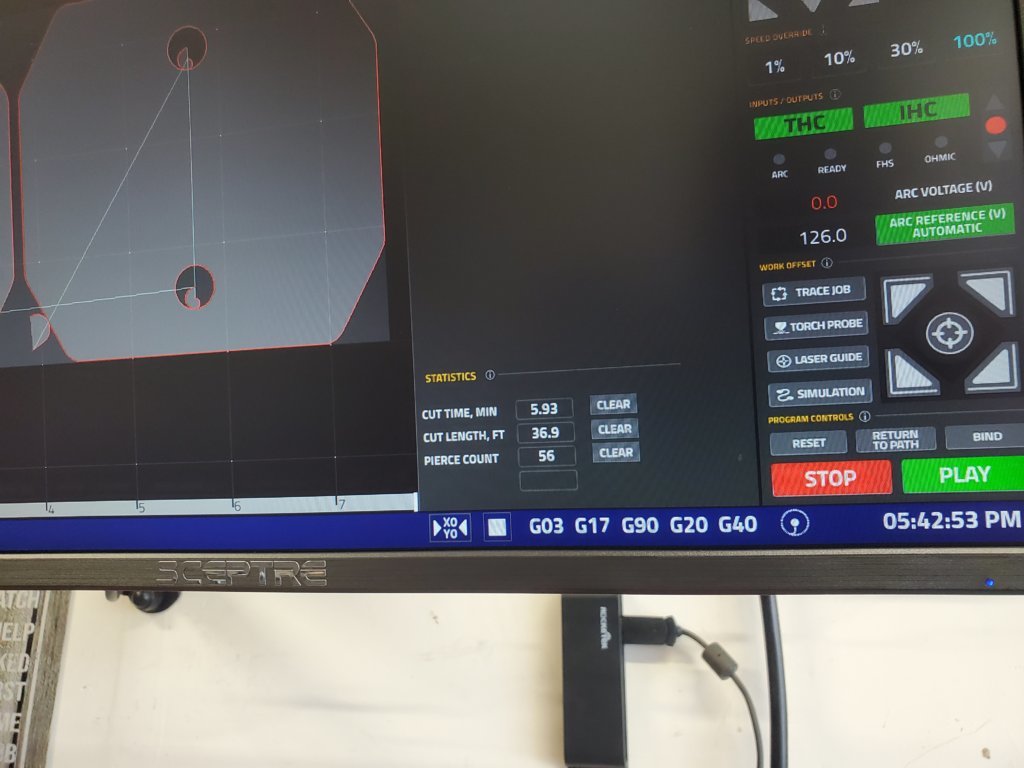

    Half-tempted to buy some 16 gauge tomorrow and run this file, afraid that I may have some drops due to the longer pierce delay still.
    Taking donations if y'all want to see me try :rofl:

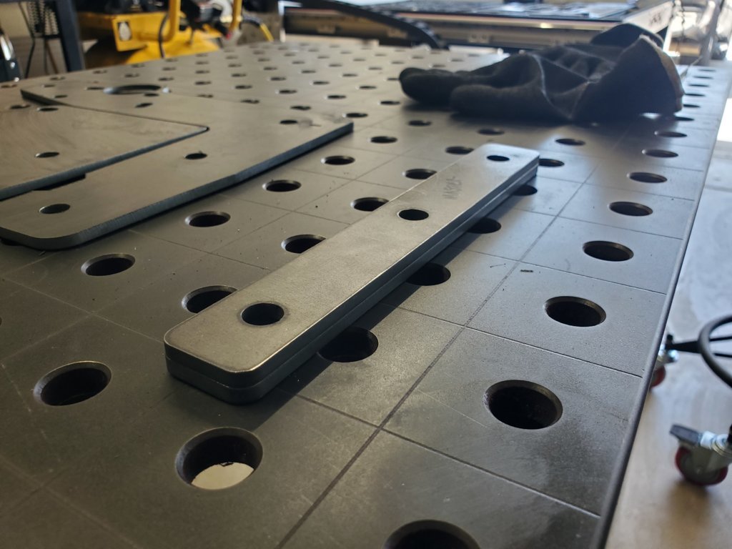

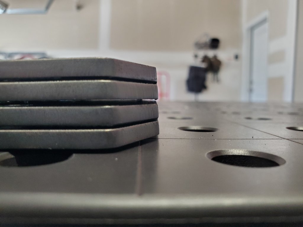

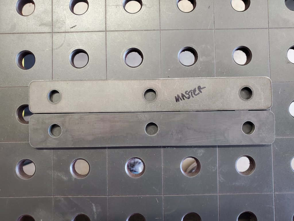

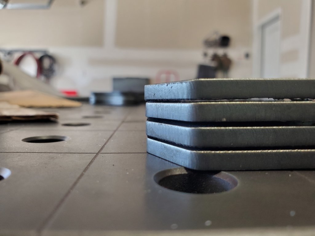

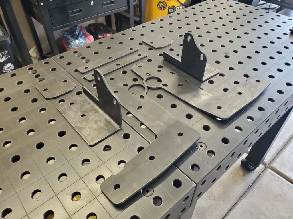

    First set of internal stiffeners cut out on the table; got a bit of beveling (minor) but it's consistent which tells me it's my consumables.
    Only thing that sucks about Optimum is not having a pierce counter :annoyed:
    My master set's main parts are bent and welded, so I don't exactly have a flat set to compare it to.
    However, comparing it with the small 3 hole mount it's damn near perfect.
  11. Jun 7, 2025 at 12:34 PM

    Oh yeah, everything looks to match.

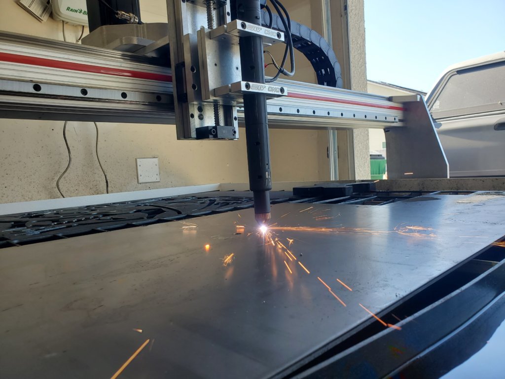

    Just got off the phone with STV, man they're listening.
    They had a discussion recently about items I brought up and one of them was actually about a pierce counter! Just updated my software as an update was made available so now I can manage my pierce count within Optimum.
    The next one is implementing rules that Fusion 360 has as well as disabling THC for individual layers within Optimum's CAM.
    Things are happening :bananadance:
  20. Jun 12, 2025 at 2:46 PM
    #700
    Kwikvette
    Kwikvette [OP] Well-Known Member Vendor
    Feb 27, 2019
    #284735
    82,713
    Fresno County
    4 run, 2 don't

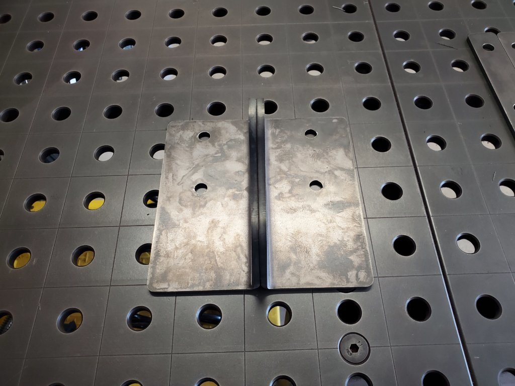

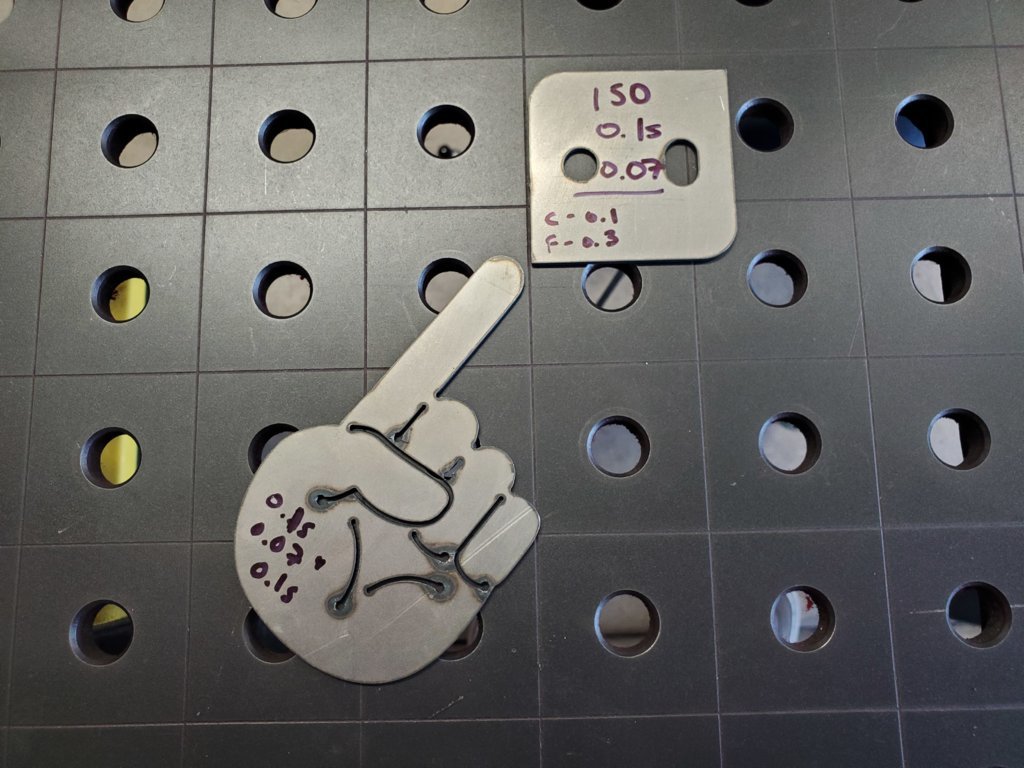

    And confirmed!
    And the fact that it cuts this well consistently on different parts of the table is freaking wild.
    There's a bit of dross on the small holes which is normal for this setup.
