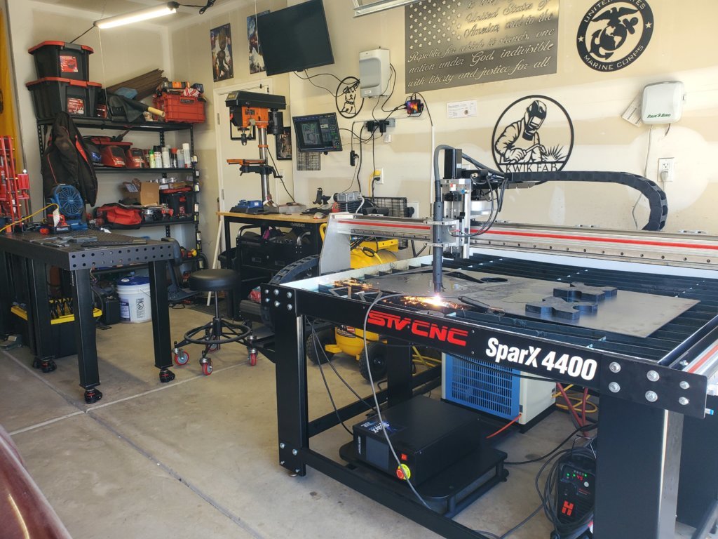

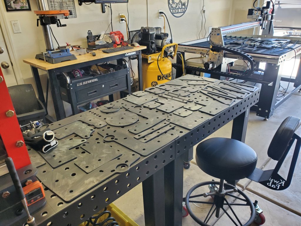

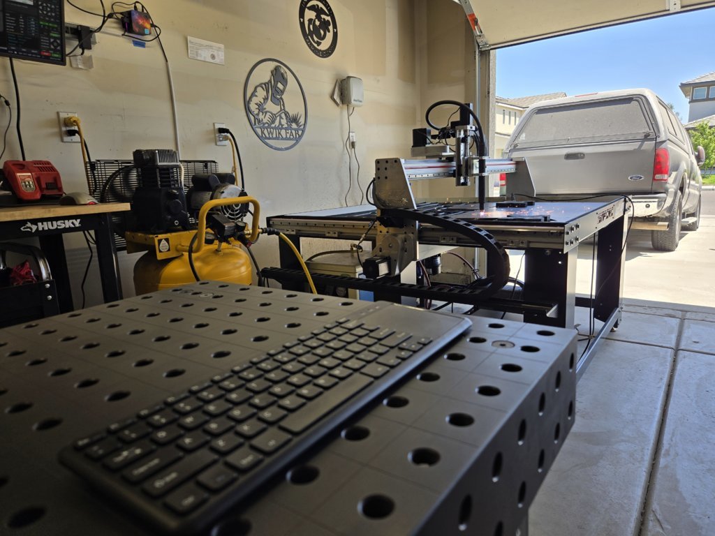

    Got a few things to cut tomorrow - some more internal stiffener sets, a stool kit, and even some filler plates for some sliders.
    Best part? I drew everything up within minutes and I'm done.
    Seeing as how all my CAM is done right at the computer, not to mention how fast the actual process is, I'm spending less time dealing with save files on Fusion, skipping creating my cut paths, then waiting to post process everything on my laptop when I'm ready to cut.
    This whole Optimum setup has made me much more efficient now that I just have to create the DXF.

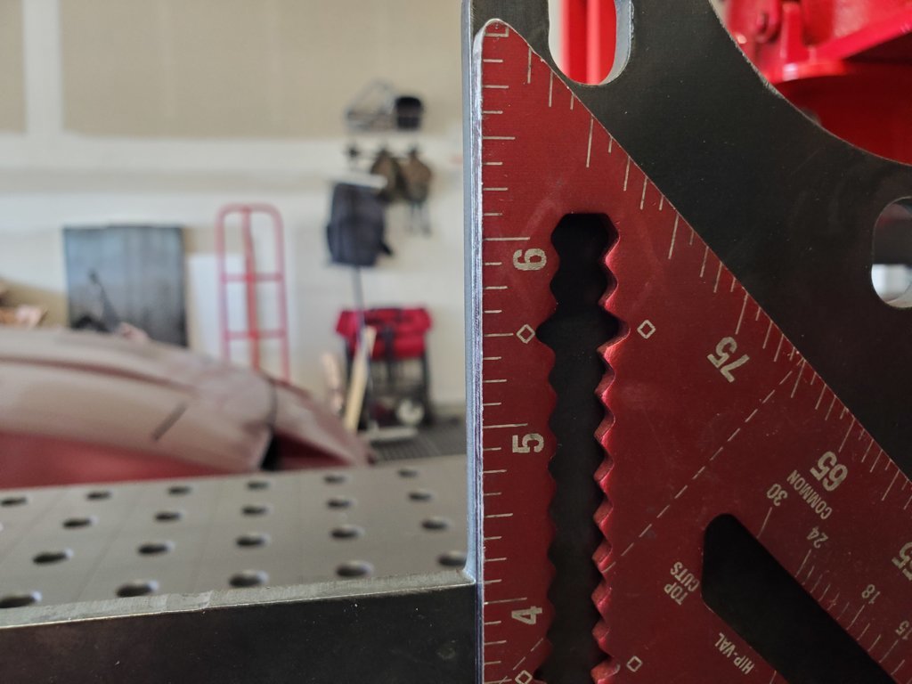

    Reserected from the dead.
    Very nice accuracy.

    Consistent accuracy, that's where I'm seeing the big difference here. I can cut anywhere on the table and it is both accurate and consistent from one part to another.
    But I think the biggest take away going from my old Langmuir table to my STV table is that I can walk away knowing all my parts will cut without issue.
    The curved slats are preventing specific items like my internal stiffeners (the smaller L shaped one) from falling in and causing a tip up. The magnetic break-away handles that anyway but the slats are preventing it from happening to begin with.
    The floating head setup uses a different type of switch; I've had IHS set itself off prematurely causing Firecontrol to "think" it touched off the metal already and proceed firing above the surface of my metal. This is because the IHS contacts are thin copper tabs that are exposed to gunk and anything else that kicks up onto the Z axis assembly.
    The rack and pinion setup means no possibility of a leadnut failure (had one strip before), or couplers that suddenly get loose causing an axis to slip.
    This isn't a knock on the Langmuir table of course, I ran them for a good minute but with continued use of the STV, I feel more at ease just letting the table do its thing.

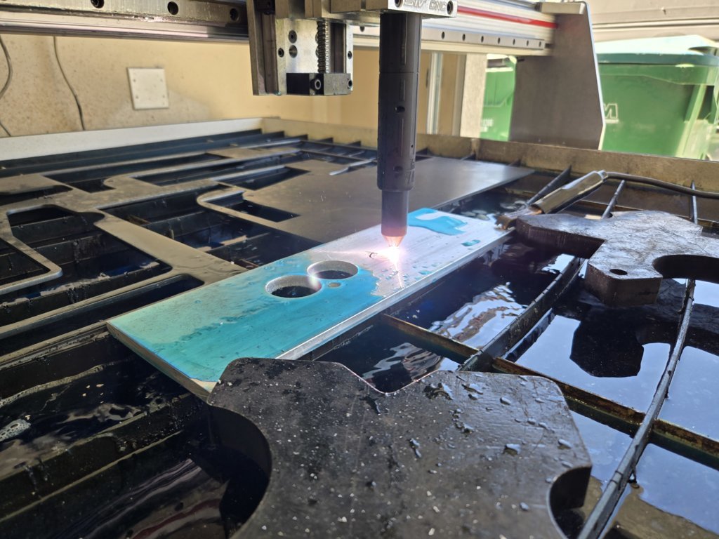

    I've been using unshielded consumables for my fine cut, and as great as the quality is, I'm sure I should've gone shielded for longer life.
    Finally got myself the shielded deflector and some more nozzles.

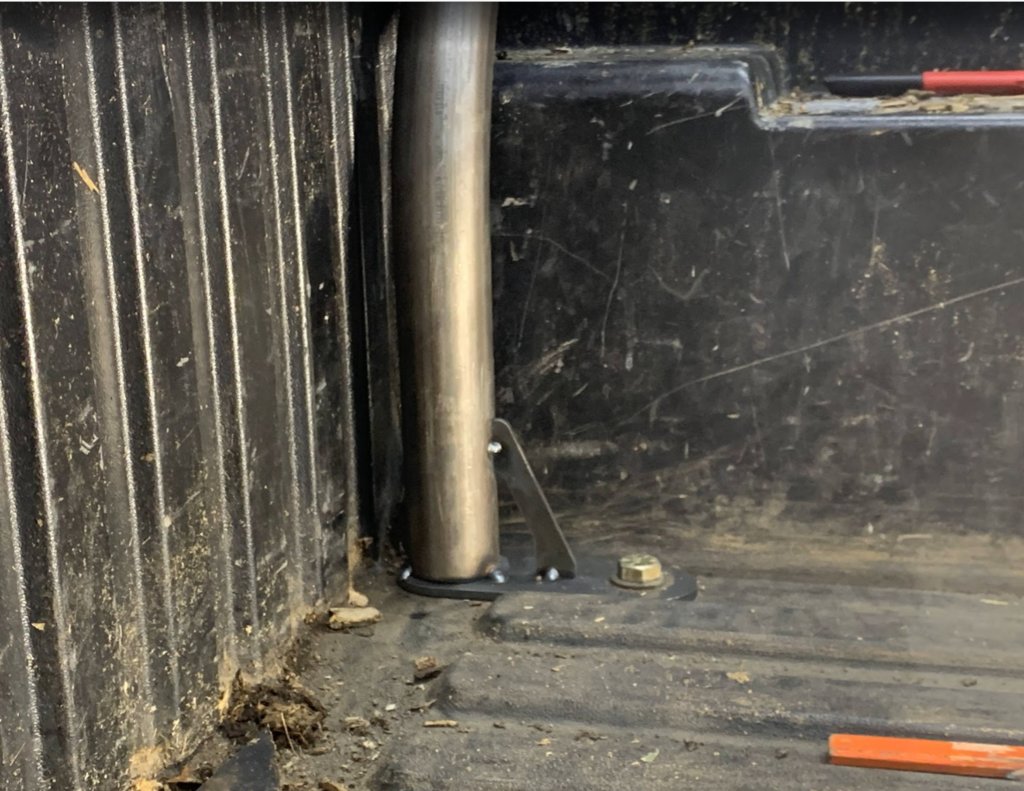

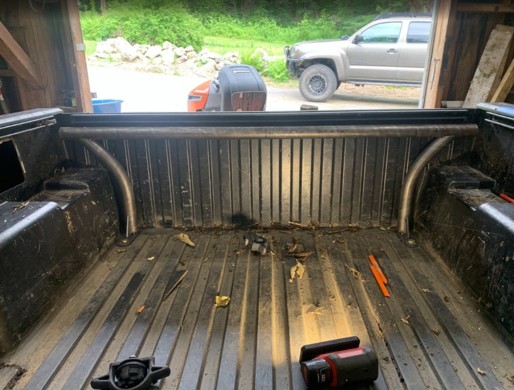

    I kinda dropped off here, still using the table alot though.
    Building a bedcage for a local and used the table to make some small gussets thatll double as extra tie downs.
    Going to be the working mans bedcage

    Tab and slot is the best :bowdown:

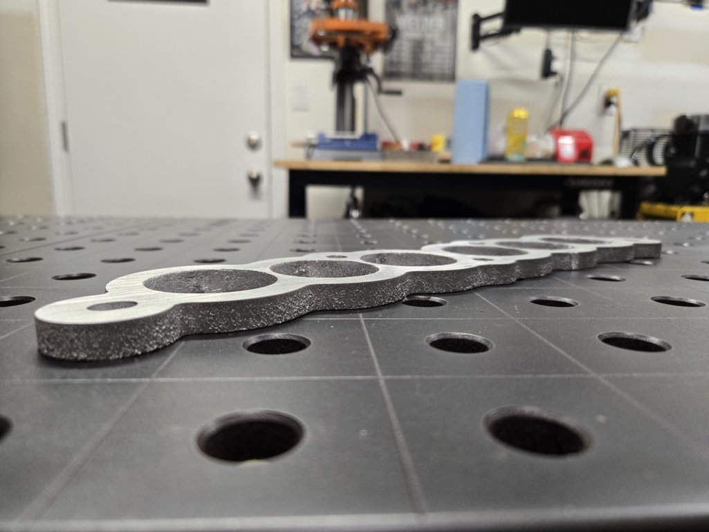

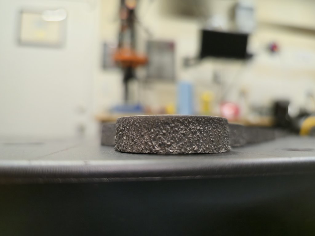

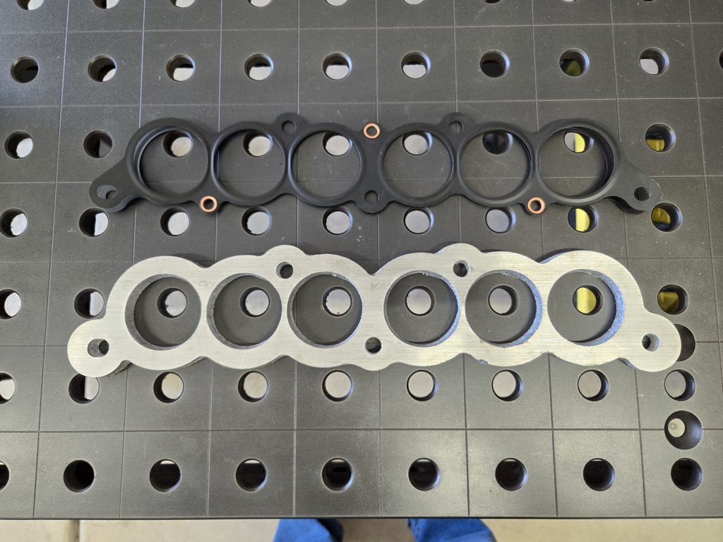

    Aluminum is messy.
    Thick aluminum, is really messy.

    This is a post that I can relate to.
    When I got my table running ( not dialed in), I had no sheet iron on hand. I did have 1/8th" aluminum sheets handy. My cuts looked like ass, but I was super excited that the table worked!
    I did make a YT vid and may have dropped the F-bomb in excitement!

    I've cut the tiniest bit of 1/8" aluminum and that's it.
    Never cut 3/8" aluminum before and you can see I had little to spare so no test cuts for me :rofl:
    Fuck yeah I was happy for a non-dialed in cut result. But I feel like it could be better (if dialed of course).

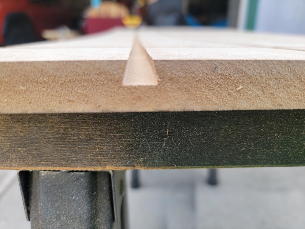

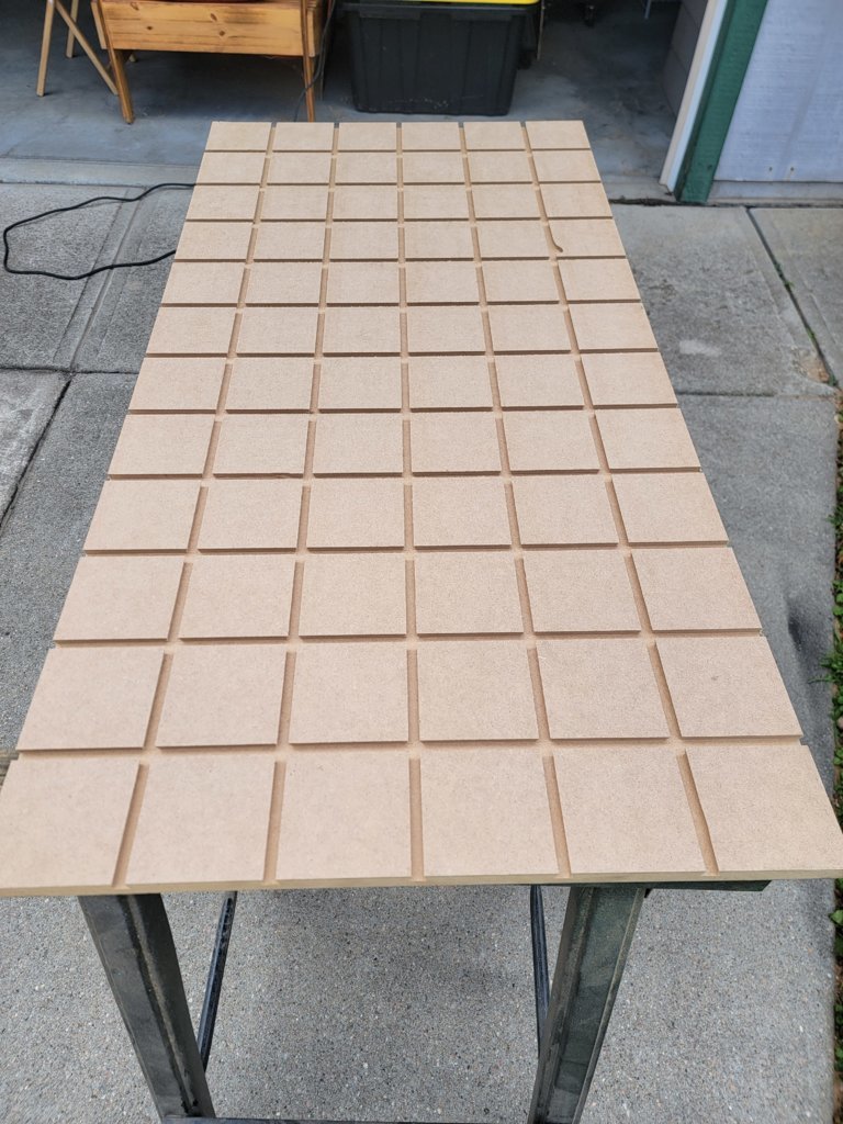

    You wanna talk about messy... how about cutting a dovetail grid in some 3/4 MDF!! Seriously a half of a 5 gallon bucket from the shop vac set up on this one!

    I'm pretty sure I can taste this picture.
