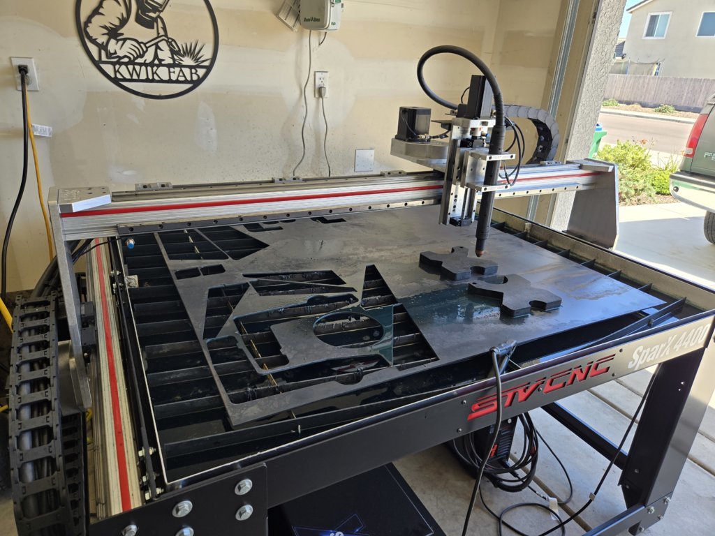

    4 run, 2 don't

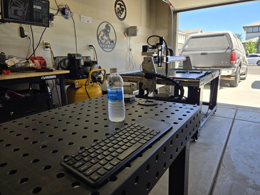

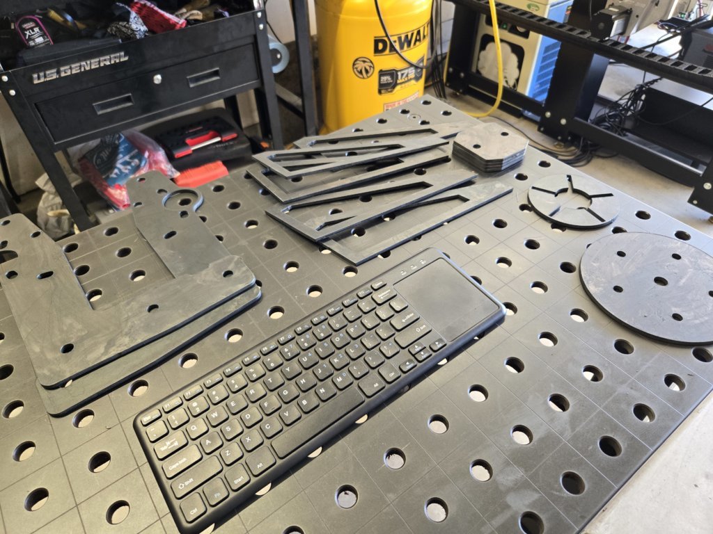

    Have to force myself to stay in my seat while cutting :rofl:
    No need to babysit while cutting like I used to on my other table
    It's also nice having moved to a bigger table since I can leave more steel on it now and not have to swap so often

    If there's any advice I can offer, it's that I'd recommend using 3M Marine Adhesive (5200) for any and all joints and corners on your water bed.
    While I'm not exactly cutting stuff every day, I do keep my water table more than half full at all times. At 60" x 60" and over 2-3" of water height, that's over 40 gallons and that's shared between a two-piece pan held together with bolts and 3M sealant in between.
    Table is still 100% dry and it hasn't leaked at all anywhere underneath. Just make sure to give it a proper 4-7 days to fully cure before filling it up at all. It'll remain tacky for several days, so definitely be patient with it.

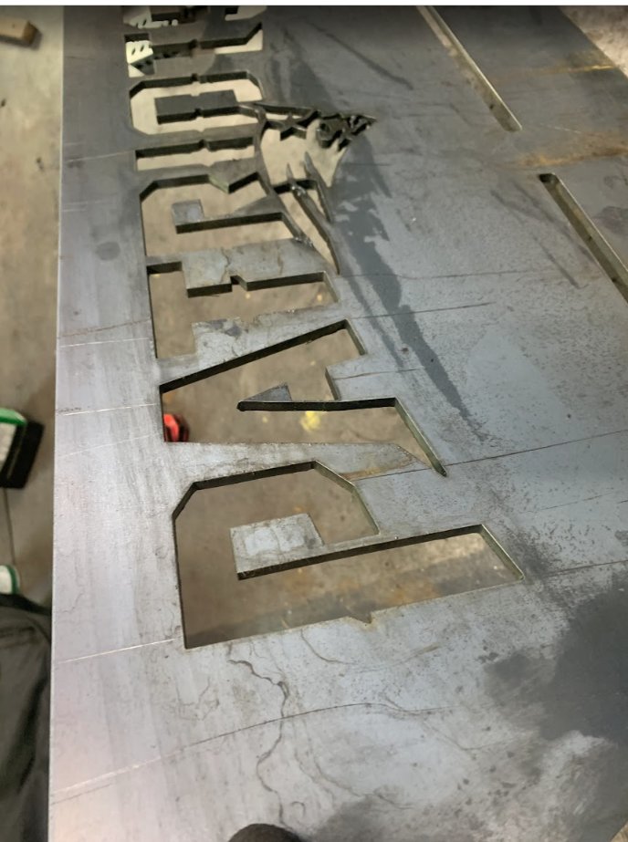

    I am very thankful my job has 2 fiber lasers to cut this. :D

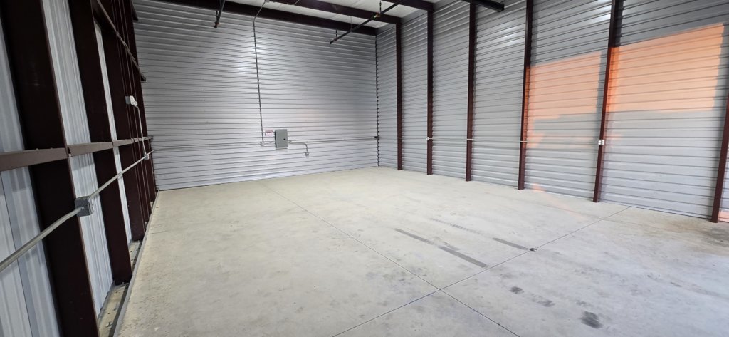

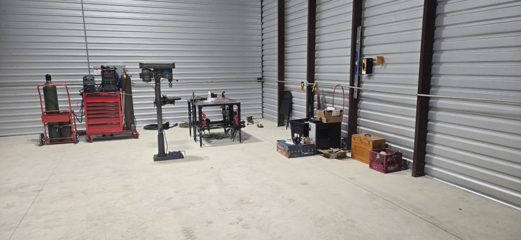

    Took nearly a month, but I started moving into the new shop space this weekend.
    Blank slate..
    The welding equipment, and one of my work benches where some of the first items to get moved. along with the drill press, stuff for the air system, and some misc items that fit in to left over space on the truck. I will need to use the trailer that belong to storage company that runs this site. Hopefully Through out the week I can get the rest of the small tools and random material an supplies moved. this will leave the other tool box, plasma table, lathe, and band saw along with the air compressor to go out on the trailer.
    Then, once everything is moved in, the real work starts on the garage. It will become a licensed food manufacturing plant for my dry rub. clean up all the grinding dust that has settled in the corners, recoat the floor with new epoxy , repaint the walls, and install the 3 bay sink along with the handwash sink.

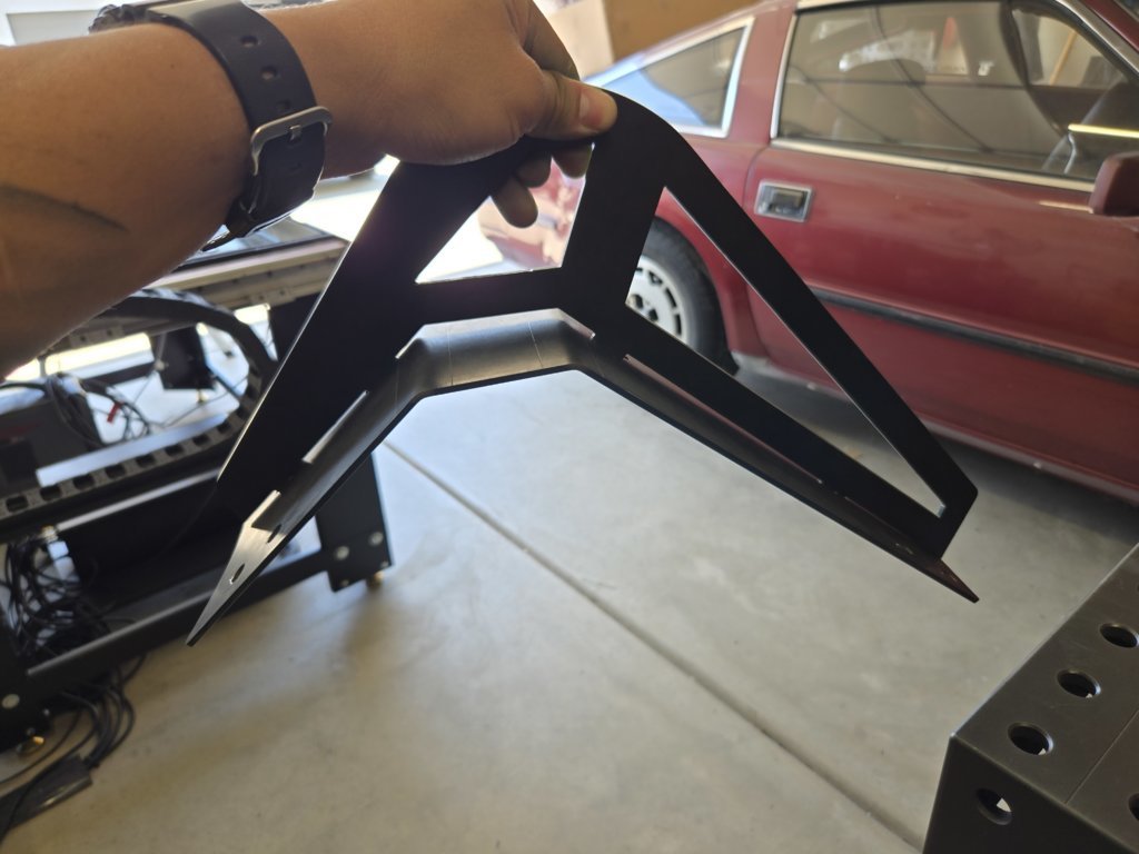

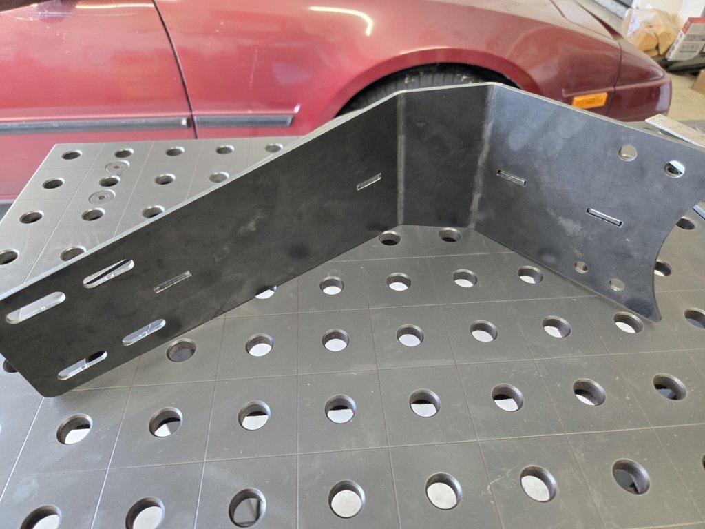

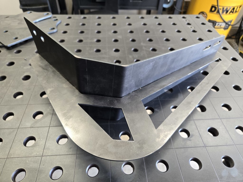

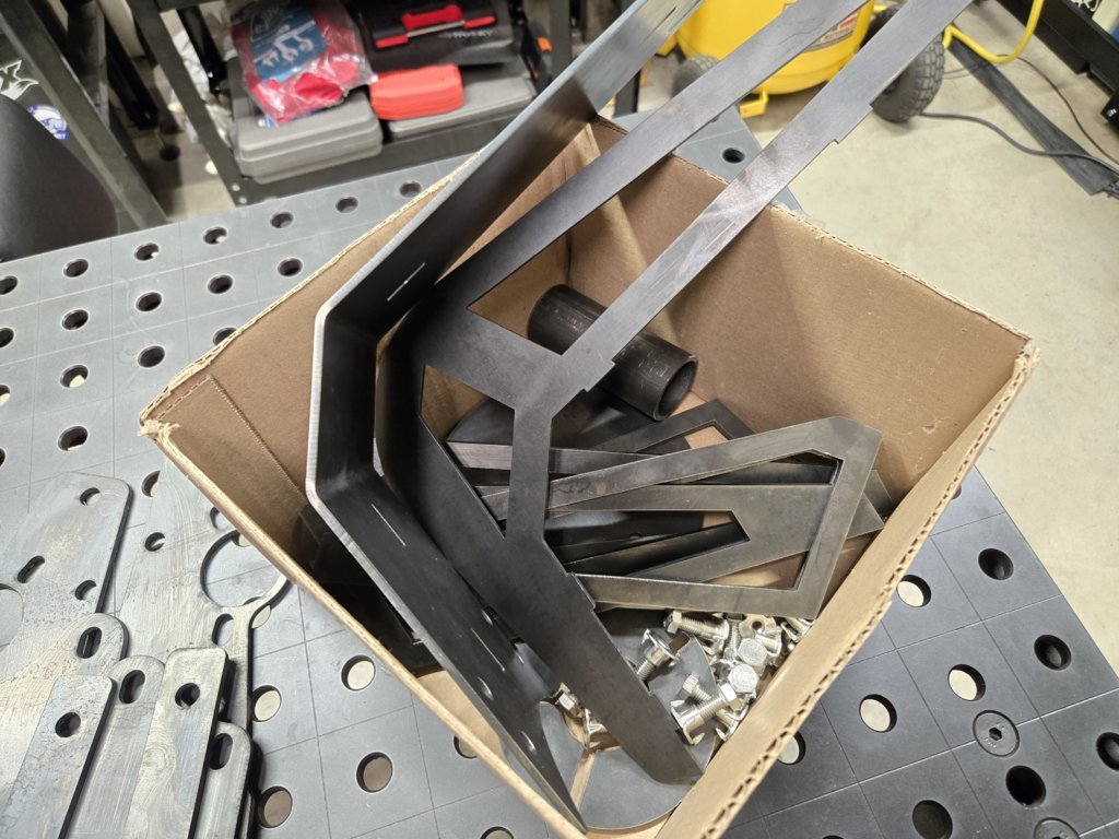

    It's been a little while since I've posted a video, so I shot one real quick cutting a backrest setup from 1/8".
    https://youtu.be/-CIez4PiGOo
    I should really upgrade my press brake setup, not because of capability but more for the ability to use different punches for better clearance.
    It's ok, my design works and my calculations are on point.
    Friend wants to make his own stool, and since we're heading next week to stay at their place a few days, I'm taking as much of a complete kit as I can.
    koditten and Drainbung like this.
