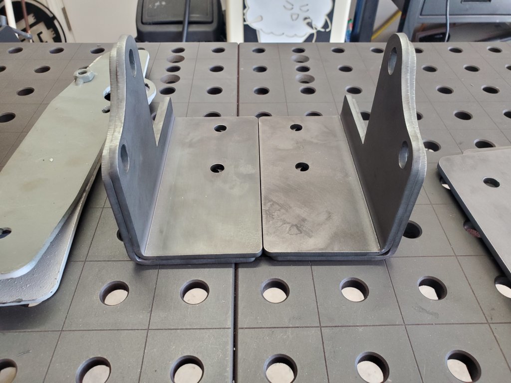

    I finished these if that counts but I am nowhere near a manufacturer. But bending punching and dimpling happened. Soon I will be ready to weld after I run a couple practice beads in a mock environment to decide if I will switch to .030 or stick with the .035 in the machine currently.
    [​IMG]Untitled by MJH Creations, on Flickr
    Really wanting a press brake setup for my press now.

    @Kwikvette can your bender setup bend 12g pretty easily? I remember you showing the setup and the tooling you had but can't remember it now.

    Easily.
    With the 4 way die I can bend up to 3/16" as that's what these stiffeners are -
    Without the die, I could still do 1/4" for the width of 10".
    Which reminds me, you need those mounts!

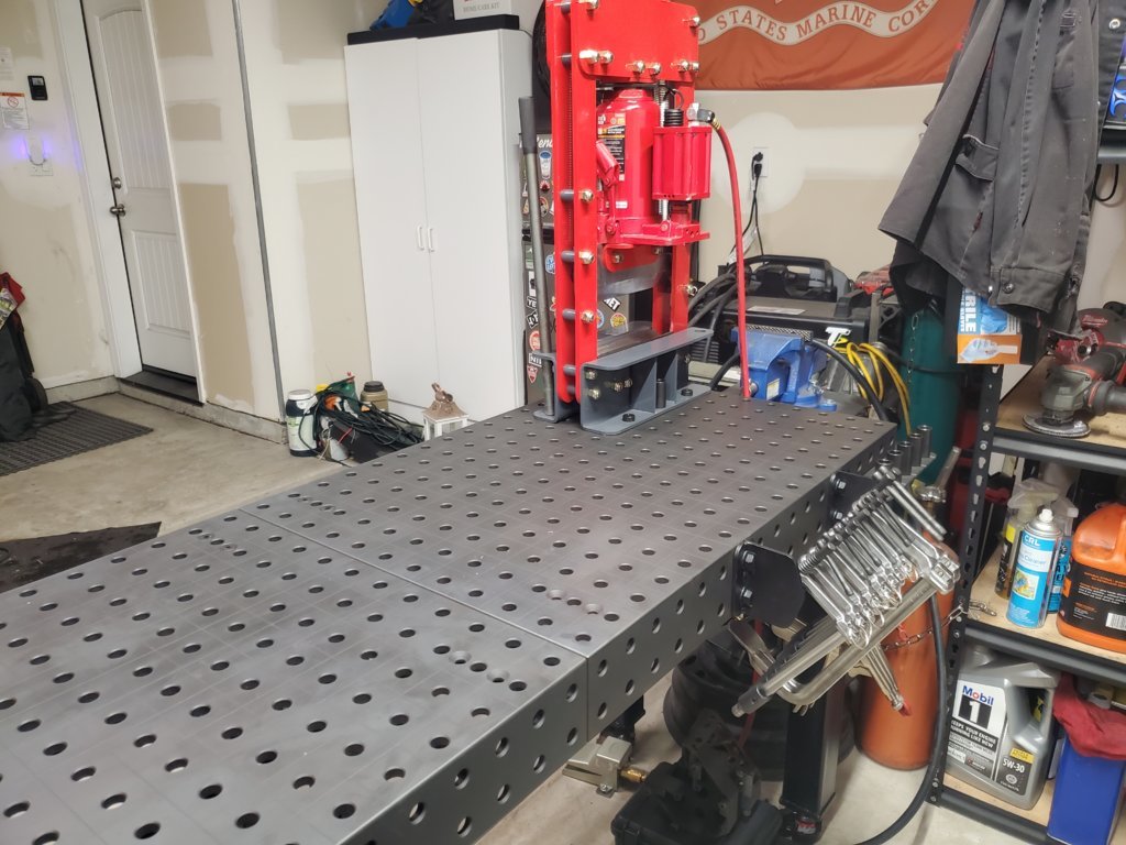

    But if you're going to get a press brake you've got a few options -
    At home, precision work, you can opt for the Langmuir 25T CNC press brake.
    Has a nice working width, uses standard American tooling, and will make repeatability a breeze.
    For a "bolt together" setup you can use a Harbor Freight press, and go with Swag Offroad's Pro brake kit. They offer it with tooling and without, and best of all, is also meant for American tooling.
    However, the bottom die holder not only accepts the 1/2" tang used on such tooling but opens up to over 5" so you can use a 2-way, 4-way, or any custom bottom block you choose.
    And the cheapest would be a Harbor Freight press, or DIY, and getting one of Swag Offroads weld it yourself kits.
    Below that, you've got plenty of cheap options on Ebay that are made similarly like the one Swag sells.

    And then there's the option I went with, which is the Trick Tool's Bend Press.
    It has a far less working width than any Swag 20 ton kit. Cheaper than their Pro, but more expensive than their weld it kits, it offers far nicer bends since it uses nicer tooling.
    But opting for their Pro will net you a wider working width as well as the option to use nice tooling so you'll easily get quality bends you couldn't get on their cheaper models.
    Since I've got a small space, and I don't require bending large parts (at the moment), the Bend Press is perfect for me.
