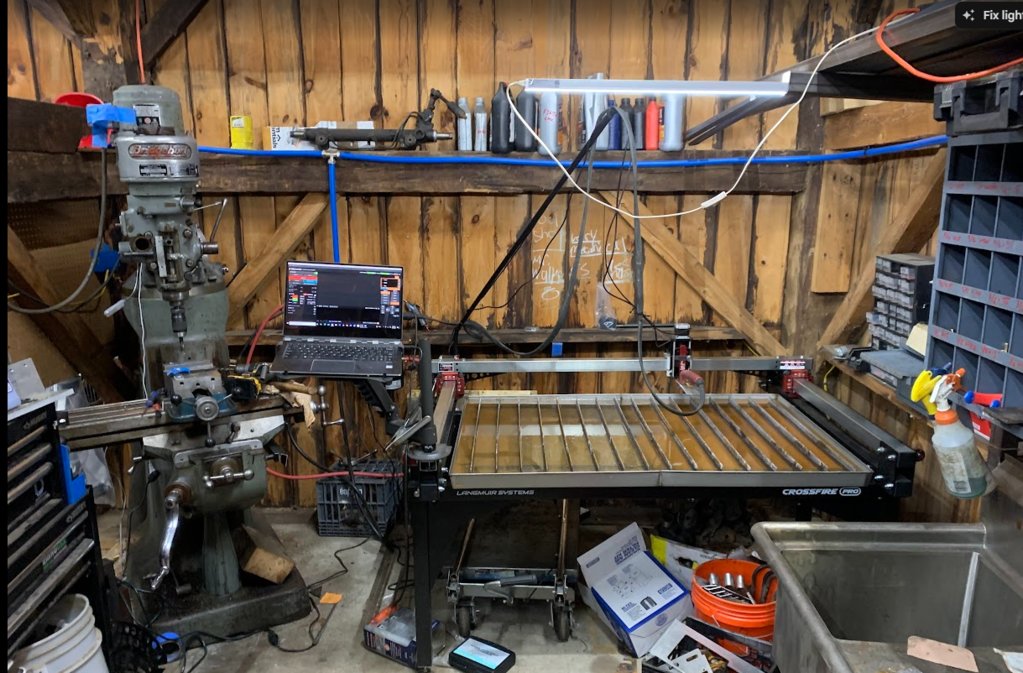

    I fixed it in 10 minute with a cable lug....
    Yeah looking to pick up another cutter so I dont haver to disconnect this one from the table. Its really a pita

    While I'm normally a proponent to the "2 is 1 and 1 is none...", there should be no reason why it's a pain to disconnect your plasma cutter from the table.
    I have no idea how you wired things up, but when I used to run my PrimeWeld CUT60, I did find myself cutting both on and off the table. Having a machine torch allows one to leave a torch dedicated to the table, while having access to a hand torch off the table. And the cables to the VIM and table controller? Just disconnect them as it's just 2 or 3 total plugs (if you got THC).
    I used to cut a lot of stuff down off the table, specifically for some trailer repairs or cutting down large sheets to smaller pieces.

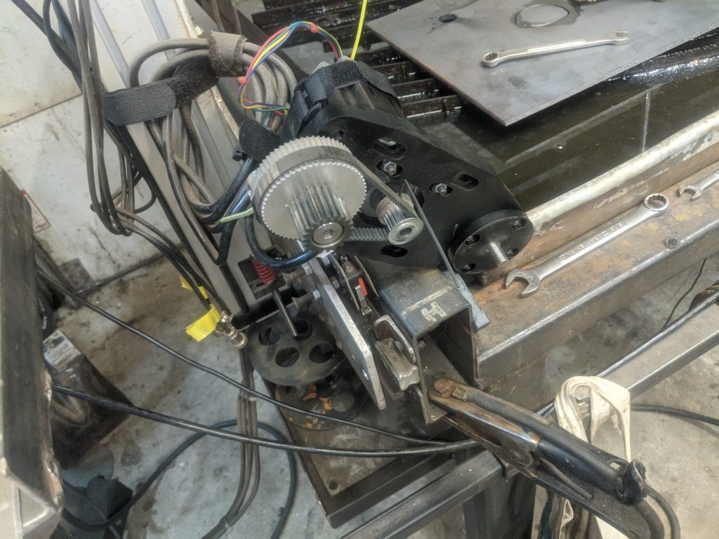

    I lost a set screw on one of my steppers today.
    The circles get a little squinty when one stepper has left the chat.
    Fortunately I caught it early. Only fucked up one bracket.

    Its just cause I have to disconnect evverything while cramped between the bridgeport and the table. Setup isnt even close to dialed in yet. Booked too much side work to make shop improvements

    Ahh I hadn't considered placement, makes sense.
    Had my plasma cutter next to the table for the longest time until I threw it underneath. I'd just roll that fucker out, disconnect some plugs and the torch and it was ready to go.

    Open heart surgery on the table.

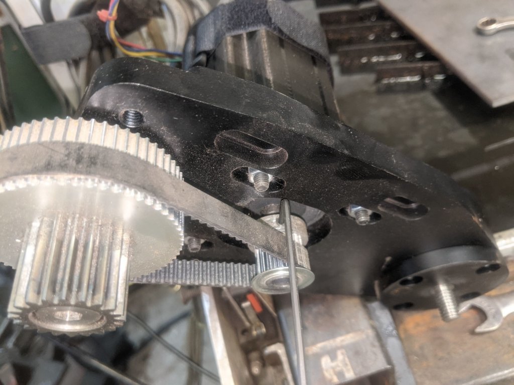

    Of course you have to remove the entire drive top gain access to those screws.

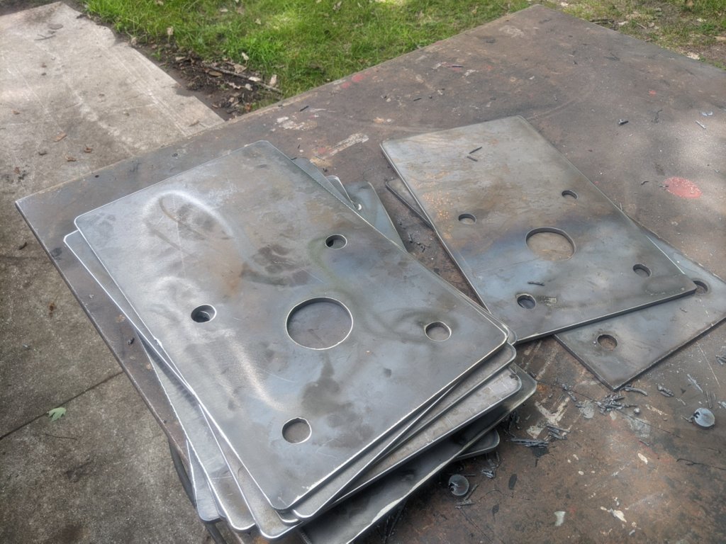

    Job is done. Off to the fab shop to get bent.
    The 2 on the right were rejects.
    The loose set screws made the left side of the gantry lag That stepper and gear drive was just going along for a ride. The gantry is stiff enough that the right stepper and gear drive was carrying the entire thing.

    Shame you're not around - I'd charge you $5/bend to bend all those at 90 degrees.

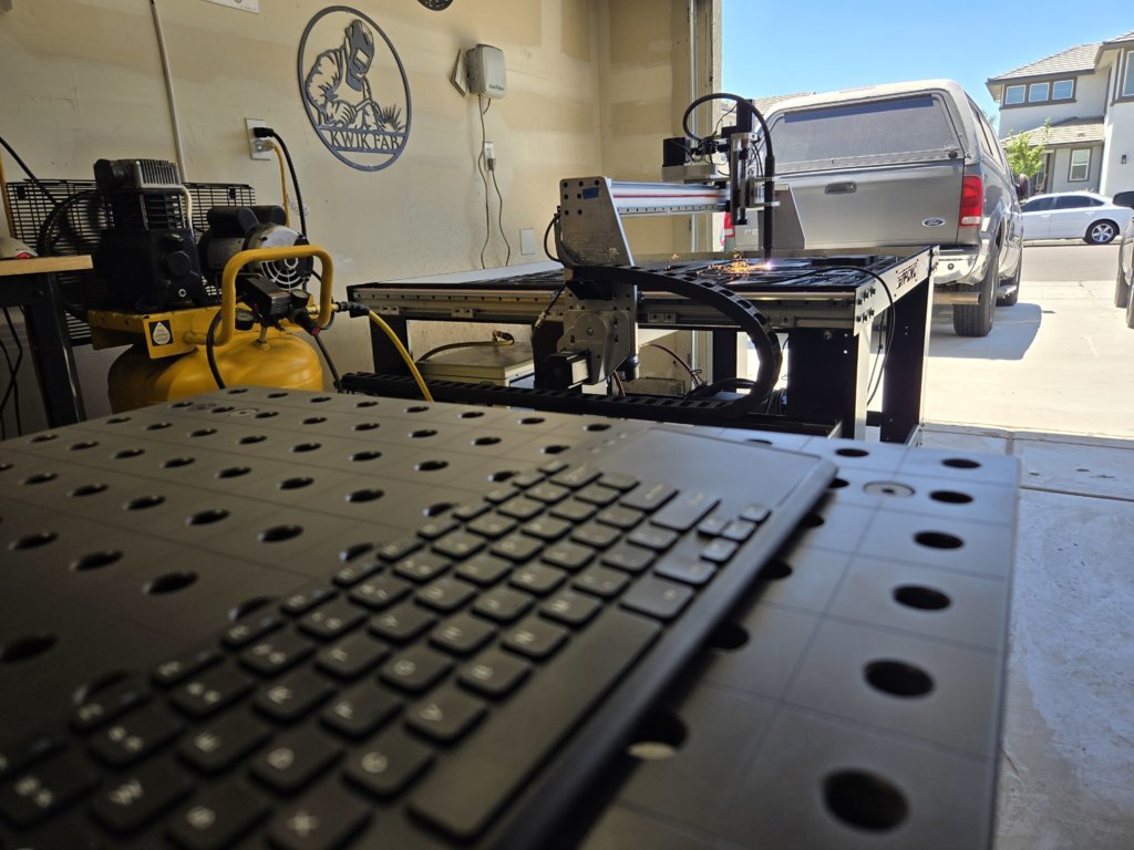

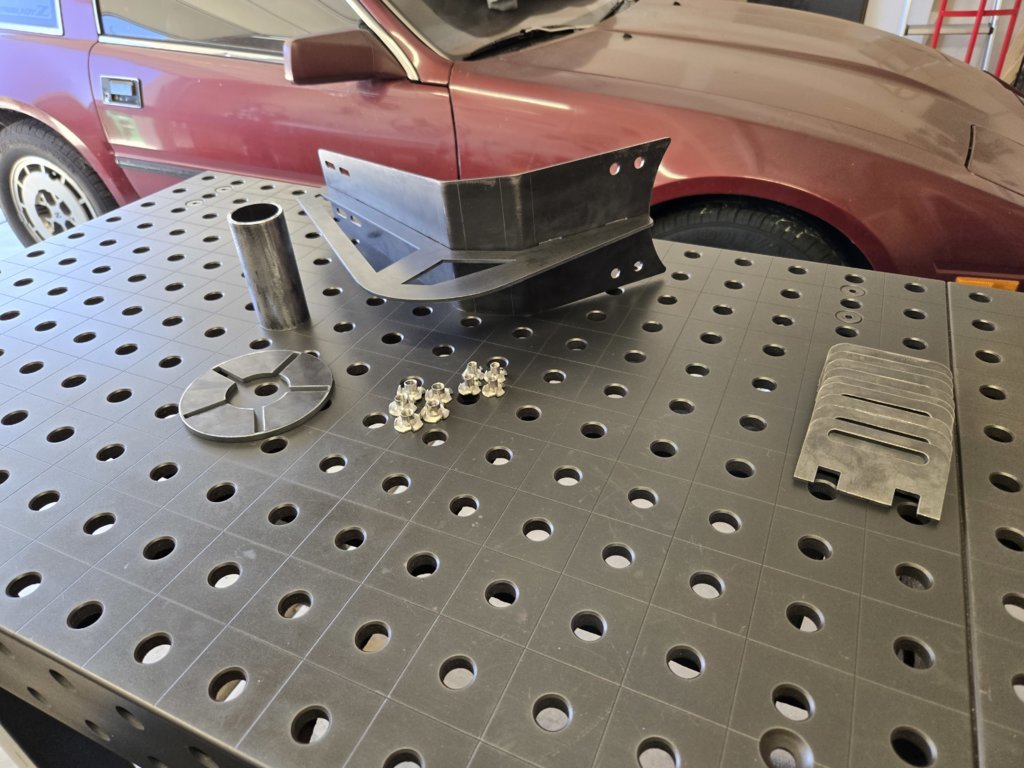

    Still got a bunch of steel left over so trying to kill it.
    Cut 10 motorbike chain tensioner brackets, along with cutting and bending another backrest
    I'm pretty much all out of 3/16" so I'll have to wait until a big order comes in before buying more
    Once I do, I'll cut a set of legs out for the stool and have most of the parts to weld together the assembly
