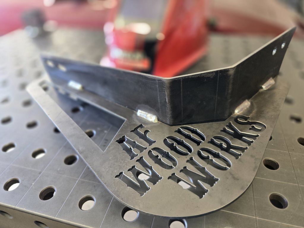

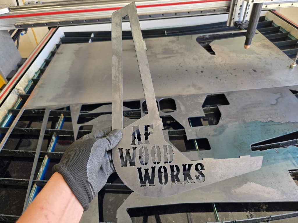

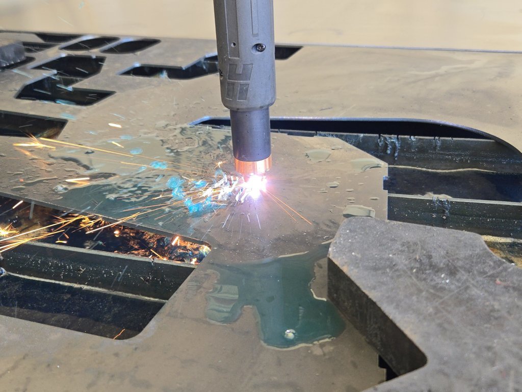

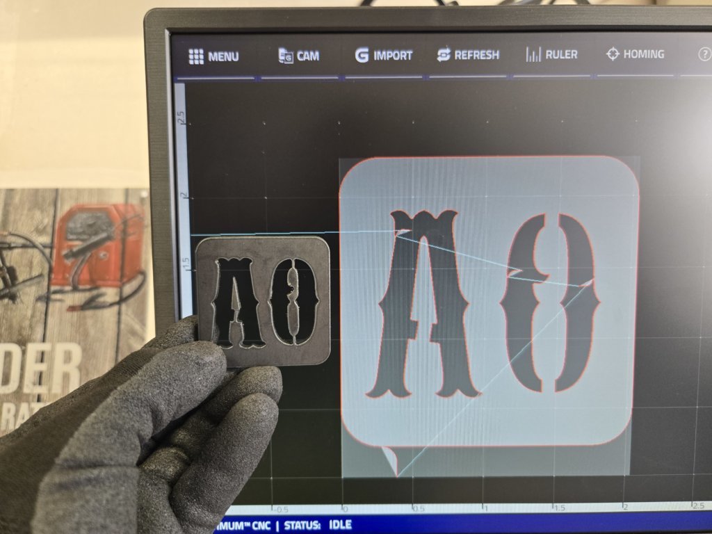

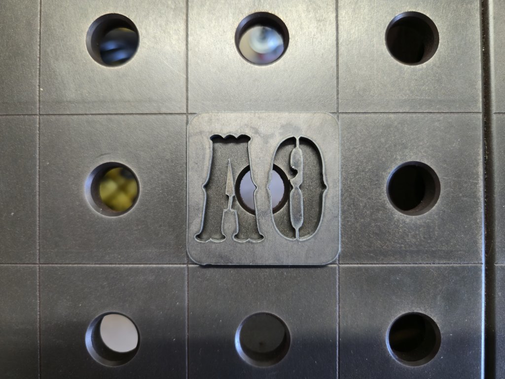

    Confirmed a request last night for stool and since I had most of the parts already done, I thought I'd make it a custom setup.
    Since I'm not a sign maker, or bother with design work, I like to do test cuts (as well as emphasizing to others to do the same).
    I pick what I consider to be the most difficult letters, and cut them out in a small square.
    Perfect!
    Letters are almost 1.5" tall with bridges as thin as 0.0625.
    Onto the custom spine.
    https://youtu.be/mmW2YN6T_nU?si=VQ8v1a88u4KAai4z
    I'd say it came out pretty good!
    And she's all done for now.
    My swatches are coming in this week which will allow me to show others a few custom leather choices I think would look great.
