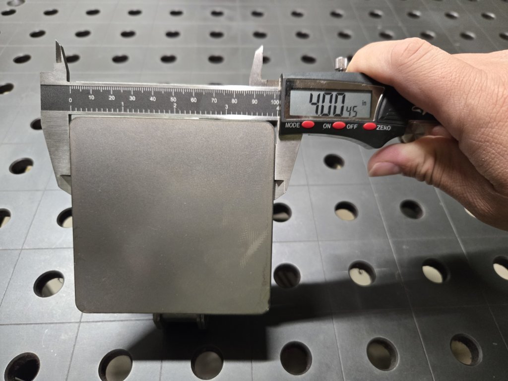

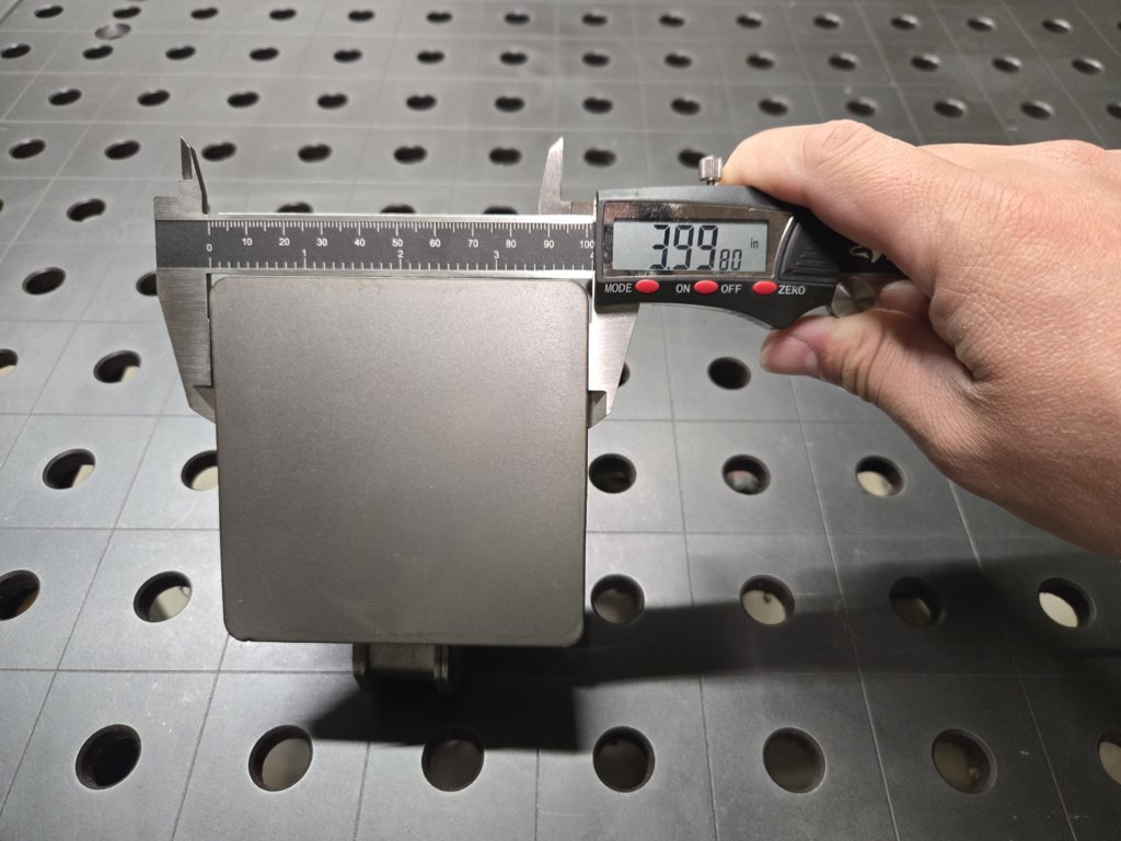

    I won't post up the cutting and welding I did most of the day yesterday, but I did have a big OOPs
    At one point, I backed into my CNC table's motor that was sticking out (as in me, walking into it)
    Fire it up to jog it all the way back only for the motor on the other gantry to catch my welding cart I had out
    This threw it out of alignment pretty bad on the Y axis
    Did a quick automatic home, performed a test cut, and it is within 0.0095 on the two worst sides
    I would mostly attribute the difference to the slight beveling since it's 16 gauge that I did a quick test cut for
    I did a 4" x 4" just because it was really bugging me that I had knocked it out of alignment in the first place

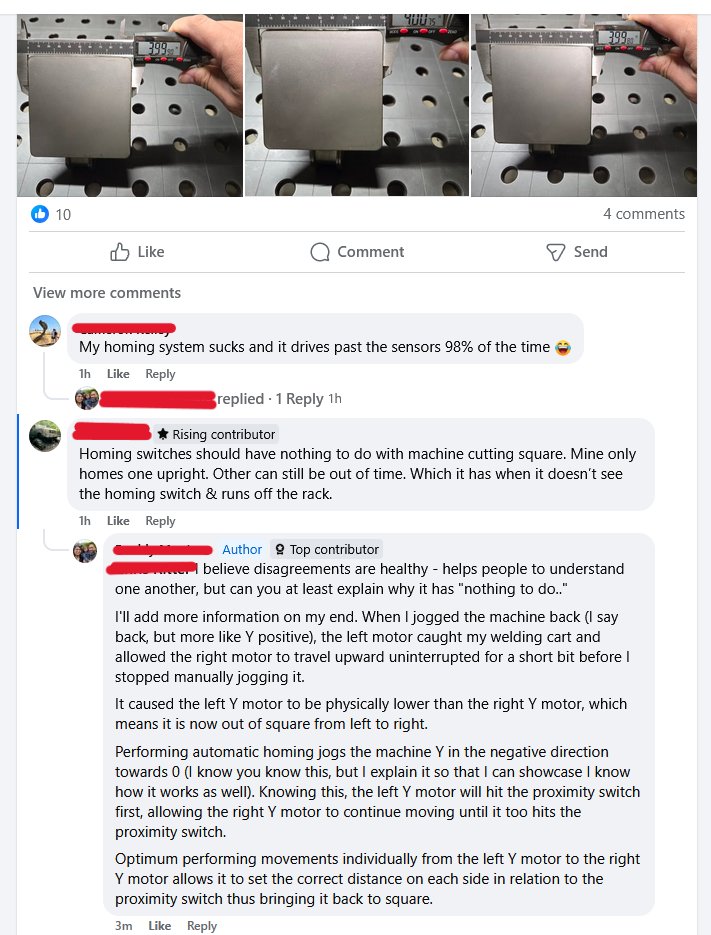

    God damn, not only the physical pain aspect but just having the table 'tear itself apart' really hurts.
    It's why even in the middle of the job, I set aside a few minutes to draw out, cut, and measure a square to confirm that my machine had squared itself.
    It's funny though because I had posted about it on Facebook STV, just to say something positive about the table since we all know forums/groups are typically meant to help resolve issues.
    I wanted to just post something positive about my table.

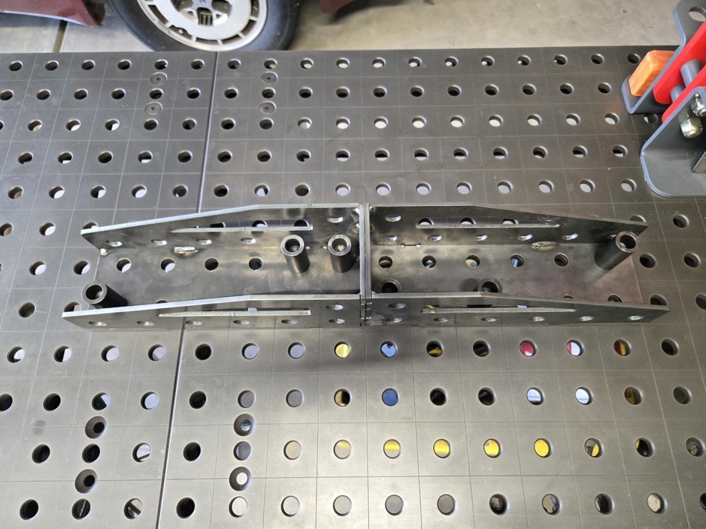

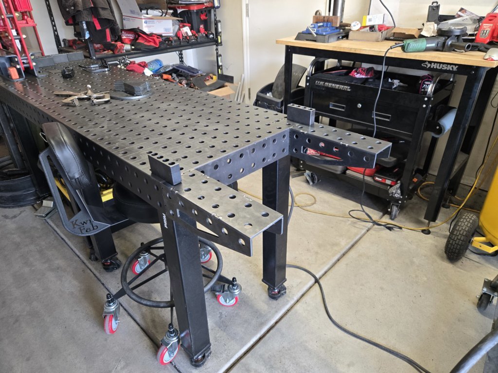

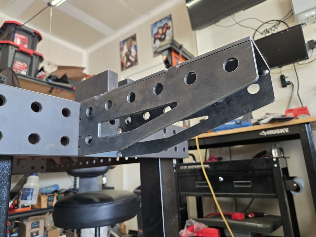

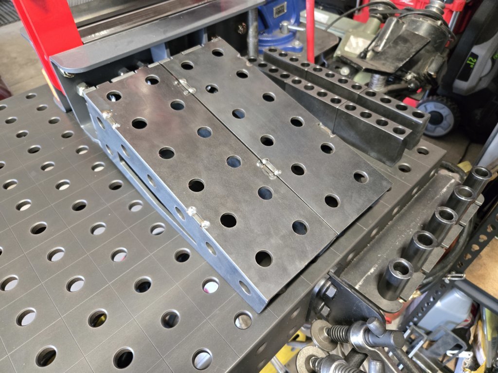

    This table just runs.
    Had cut myself the beginnings of a table extension for my fab table. I've always thought they were cool, but never considered them since I normally use a pipejack for any overhang. With a recent large frame I'm welding up, I figured it's about time I make myself a set.
    First part fit perfect right on my table, no clean up.
    Followed up with the remaining parts and got her all cut and welded up yesterday.
    But as the saying goes, two is one and one is none so I cut and welded up another one today.
    Even though these will never be used side by side, as the answer to that would be a wide setup, I wanted to ensure they were even with one another.
    And they're done!
    Other shops sell these but I'm too poor to afford them at +$120/each.
    Not perfect, but definitely more than good enough!
    In order to use them, I do have 4 ball lock pins on the way. The blocks seen above were just to ensure that my parts were accurate and true as far as hole spacing goes, as well as being level with the fixture table.

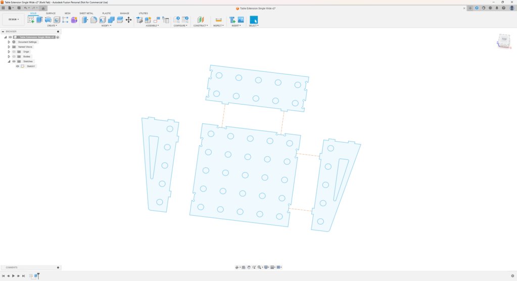

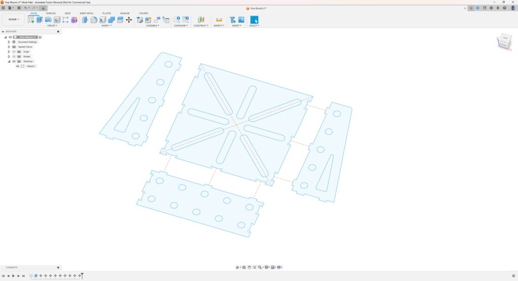

    Been out of the garage the last 2 days, so it's been weird not cutting or welding stuff as I usually take care of stuff on weekends.
    So instead, I shot a quick video for the group showing them how to use the pattern and mirror function in Fusion 360.
    https://youtu.be/CzPSLyD0ejA

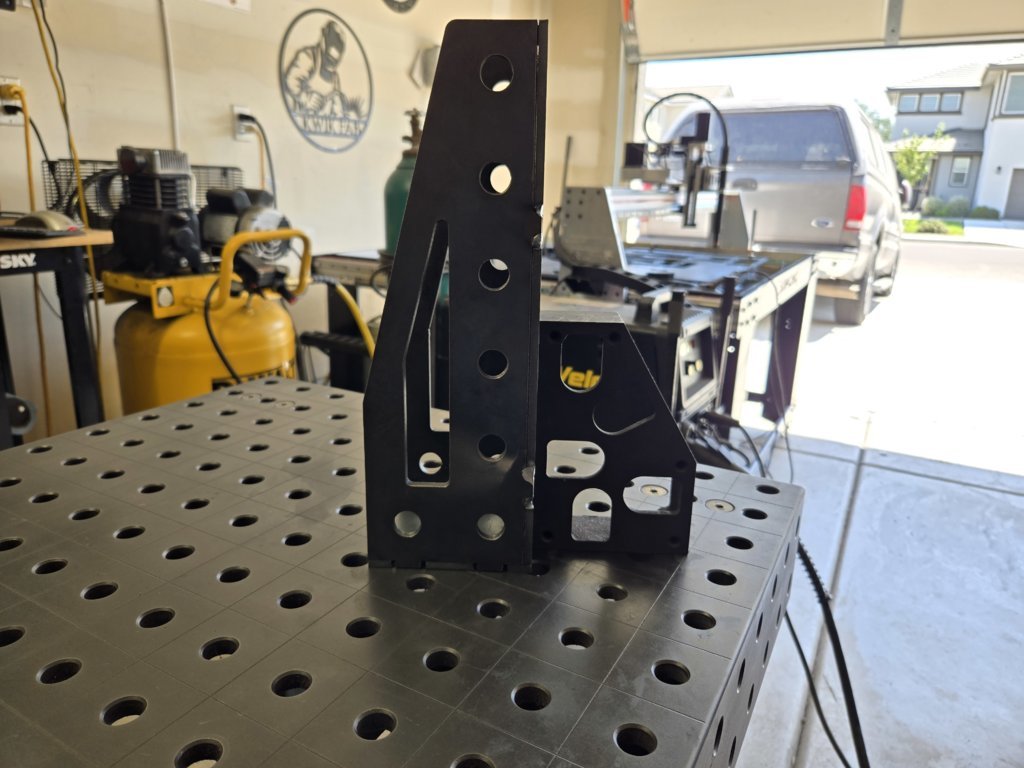

    Right after I posted that, I thought maybe it'd be cool to make a small vise mount.
    I may never actually cut it out but it's cool to have. I may instead just make a single wider extension for situations where the two narrower versions won't work.

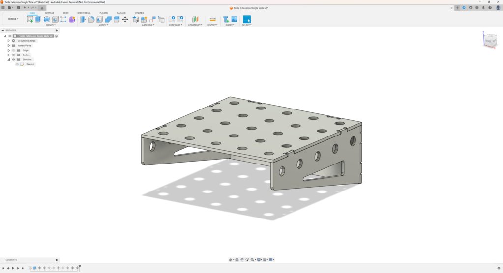

    This would be much more beneficial; may just cut and weld up a single one of these.

    I would have cheated and just made 1 cell, extrude, mirror, then copied and joined the 2 pair, then you would have all 4 cells joined as 1.
    I'm not good at vids, so explaining is the best I can do.
