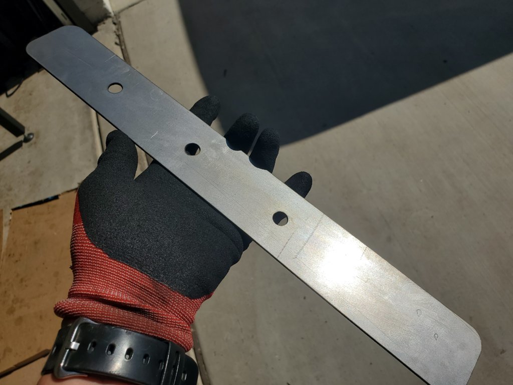

    For us poors that have to scribe their shit for bending.

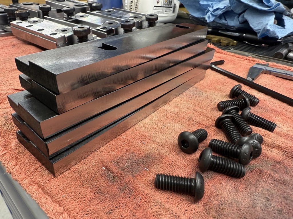

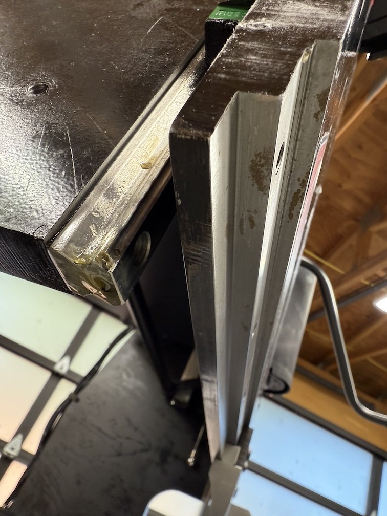

    The underside of my ram is not super flat. They didn't even machine the entire rough-cut part! (that lowest surface is the datum surface for the ram height - what is supposed to contact the punches) If I had a big enough mill I would contemplate taking this thing off and cleaning it up. Sheesh.
    But a funny (not funny?) thing - it's also short compared to the clamping bars - so the clamps were actually supporting the punches, not the ram. So I lopped .006 off them and now they're all flat with in a few 10th's. Certainly flatter than anything on the machine. Lol.
    And with that, I am ready to resume some "kwikvetting." Lots of small squares of metal with sharpie notes to follow!

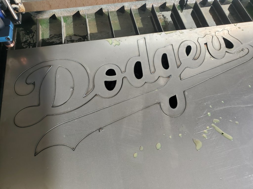

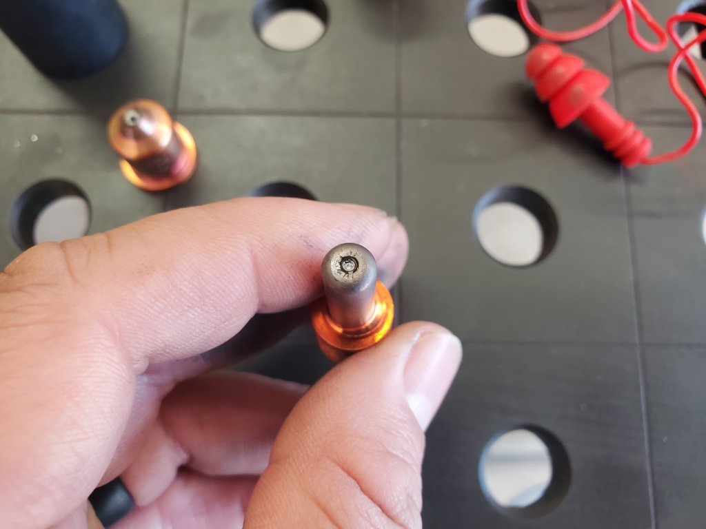

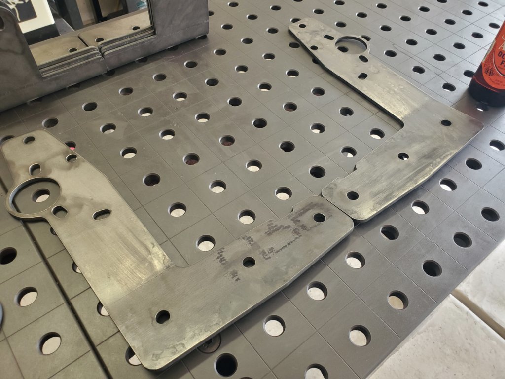

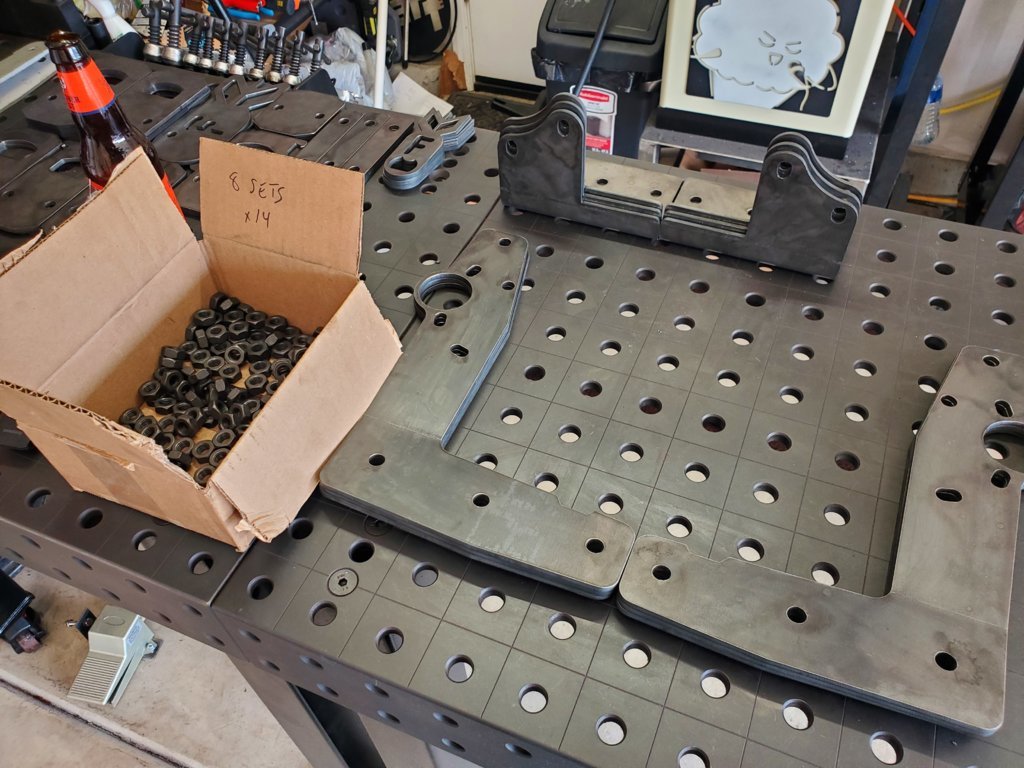

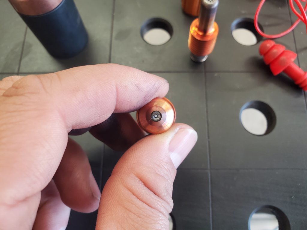

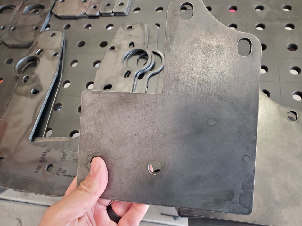

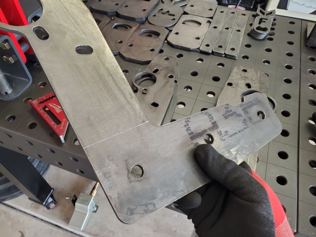

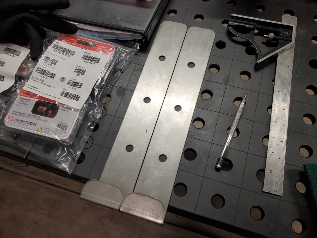

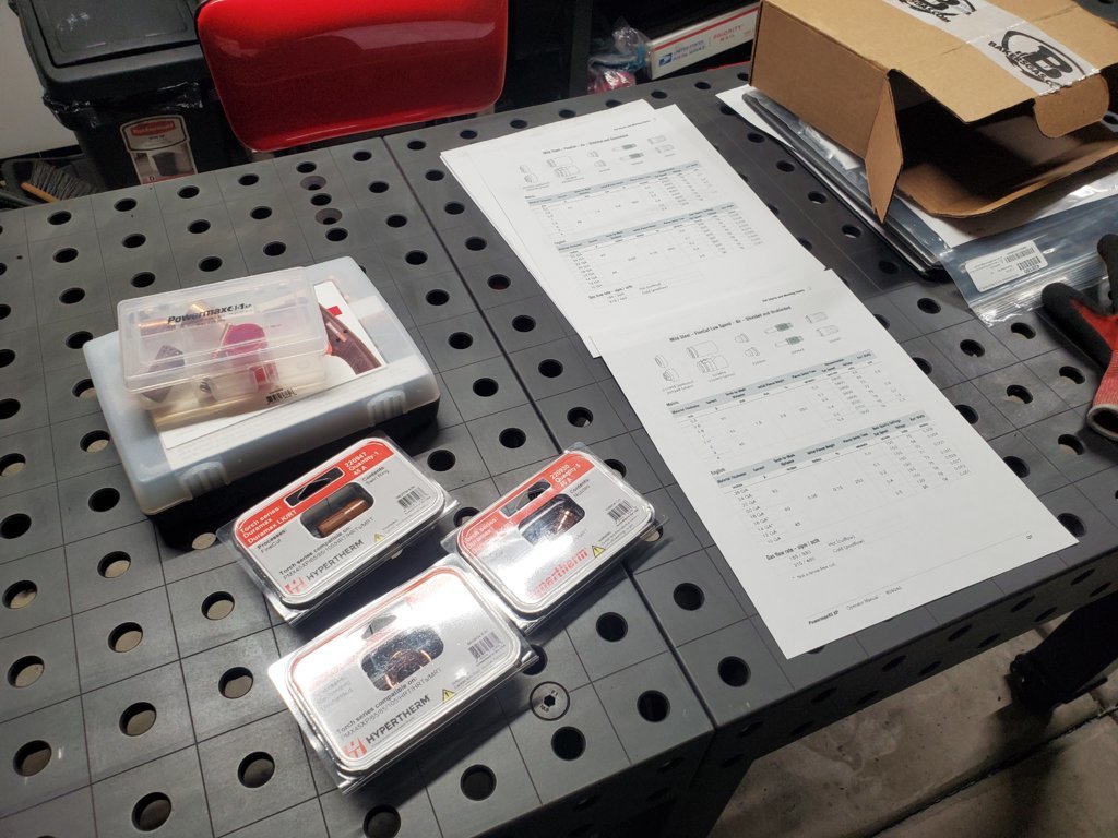

    Tried my hand at finecut consumables for the first time, I am impressed!
    With Hypertherm having different charts for their Finecut on mild steel, I went against what I normally do and just used my friend's amp setting of 32 amps.
    The kerf is so freaking small, and those outside edges remained pretty damn sharp because of it.
    Had to cut these small hangers too, and I have to say I'm impressed by the amount of dross (or lack thereof) right off the table.
    Topside -
    Underside -
    As far as running finecut, I opted to run a new retaining cap as well in order to keep my regular consumables together like a "cartridge".
    Over 700 pierces too!
    I'm not really hoping for, but rather, expecting to get +1,000 pierces per set on my regular consumables.

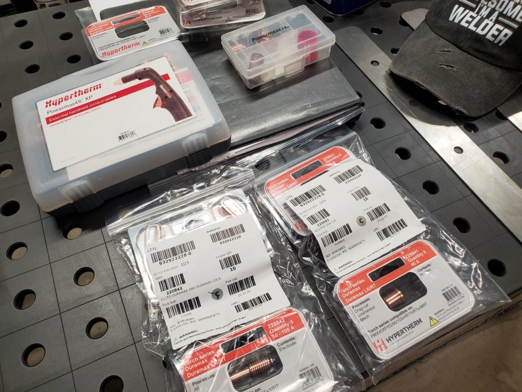

    And lastly, soon as I got done cutting, UPS dropped off my package!
    10 electrodes and 10 nozzles all as part of "warranty" after the 2 month ordeal with all the time and metal wasted trying to troubleshoot my table.
    I'm set for at least another 6+ months.

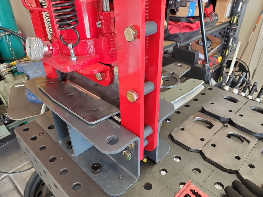

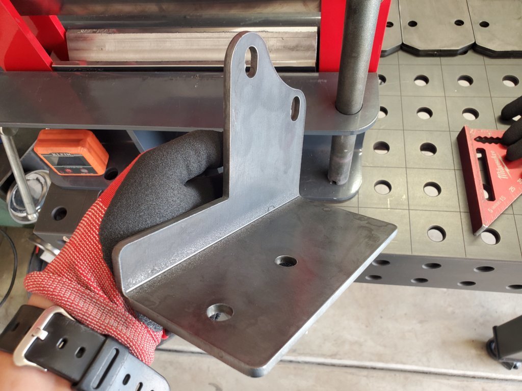

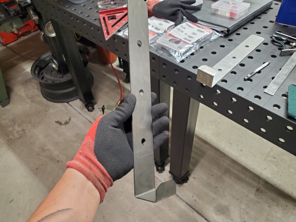

    And, incorporated a little bit of bending too.
    @ERod27 needed something to hold up his "stuff" whatever that means; maybe code for sex toys :notsure:
    Zebinator and ERod27 like this.

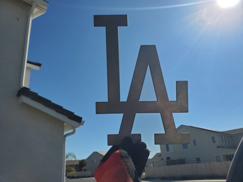

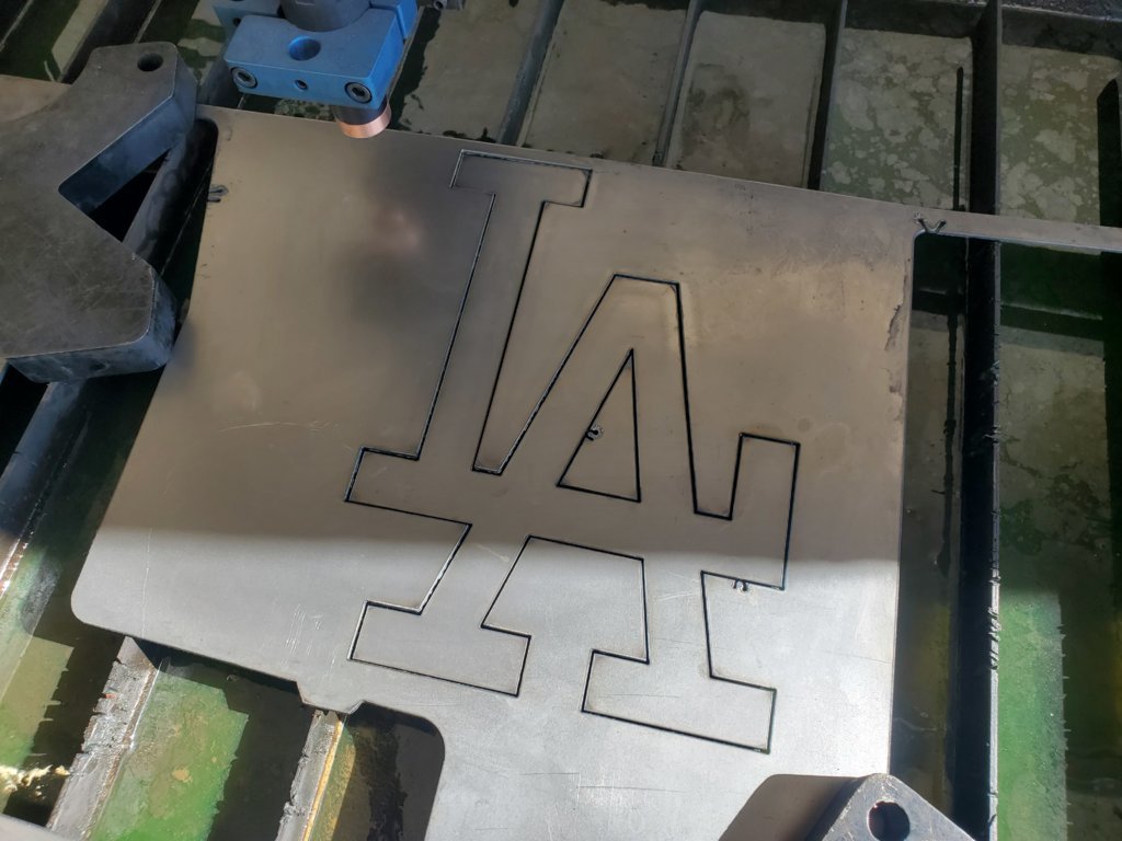

    Fired up the air compressor once more; wife's car needed air in her tires so I figured why not cut a customer's order today :anonymous:
    Top one is 18" tall, bottom one is 30" wide.

    Ha, I did!
    My mom came by to visit on Saturday so she hung out with the wife most of the day. Well, she saw me cutting some stuff up and said "ooooh can you make me a Yankees sign" :rofl:
    So I'll have to make her one cause she's a diehard fan, even if they're getting killed in the World Series.
    The Dodgers signs are for a repeat customer that I normally make low rider bike parts for.
    As for those finecut, oh man you're gonna love them.
    If you look closely at the edges, you'll see my steel isn't discolored! With non-finecut, or even the UPM-105 when I ran the PrimeWeld, you'd see a lot more of that along the cut path due to the heat and speed.
    Here, the only real heat applied is at the corners.
