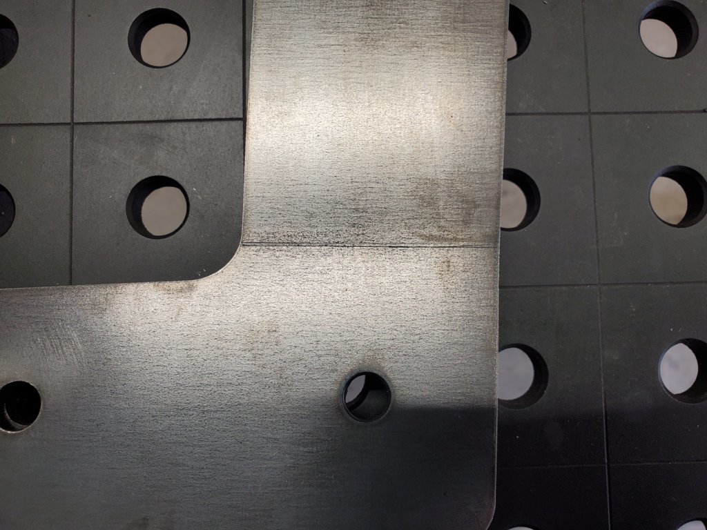

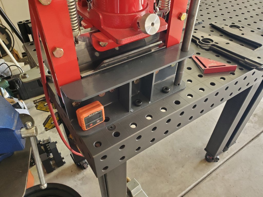

    I didn't want to weld it up, or even bolt it. But here's how it used to be.

    Drop bracket lift and booger welds

    Yep, see below.

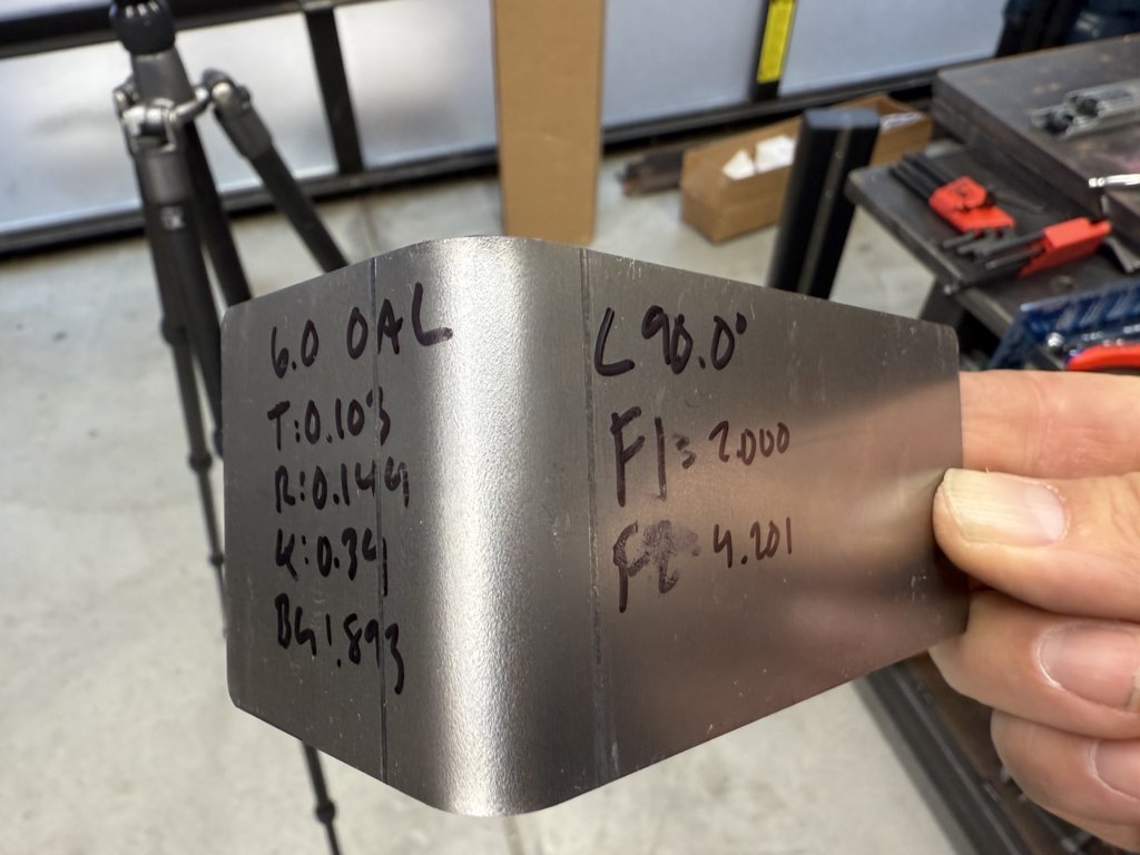

    Well it only took 5 tries to get here after I sorted the ram height. I’m not sure Langmuir has figured out the best process exactly.
    I started with stock variables out of fusion for 12 ga steel, except thickness. Trying to make a 90* with a 2” flange.
    K factor .44, back gage set to 1.910, bend radius of T (.104) was a bit off. 2.020” flange and 88*.
    But using a little overbend, send cut send’s k factor (.34), and a measured bend radius (.144), I got the flange dead on! 2.000.
    Now to try across the grain.

    Man, that .02" would've been good enough for me as long as I made whatever hole or slot on the flange big enough for that tolerance :rofl:
    That's badass.

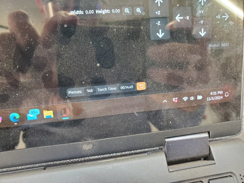

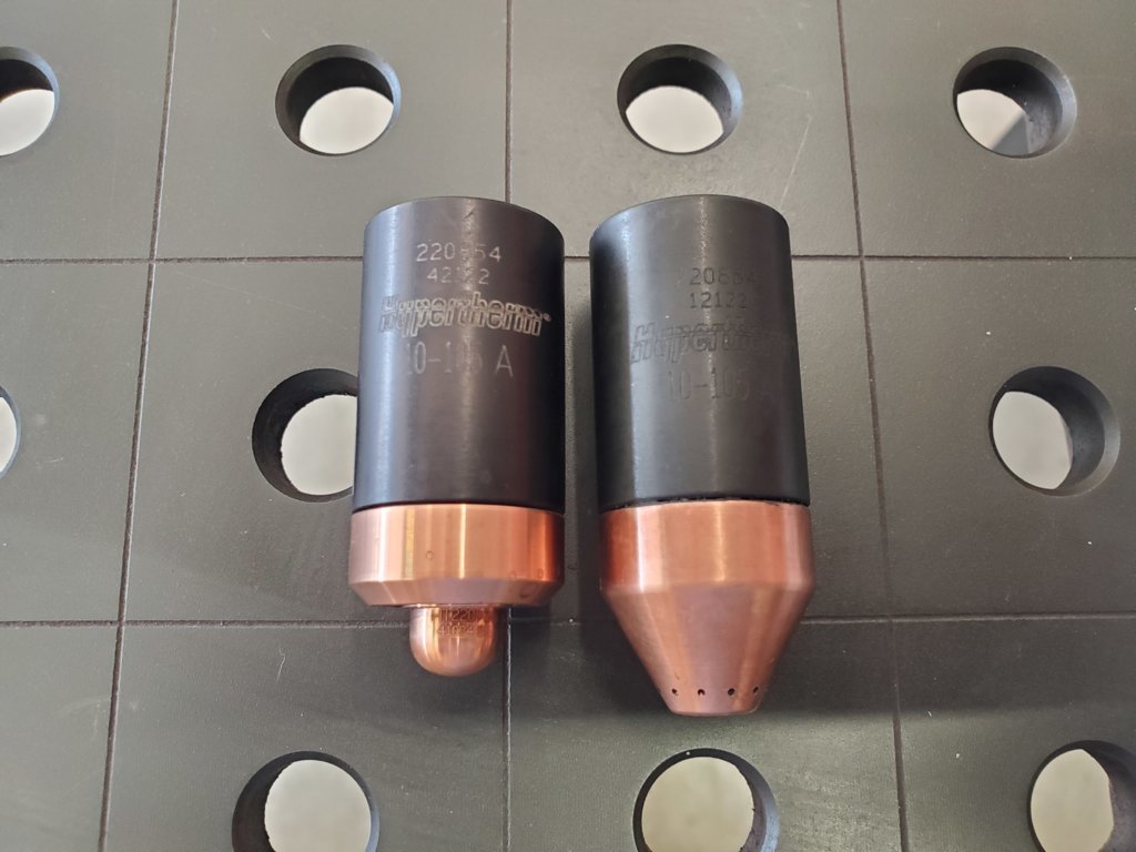

    @zippsub9

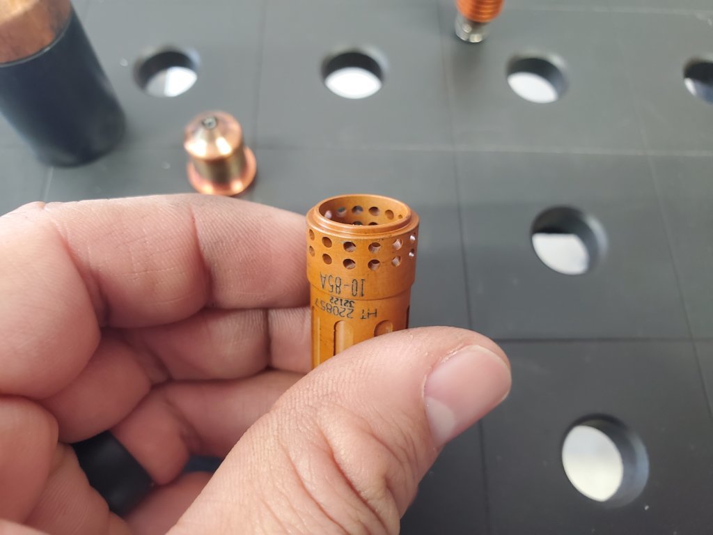

    Since I don't have the Sync system, this is how I keep my "cartridges" separated.
    Retaining caps and electrodes are the same between both, but the left side uses the finecut swirl ring, finecut deflector, and finecut nozzle.
    Right side using mechanized shielded deflector, standard swirl ring, and standard nozzle.
    Easier to keep track of pierce count now instead of just swapping the nozzle, swirl ring, and deflector.
    30 on the left set, 840 on the right set.

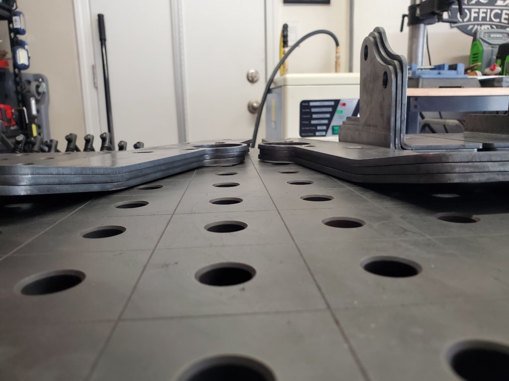

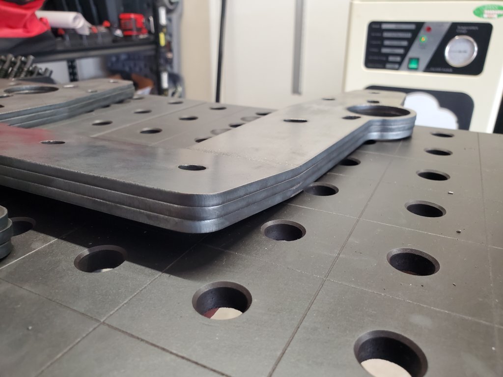

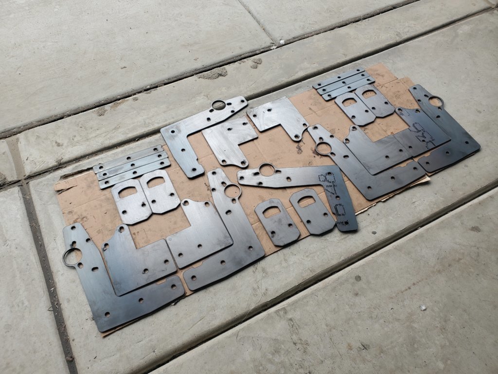

    And also, the difference in cut quality on 16 gauge.
    150ipm, 32 amps, 110psi to the machine with finecut consumables -
    150ipm, 35 amps, 110psi to the machine with regular consumables -
    I did perform a cut on a much larger piece at the book setting of 240ipm, but I wrapped it up already. No pics.

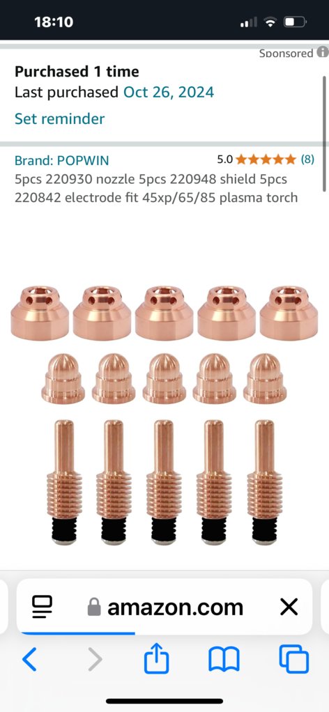

    What brand did you go with?
    My friend sent me some Chinese variants she uses on her Hypertherm 45XP and says they do well. Just a bit short on consumable life but for the cost, she doesn't mind replacing them often.
    Sometimes they'll run her 150 pierces, and other times 400 pierces.
    zippsub9[QUOTED] likes this.

    Not sure if they keep the same name on Amazon or advertise from multiple companies. But not bad for $40.

    Shit bolted onto other shit, and junk.
    Stupid question, but what is the easiest way you found to keep pierce count? I kind of wish Langmuir would add a counter onto there Fireware program.

    4 run, 2 don't

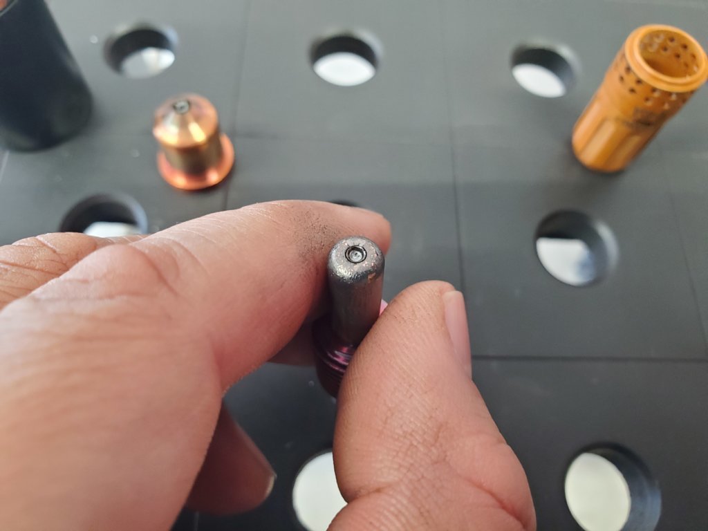

    Firecontrol does, this is how I determined I had 840. I pulled them at 700 pierces, and reset the timer when I put in the finecut set.
    Then I pulled off the finecut, put these back on, and reset the timer again just adding the new count to the old count.
    Also, I understand wanting to use cheaper consumables (at least from the get go) but the biggest difference with cheap vs brand name, your orifice won't burn out as quickly meaning your cuts will have the same edge quality from start to finish.
    Again, just cut these today and they're only 160 away from 1,000 pierces.

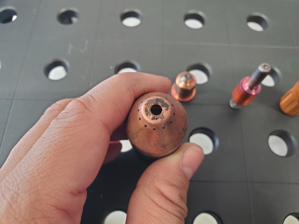

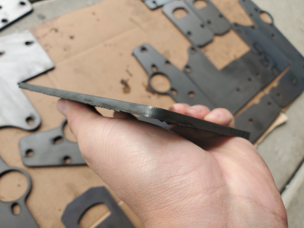

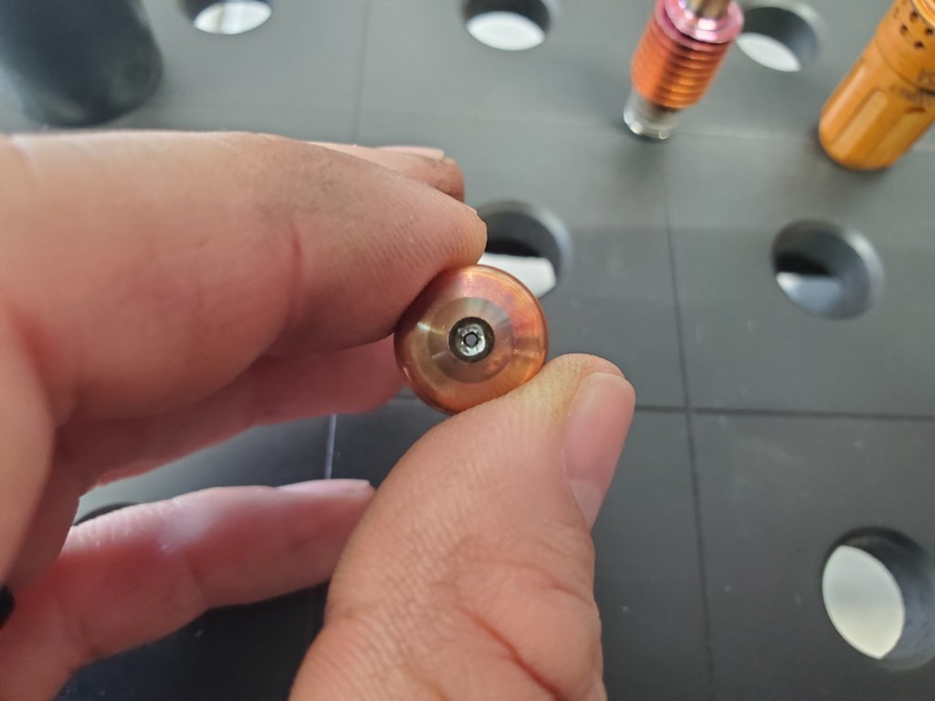

    @zippsub9
    Now at 978 pierces and check out the edge quality still.
    And the consumables themselves.
    It's fair to say, I'll change them out at 1,000. Another 100 pierces or so won't hurt but that'll be the average pierce count I'll expect.
