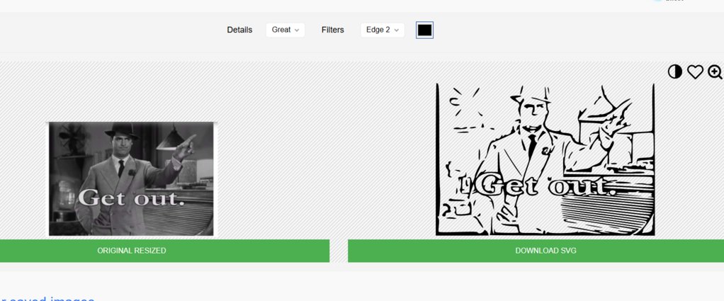

    Free SVG converter was the name of the program.
    I just did this one to see how well it could do a rendition..

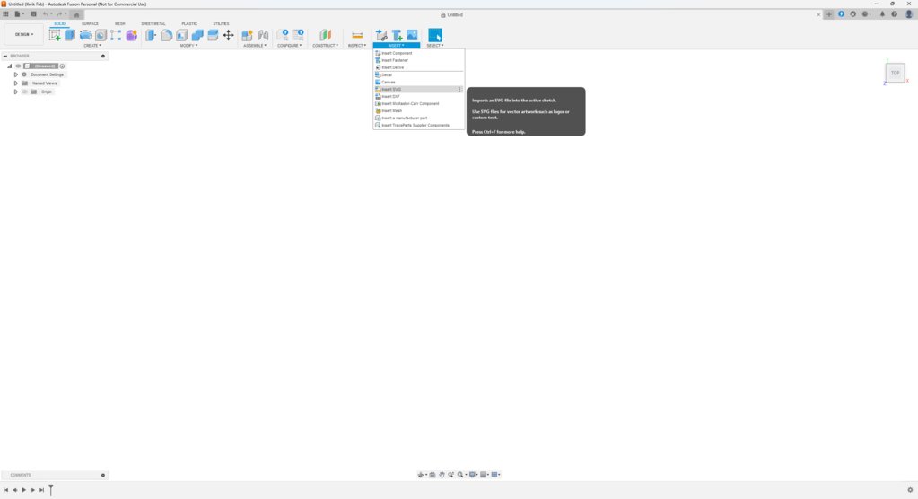

    Just insert it -
    It can be done in a new or pre-existing drawing.

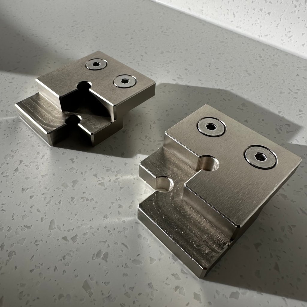

    An attachment for the fingers on your brake allowing you to square up your work material.

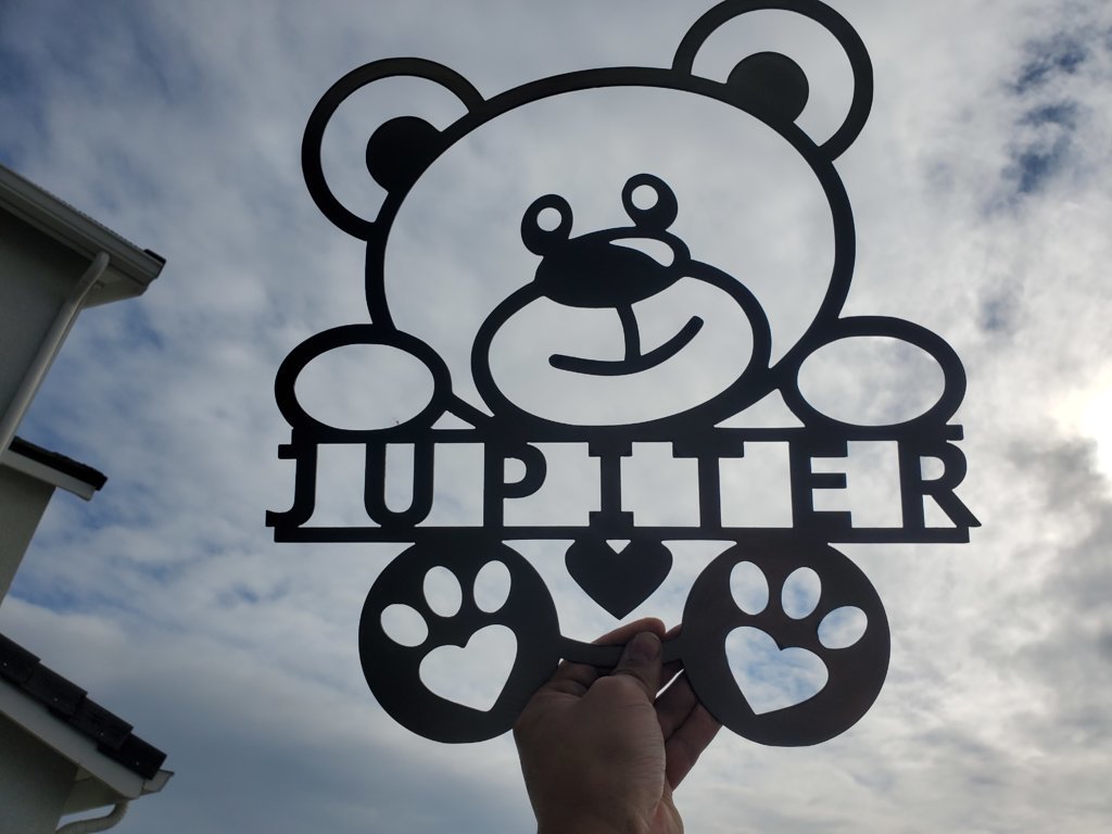

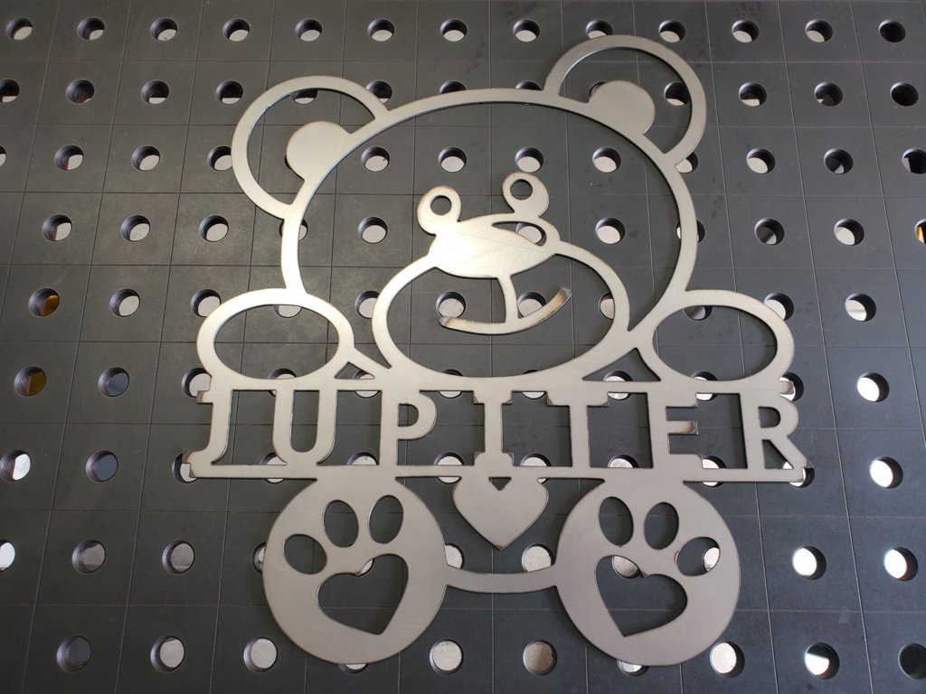

    For the last 2 months I've been cutting a lot of parts, so much that I had to completely clean out my table all over again :bananadead:
    Had to do a rush job because what was supposed to be us going to visit my family, my mom, brother, and his fiancé are coming over to visit us.
    They're expecting their first kid (my first niece) so I wanted to make something they can put up in the nursery. They're going for a bear theme.
    I'm hoping they like it.

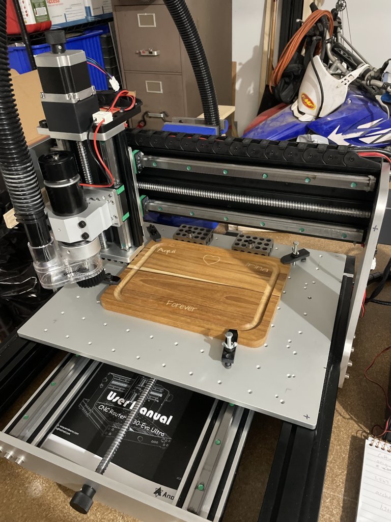

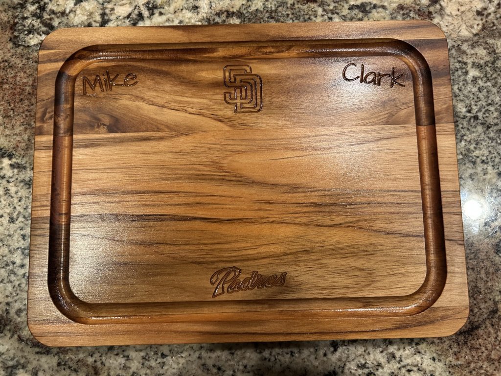

    My wife bought me a tabletop CNC mill for early Xmas gift, so I engraved a bunch of cutting boards as presents for others. I can also replace the spindle with laser engraver / cutter. I am hoping it will machine aluminum cleanly, haven't tried it yet.

    It is an AnoleX 4030 Evo Ultra. 400mm x 300mm cutting area. I also bought several upgrades that haven't been installed (bigger closed loop motors and upgraded spindle, + Laser head that can be mounted in place of the spindle, also has 4th axis capability which I have not bought yet). I chose this due to dovetail linear rails on all three axis, most have rods instead of rails. That said it is still a little lighter duty than I wanted. So, I already told my wife it will be a struggle for me to make things on the machine vs. make the machine better by making new side plates, endplates, etc. It runs GRBL control system which I am finding out is pretty limited. No extra I/O and pretty limited Gcode commands.
    My desire was to set it up with an automatic tool changer and be able to run it unattended. Currently that does not look possible. So long term I will likely try to use this to make a stronger machine with a different control system that can do automatic tool changes and leave this as a laser machine.
    I was previously an Automation Engineer working on machines and robotic systems, mechanical design and programming and had a Bridgeport mill with Prototrak 2 axis CNC system. Was pretty cool. I have many years on SolidWorks, but so far really struggling to find CAM software I like (without spending hundreds or thousands).
