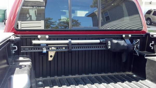

    I know ATO and Relentless make nice Hi-lift jack mounts for the bed rail. Is there anything else new out there?
    I am a slightly concerned about where the the lower part of both the ATO and Relentless bracket rests against the bed. After zillions of miles vibrating from gravel roads do they wear into the composite bed material?
    Both ATO and Relentless look good to me.
    I also saw these on ebay, but have not seen them discussed here:
    http://www.ebay.com/itm/TOYOTA-TACO...EM-HI-LIFT-REESE-FARM-JACK-PLUS-/150840412114
    Anything else I should look at?
    Post some pics of your Hi-lift mount!

    You could look into getting some cloth pads to stick to it. Like the kind you use on the bottom of chairs and tables to not scratch hardwood flooring.

    I believe ATO offers an option in which they cross drill the bolt that goes through the jack. You can then put a lock through the bolt.
    Damage to the bed where the ATO mount rests was a concern of mine. Take a piece of rubber tubing, slit it down the middle and put it on the bottom of the bracket. It will fit great and protect the bed. I only have a 1000miles on mine but no visible wear.

    I did the same thing on my ATO hi lift mounts, some black 5/16" fuel line split down the middle with a few drops of gorilla glue to hold it on there :D
    No issues with any gouges or any wear. More than 3000 miles on this set up
