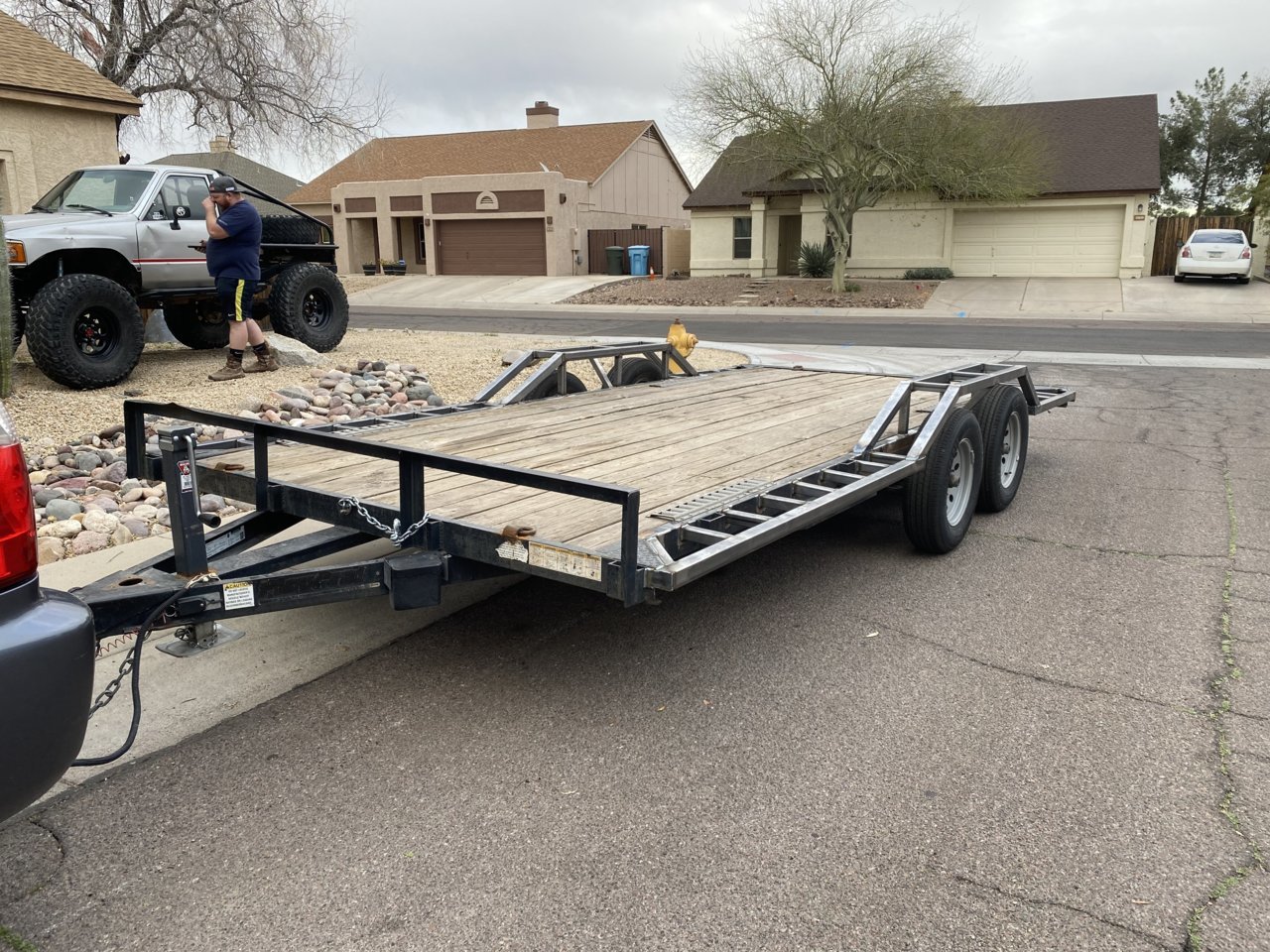

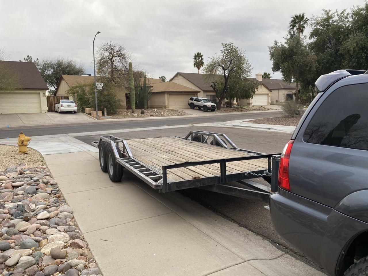

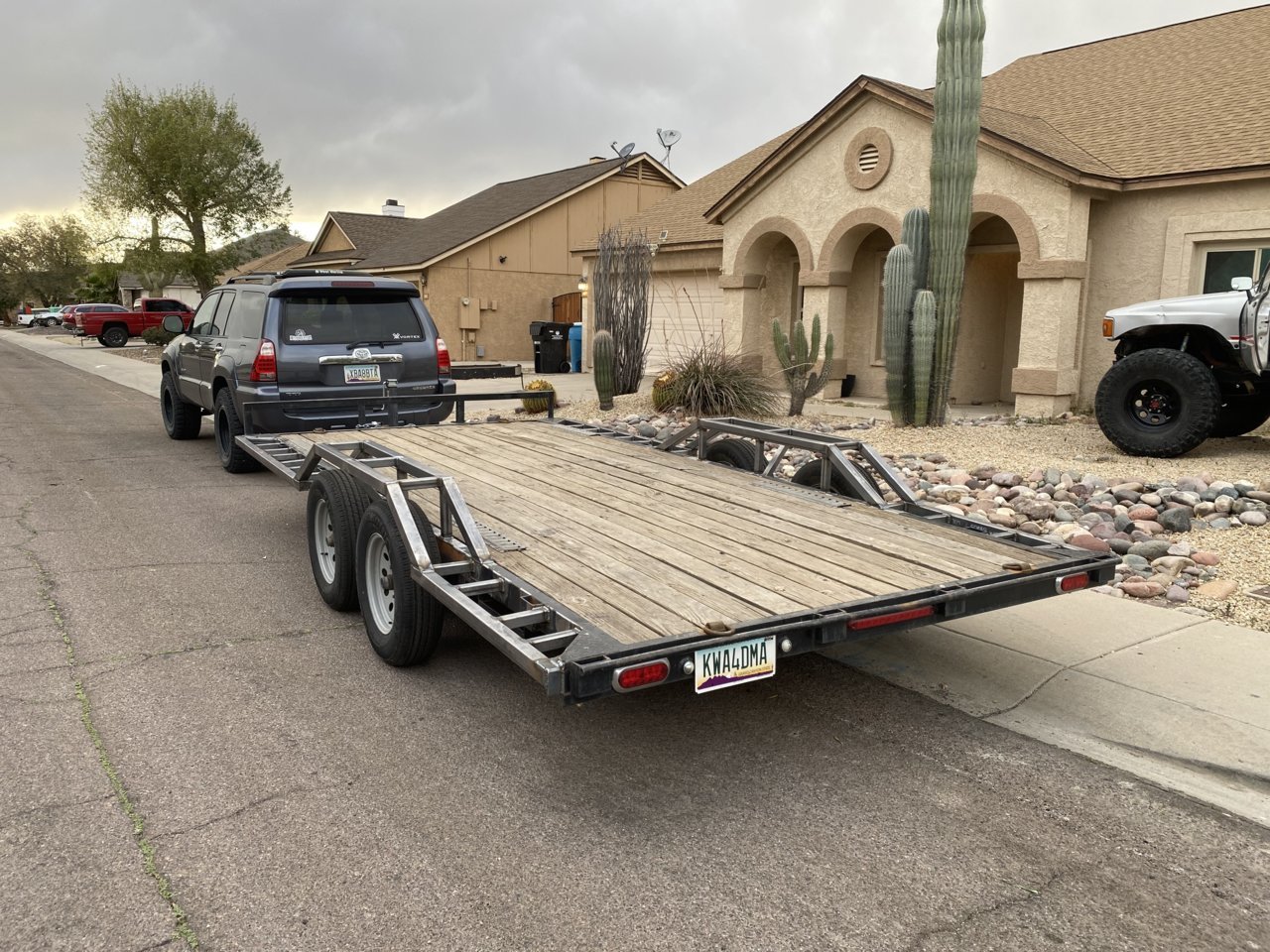

    Widened my personal flatbed trailer over the past two day and built drive over fenders. Actually took more work/time than I was thinking it would. Roughly 54 square tubes and 6 tube caps. Fenders will get plated with diamond plate in the future and the rest left open so I can still have access to my stake pockets 75F1CE4B-00B6-47B7-B1D8-323560974648.jpg6354A59B-6BBA-4700-9535-20937EC8E4B4.jpg24FE2935-269B-4D0A-A5C7-969A489E268D.jpg

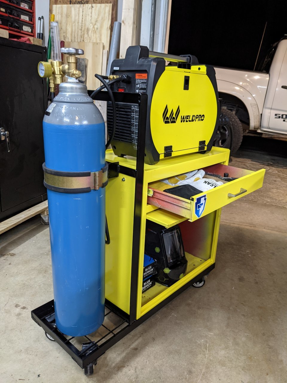

    Haha thanks man. Yeah, this cart will definitely help lugging around gear. Milk crates full of fittings, pipe, sand bags, apple boxes, etc...
    haha I imagine a super low profile cart would be great for the Co2 tanks haha
