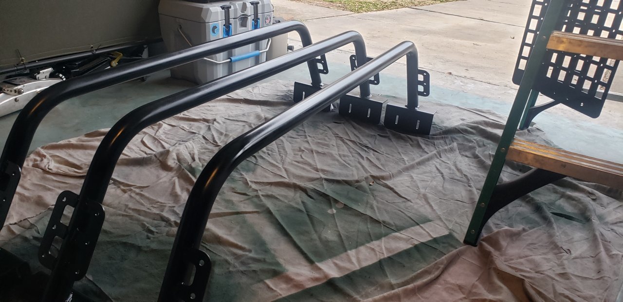

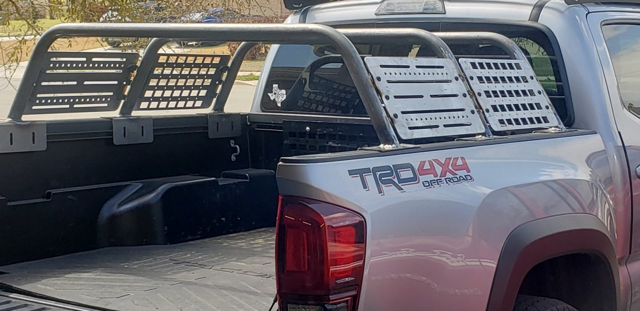

    nice work,
    what gauge steel are the panels between the bars?

    11 gauge mild steel. Matches the. 120 wall tube pretty close in thickness.

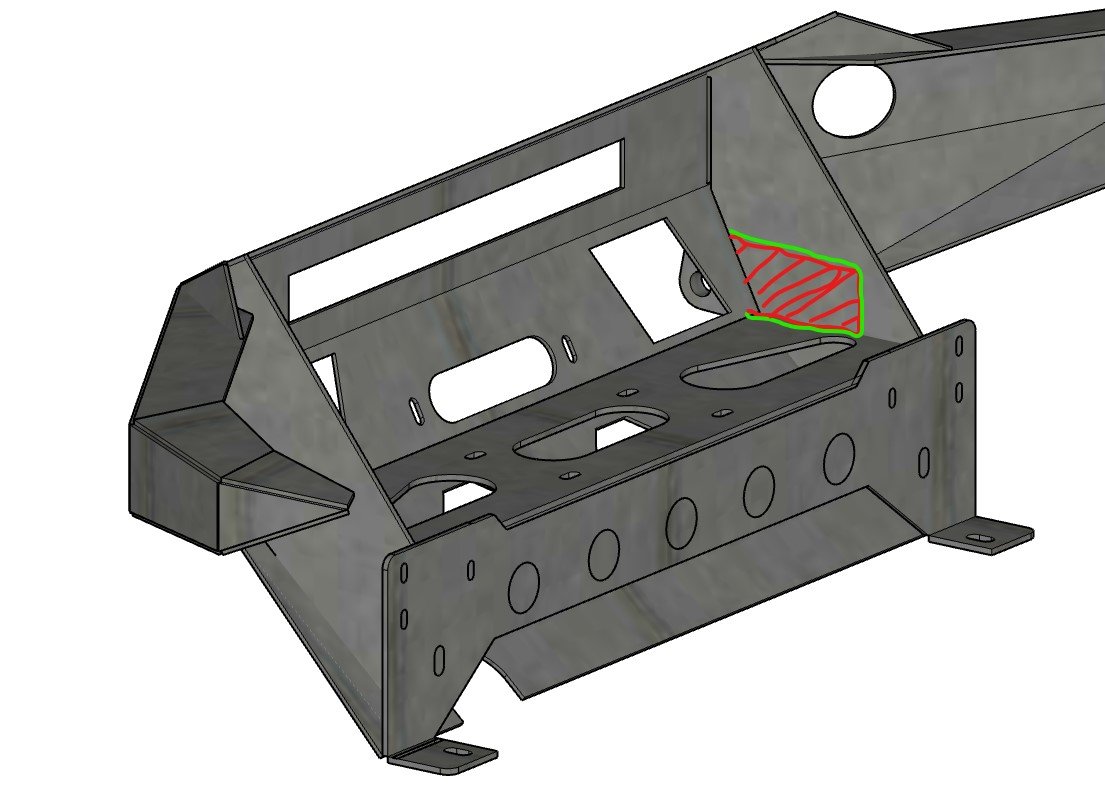

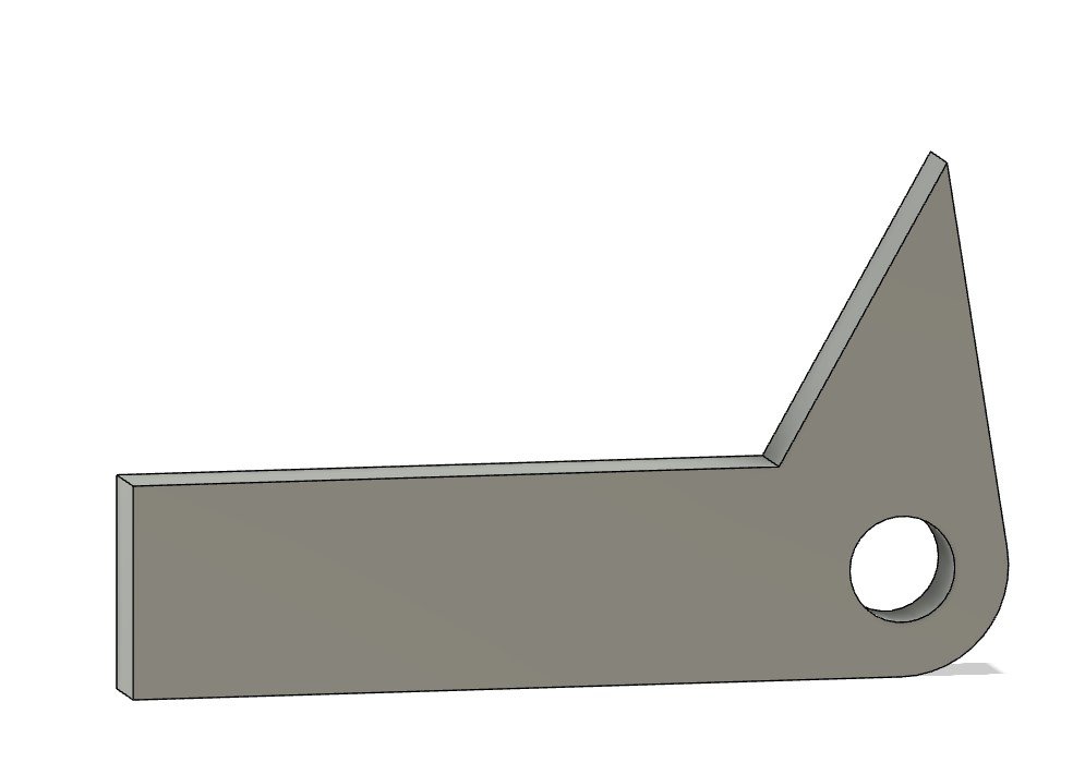

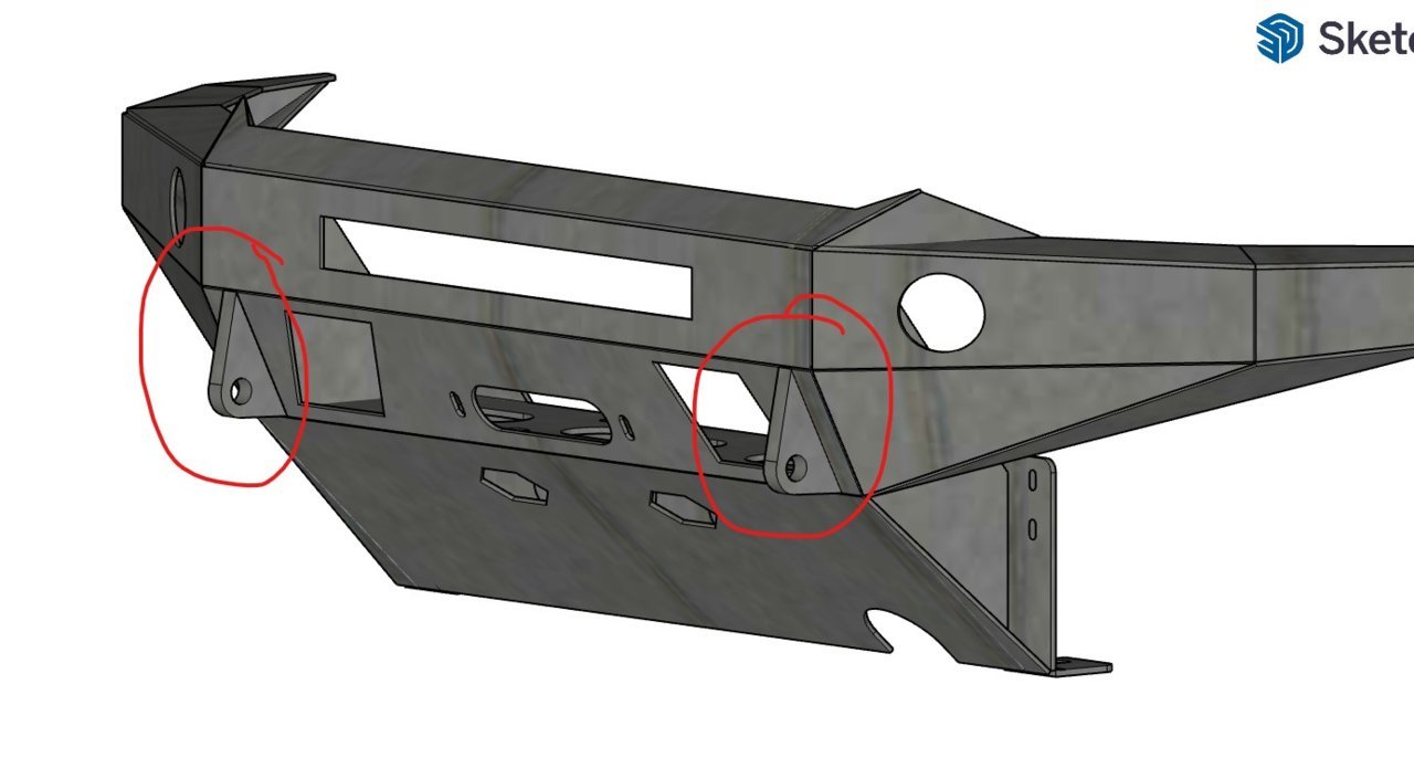

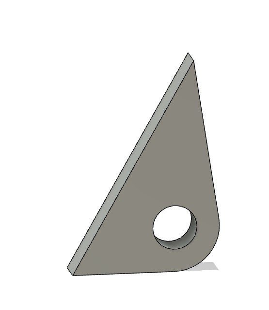

    I would 100% pass it though the bumper. There are some insane forces at play in a recovery and can be from any different angle. Even if the weld stays good, I bet you’d bend the recovery point fairly easily.

    Yeah I like extending the tow points to the frame if you can. I don't think they'd hold up under the four wheeling you do.

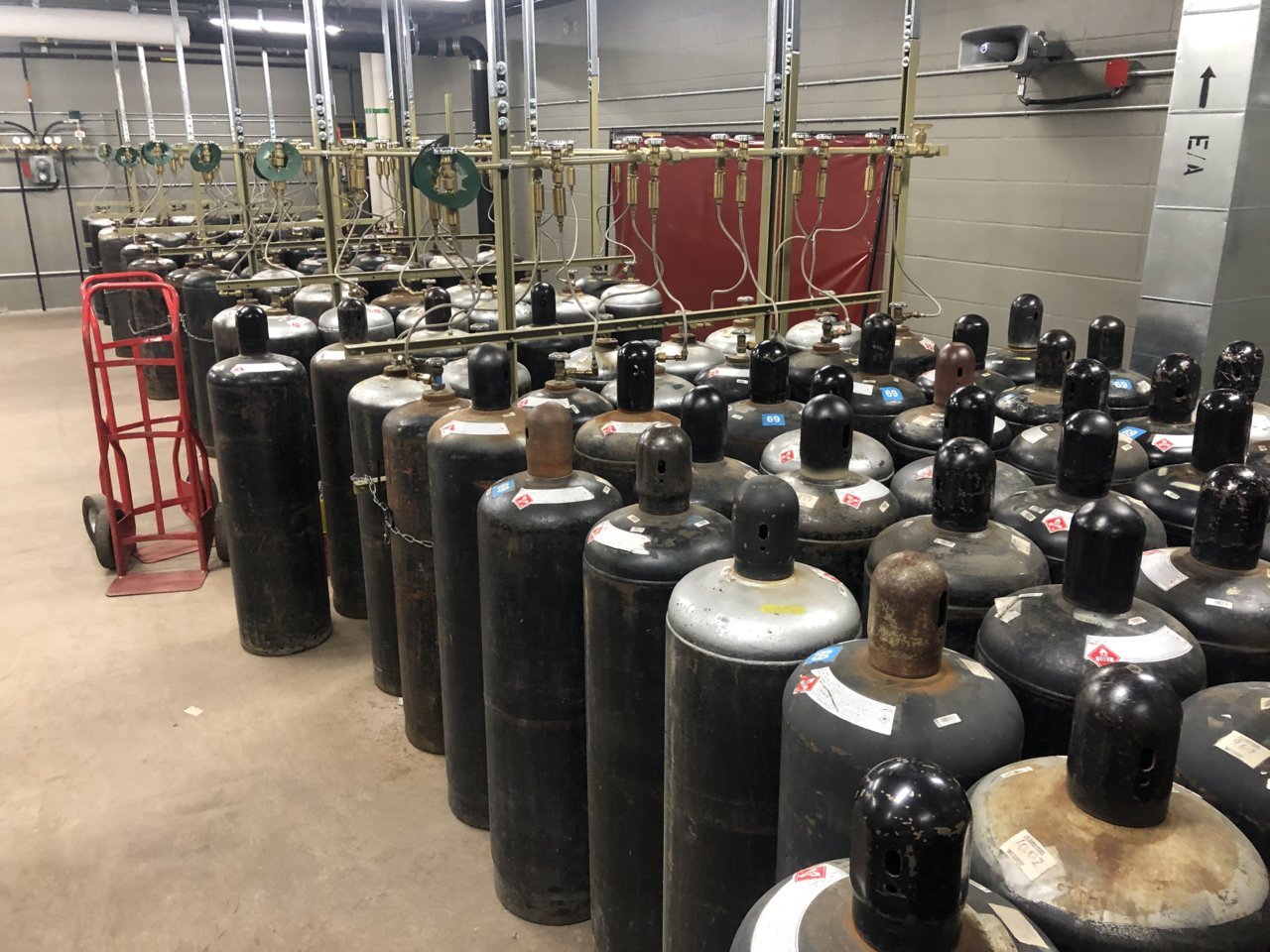

    This is our acetylene manifold system.
    There is a second bank out of view

    What in the world do you use that much Acetylene for that you need that much volume ?

    trades college.
    its still suprises me every time I see that many bottles.

    Ok that makes sense.
    No Doubt some reason the school is not allowed to generate there own.
    I recall when that plant exploded in KY I think everyone could not get any or was limited for some time or switched to propane

    Regardless, that's a lot of calcium carbonate to make that much gas.
    I remember when I thought I was the shit having a calcium carbonite head lamp to go spelunking (caving).
    Water and rocks made the gas to light our single burner lights.
