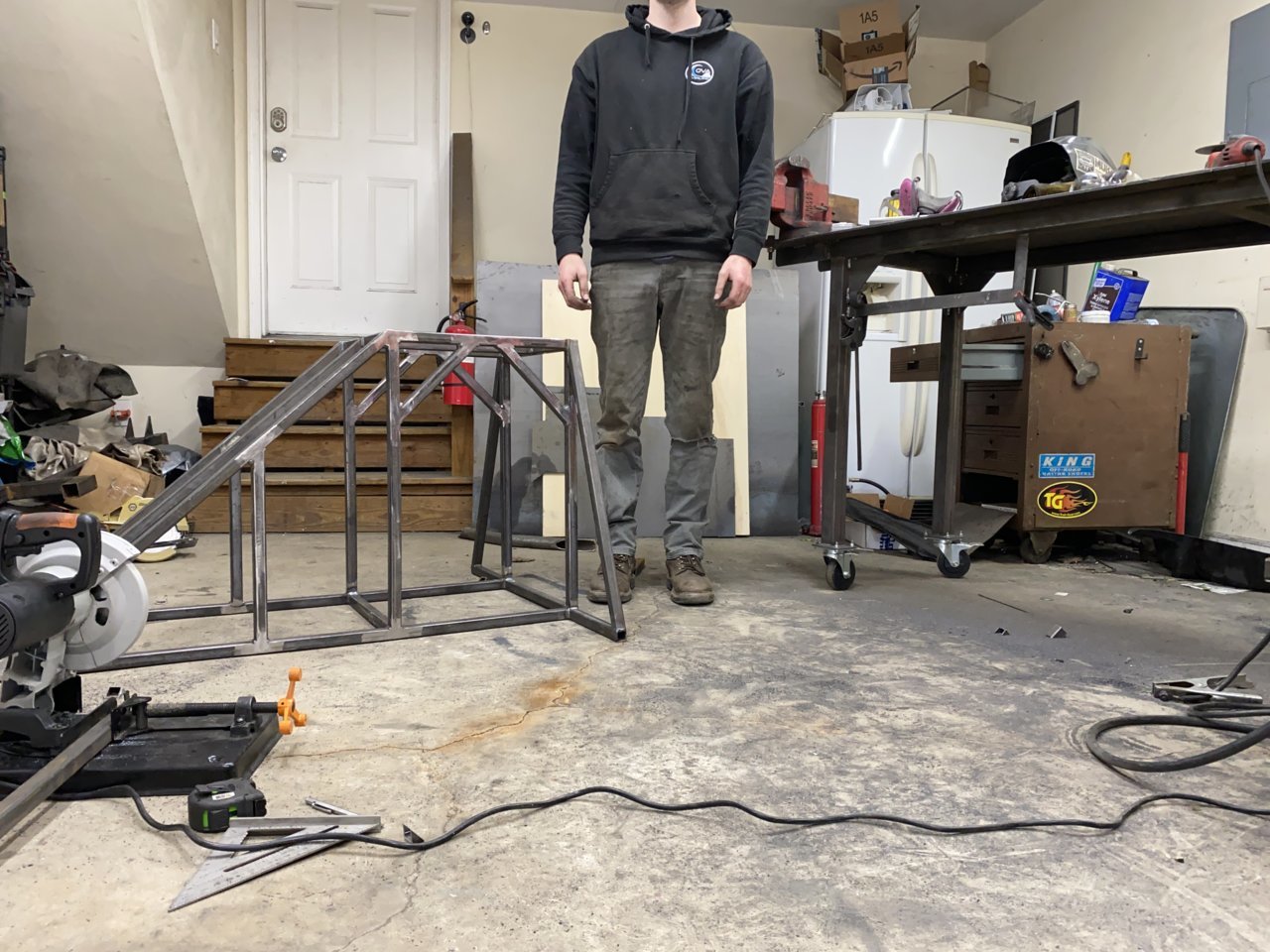

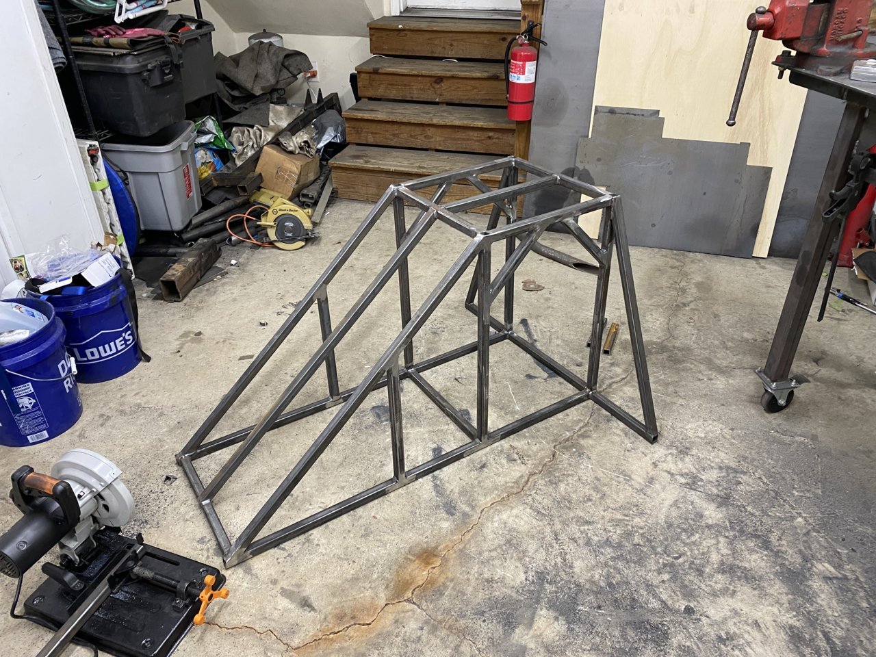

    Building a mini flex ramp just because. Using 1”x.120 square tube and it took 60’ worth. Not done yet but should be finished tomorrow. Made it 27” tall.

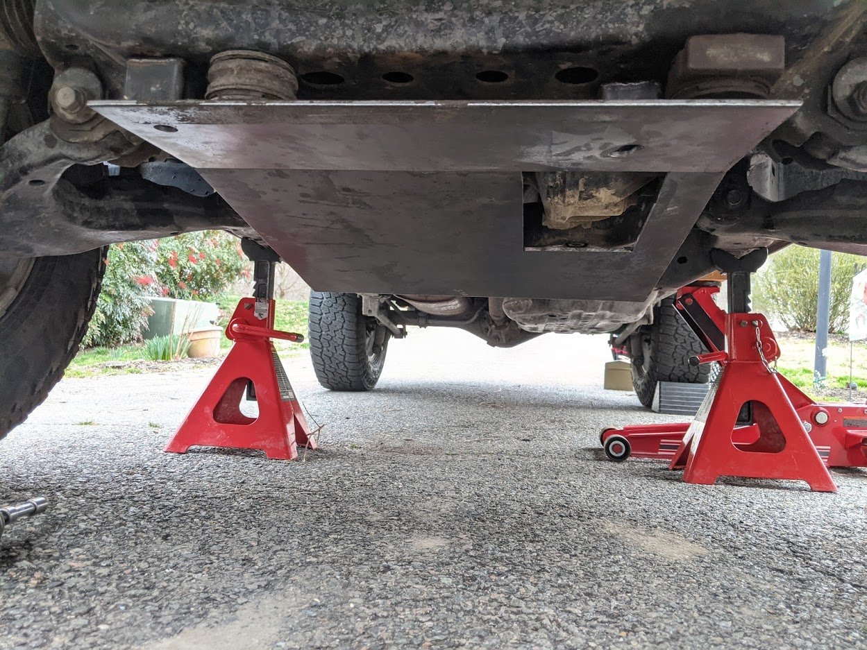

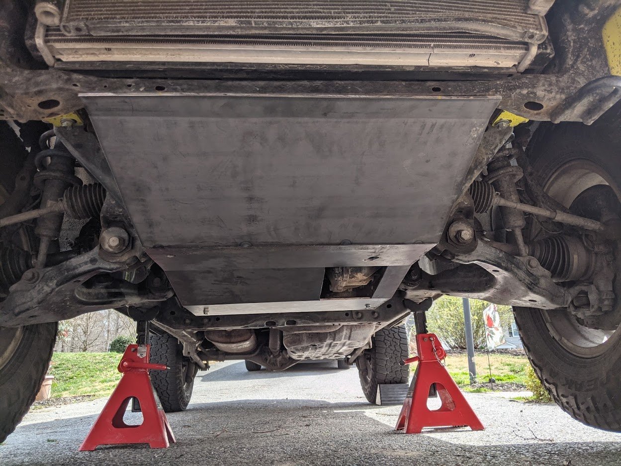

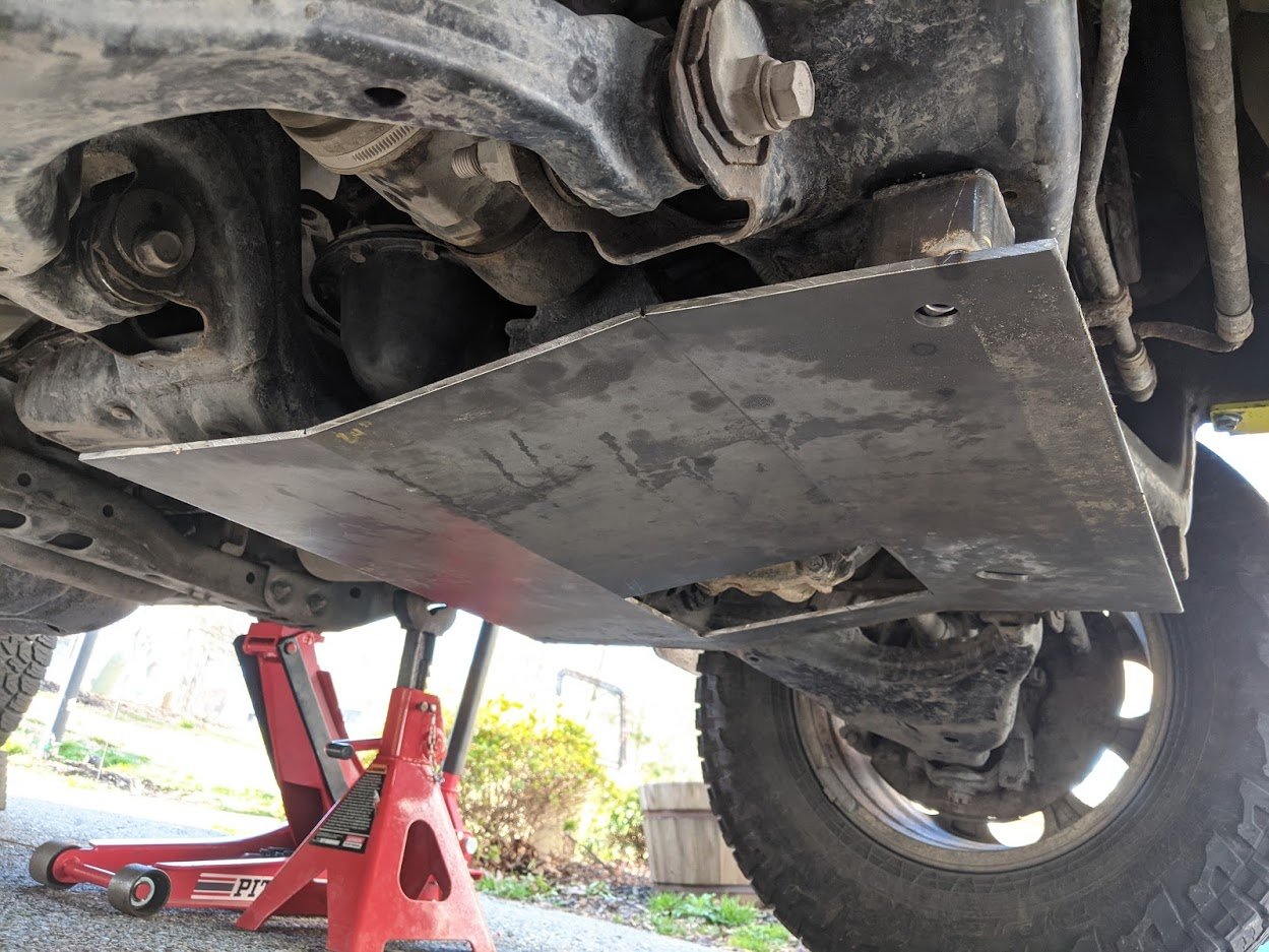

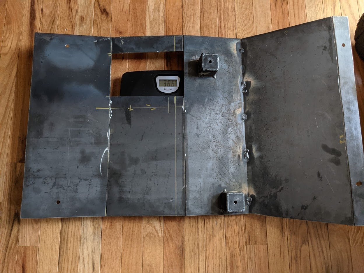

    Looks good. Don't worry too much about the weight of skids and sliders. Their weight is the lowest you can get, so to an extent more is better. It's ballast essentially. Especially when you start adding stuff up top.

    Sheesh, I just did a rough count of 20’ of weld being laid on that ramp. All in 1” segments. No wonder it felt like so much effort.

    Well, it’s done and it worked. Now I just need to paint it.

    You think it would move if it wasn't hitting the garage door lip?
  19. Mar 18, 2021 at 12:25 PM
    EatSleepTacos
    Mar 24, 2015
    #151688
    59,835
    Randy
    West Valley, AZ
    2017 4Runner
    Absolutely. I'll have to have this jammed up against a curb or something whenever I use it. It's a 41 degree climb and even in 4lo, I had to work for it. It felt like I was climbing up a rock vs a ramp.
  20. Mar 18, 2021 at 12:28 PM
    cynicalrider
    cynicalrider #NFG
    Jul 25, 2012
    #83399
    17,147
    Jersey
    01 SR5 TRD 4x4, '23 Bronco Wildtrak, 2017 HSQV FE350
    Drop bracket lift and booger welds
    I'd imagine expanded metal on the surface might give you better traction. :notsure::
