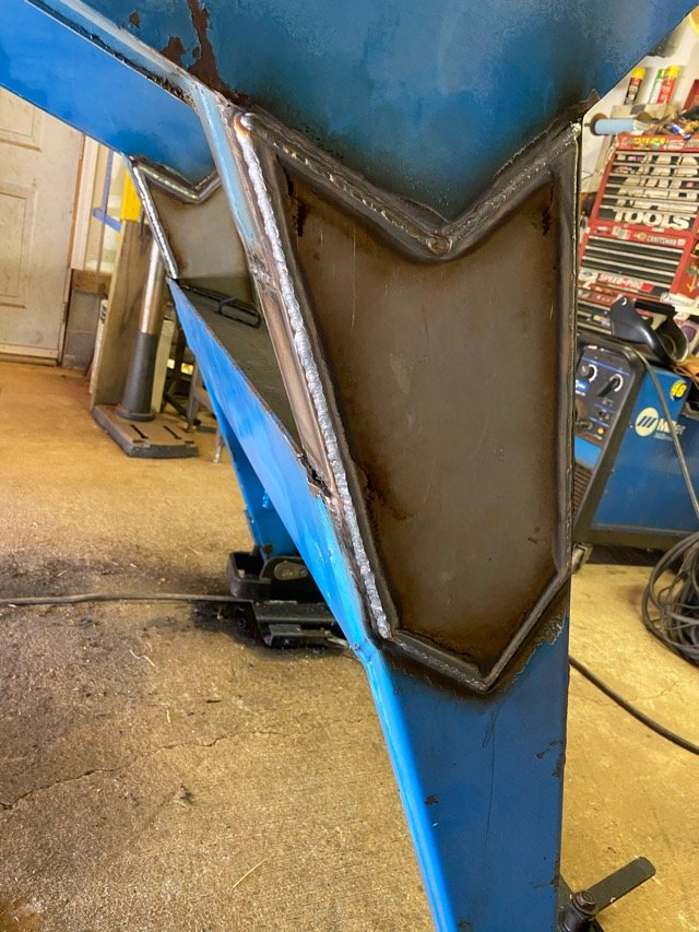

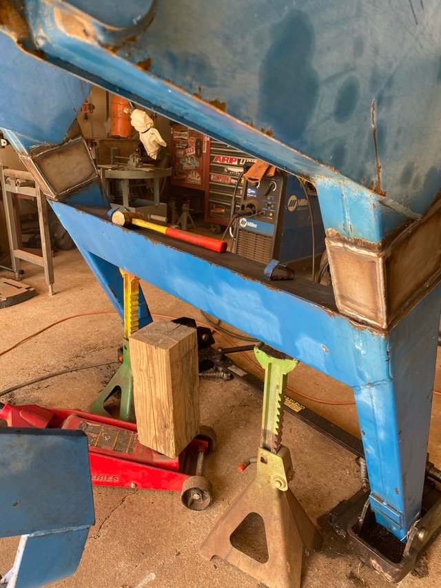

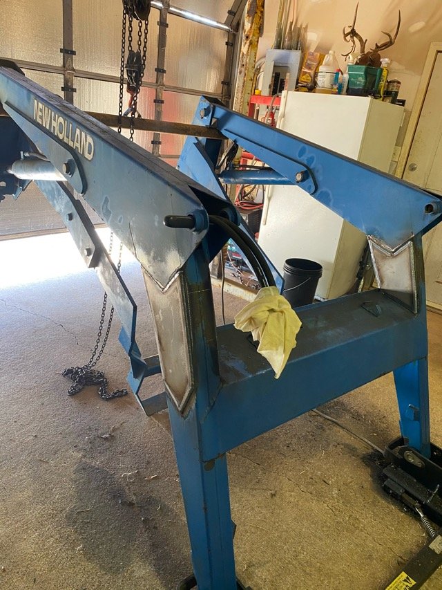

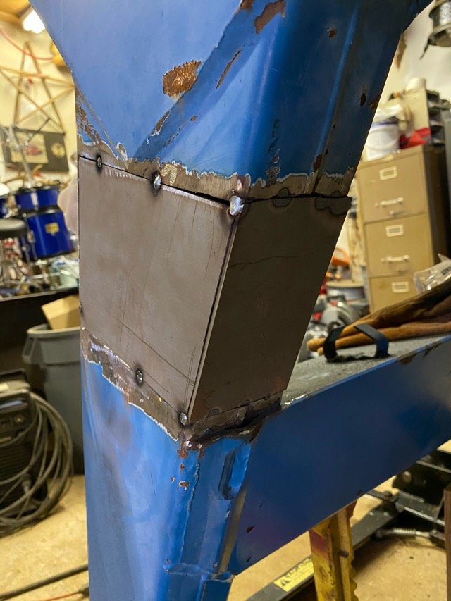

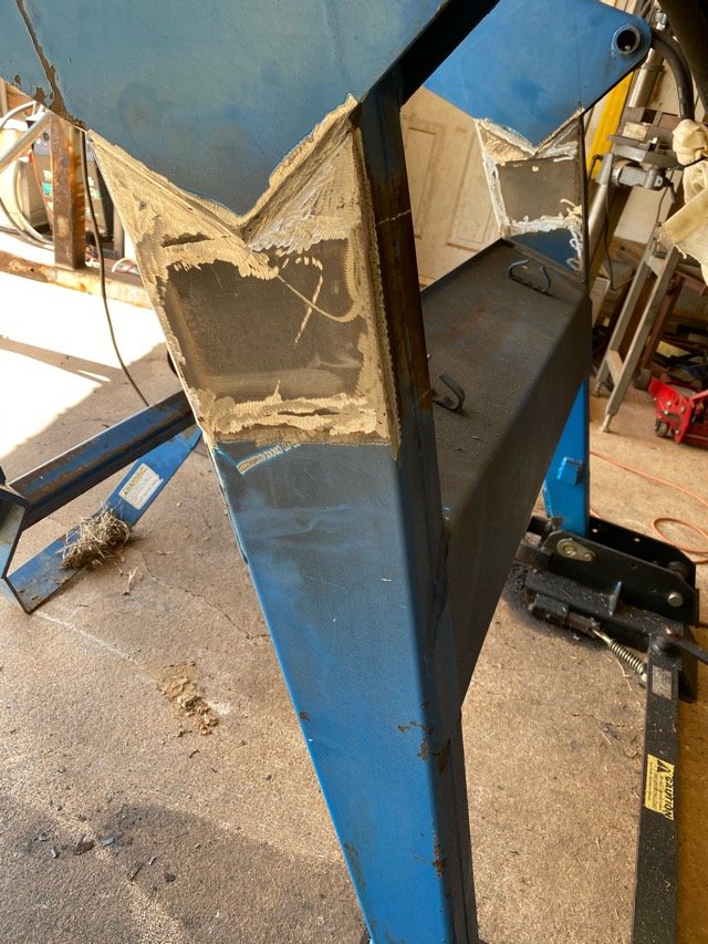

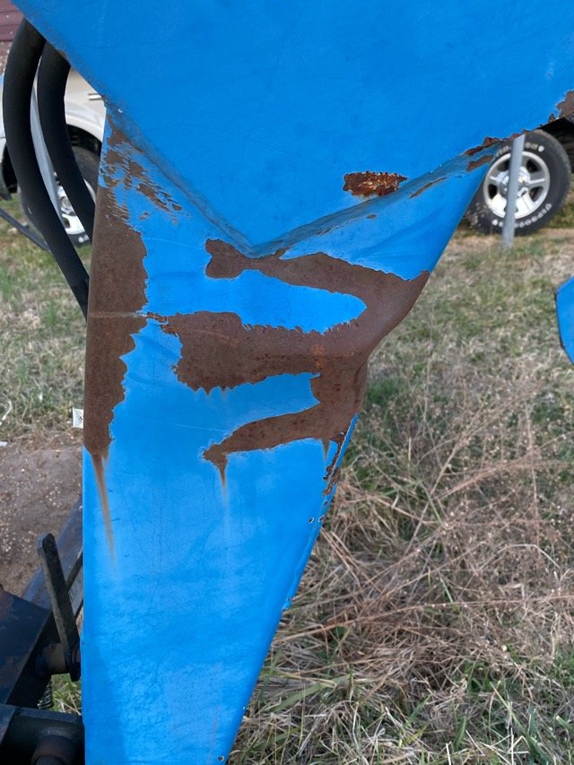

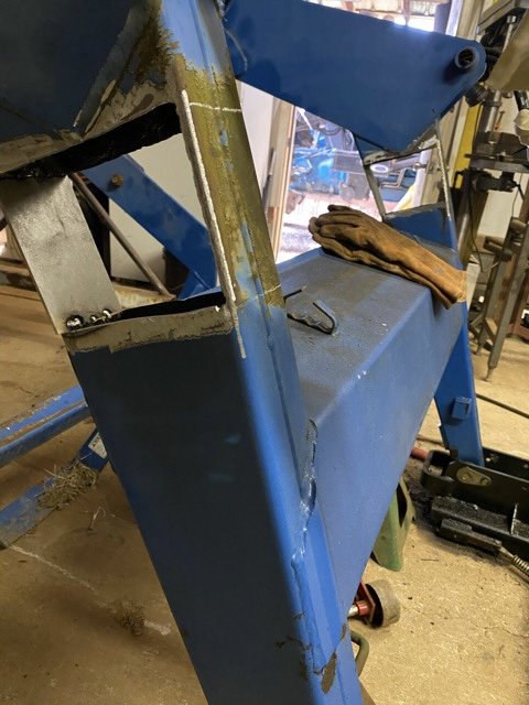

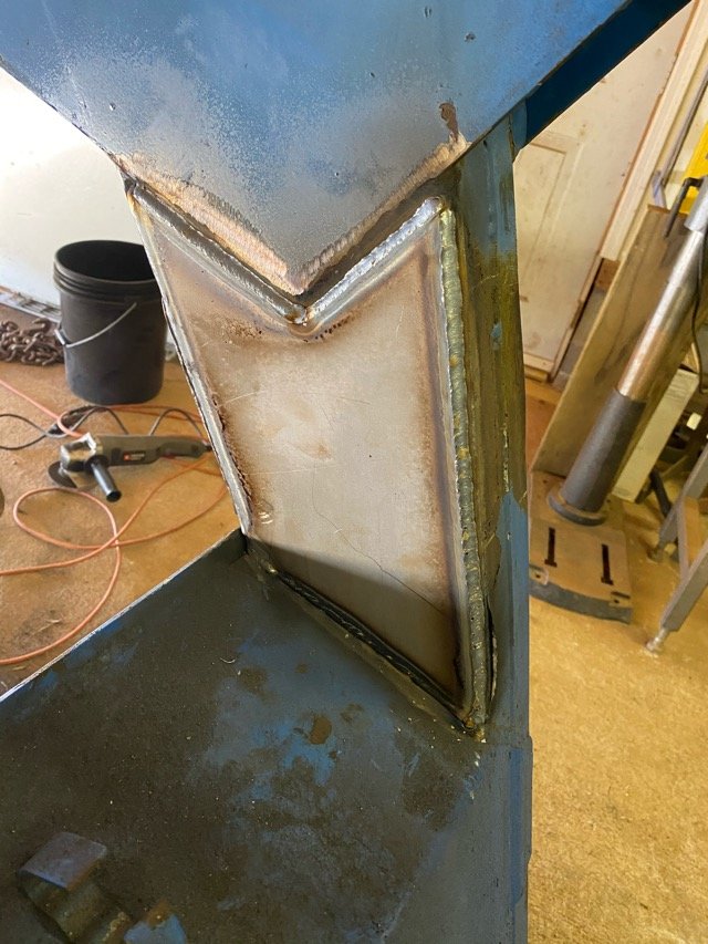

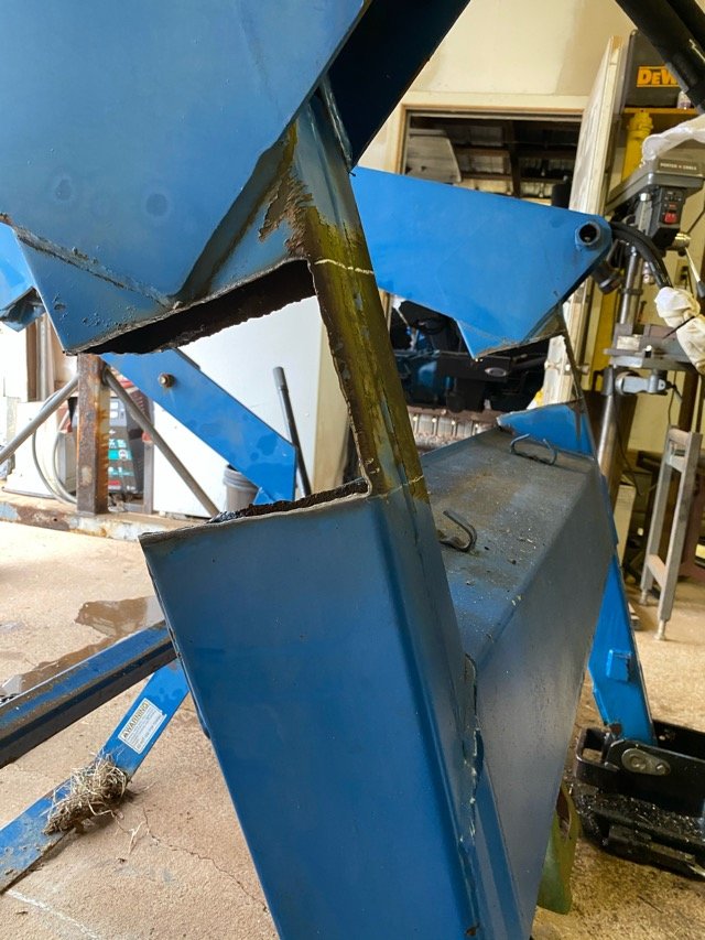

    Done with my friends bent loader project.

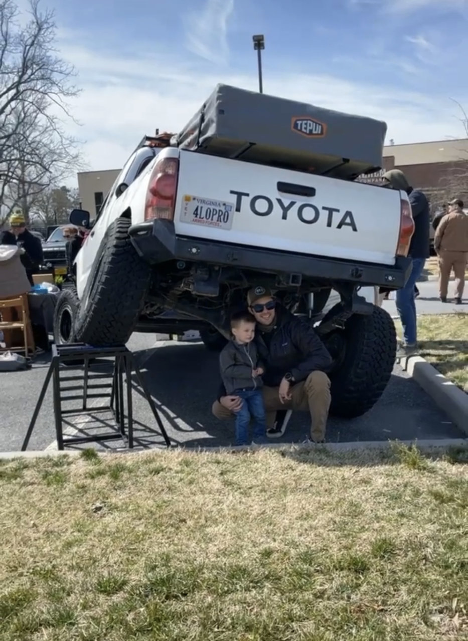

    I always like to show the end goal of something I make in this thread when I can. We had a truck meet today and over 90 trucks showed up and the ramp was a big hit. Really drew in the crowd.

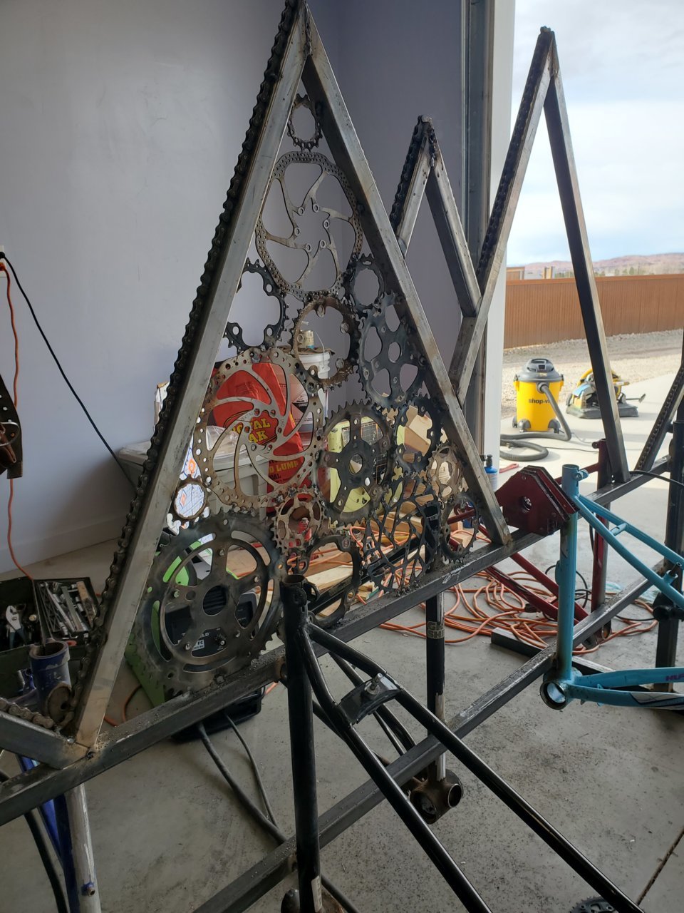

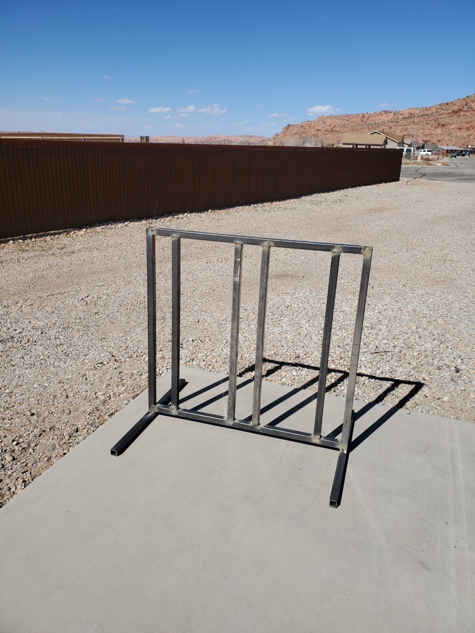

    Who has made their own bedracks before? Got a 110 and I'm getting better.
    Been making some bike racks for the town.
    Really like the look of the tube ones but I don't own a bender.....yet.
    Let's see em!

    That looks great! Nicely done

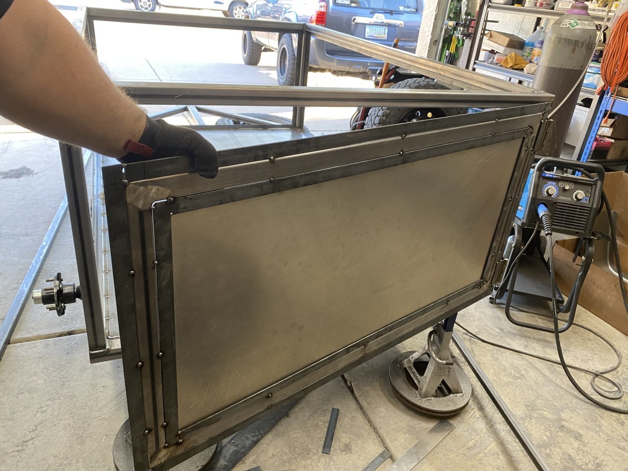

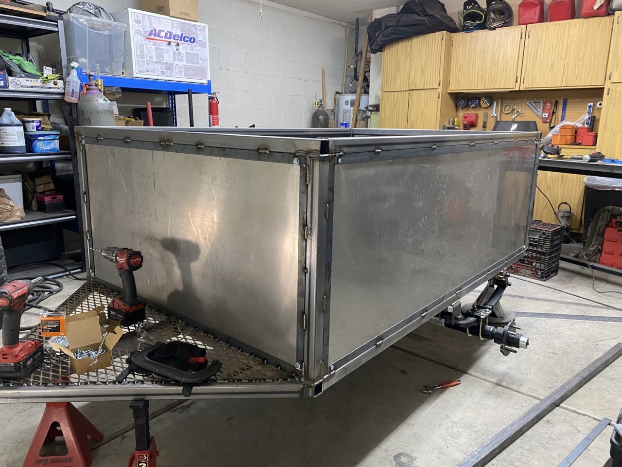

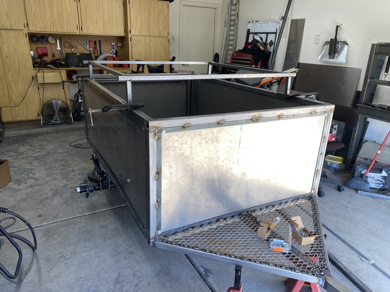

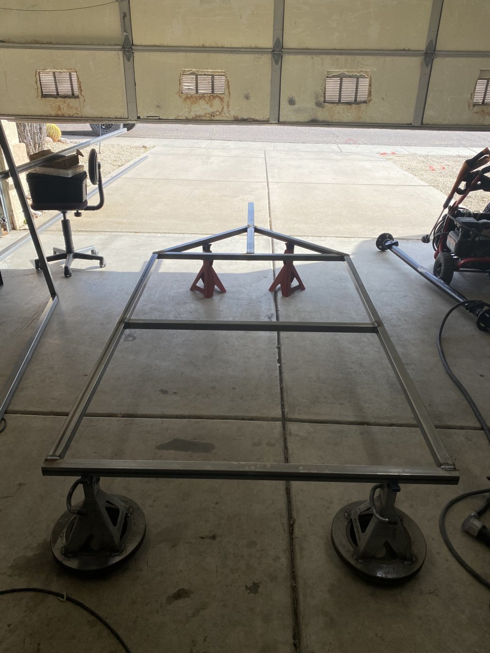

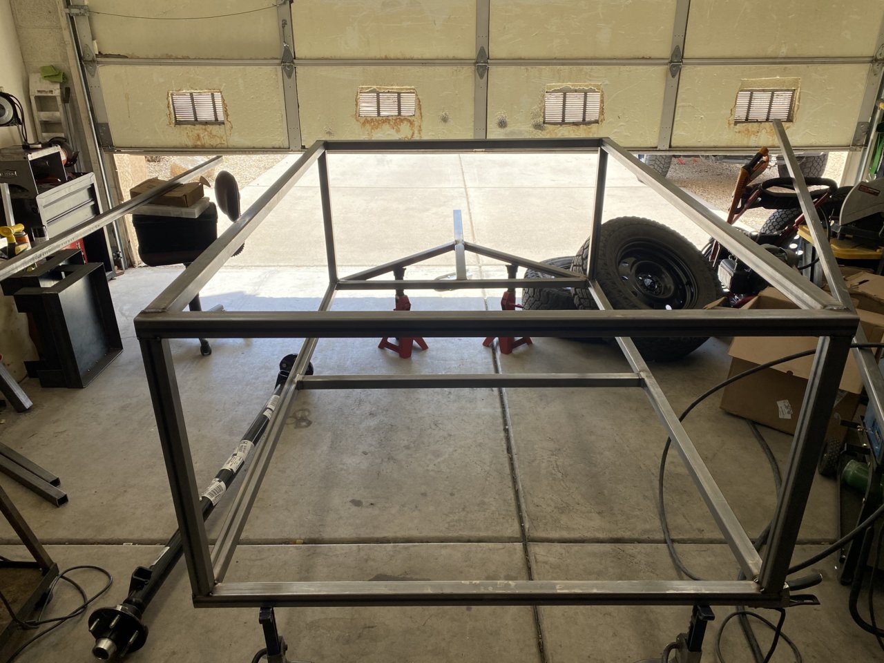

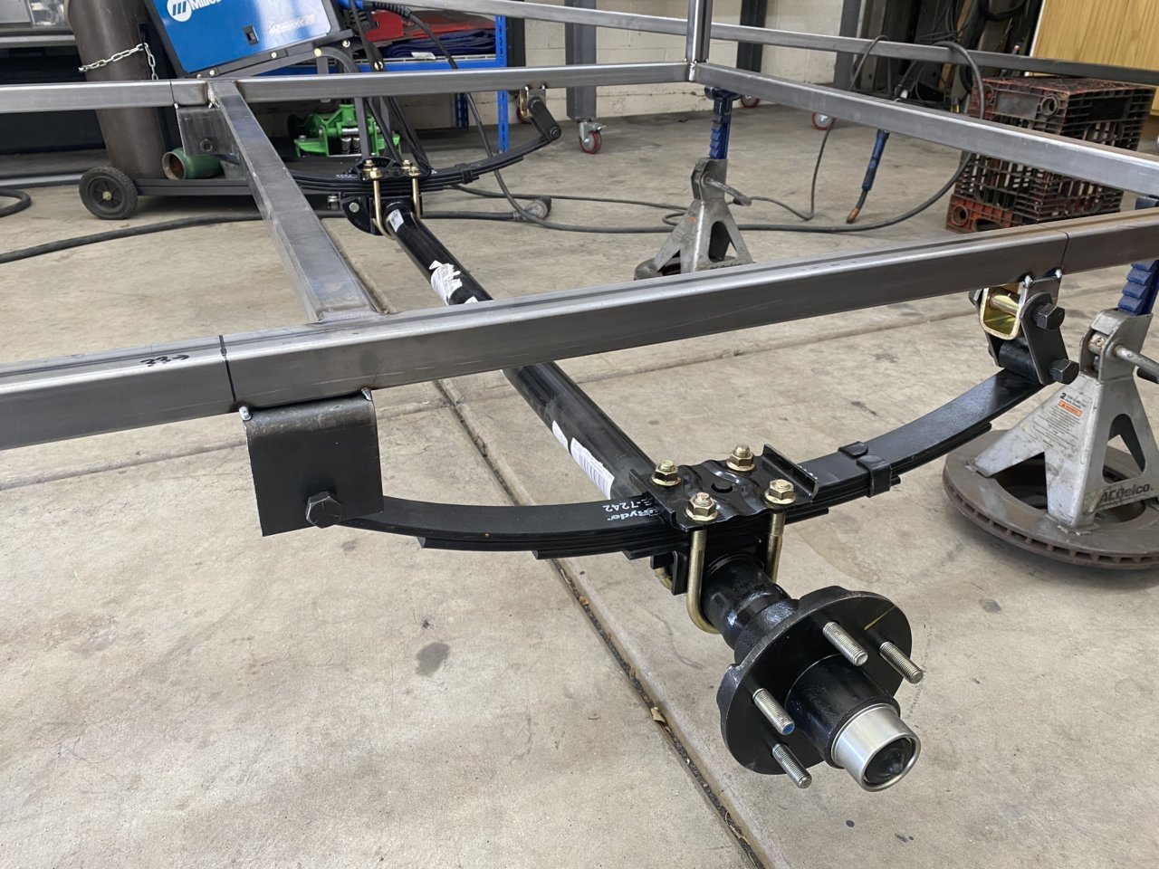

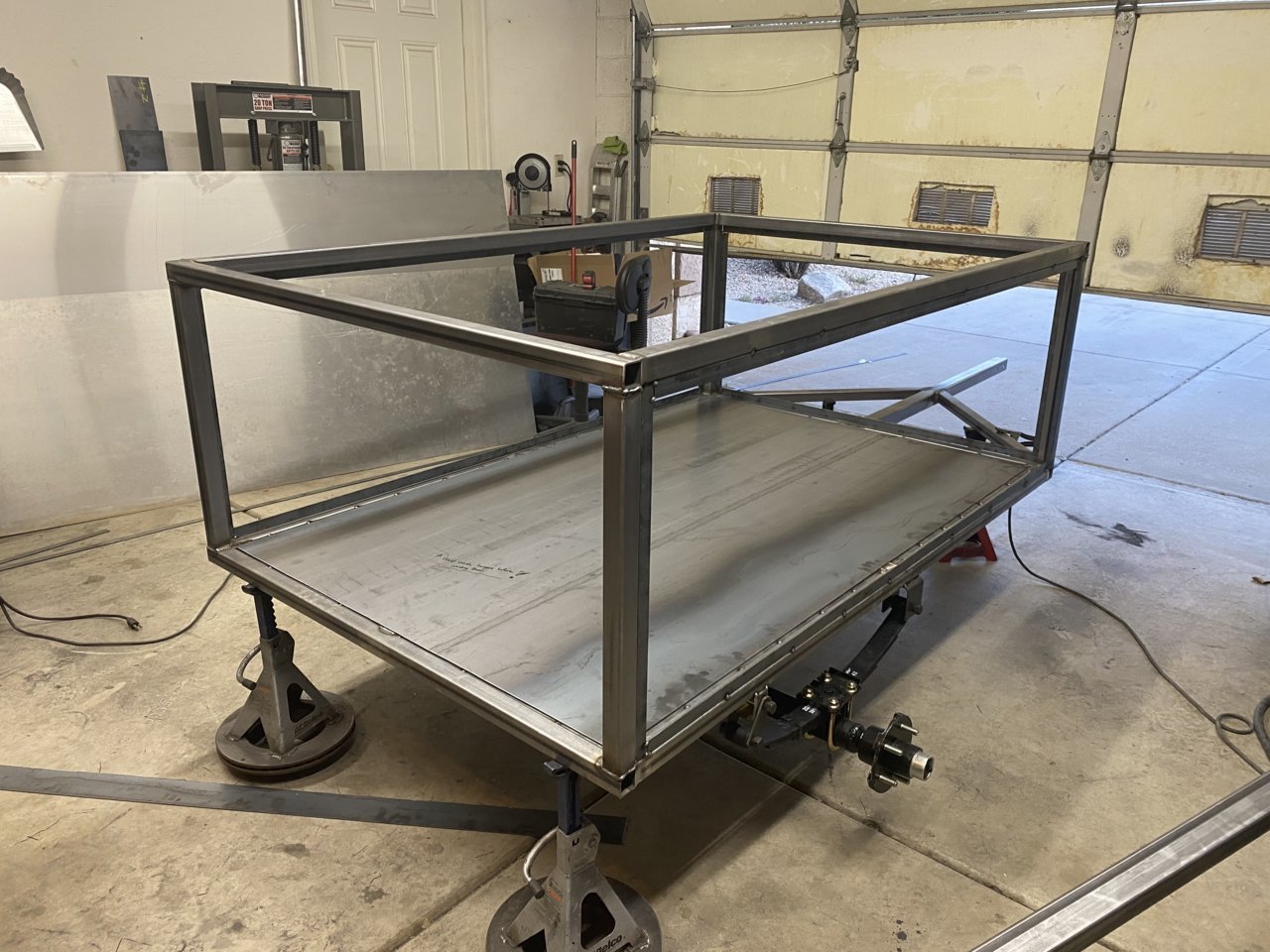

    Overland camping trailer build. Waiting on some parts before I can continue. Not the greatest but it’s always fun building something new. Frame will be painted black which will make the aluminum “skins” pop a little better. Fenders, lights, step, latches, etc will all be added after my wheel adapters come. Few more tubes for the removable tent rack.
    I’ve also got some cool little parts to finish it out really clean, such as the plastic tube caps that pop into open tubes, etc 1999ECB0-11A3-4083-9D32-EA208C50D24A.jpg340E17BD-DB77-48FE-BD84-6286CFECA985.jpg4A430413-7C58-4A93-8D2E-91C54A0773C0.jpgB560834A-7B28-458E-BDB9-352BD28DE55A.jpgCC7B39BF-EF21-4FD9-9752-07FBDD1CB8D2.jpg029CE10A-909D-4415-8772-6B496C14D541.jpgA15252C7-9C44-4982-9154-31825653E24E.jpg585F83D7-A45E-420B-BA58-F7399C605DFF.jpg75EB9443-922B-43AE-9215-932E48EE6A89.jpg

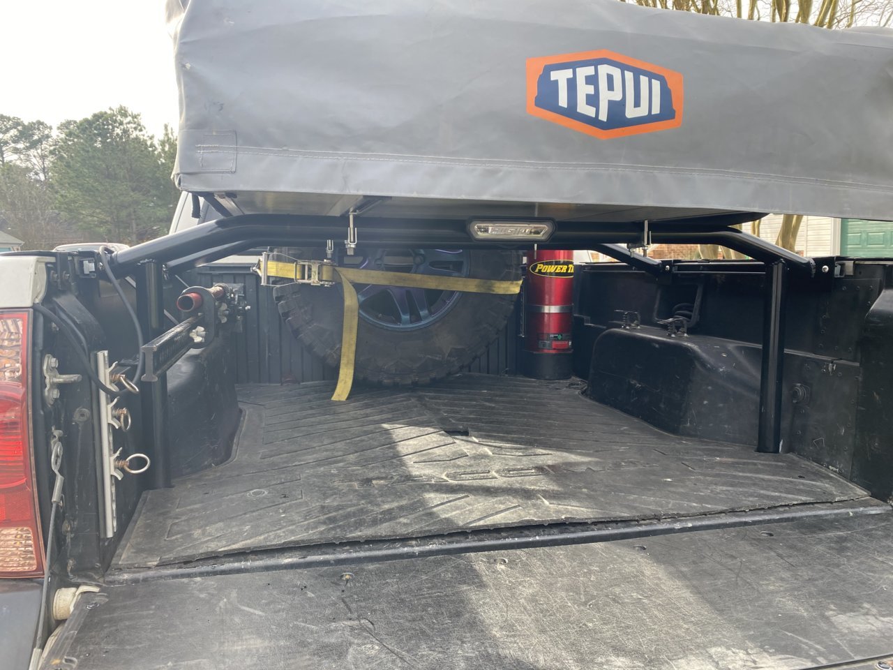

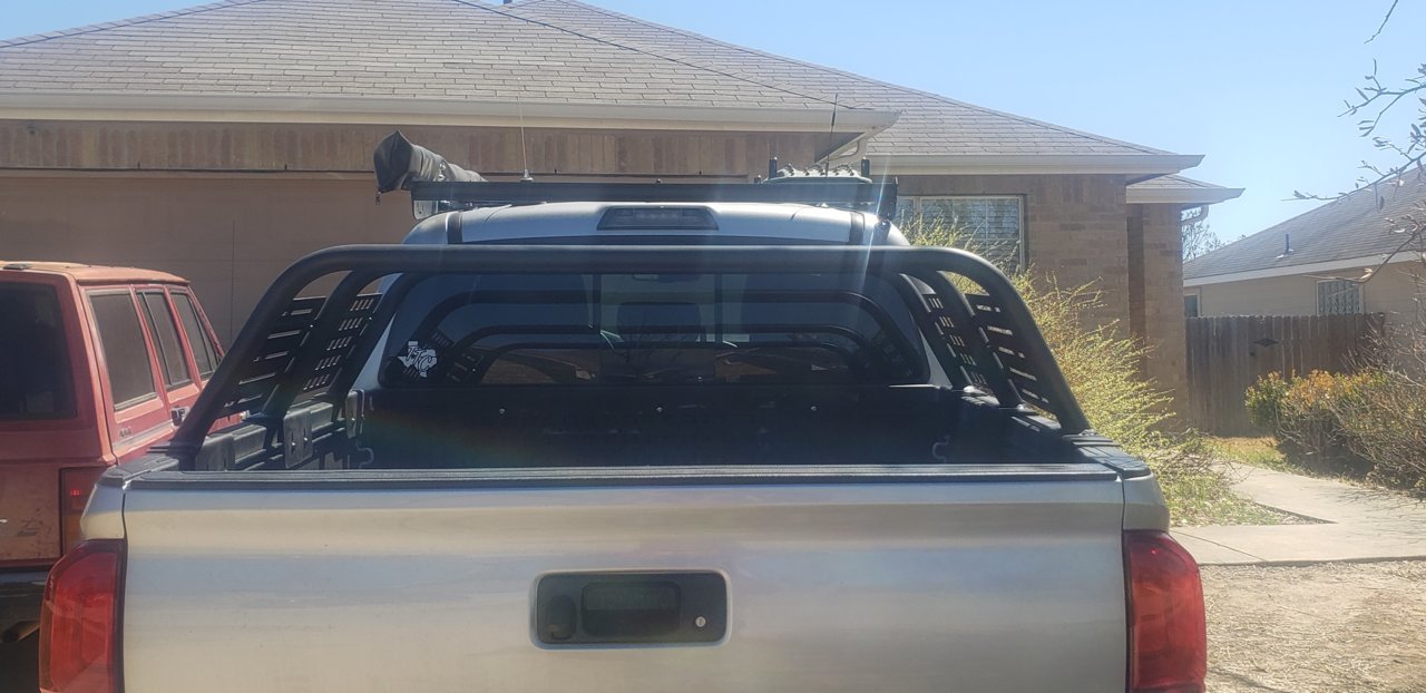

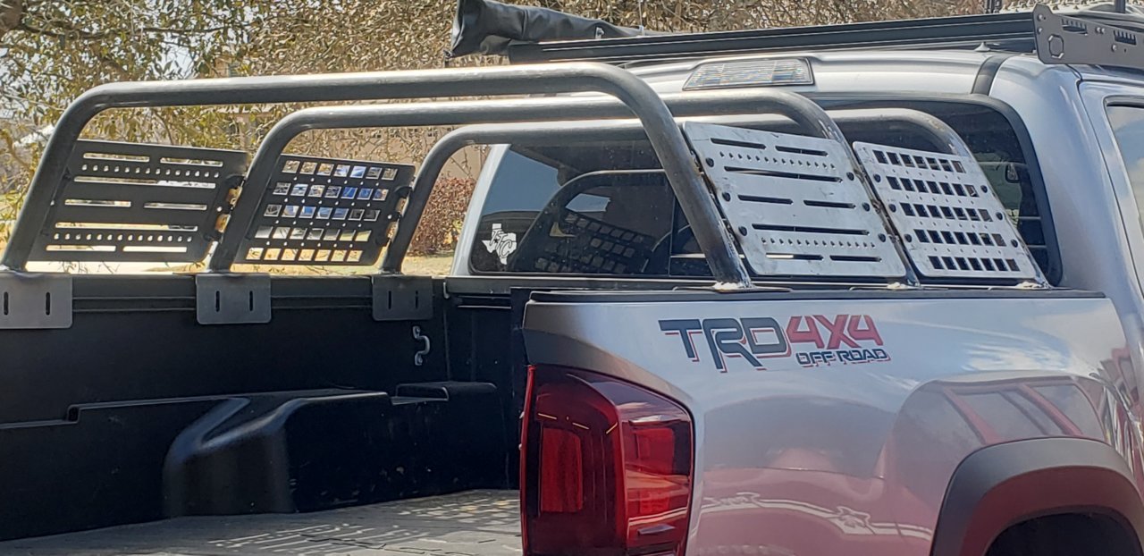

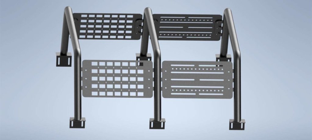

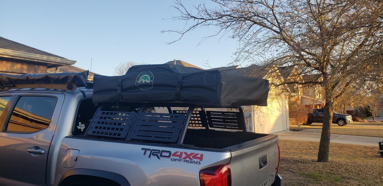

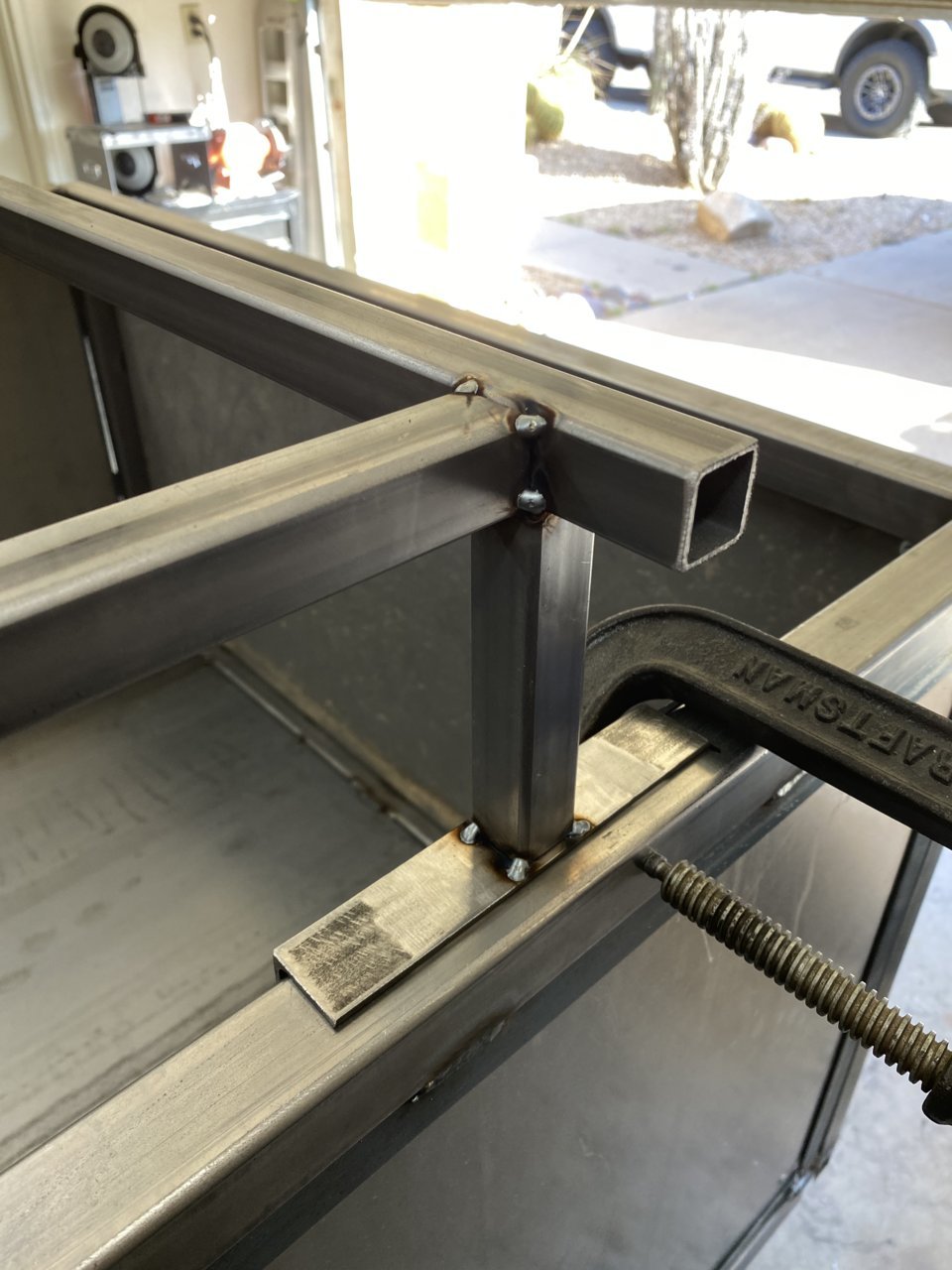

    Just finished mine up...

    @snowboard704 Nice looking trailer. I hope that you're going to weld some vertical gusets between the angled rails from the hitch to the front corner pillars.
    What you have created is a stiff hinge that will flex with every bump the you take it over. Failure may take quite awhile but it will happen. I can visualize all sorts of horrific scenarios...
    You might consider a beefier material 45 deg 3/16 or 1/4 X 6 X6.

    Reserected from the dead.
    That tongue is the weak link. Need to extend it back to a second cross member.
    Otherwise, gonna be a great trailer.

    That's what I'm talking about! I love that, like can't give you enough compliments on that. That's pretty much the exact style I'm thinking down to the panels.
    Mind if a DM you with a list of demands..er questions?

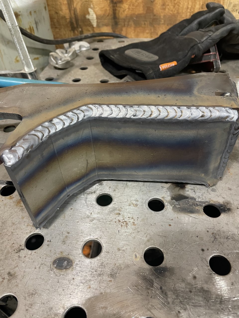

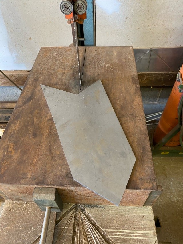

    Had some good shop time today. Converted back to a metal shop from a week of wood working. Which basically means I rolled tools out of the way that were no longer needed and rolled in the welder and evo saw.
    Adding a swingout tire carrier to a HC bumper. Bunch of random closeups before I finish everything up.
    Got these gussets from BAMF and I always keep a few around for odd jobs.32A7C8E2-1ED8-4B03-8846-3F5E9373559B.jpg
    I always like the color change.

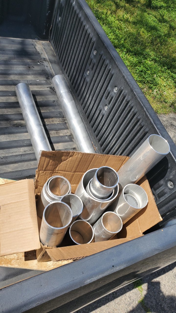

    My buddy that works ar a drive shaft shop just came and dropped off a bunch of aluminum scrap for me to practice on

    you doing a build thread for the trailer? what size are you making the trailer itself? Where did you get your axle from and whats the hub size on it that makes you have to use a spacer for wheels?
    I have mine drawn up just waiting for the weather to warm up so I can start my build. Looks sick!
