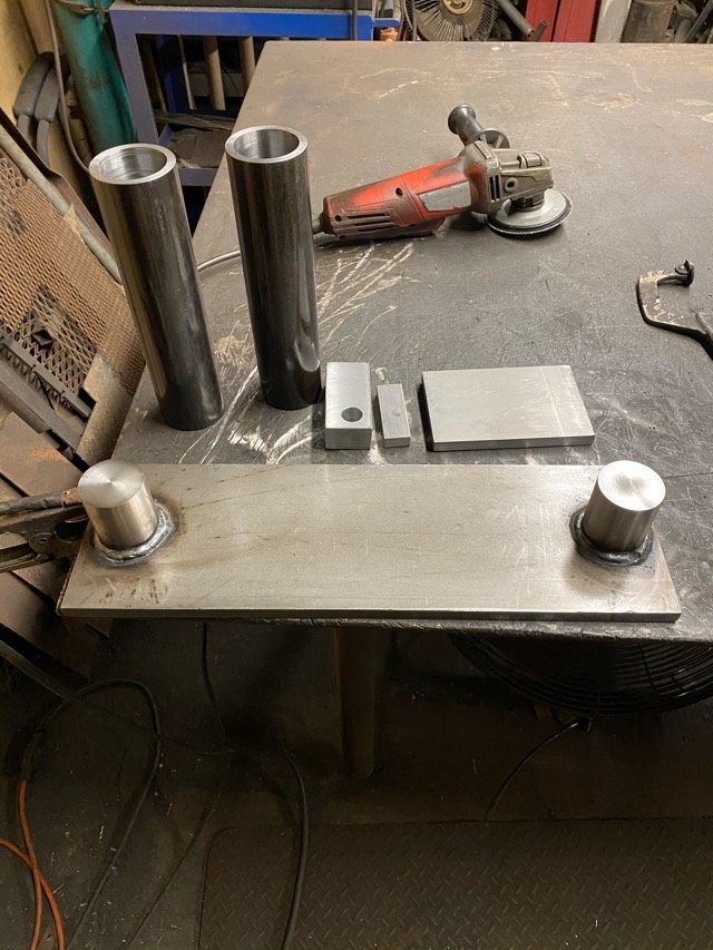

    This was fun. Measured the center distance of the tubes after it cooled off. It’s .007” off. Hopefully it won’t be tight on the slide.

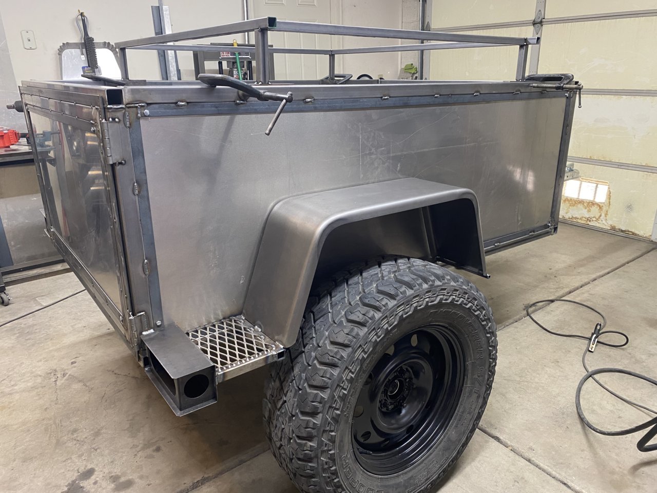

    Appreciate it! Got some more progress on it today. Fenders, tail light housings, and mesh step. Not bad for 2 hours

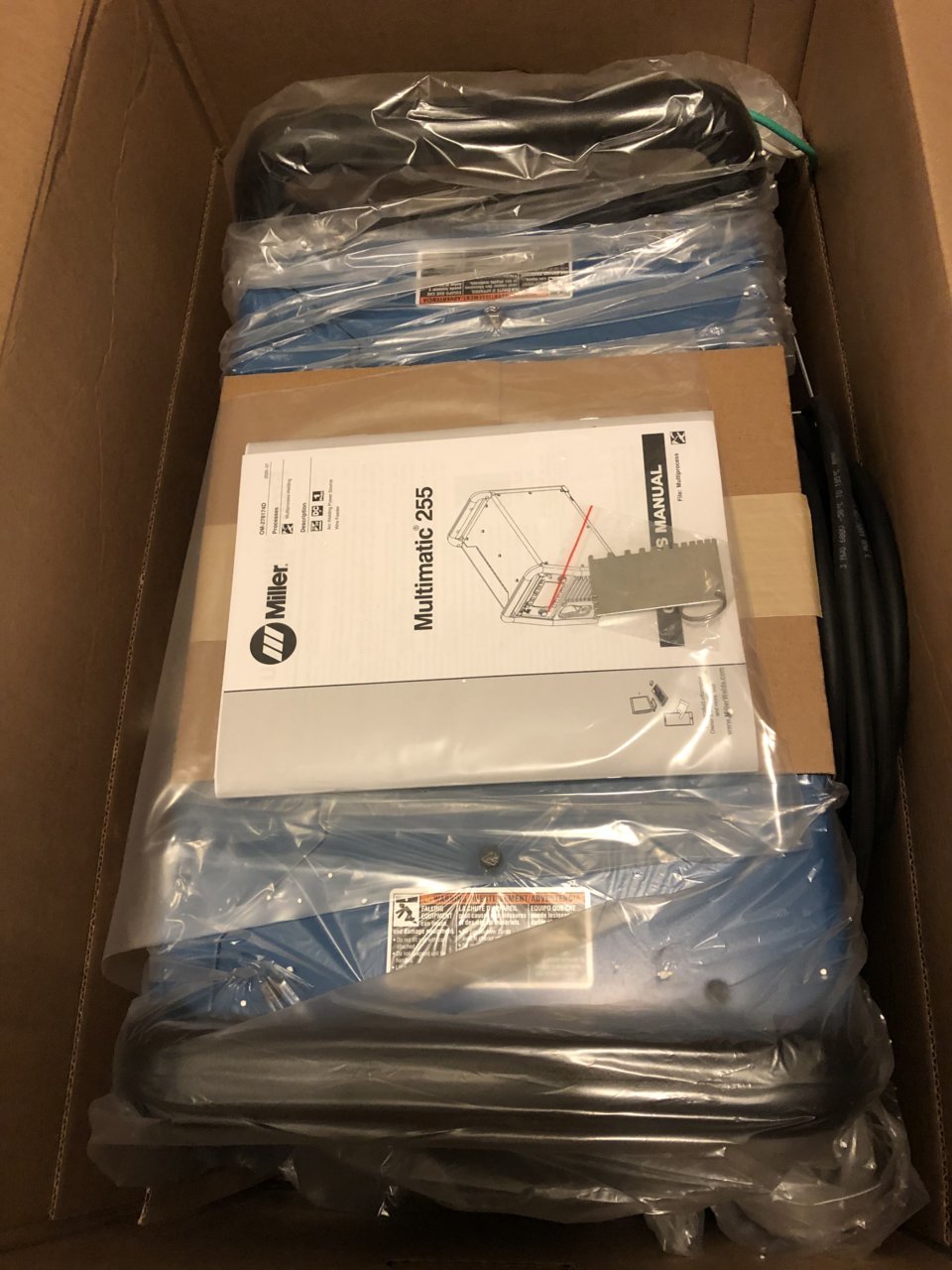

    Excited to make a replacement to the metal tool collection
    had to pull the trigger before the price increase
    just gotta save more pennies to get a plasma cutter before I start on the JDFabrications pivot kit it be a while so I got time to get use to the new machine

    As many as I can fabricate
    :spending:
    Great choice.

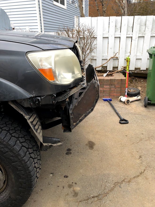

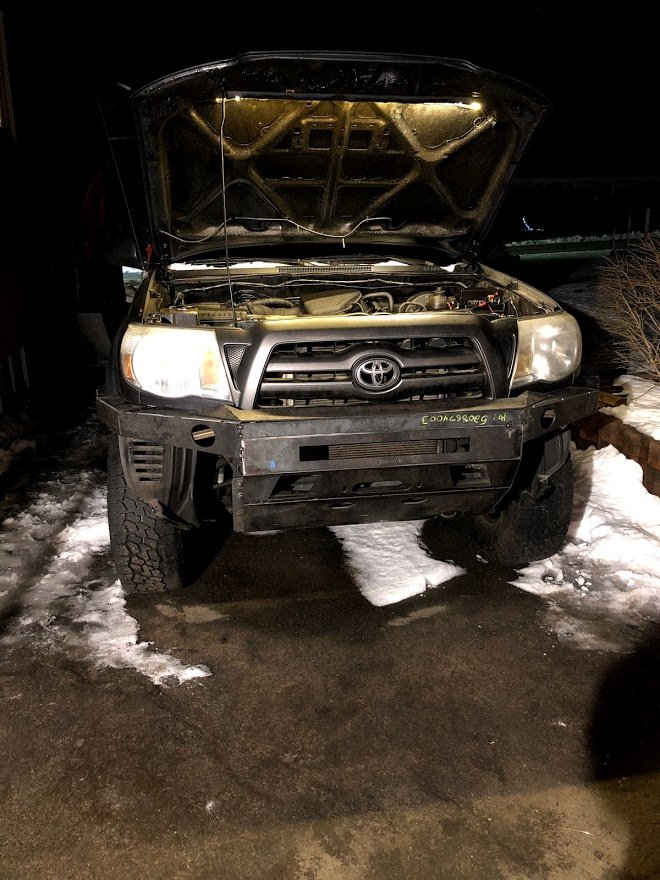

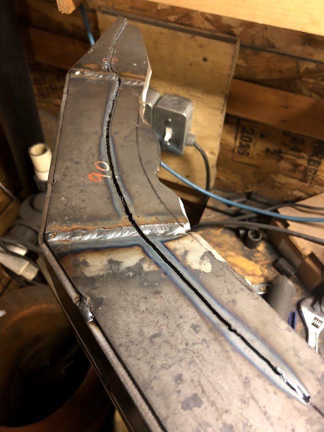

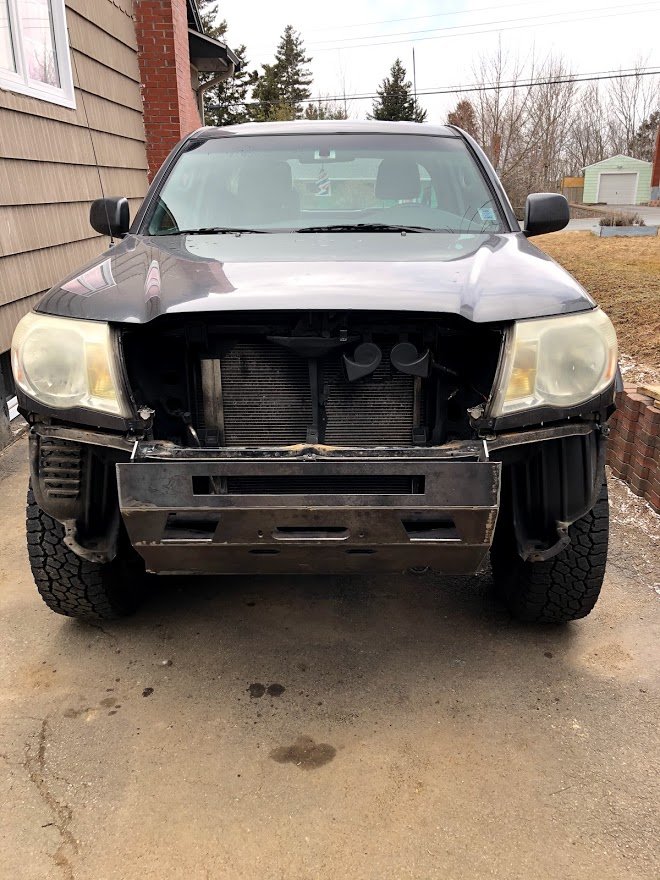

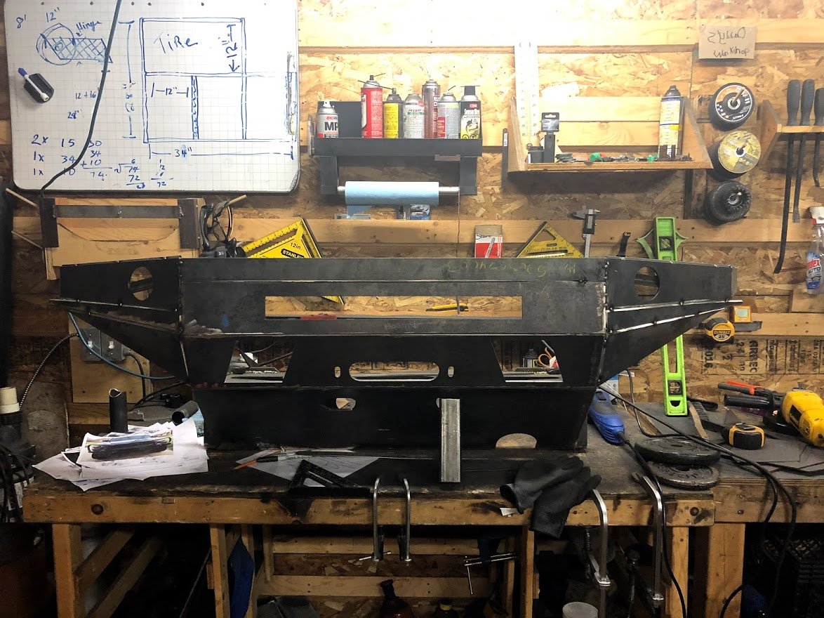

    March Break was last week, and I took the week off to be with my oldest Son ( and to not go to work :D )
    Managed to squeeze this out during the break.
    I bought the CAD plans from a local company who claimed they were for 05 - 15 taco. after much research it's really for a 12 - 15 taco, Once I understood what the issue was ( had horrible gaps and was waaaaaaay off ) it was full steam ahead on the old "make it fit" train
    I'm pretty pleased with the result so far.
    Definately been giving the Lincoln MigPack 140 a workout. :welder:
    ACtC-3fpY4IadE5THxuw_RaS2M3di0feINWxLbqG_6d37e8bb84a7b7397edb405834ac821f4df8c4fe.jpg ACtC-3f58d6notDPPzd9VhGDdmZ3Z6gL5Pe1WJdQ_3e75a681de702039cf876638ca3512834ec6f740.jpg ACtC-3fuGpm_YxYjXX4o_TpTvah11itutxEAXrCO_138c2b5a08ebdfe4859f35c37f9705bc4df32c58.jpg ACtC-3c76heX1Eo2IuWtg04VZERkM6tYRq3U5NW-_5da1d5600c4bc0e43b15219b5f995cf3e373d2ea.jpg ACtC-3dKXgGayW_psqBjviHqGfStuGYBH3V7H0Hx_958e95d45e0b08d4d071c9b6419b92480d0d6b4d.jpg ACtC-3eJNaBCzAXRK44z1Da5mJdkIAe2PLf6Egem_7469206275f63bcde22368f55a4ed7ef9ea52fde.jpg

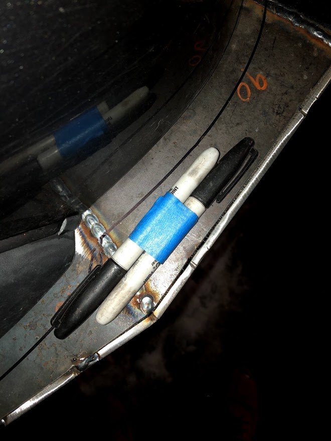

    The pen trick worked a treat, by taping them together it gave me 3/4" clearance between the body and the bumper. Did a semi final test fit last night before my final weld pass. Looks decent!
    I had my heart set on a single hoop that follows the grill line and some little side supports, but then I just seen @EatSleepTacos bumper and noticed he's got a long and low bar..... Damn!... Decisions decisions.....

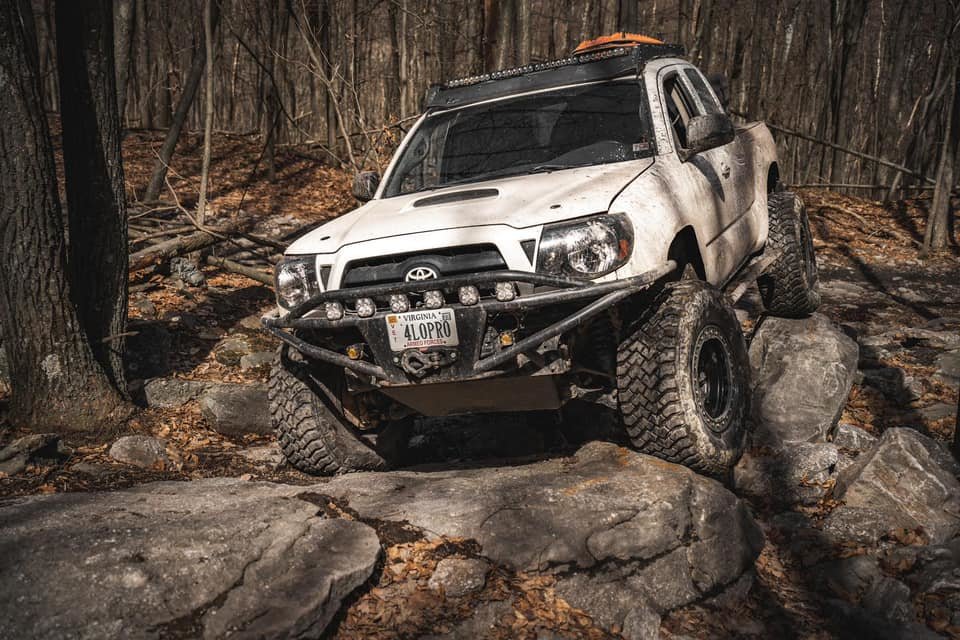

    I originally added my low bar out of necessity for the pods but it ended up really tying the bumper together. It's about 3/4" in front of the face of the pods so if I bump into a tree I don't need to worry about breaking the lights anymore.

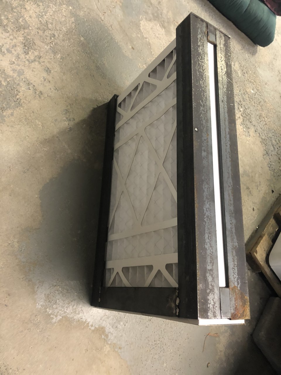

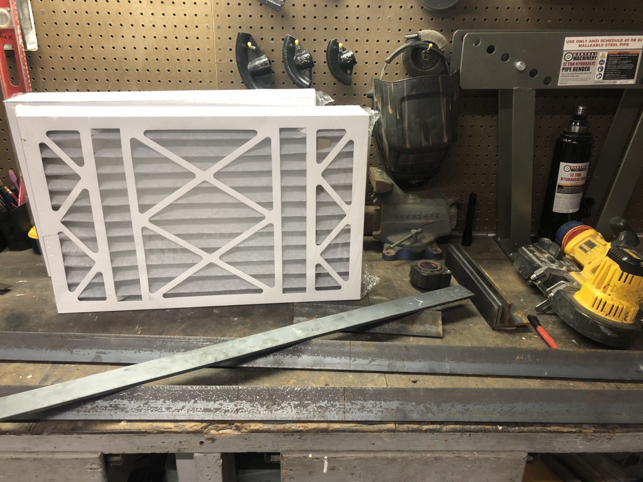

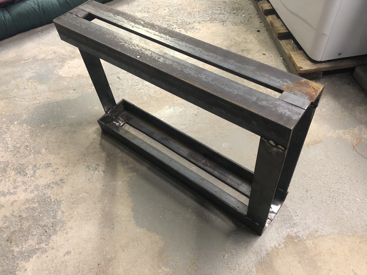

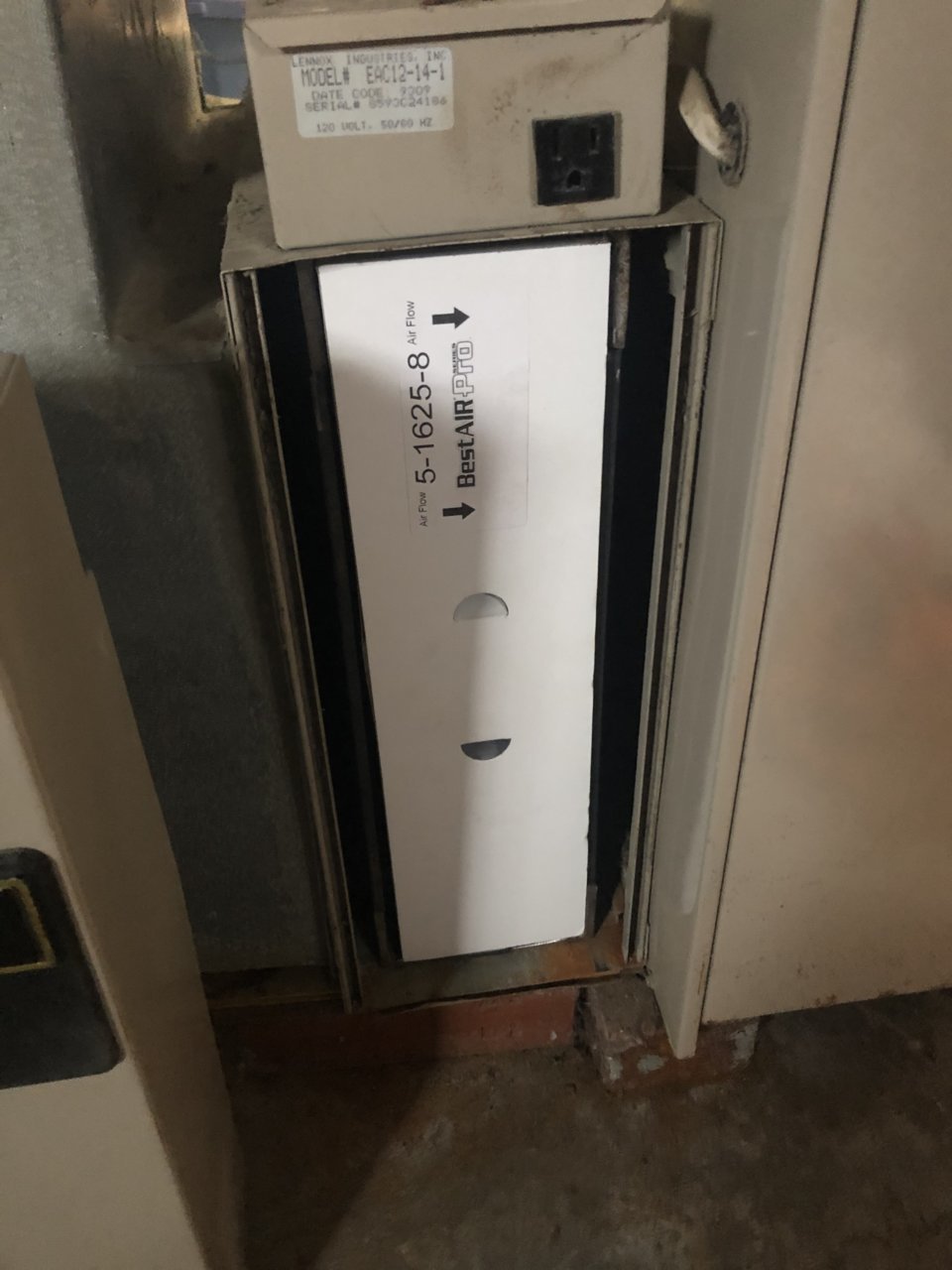

    House has an older furnace, and an electric air filter that doesn’t work any more. There’s not an exact fit filter for it so I made a heavy duty box for it out of scrap angle. It fits in nice and SNUG now!6BB12DBE-445B-49EF-98C0-6C3AC94D652D.jpg 2BB34D8A-AC0C-46CA-AC50-3A7F6BAF74C1.jpg D99D2793-2D96-42EC-A590-540D45EDB973.jpgA2835325-AD7E-4A55-9A52-CF4236AE624F.jpg

    that's pretty cool.
    tell me more about this electric filter.......

    well I’m supposing it would negatively or positively charge the panels that used to be inserted and the dust,hair,whatever would attach to the filter like static cling. Then you could remove the panels and while them off. This is all speculation lol

    that's neat,
    were they a PIA to clean?
    I'm guessing they are pretty expensive since your not replacing the units, but going with a regular filter

    hopefully I made the right choice. Was going back and forth between the 252 vs 255. I would say that I won’t fully use the machine to break it during warranty so I am trusting the new inverter tech base on reviews

    Honestly I don’t know, i talked to somebody probably a year ago about it I just can’t remember......I’m a wealth of knowledge lmao I think the actual filters themselves might have been fine the power supply to them I think was fried
