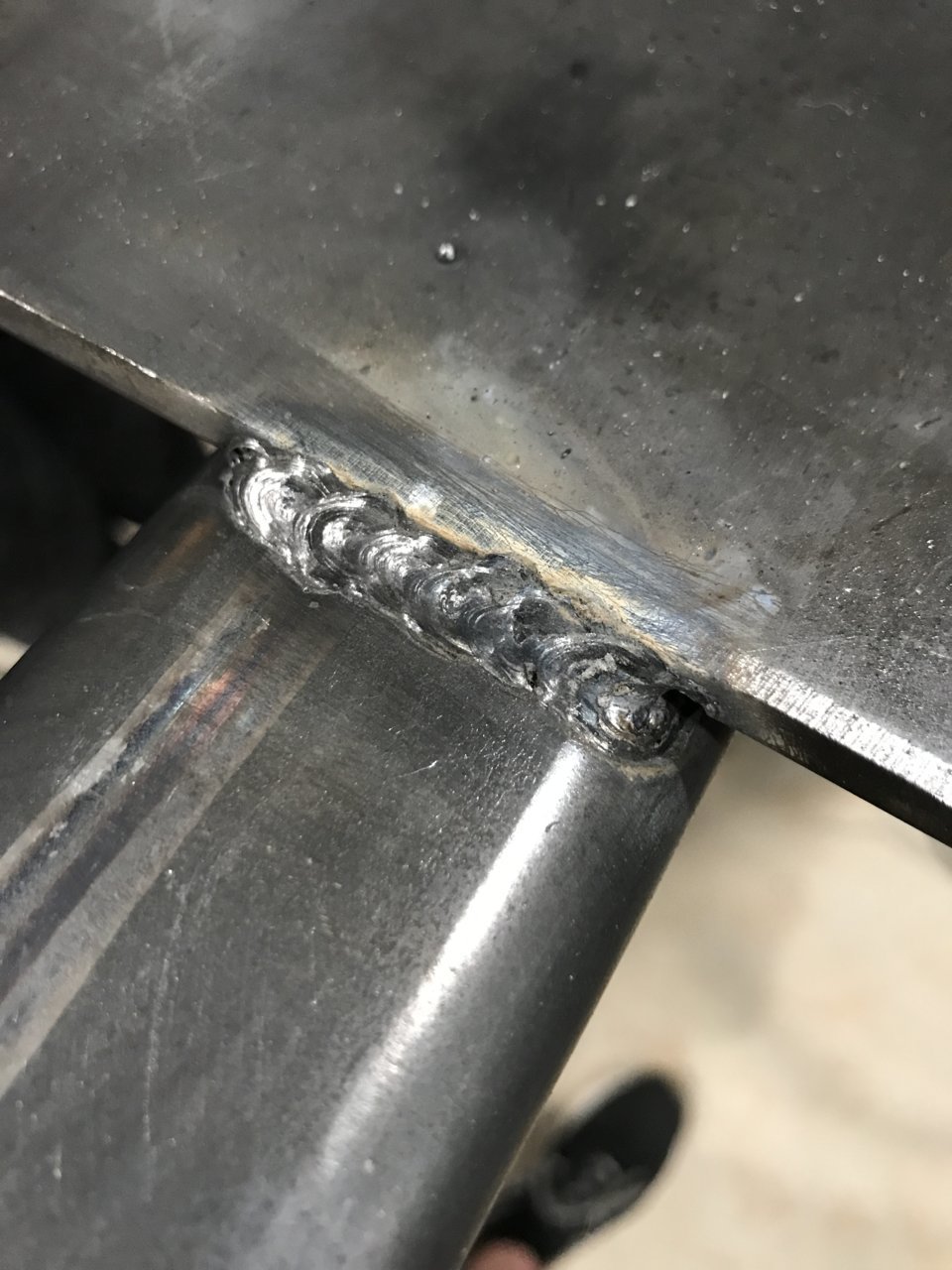

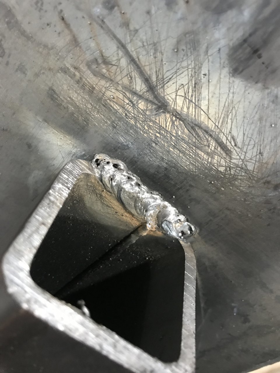

    Are you dragging? Also did you make sure to set polarity correctly? It’s opposite from gas shielded. There should also be a separate wire feed knob just for flux core. You don’t want too much pressure on the wire feed because it’ll crush the wire and cause porosity.
    Not saying I necessarily see those things in your welds, just want to make sure you’re setup for success.

    yes, I’m dragging and yes, I switched the polarity. You statement would explain the porosity in the first weld because the wire speed was up higher, yeah?
    not sure what you mean by separate wire feed knob.

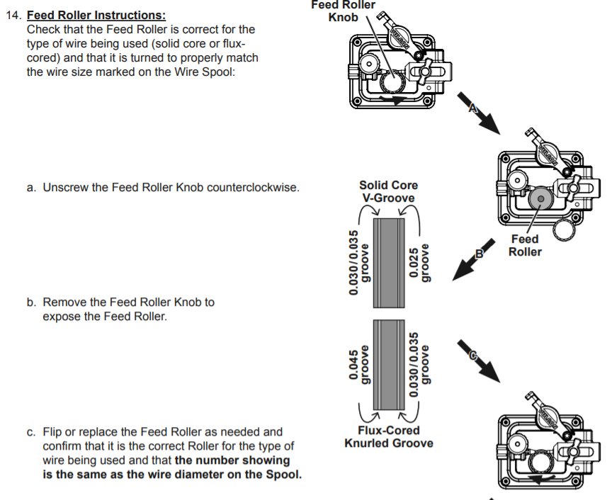

    I'm sure it's welder dependent, but on my welder, I have various sized wheels for the different sized wires. One is specific for flux core. It sounds like you've got it all setup correctly then and it's just a matter of practice.

    That is an excellent question. My welder does have different grooves for different wires, I wasn’t aware this would need to be changed for flux core though. I’ll check it out, thanks!
    To your question about dragging, are there different techniques you’ve found to be successful with flux core? Maybe a straight drag as opposed to a an “e”?

    Yes, flux core needs the knurled groove rollers - the v-groove rollers are for solid wire and can crush the flux-core, creating feed problems.
    Unsure of straight vs e dragging - the main reason for pull vs push is that the shielding is generated by the flux and by dragging that occurs over the leading edge of the weld pool thus shielding the weld as you go. With gas/solid-wire the gas flows ahead of the nozzle, so you're able to push.
    At least that's how I understand it to be.

    IIRC the flux one has grooves in it to bite the wire a little since you can't use as much clamping force on the wire itself.

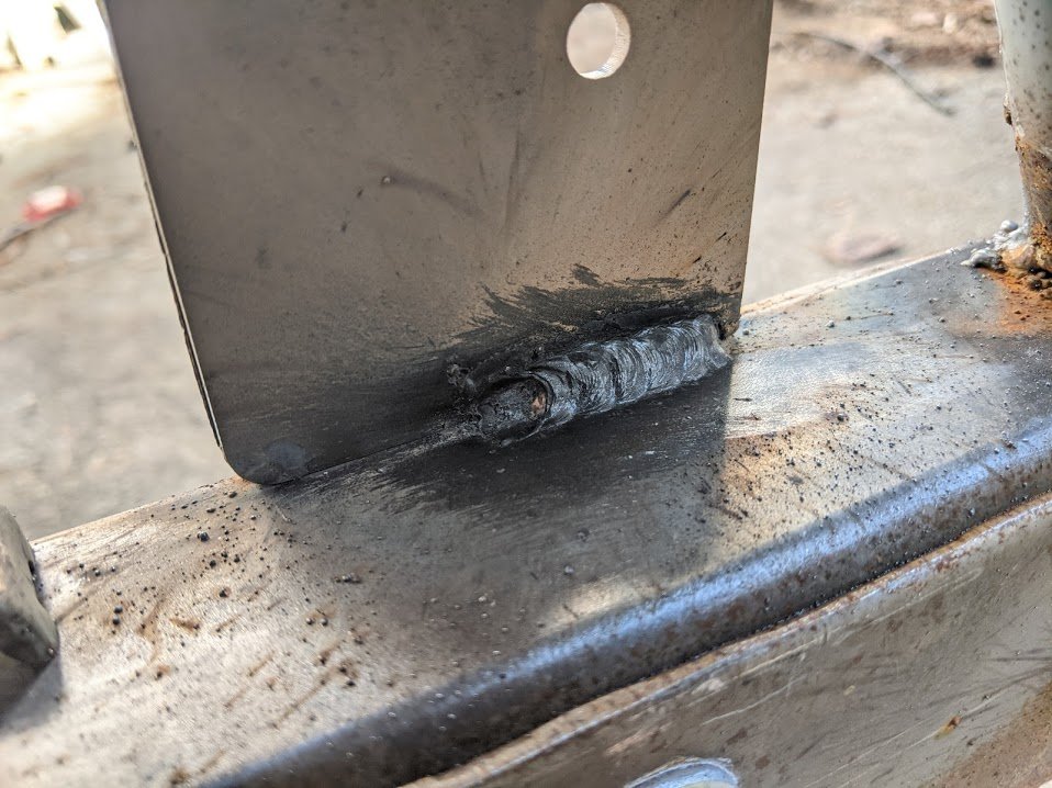

    As far as technique, it's been a hot minute since I've had to use flux. I think I just did crescent moon shapes, kinda like a C. Here's one of the few pics I can find of when I was using flux wire. This was cleaned up with a wire brush but still, looks pretty good if I say so myself.

    That does look pretty good. :101010: Thanks for the info gents! I'll play with the setup some more and lay some additional beads.
    Is there a reason you chose to do flux over solid wire for a relocation in the pic?

    Only because I hadn't ponied up and bought a tank of gas yet at that time. Since getting gas a couple of years ago, I haven't even thought about touching flux. I have a 1lb roll as a backup but that's it.

    Like everyone else mentioned, the grooved/knurled feed wheels are for the Flux. I use flux because I usually need to drag it inbetween places to use it and can't drag a bottle everywhere.

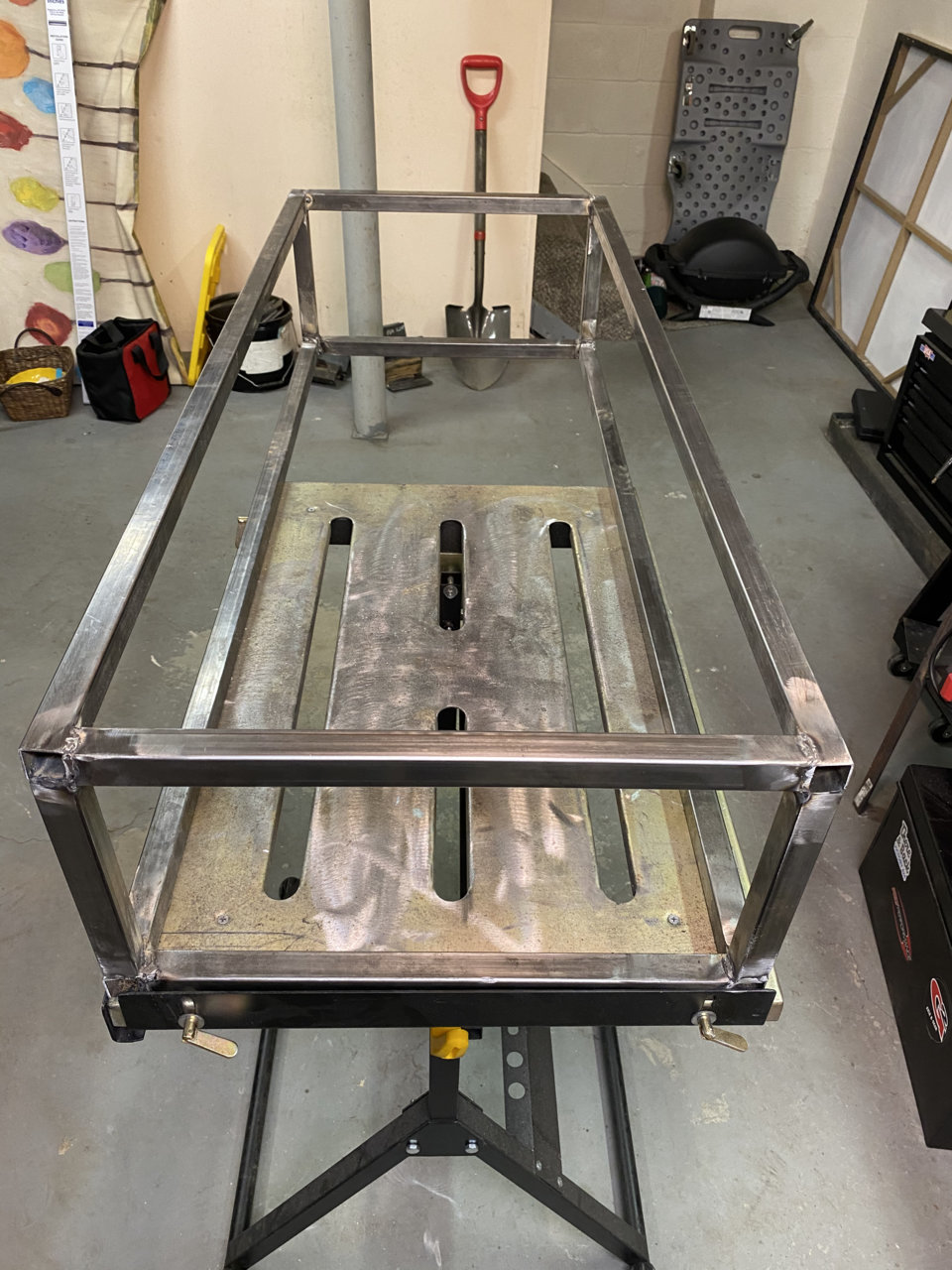

    Working on custom drawer for bed. Decided to use some 1/16 tube as the frame. Will box in with 1/2 plywood. Never worked with this thin of material so there def is a learning curve. Couple of blow throughs so good opportunity to practice my fill ins.

    Nice. Look into "stitch welding" technique if you're getting blow through.
