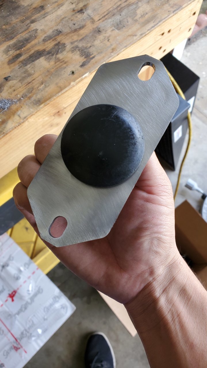

    This is what those pieces are for. Low profile bump stops. Still need weld and paint.

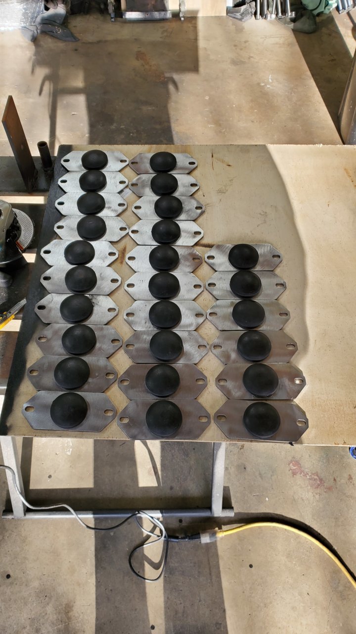

    Just need to paint em up now.

    How thick are those bump stops? Or product link? I may have a use for them.

    The bump stops themselves or the whole piece i made?

    Yup those are the ones I use.

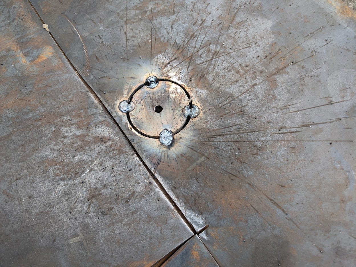

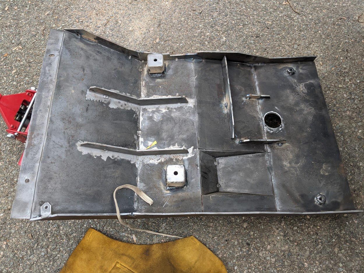

    Making progress on the skid, but not quite done. Unfortunately don't have time for two more weeks to finish. Also didn't feel like putting it back on and it getting all rusty again from being unpainted, so the 4runner is going naked for now

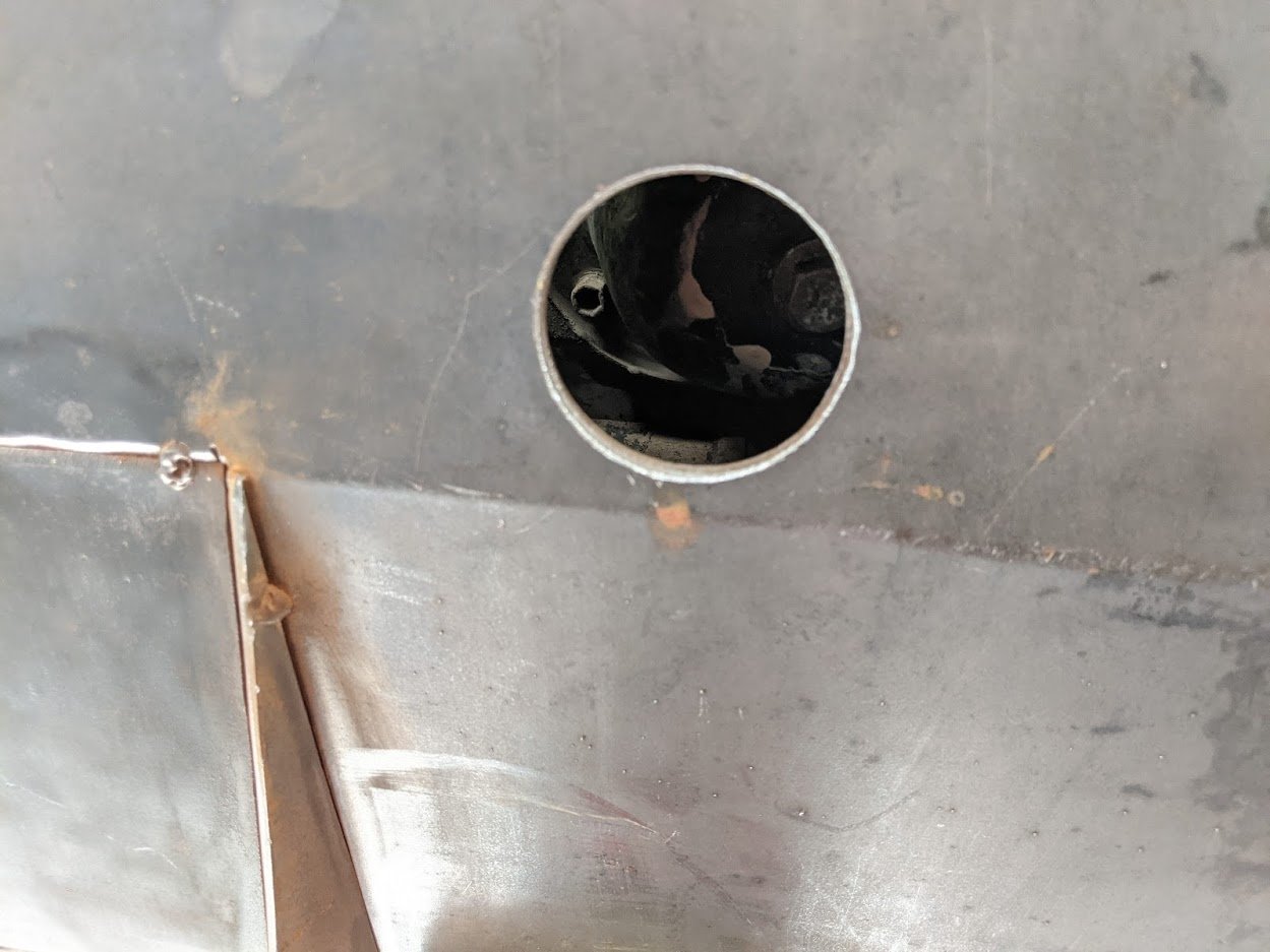

    Messed up the hole for the oil drain, thankfully i could just hot glue it back in and try again

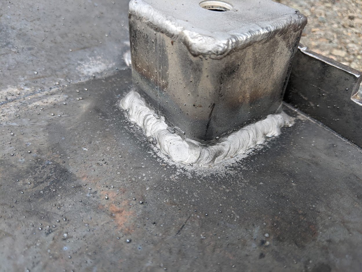

    And added the braces, nothing fancy, just fit what I could around the diff and oil pan
    WeRxiCvtIljxGP8cato6ht1ZS_Aiqw4pq1liOF4a_ed3beb6396d79db13a785f29a6bd226a3cbd6c1b.jpg
    Not perfect, but I am getting better at rounding corners.

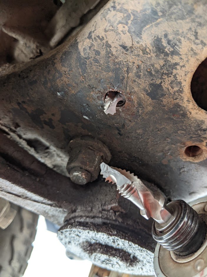

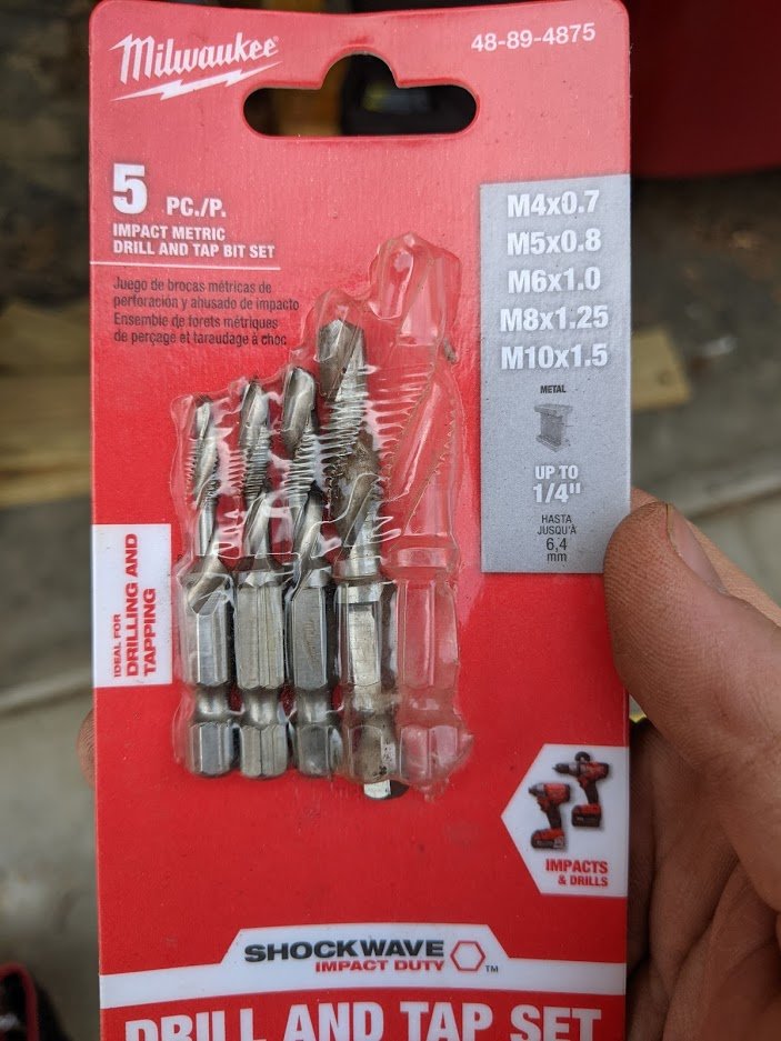

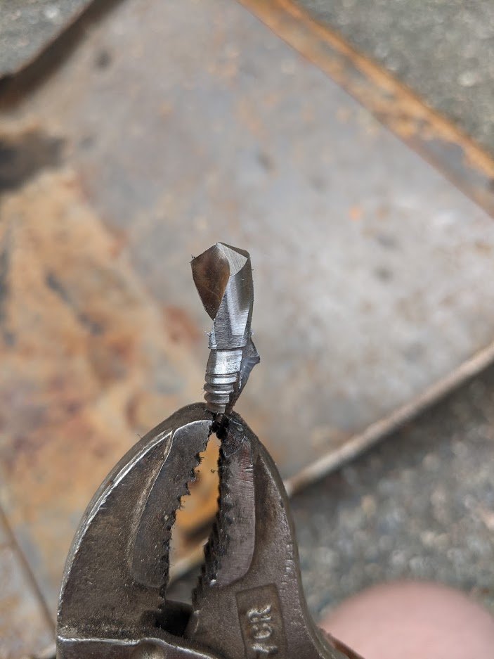

    BTW these "impact rated milwaukee" drill tap thingies aren't really impact rated lol. Tapping my stripped m8 weld nuts for m10 I was using a smaller and older 12v impact (read low power) and backing off very frequently to clear chips, and it still broke off on me. thankfully was able to get the chunk out in one piece with some vice grips. It was most of the way through, so I was able to use whatever was left of the tap thingy to finish tapping the holes

    Was the hole for the most part predrilled to the starting bit size? Wondered if that would make a difference.

    For the tap thingies? Hole was already drilled and tapped for m8, but they got boogered up when my stock skids got snagged on something. The drill taps have a drill section on the front portion of them, so the hole was properly sized by the time the thread tapping section engages. Actualy thickness to the tapped area was less than 1/4" that they're rated for, so I dunno if they just got caught weird or what
    When it broke, I hit it with a needle scaler to try and disintegrate it out of the hole. That loosened it up but didn't break it. The I just turned it out with vice grips

    I know they say impact, but I can't imagine them not breaking with an impact.

    This lol. In that case where you were chasing threads I think you would have been better doing it by hand. In this case you risk cross threading which could snag and break. Drilling and tapping is such a delicate process, never even seen anything impact rated.

    Yeah I was skeptical of that too lol, but I hate tapping holes upside down and was hoping they would be a good solution. I was using an older and weaker 12v impact, no where near the power of any current 12v milwaukee tools, I was bummed when it broke. Wasn't like I was just ugga dugga plowing it in, I went back and forth to clear chips, but oh well
