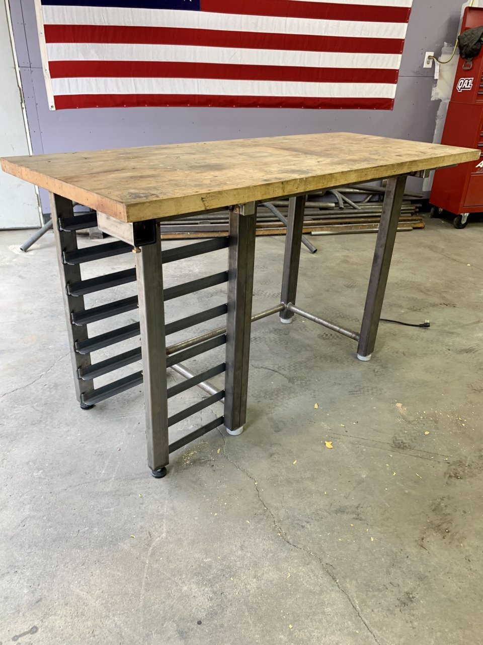

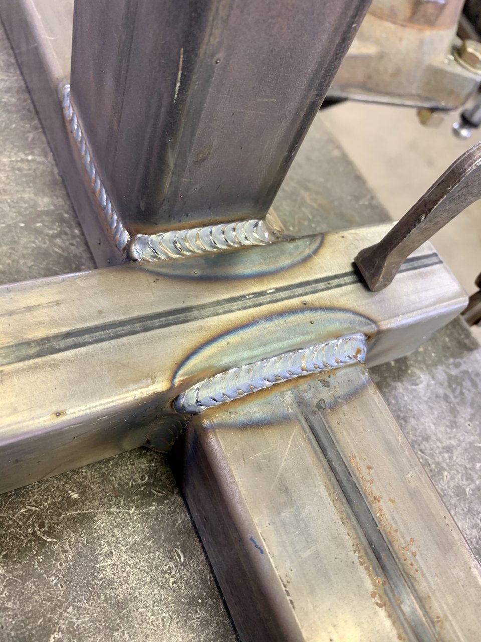

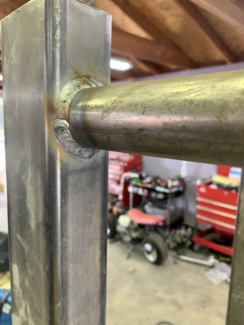

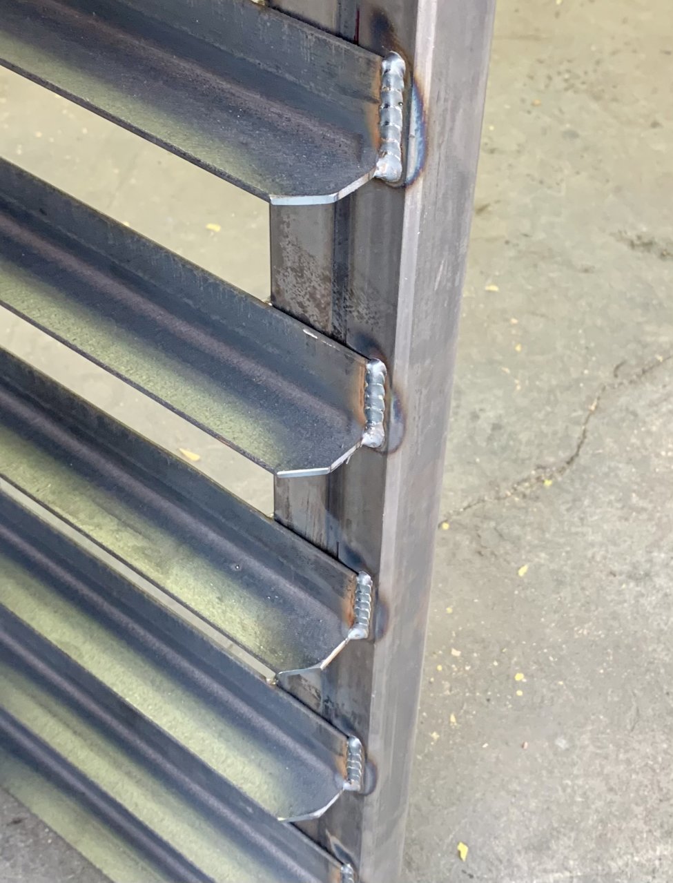

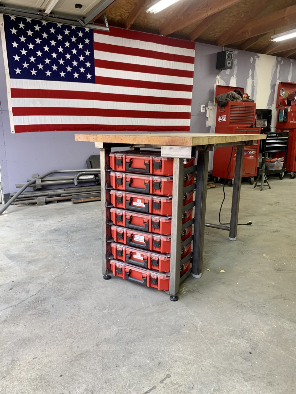

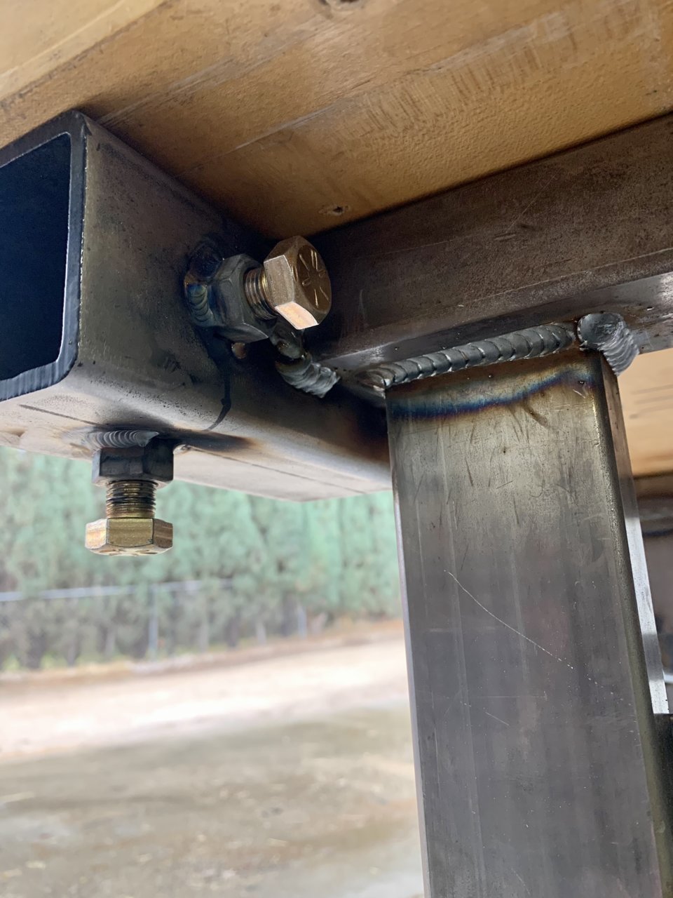

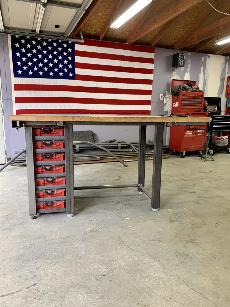

    Finished up this workbench for my garage. Made it using scrap and an old butcher block top I had. I wanted to try something different so I fit everything tight like I normally would, but I didn’t do any sanding or prep to the weld surfaces prior to welding. Wanted to see how much it would affect the end result. Prepped surfaces definetly weld better, but it’s not a huge difference, but I’ll stick to prepping everything. I left it raw for now, gonna use it a few months so I can decide what else to add to it. Then I’ll get it powdercoated

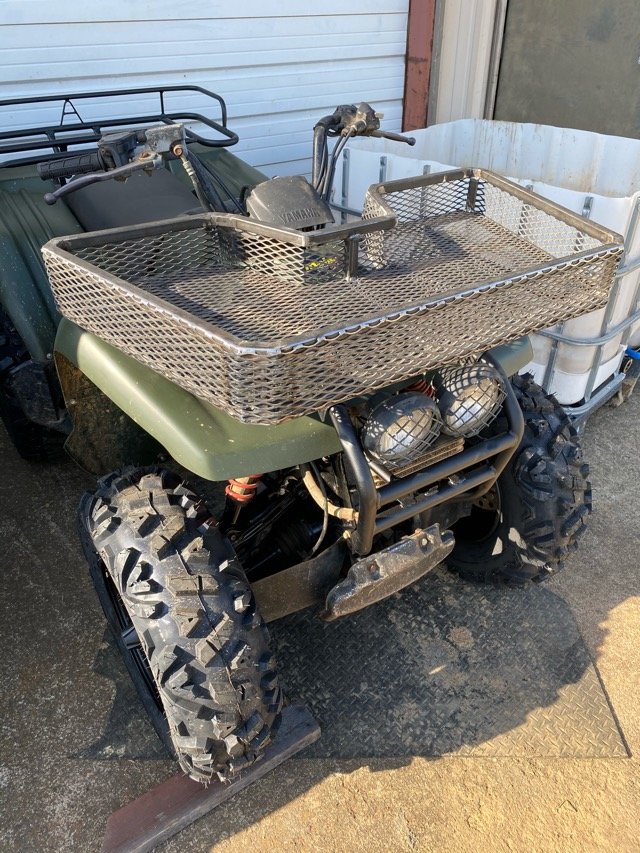

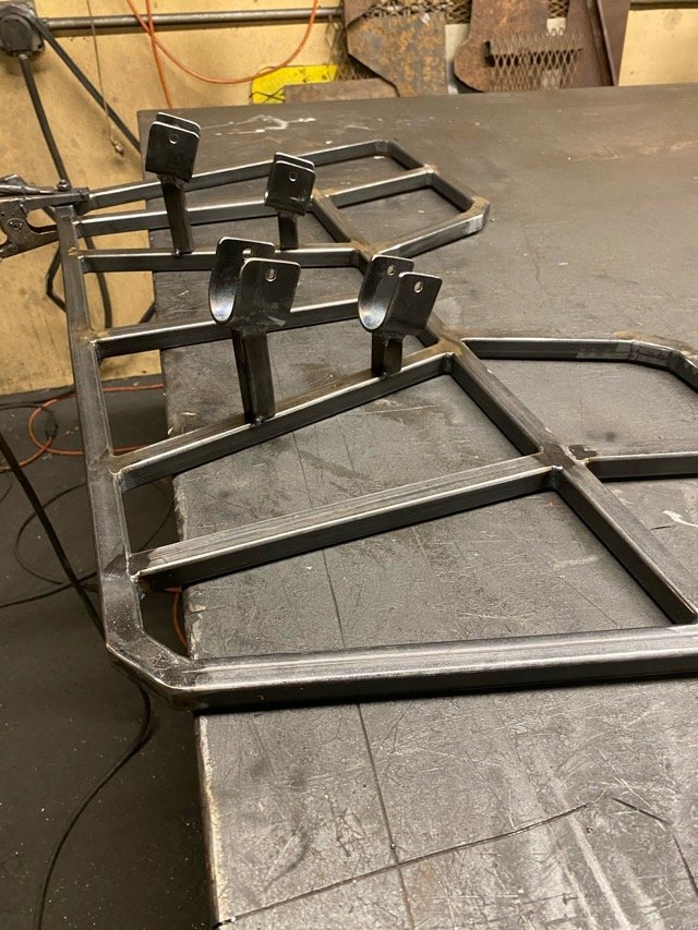

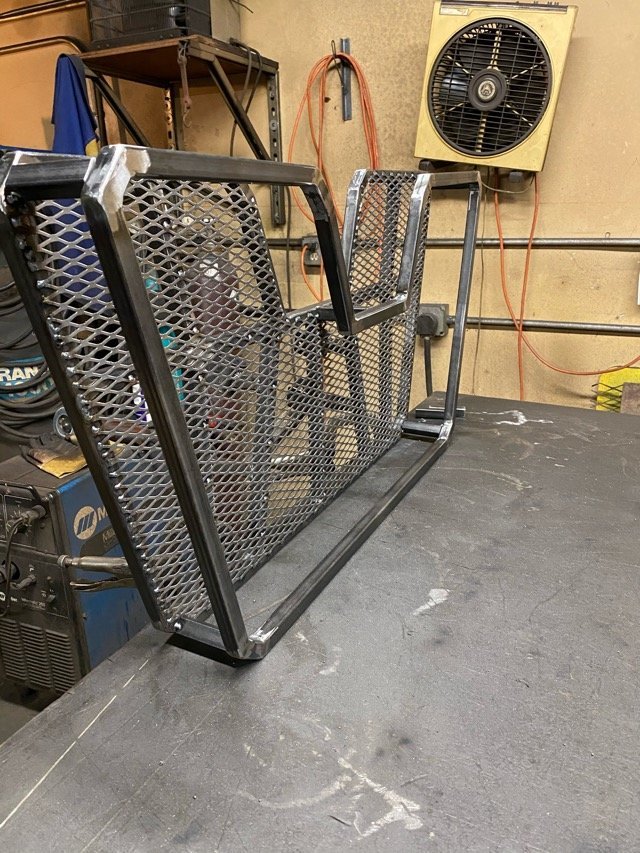

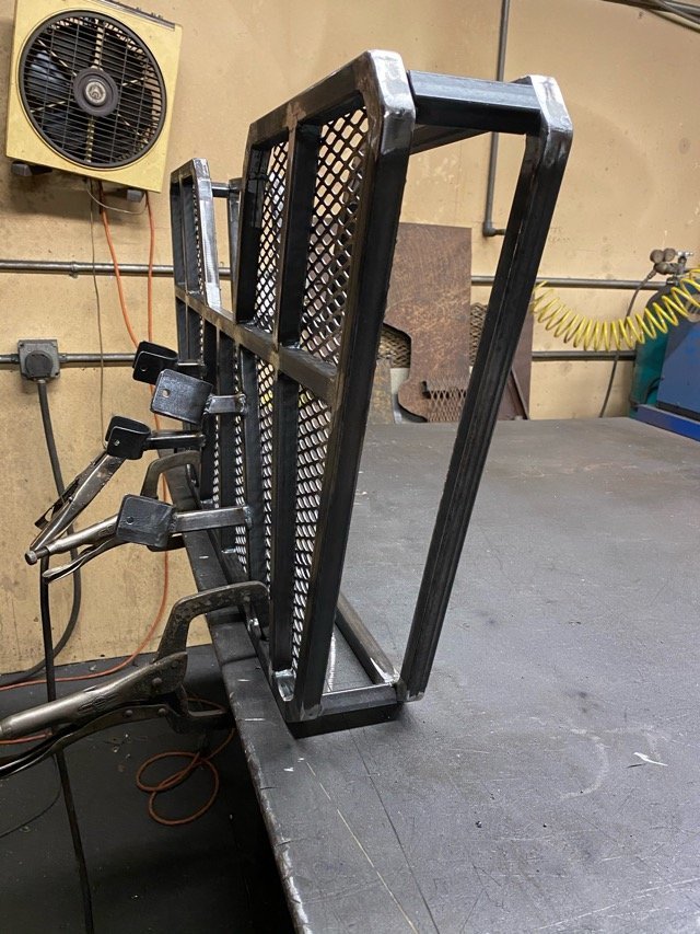

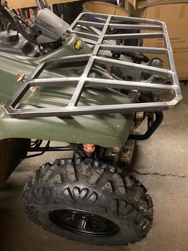

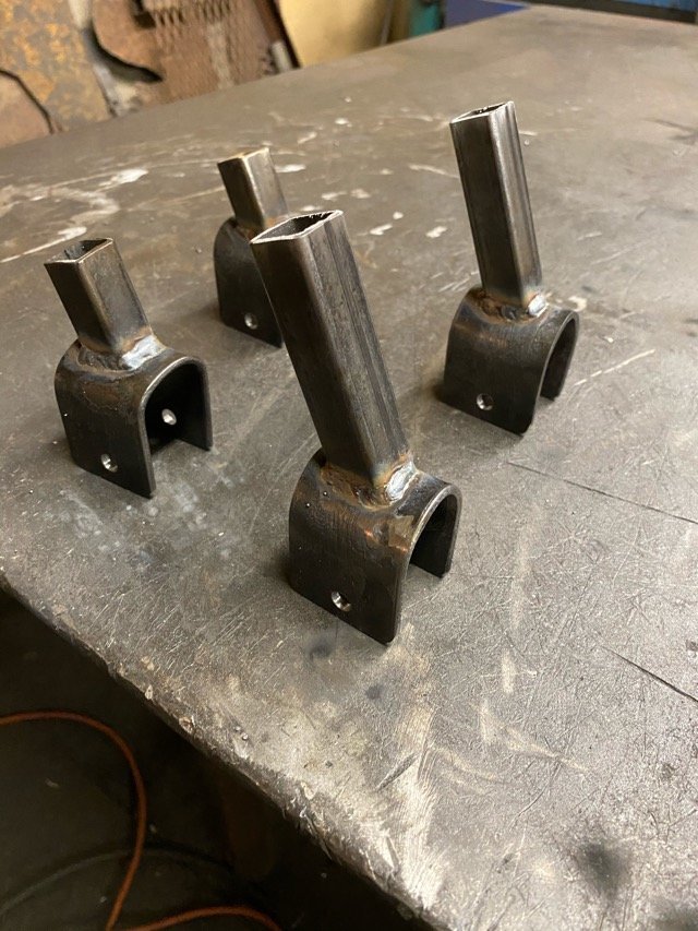

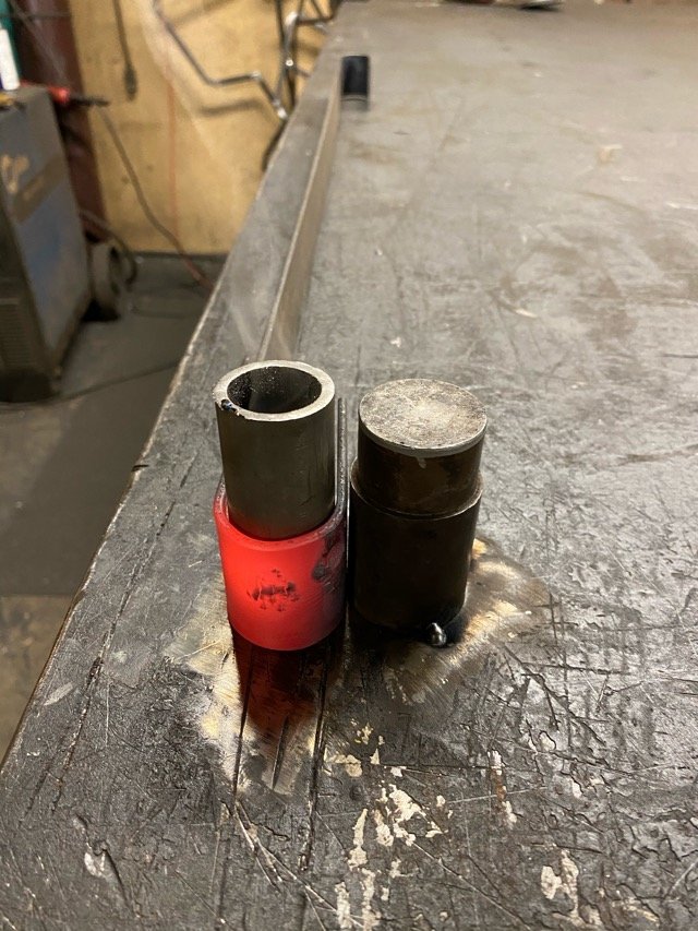

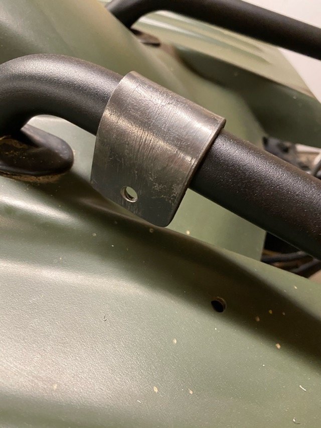

    Been building a basket rack for the four wheeler off and on over the last couple weeks.

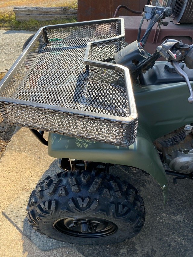

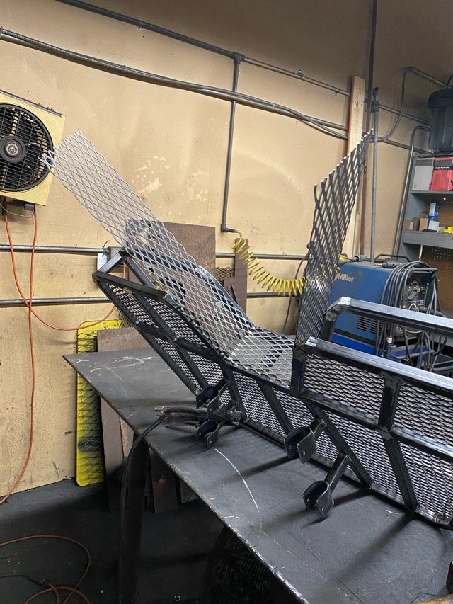

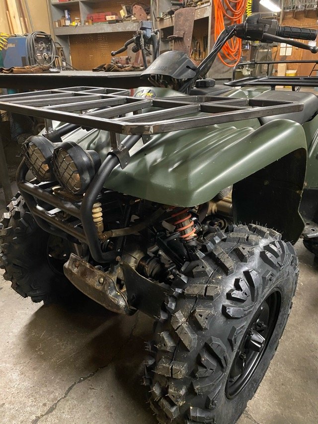

    Rack is done.

    Any cutting oil? I know it’s messy but even a drop helps.

    Drop bracket lift and booger welds
    So clean :cheers:

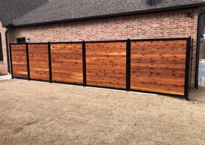

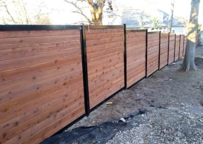

    Recommendations needed.
    I am building a fence on the side of my house.
    4 sections 6ft apart. Slanted, loosing 6in each section. 5 posts total in at least 2ft of concrete. The ground in my house is hard a f@ack, no need to go full 3ft.
    First section 6ft tall, last section 4½ft tall.
    I would build a rail so the planks just drop down, then build a cap rail for the top.
    1. Thinking of using 3X3X.120 square tube for posts
    2. I will be using planks/pickets, however I'm looking into composite as opposed to cedar or redwood.
    Opinions on post specs?
    This is what I have in mind.

    thats an awesome bench.

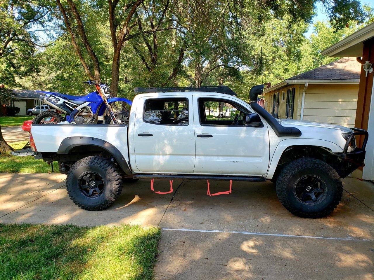

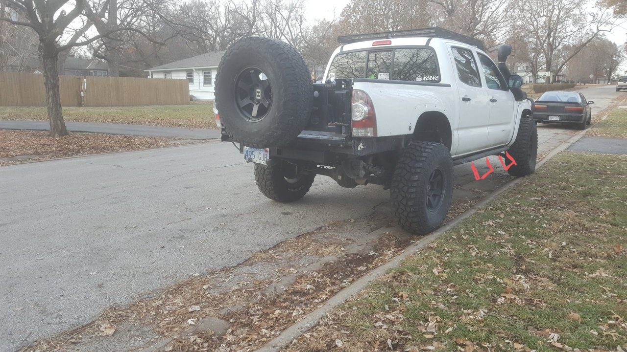

    anyone have suggestions for welding a step to sliders? i have bamf sliders and was thinking 1/8th" thick drop downs and then a simple angle iron between the two legs with maybe some expanded metal on top
    any suggestions on where to locate fore/aft on the slider would be great as well
    fiance is driving the truck and we have a newborn. truck isnt being offroaded anymore anyways
    Excuse my crude drawings on my phone

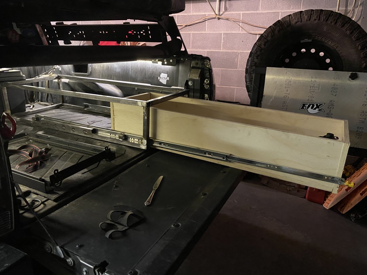

    For got to post in here, but here is the frame for the drawer system a wrapped up on Sunday. Was a fun project.

    I'd be surprised if there wasn't a bolt on step someone sells.
    Edit: Probably the wrong size tube but same idea
    https://www.amazon.com/dp/B001ONIONW/ref=cm_sw_r_cp_awdb_imm_FCKWF286534G5BF9JAJG?_encoding=UTF8

    id personally for a bolt on step

    Not a bad idea. I was thinking the angle of the slider might make it awkward since they would be angled instead of straight to the door.
    Those are pricy too. Lol. I was thinking less $50 i could build some easily. But ill look more into bolt-ons.
    Some tube clamps could be welded to so they still bolt-on?

    I always support DIY :thumbsup:
    I also support the bolt on idea.
    This will make it more expensive, but ideal I would think.
    https://www.amazon.com/Universal-Fabrication-Connector-Tube-Clamp/dp/B01N31DW77
