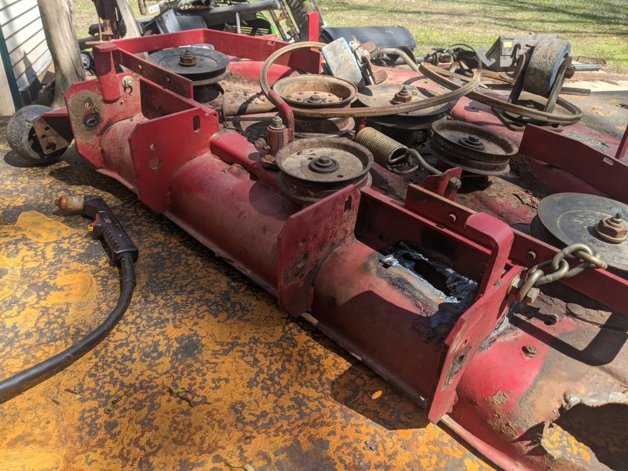

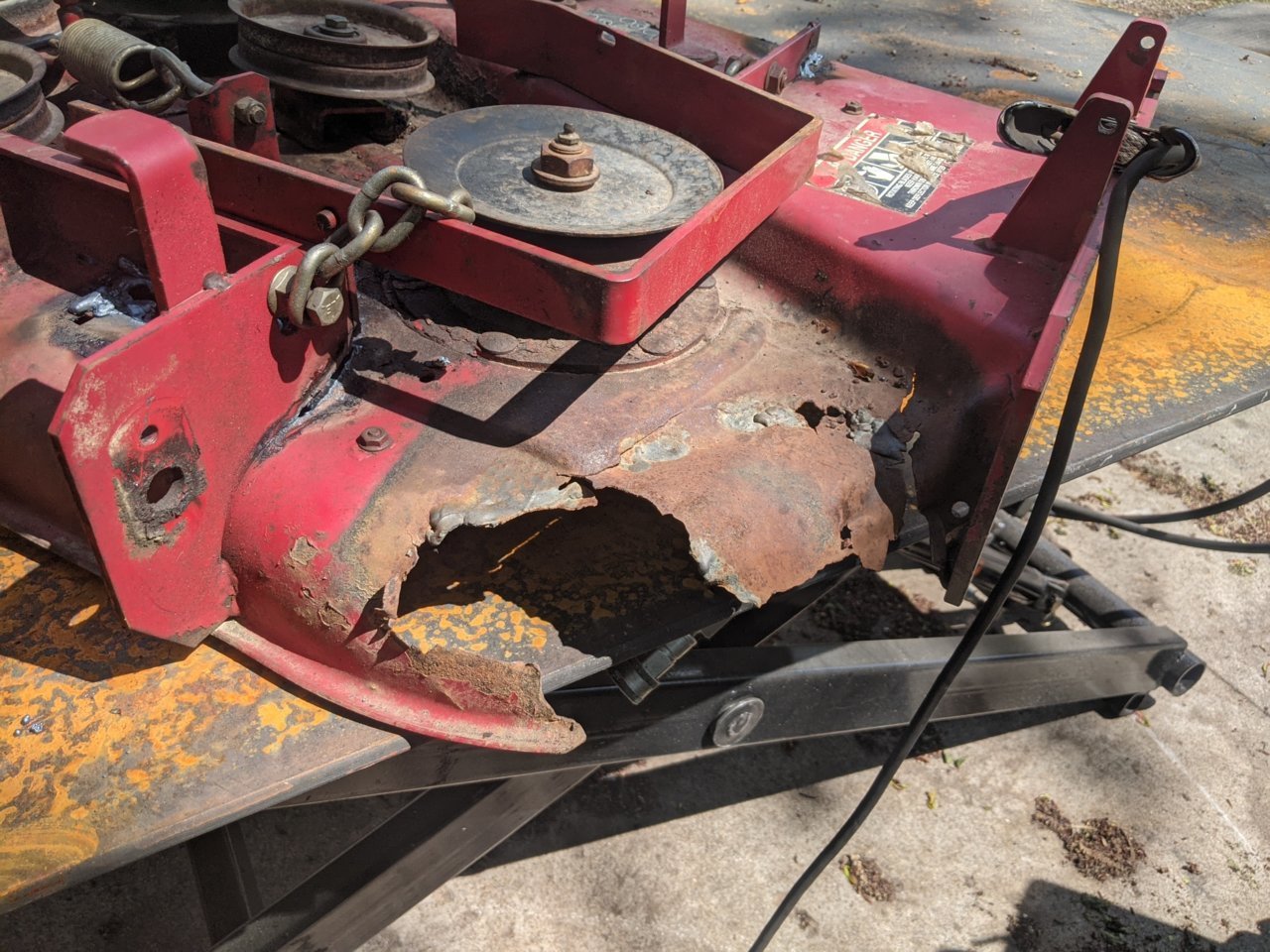

    Doing some "MaGyvering".
    Mower deck is beyond salvage.
    Found a doner that is the same width, but had many differences when it comes to brackets and hangers.
    Cutting off brackets from the rotted out deck. Gonna try to make them fit on the new deck.
    I have no idea if this will work.
    I'm posting my progress. If it ends in the scrap pile, you guys will know it 1st.
    This deck is not savable. The other side is worse and all spindle flanges are paper thin.

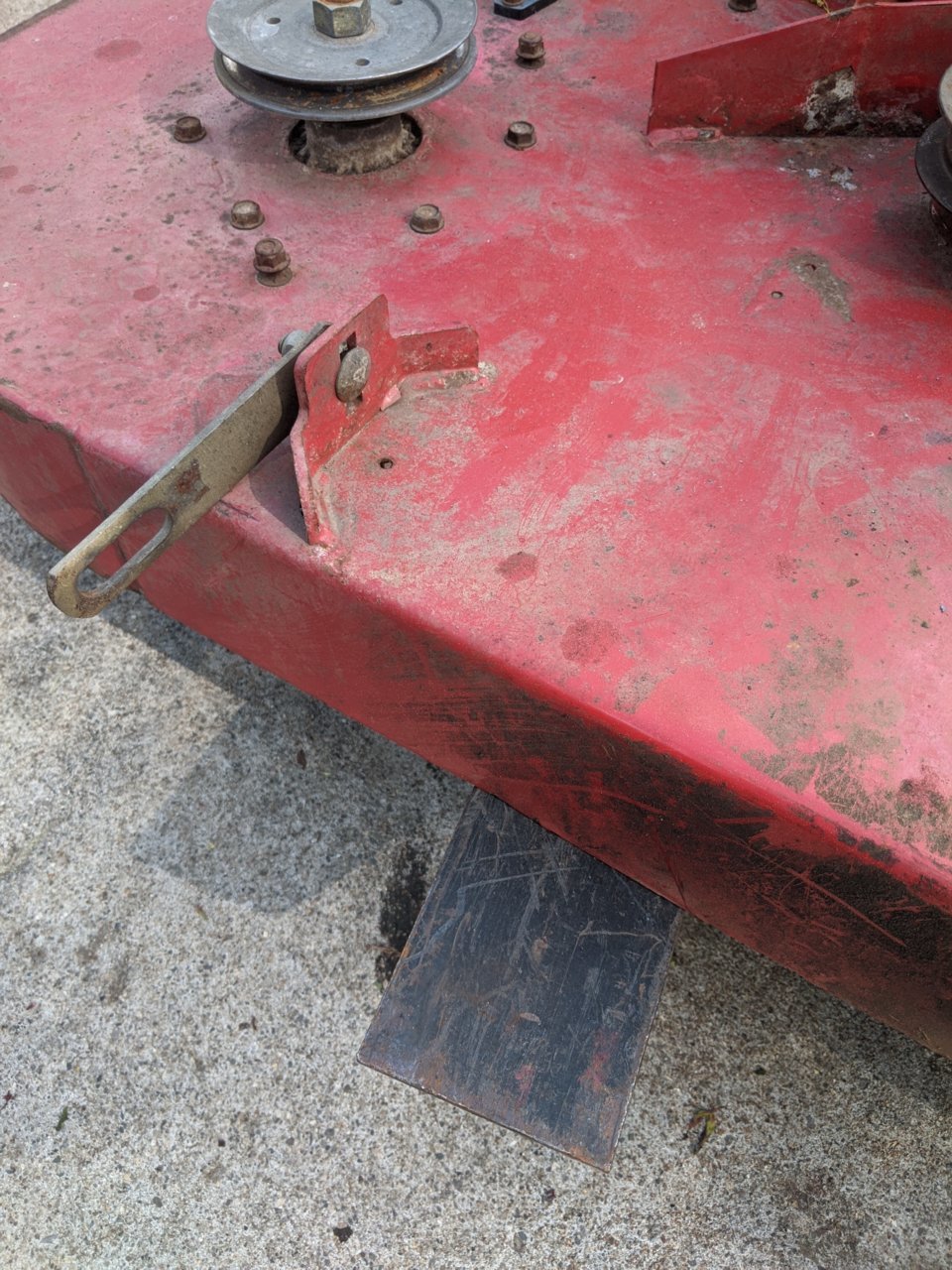

    Notice the curve of the back of the deck where the brackets are welded. The doner deck is not a stamped steel deck and does not have that curve.PXL_20210502_192753484.jpg

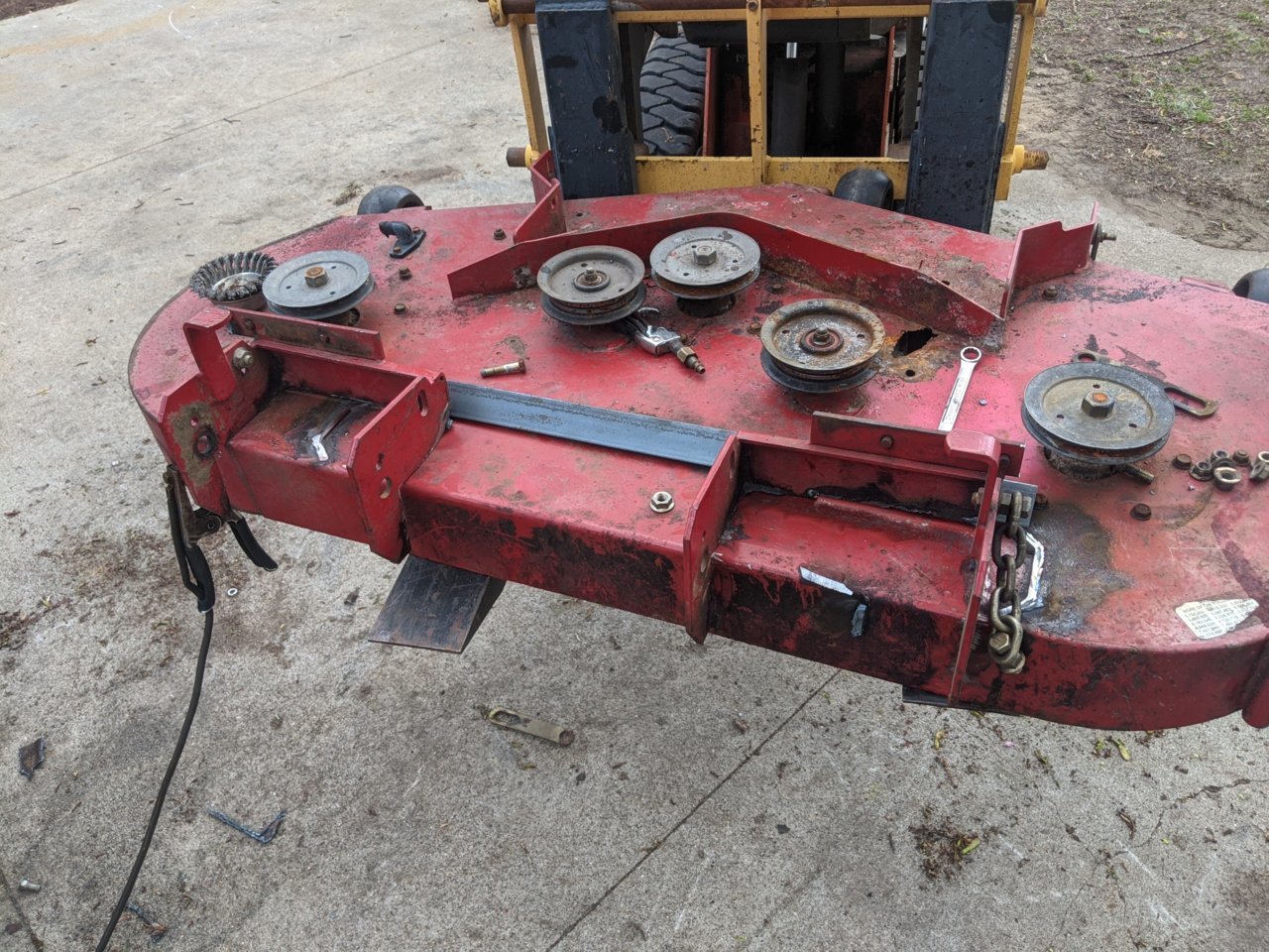

    Got the brackets cut off. The job really sucks even with a plasma.PXL_20210502_204304968.jpg

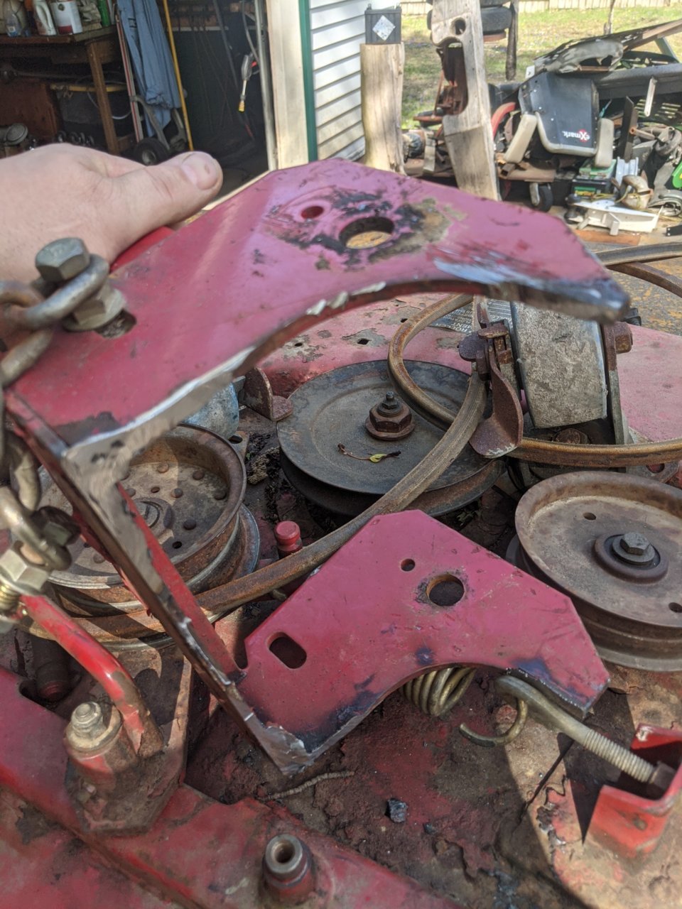

    Need to notch out the brackets for the new deck. Portable band saw made quick work of that.PXL_20210502_204317166.jpg

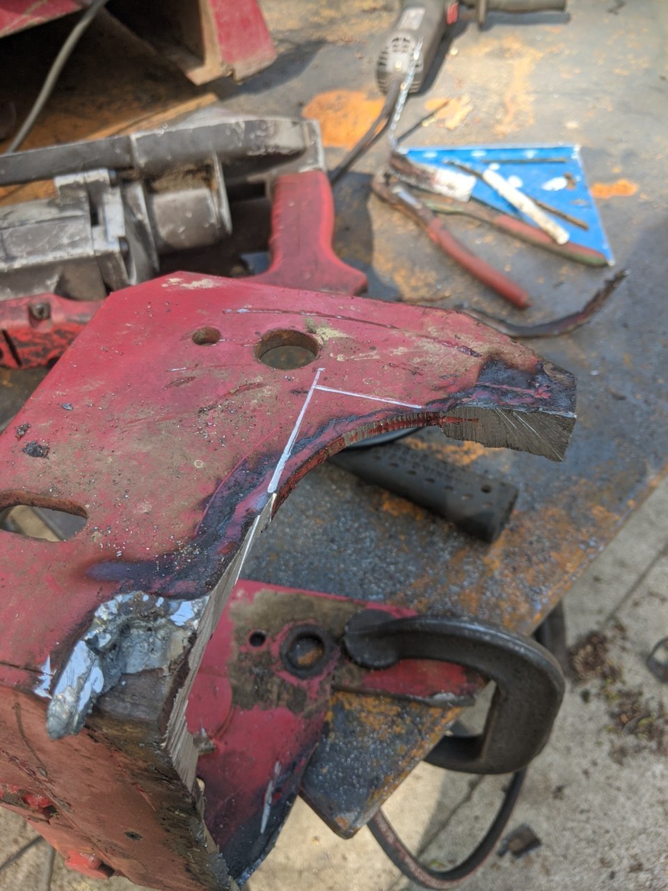

    Mock fitting the brackets on the doner deck.
    Like I said. I have never done this before. It's gonna work or it's gonna be sent to recycling.
    Those small brackets in the first pick had to be removed to allow the brackets to fit properly.

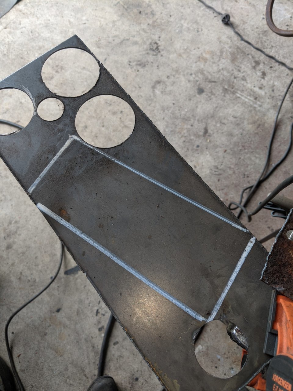

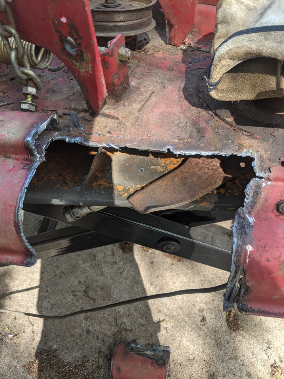

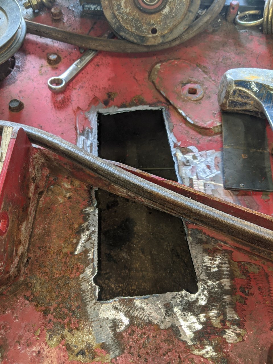

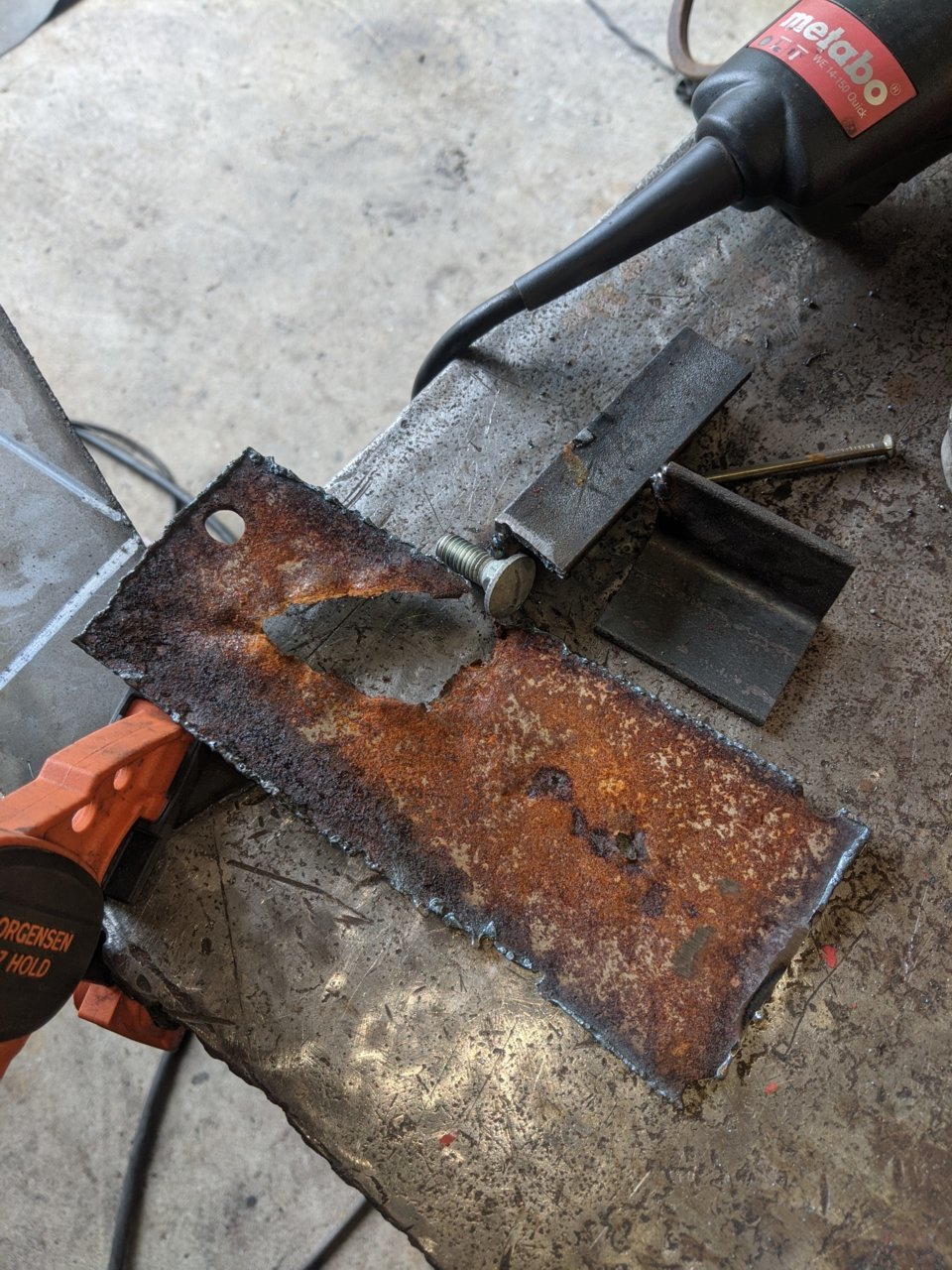

    Found a thin spot in the deck. Cut out the cancer.PXL_20210504_151520595.jpg PXL_20210504_151529042.jpg PXL_20210504_151533303.jpg
