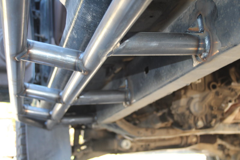

    Drop bracket lift and booger welds

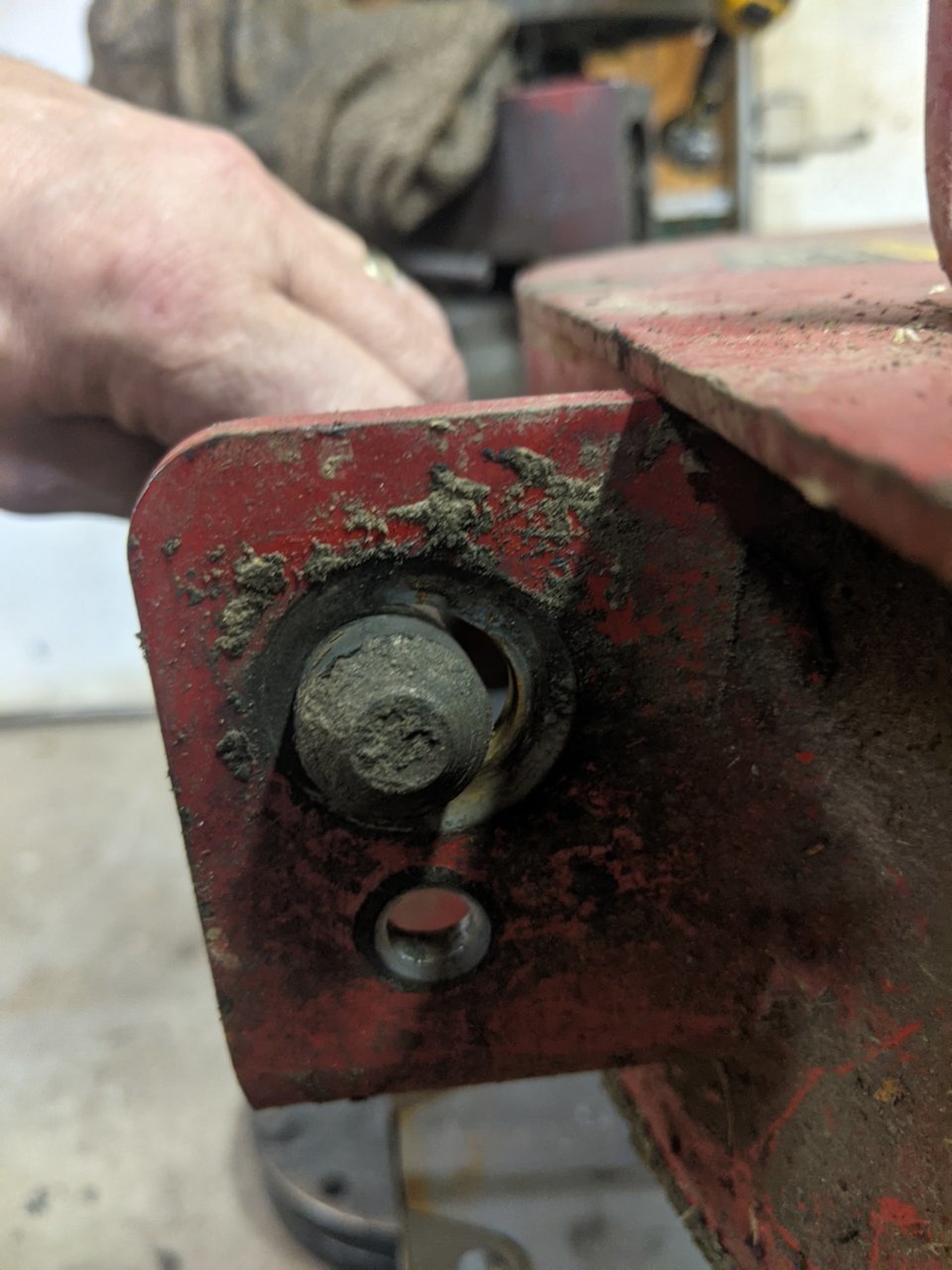

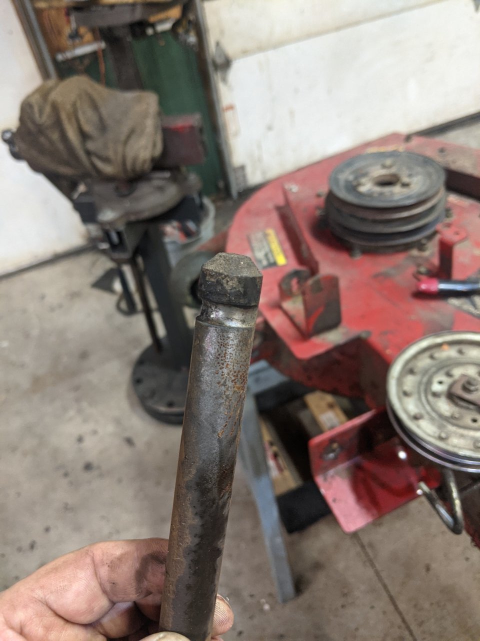

    Wallered out pin hole. Wore out pin.PXL_20210522_204949783.jpg PXL_20210522_204935576.jpg

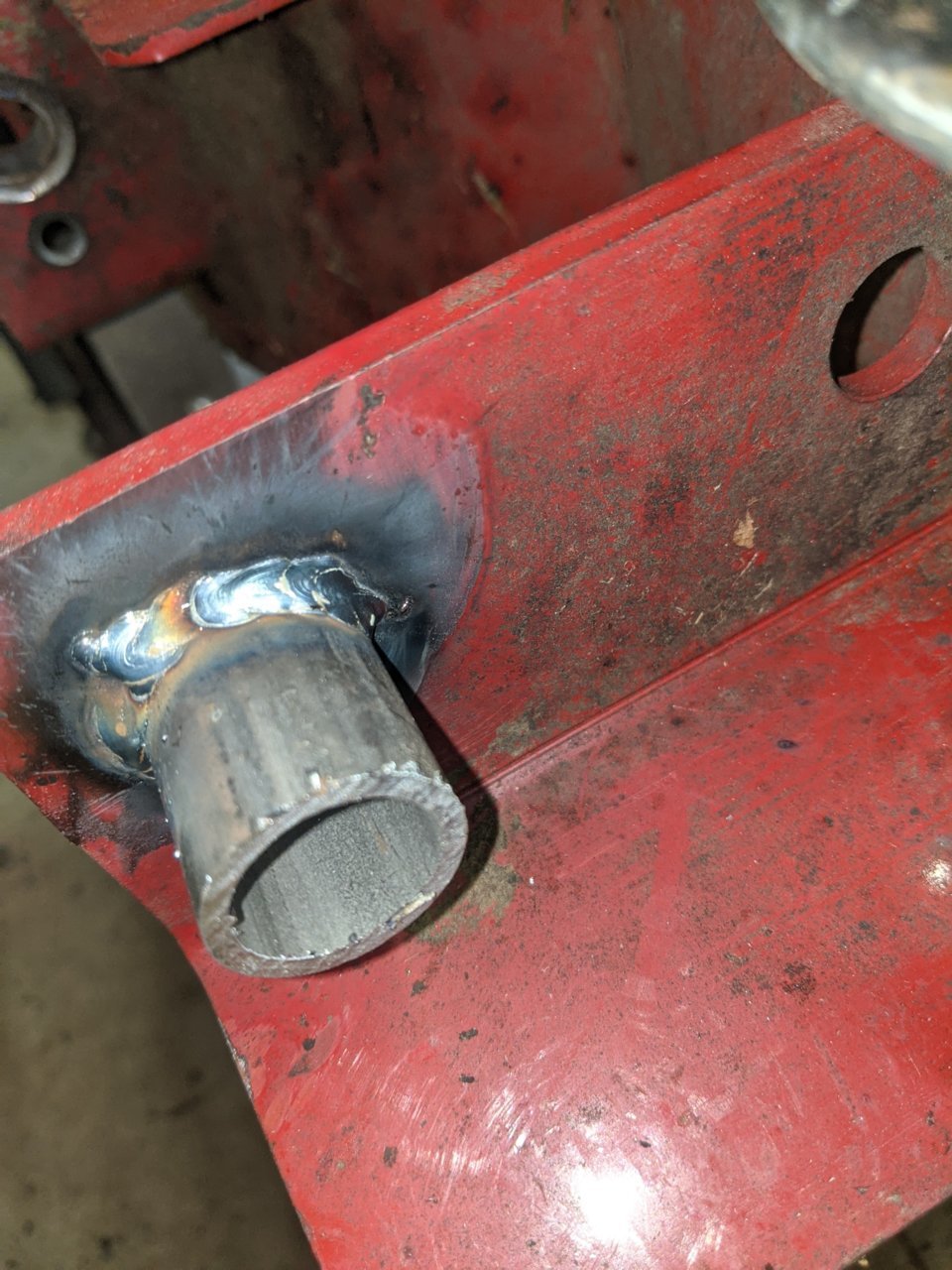

    New 3/4" rod and 3/4" pipe for pin bushings. Using the rod to keep bushings somewhat true.

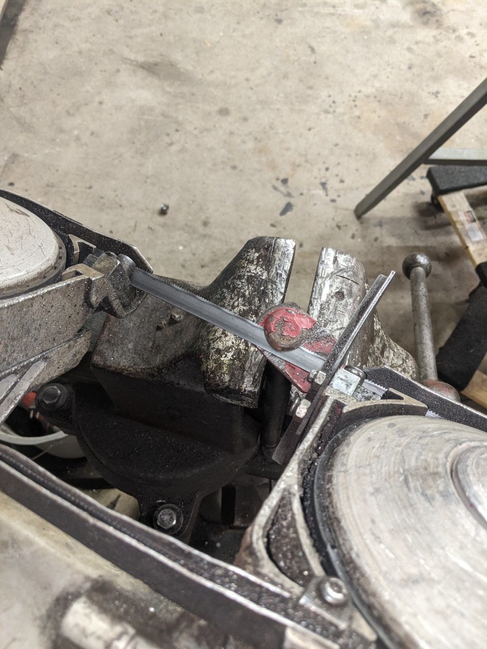

    Bushings tacked in.

    Bushings welded in and excess getting trimmed off.PXL_20210522_210456973.jpg PXL_20210522_211004344.jpg

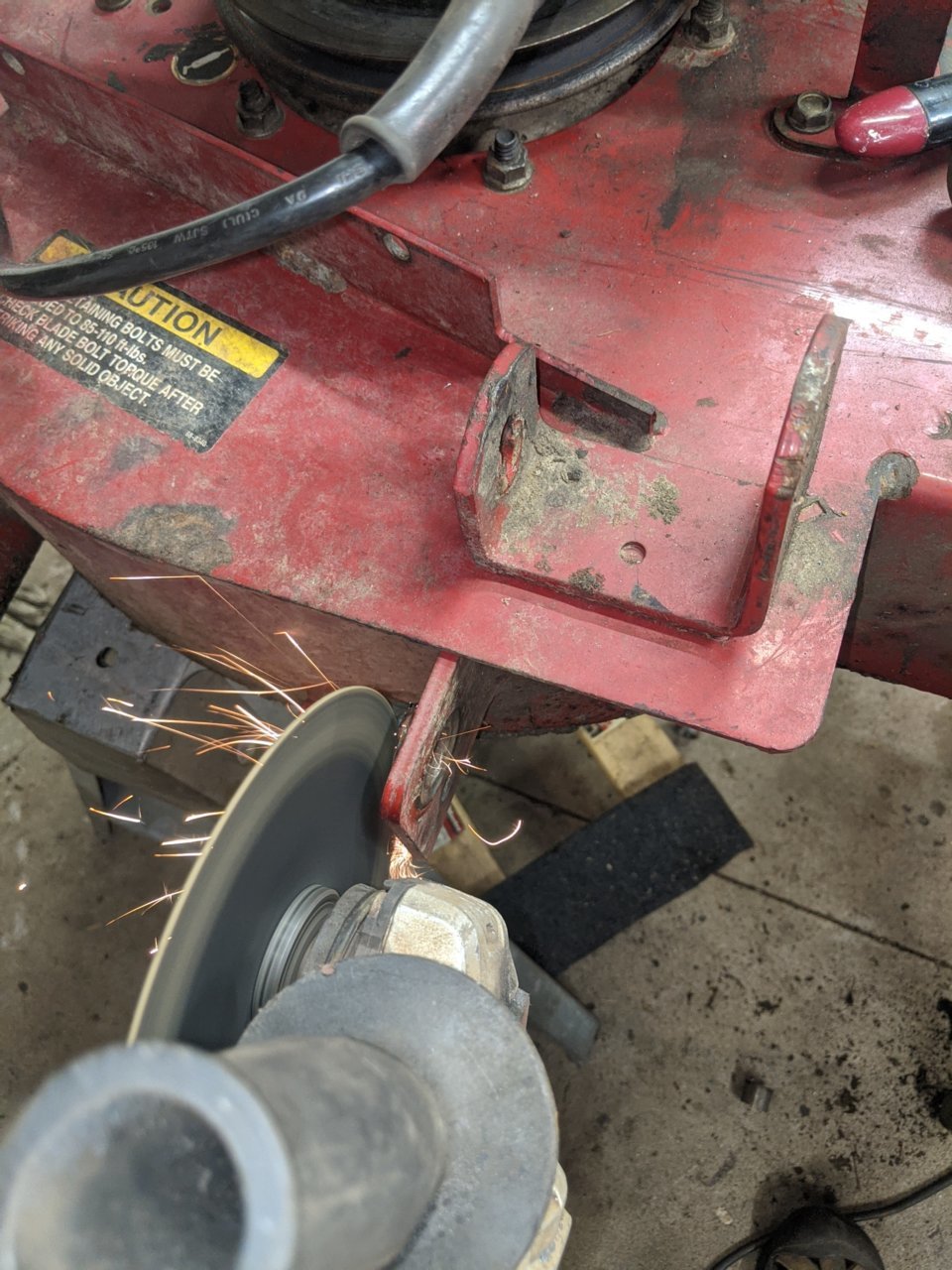

    Removing pin locking plates for reuse.PXL_20210522_211746688.jpg PXL_20210522_212020141.jpg

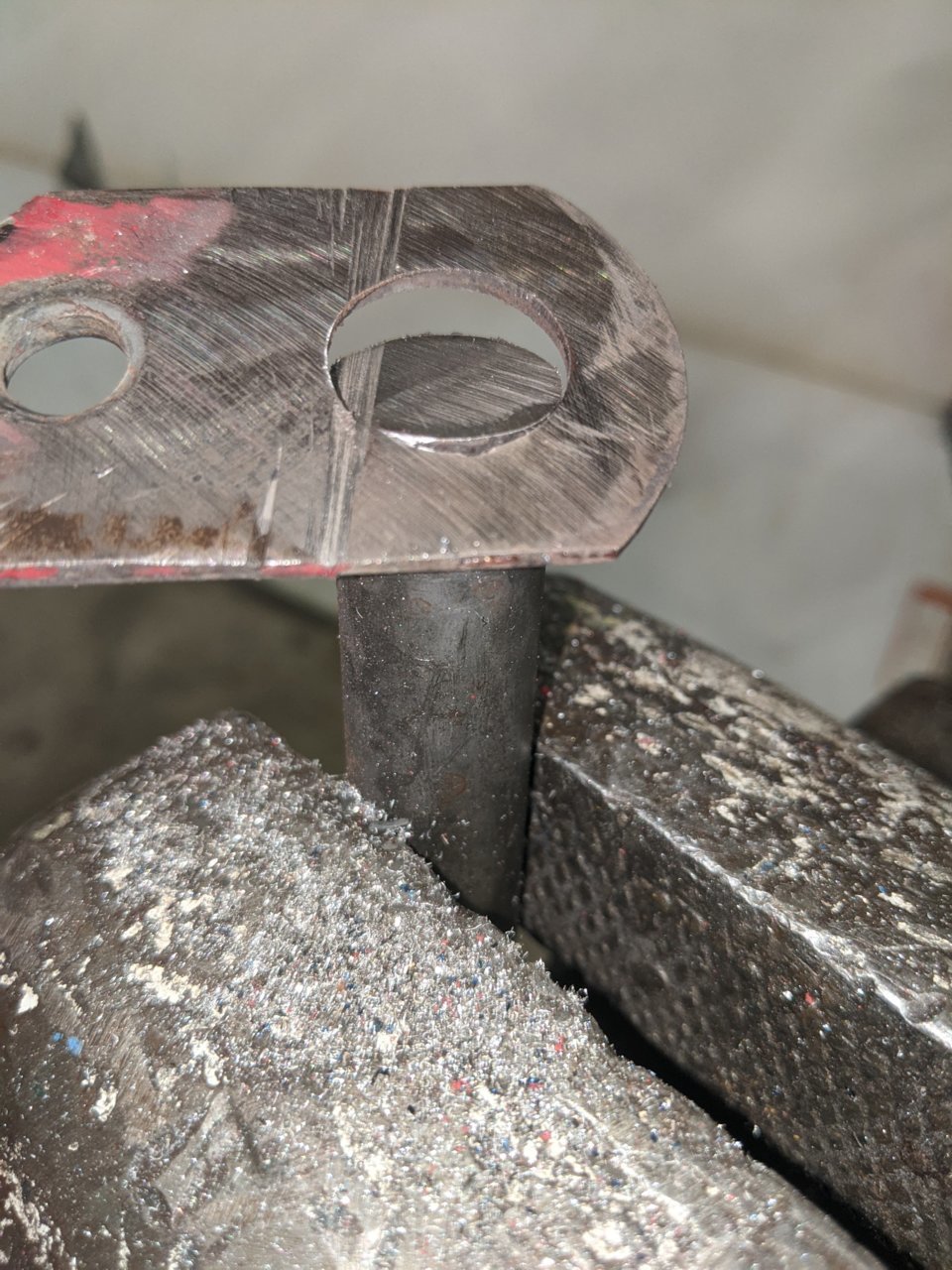

    Old plates welded into new pins.Toro sells new pins for $30 each. It cost me $4 for a 30" piece of 3/4" round stock.PXL_20210522_213603242.jpg

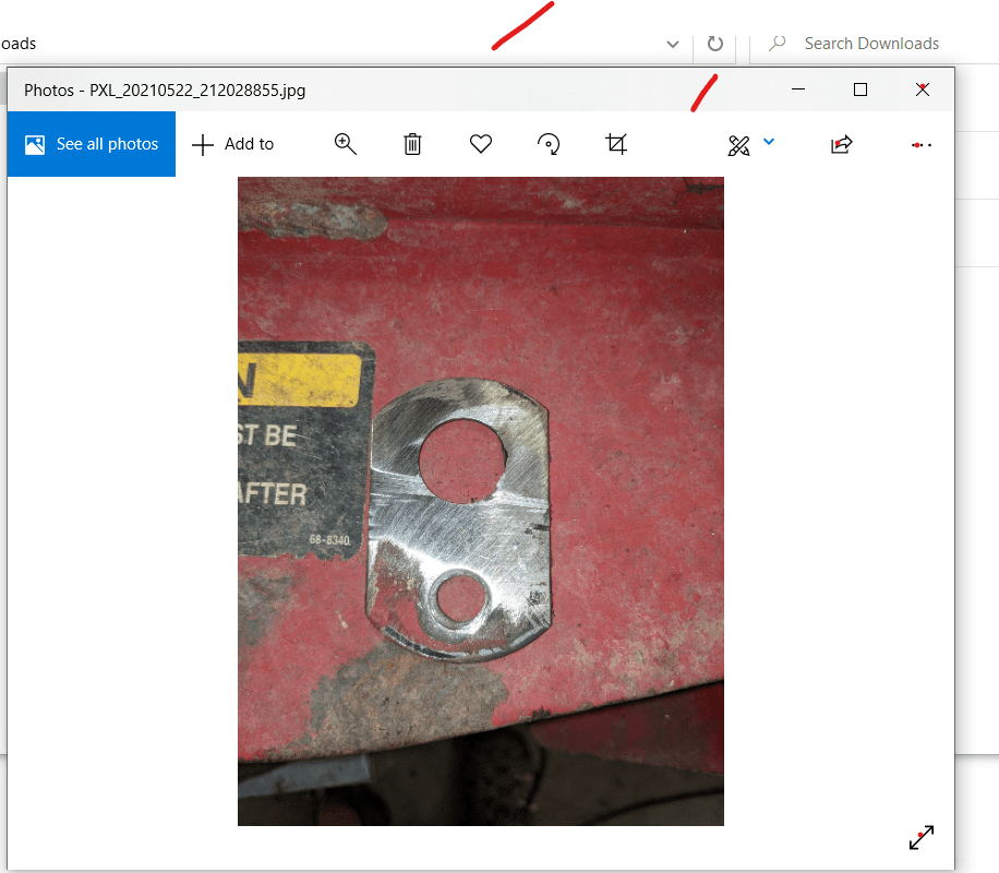

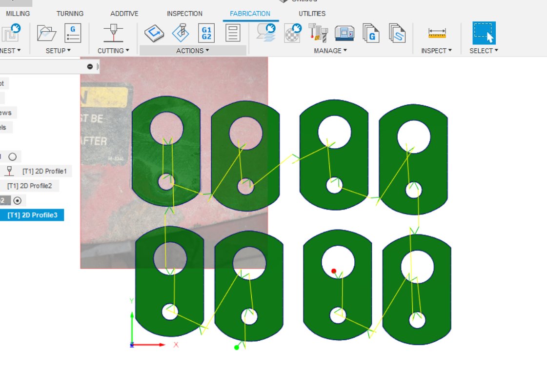

    took the foto of the pin plate and loaded it to Fusion 360. toro pin plate.png toro pin plate.png toro pin 8x.jpg

    Pretty awesome that all I had to do was tell the program that the big hole was 3/4" and the computer created the rest. I copied the original 8 times. Just need to take the G code to the plasma table and load it. I'll have 8 plates in 4 minutes.

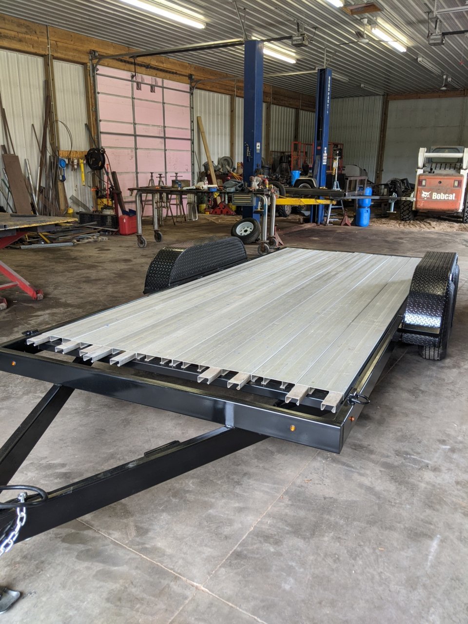

    Getting close to finishing up the car hauler.
