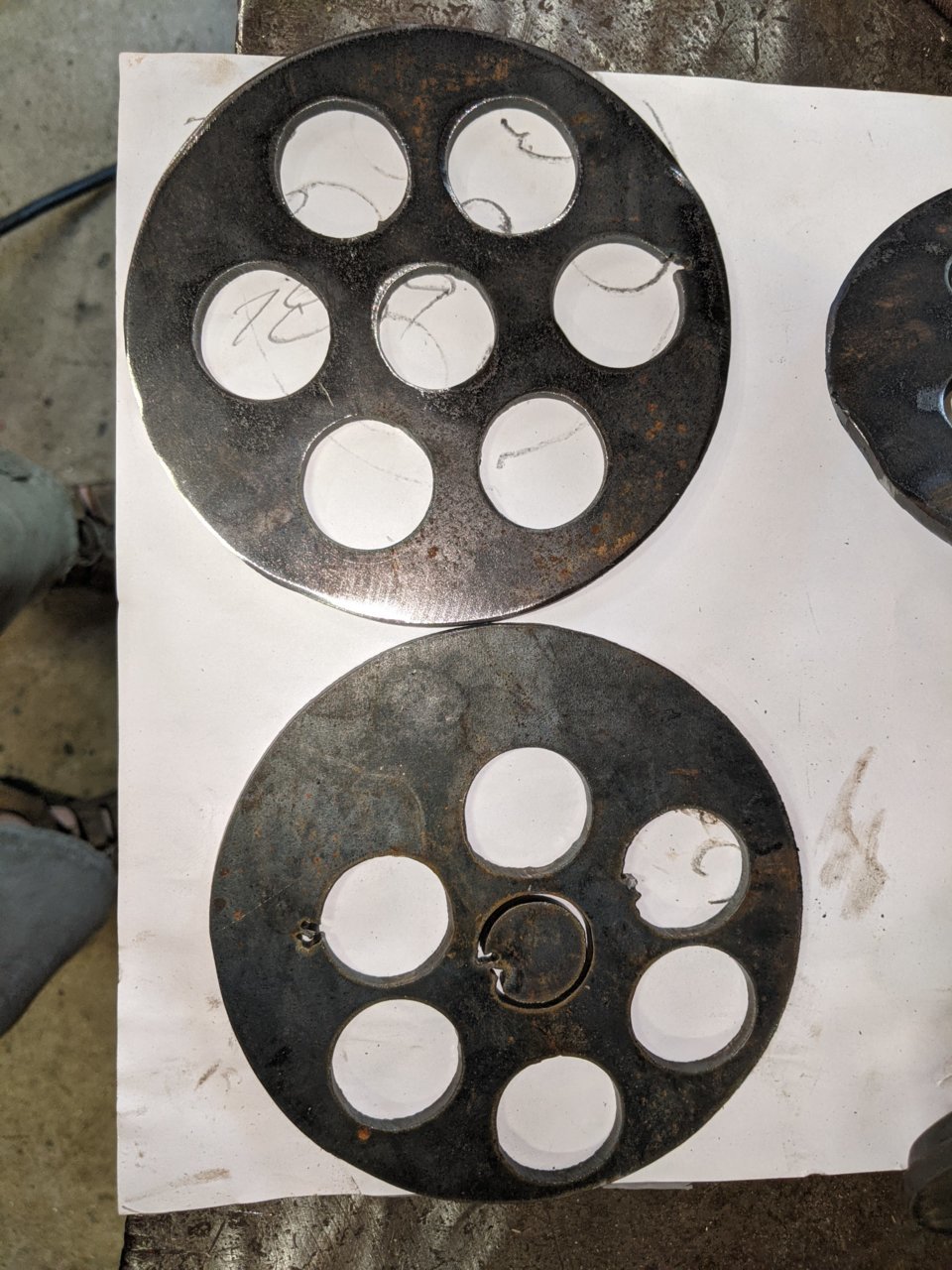

    Calling all plasma CNC peeps:
    Is this the result of EMI causing steps to be missed?
    1st one cut was pretty decent. The 5th one is a reject. The other three were except able, but not as good as the 1st.PXL_20210526_220144018.jpg

    My first Question would be is the air volume and pressure staying where it should be.
    Is the Air Compressor or any other load starting drawing enough current the plasma is losing output.
    which might effect the cnc unit as well.
    do the easy first.

    Do have any emi filters currently?
    koditten[QUOTED] likes this.

    None yet. It's on my list now.
    Ferrites are pretty cheap.

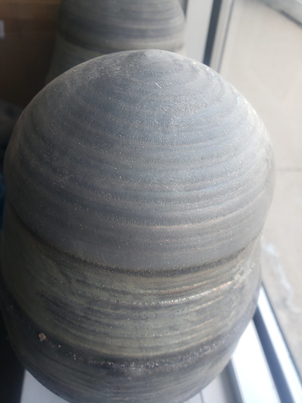

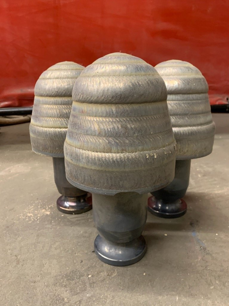

    Same part -2 different methods.
    1 - stringers
    1 - weaves
    Both by robot....my hand is not that steady.

    Crusher tips for an ore mill. 8" dia.

    Are the axis screw drive or belt driven? If they're belt driven, have you checked the tension? They could have stretched and be loose.

    3:1 gear reduction.
    It was the 1st thing checked.

    This post has triggered a thought.
    Maybe I have a loose set screw on the "X" axis stepper or gear drive. There is only one stepper on the "x" axis. The "y" axis has 2 steppers running the gantry forward and back. Hard to believe both those loosened up the same.
    Will report back.

    I just checked the stepper motor. There are 2 set screws on the gear, but only 1 flat on the stepper arbor.
    I was able see that the gear had shifted on the shaft. Neither set screw was perfectly landing on the flat. Leads me to believe it was slipping.
    I didn't have time to do a test cut, so I can't be 100% sure.
    Wyoming09 and buyobuyo like this.

    Always check the simple and easy first before pulling controllers and motors apart .
    So often it is something simple.
