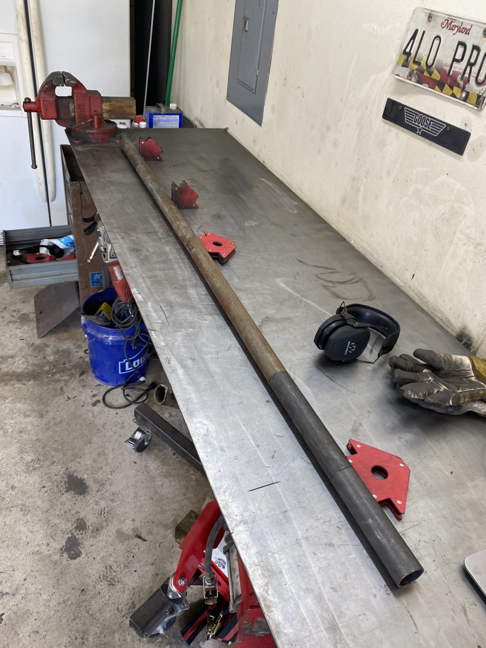

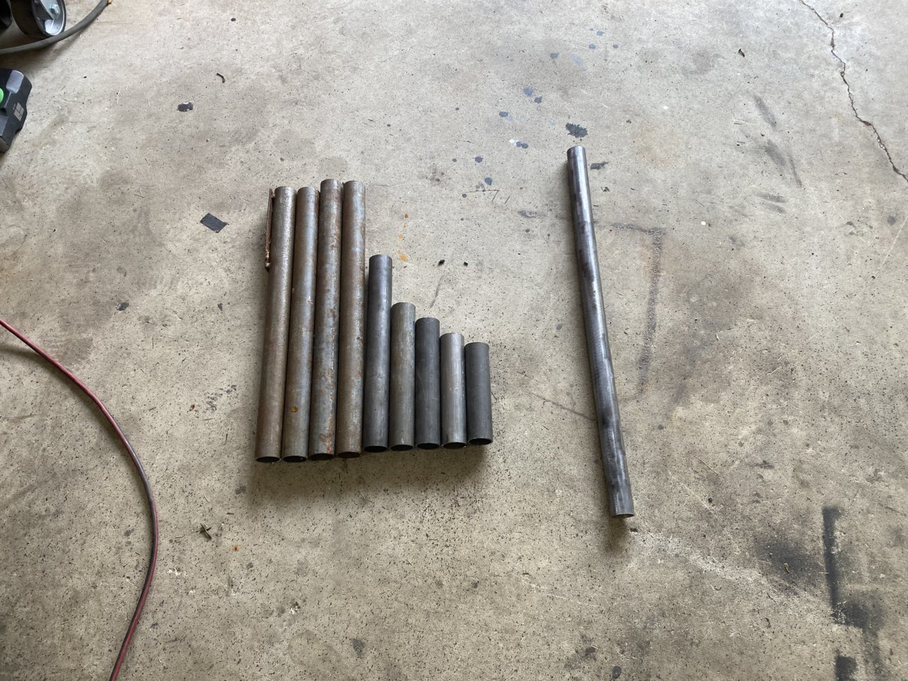

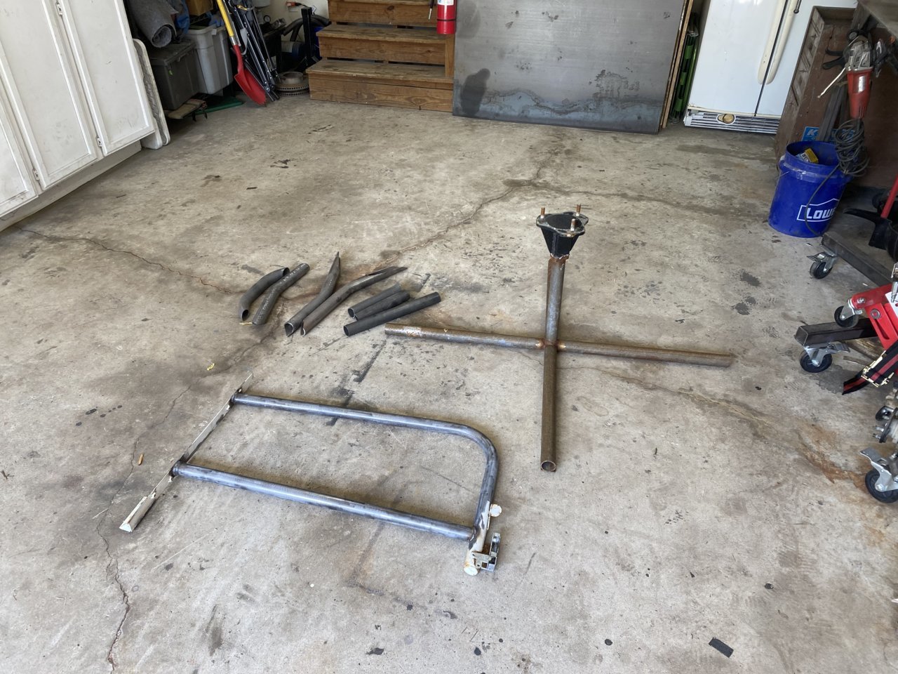

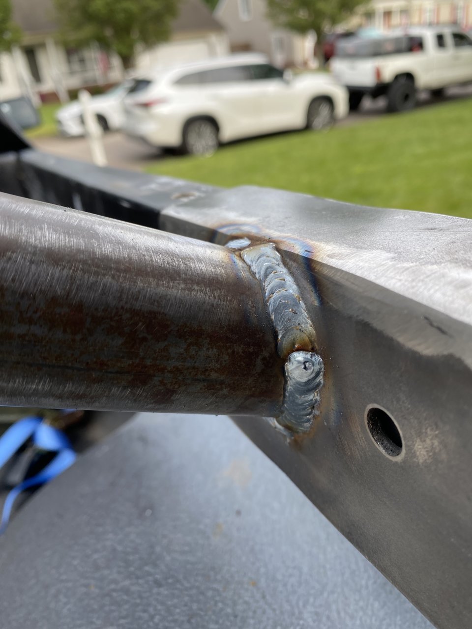

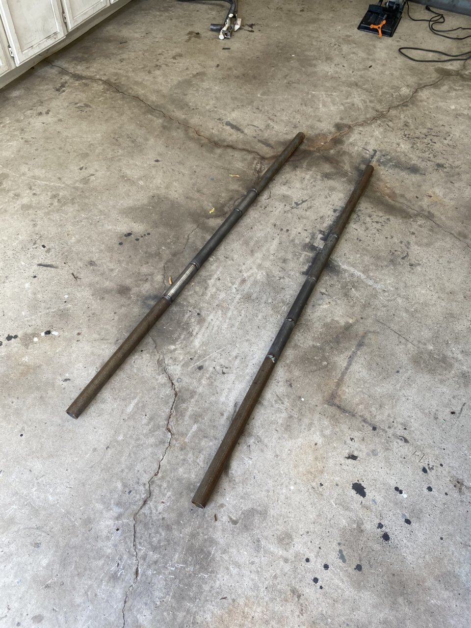

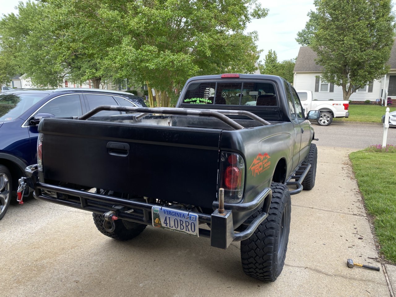

    I built my friend some bed bars with all scrap I had. The steel store didn’t have any of the size I needed so I thought I’d make it. The tube is 1.75 OD .120 and eachh joint has some 1.5 OD .120 as an inner sleeve. Makes it strong and helps keep the tube straightish.
    0/10 would not recommend for this many joints. Took forever to get them welded together and ground back down. Should’ve just called around to find a stick of tube.
    Came out ok. I was able to make it so all the joints would be hidden by his RTT. I also recommended he bed line the bars to hide imperfections.

    fun! I see him post on the 1st gen Facebook group all the time

    Haha. You're "4LOPRO" and he's "4LOBRO".

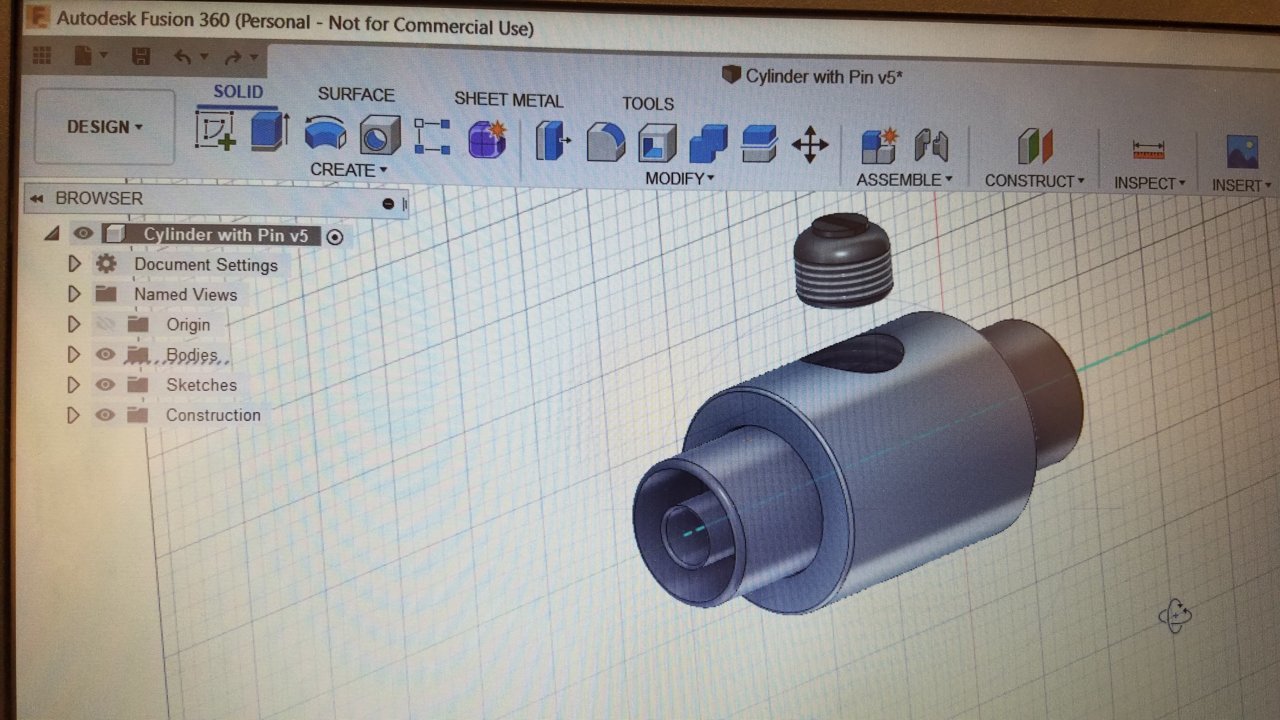

    I mentioned a while back I ordered a table for my plasma cutter. Yesterday I got my laptop upgraded to Win 10 so I could download Autodesk Fusion 360 for making drawings.
    Made my first attempt to create something today. Decided to start try to make something in 3D, even though for plasma cutting 2D will be mostly what I need. 3D is just more fun.
    It's like a cable clamp with set screws on both sides. Just playing around.
    This took me a few hours since I didn't even know how to start a drawing in Fusion. If an experienced person did it, I can see about 15 mins max. I am hoping to get good before my table arrives in July. Back ordered.... :annoyed:
