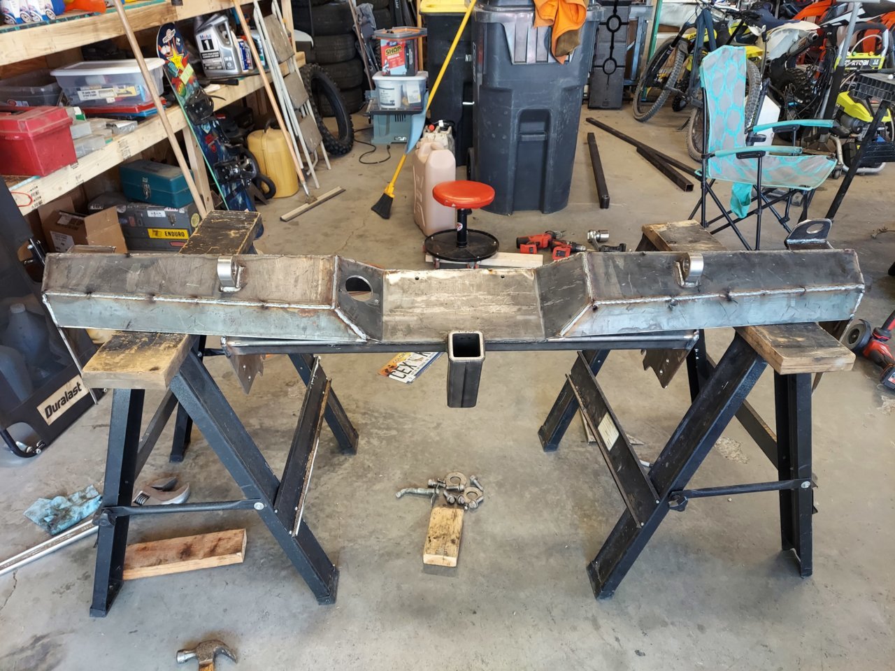

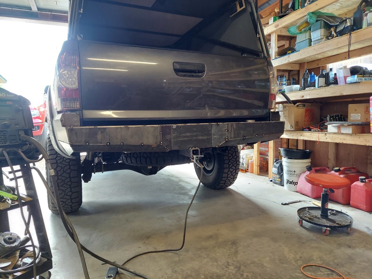

    Been building a bumper from scratch. All the cut off wheels and welding. Now for a few more gussets followed by all the flap discing.

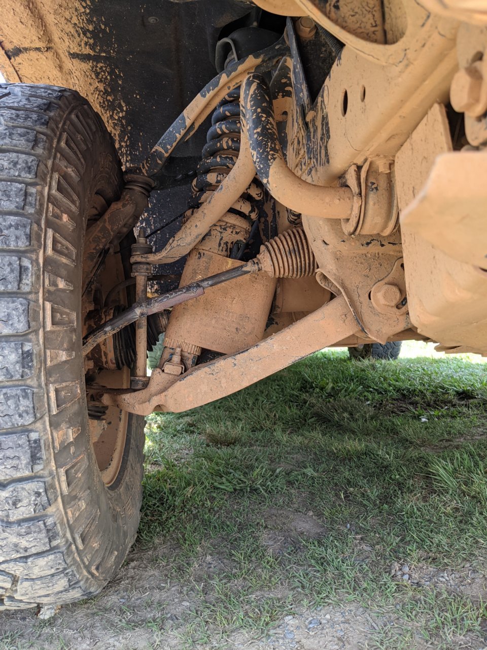

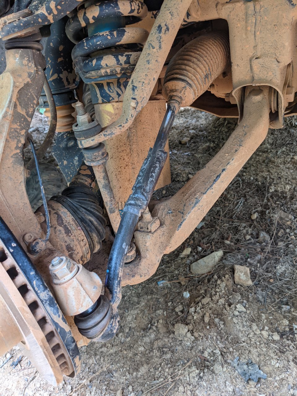

    Buddy did an oopsie on a trail. Loaded up a buddies genny and my Flux Core welder in the Rescue Rover and headed out to meet the Rescue Fucking Ranger to take me to the carnage. The Bowtie was able to make it off trail and back home just fine.

    It looks great. I like that style bumper. If I didn't have other $$$ priorities (wasn't so cheap) and not wanting to invest in suspension parts, I'd be making a RR bumper first, then front.
    Since it looks like you have the hitch already welded to the bumper, just wanting to ask if you have trial fit to the frame before you weld any more gussets. Not being critical, just asking. I know $hit moves during welding so the more trial fits the better.

    It was all tacked together on the truck and I have some wiggle room in the mounts. Gussets I need are just for the hitch and to help support the swingout so I think I'll be good.

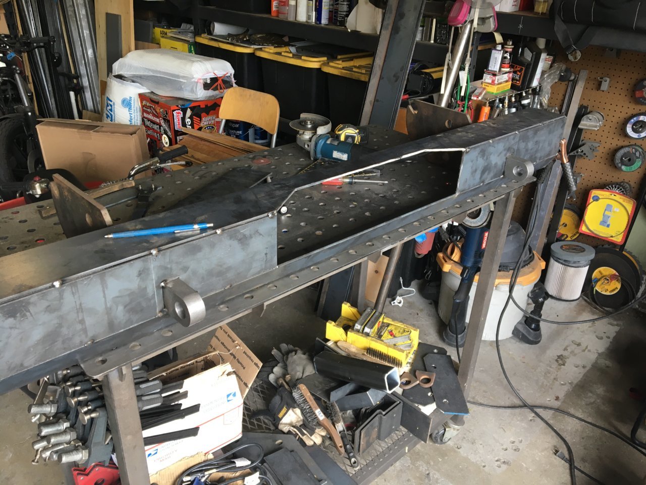

    That looks so much like mine when I started it. Excellent work!

    I was going to ask if you were doing a swing out. Hopefully better than your first one :rofl:
    Why hitch under instead of in bumper?

    Going with a 1-1/4" grade 8 bolt with bronze bushings again for the pivot. So won't have any issues there as long as the bumper around it is solid.
    Tire is staying under the bed for this build, so didn't mind the hitch lower, and wanted it easier to access. Swingout will hold water, gas, propane, and a hi lift.

    Were you also already on the trail? Seems odd to go to someone to weld something when you guys could have just replaced the ITRE no? haha
    Dude so stoked on how good this is coming out. Dislike the low hanging hitch though. Even if the tire stays where it is, you know your departure angle is based on that receiver and matters more than anything. :boink: I know it wouldn't keep you from being able to do an obstacle but it's gonna get shredded if you wheel it like you did the first gen.

    Not going to wheel this thing like the 1st gen. Plus it's still quite a bit higher than the stock hitch.
    Maybe. I'll cut it off and move it if it becomes a problem.

    They were already on the trail and couldn't find a way to get it back to the parking lot. Apparently Chevy doesn't make the ZR2 Tie rod readily available.

    That's dumb. Hopefully that guy carries a trail spare from now on.
