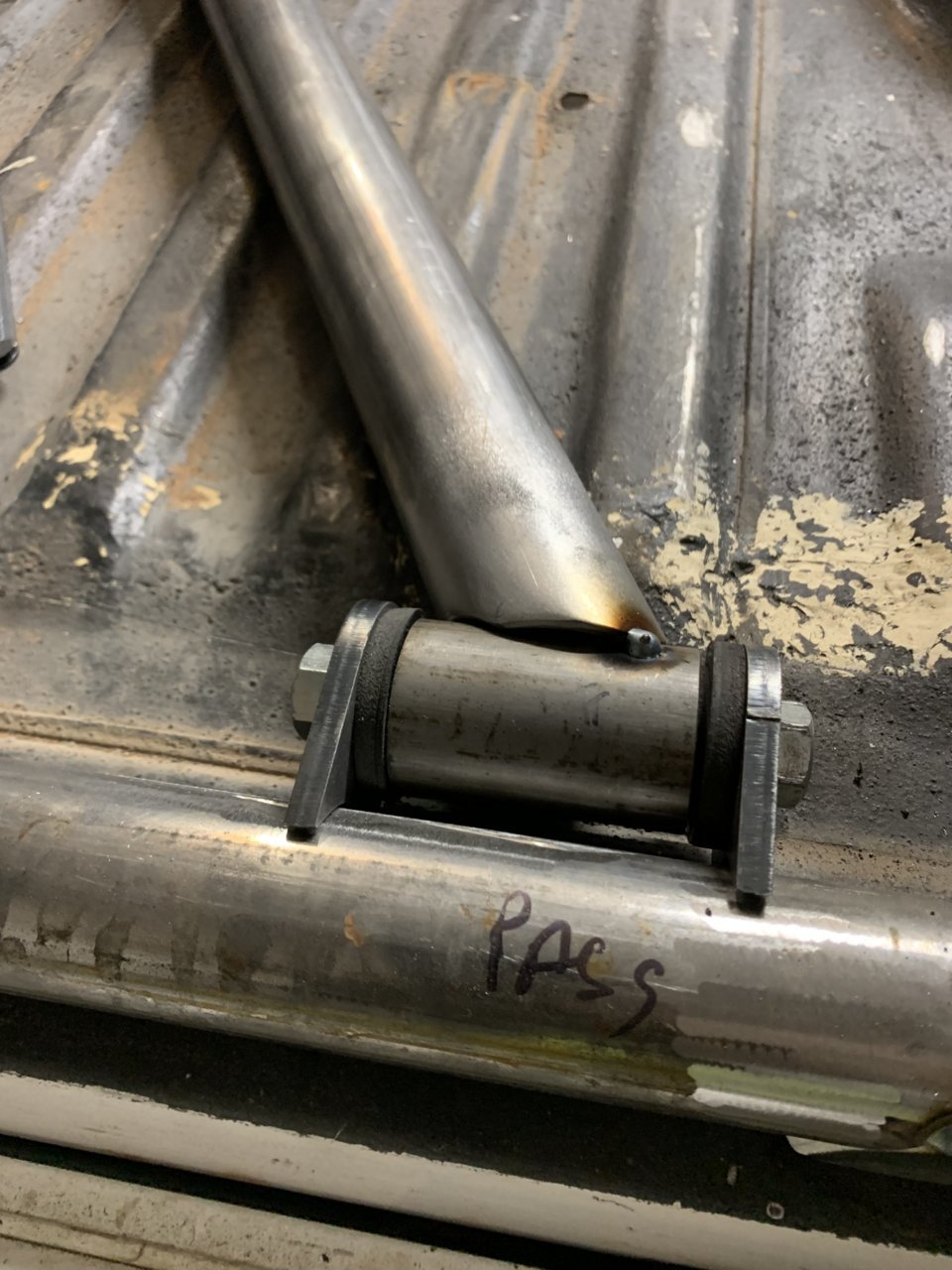

    Well made a some sleeved bushings. Make shit 100% by hand takes so long… will cut the other tube tomorrow and tack it all together to see if it’ll actually work 8EC113FB-E8F4-4854-B5E4-135C6B02AD99.jpg
    jubei and PhotoDan like this.

    I make most of my own bushings like that.

    Turning the bushings down took forever. The poly flexed just enough the lathe tooling didn’t want to catch... super annoying.
    Everything else was scraps I had laying around or repurposed.

    Oh damn, never mind. I don’t “make” the polyurethane. I buy the bushing halves from Low Range and I cut the inner and outer sleeves for them. I use them all the time for my tire carriers so I keep a bunch of the poly halves in the shop and just cut the sleeves as I need them.

    I had some that were close in size so I just took a 1/4 in off each and then turned down some sleeves to go in the middle with a half inch bottle. Buying them would have been more time efficient but I had quite a few bushing laying around from spares for leaf springs.

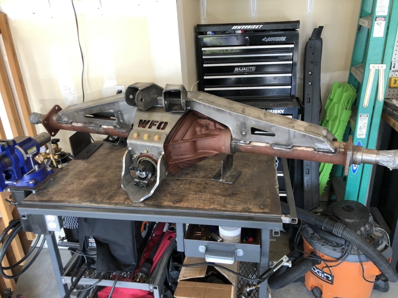

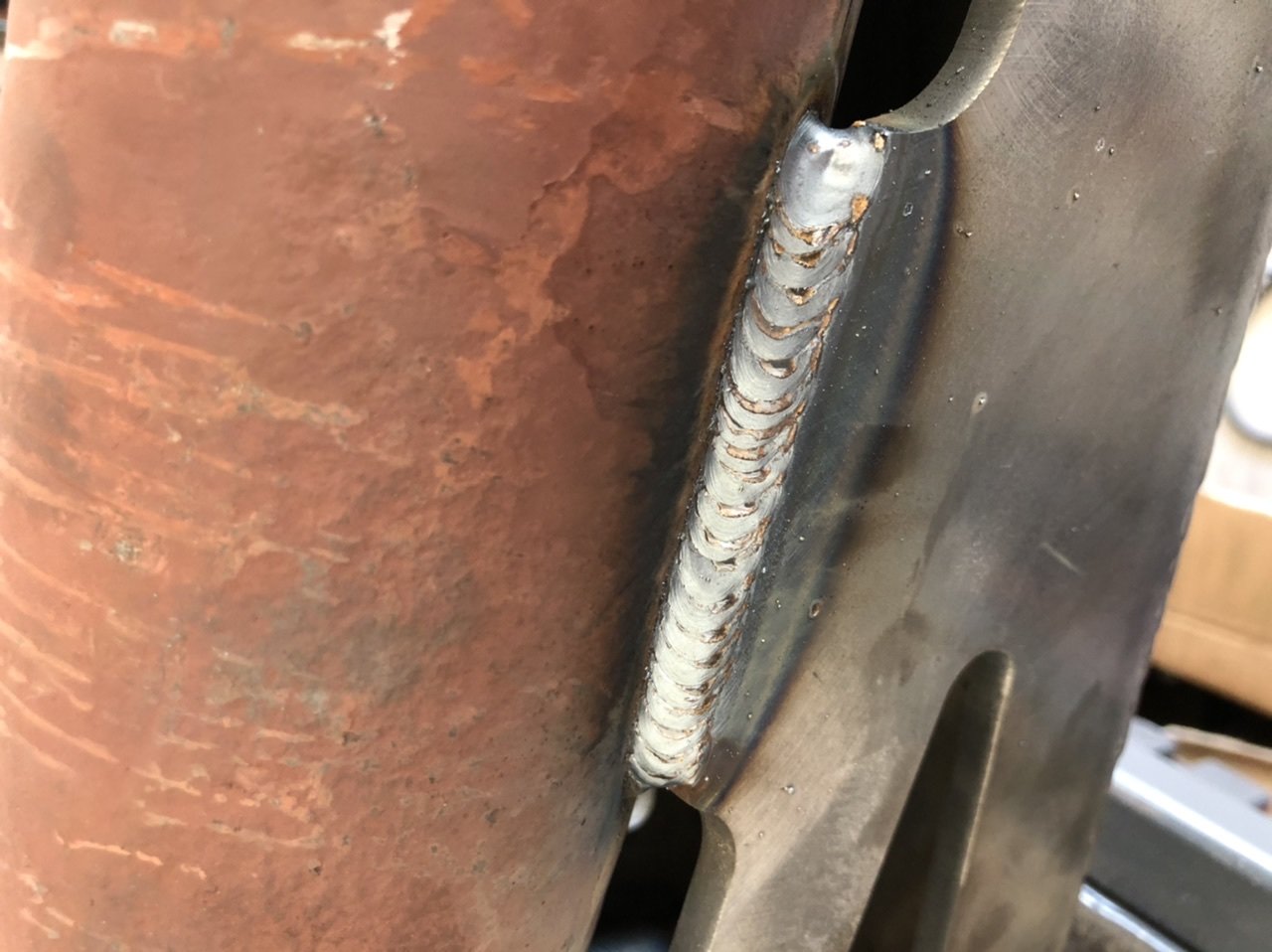

    Building a 14 bolt. I’m not the best welder.
    jubei, PhotoDan, MulletTaco and 2 others like this.

    Reserected from the dead.
    You have nothing to be ashamed of. Those look great!
    RustyGreen and JoeCOVA[QUOTED] like this.

    Removed some stuff, added some stuff.
    Those look great, just remember, a pretty weld won’t always hold, and an ugly weld won’t always break. It’s all about penetration…
    JoeCOVA[QUOTED] likes this.

    Maybe it's my untrained eye, but did you have to span a decent gap between the truss and axle tube? Looks like you could've gotten a little more penetration on the axle tube if you weren't spanning that gap. Gap or not, your welds look much better than some of my most recent work...

    Are you also going to weld to the cast center?

    It some places yes and others not. The truss wasn’t an exact fit so had to work with it a bit. I ran this I think at 19.5v and 300ish IPM with .035
    No, the truss isn’t meant to be welded to the cast center though I did run a large weld on each of the tubes as some extra security against the tubes spinning.

    I don't know shit about armoring an axle, but I do know about warping of metal.
    Is there ever an issue with the entire axle warping with all those long welds? Do you counteract the warping by running beads on the other side?
