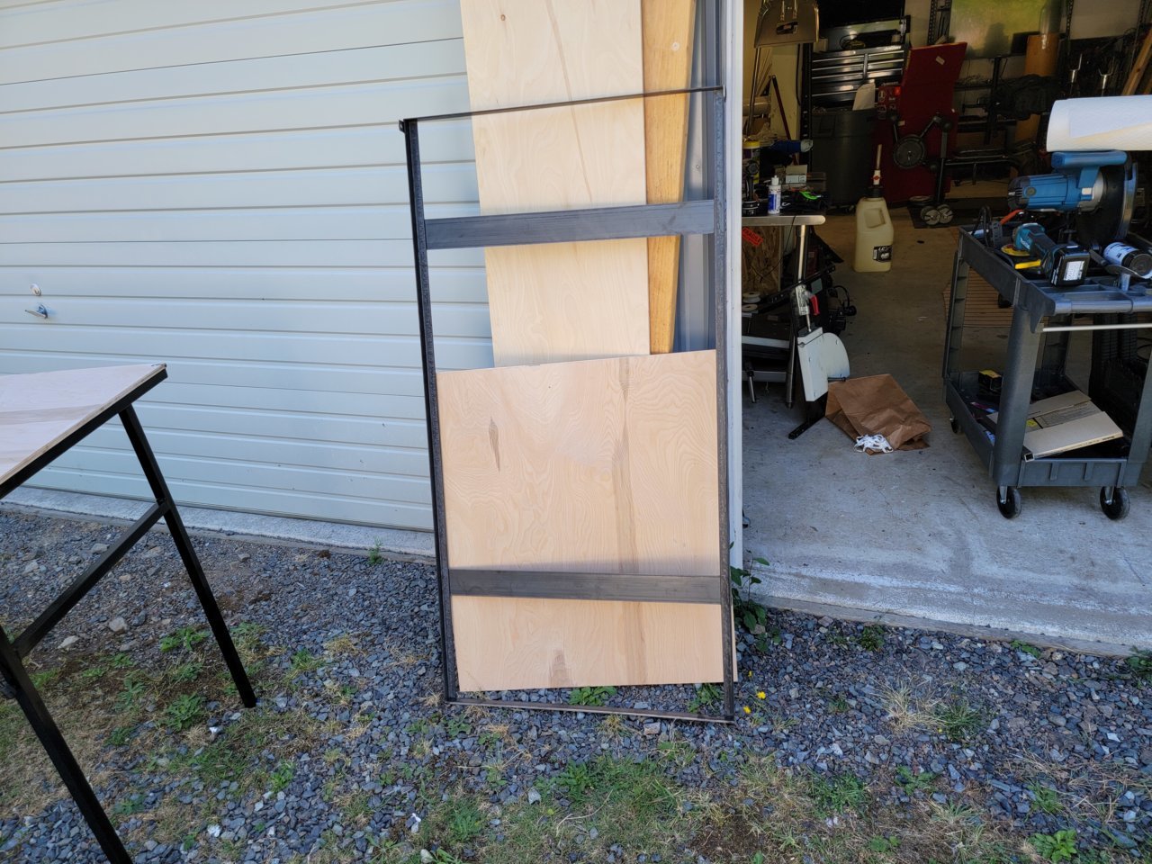

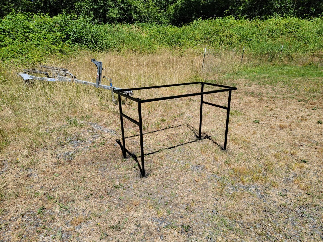

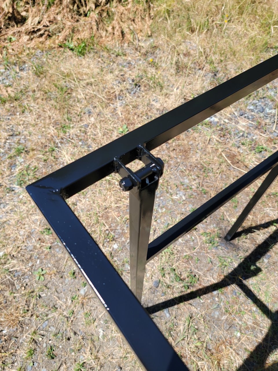

    I bought a Lincoln 140 off my buddy a few months ago, and up until then have never welded before. I don't know shit, other than it's really nice to be able to stick stuff together when I need to. I'm making a portable work station out of the back of my truck and needed a table at a specific height, so I made this guy. Folding legs have gas struts to open close, still need to figure out a top, probably some hardwood or melamine. Originally wanted all metal construction, but for how thick the steel would have to be to support any weight it'd weigh too much and cost a fortune. I made the hinges with precut tabs and 1" spacers, and nylock nuts

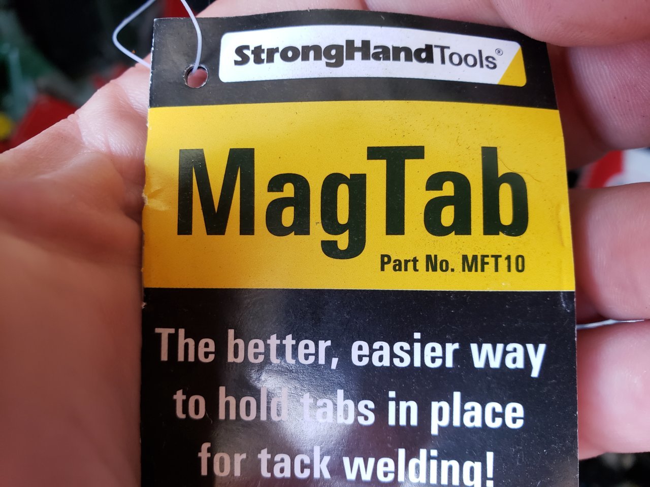

    Picked up a new clamp for the welding table.
    Got a feeling this is going to be one of those why did I wait so so long to get items..

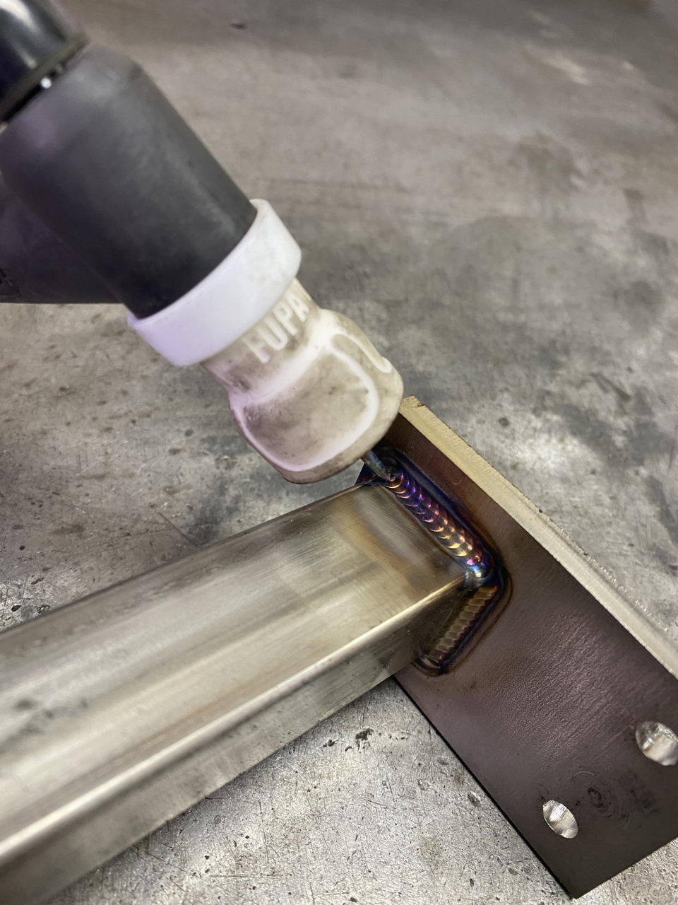

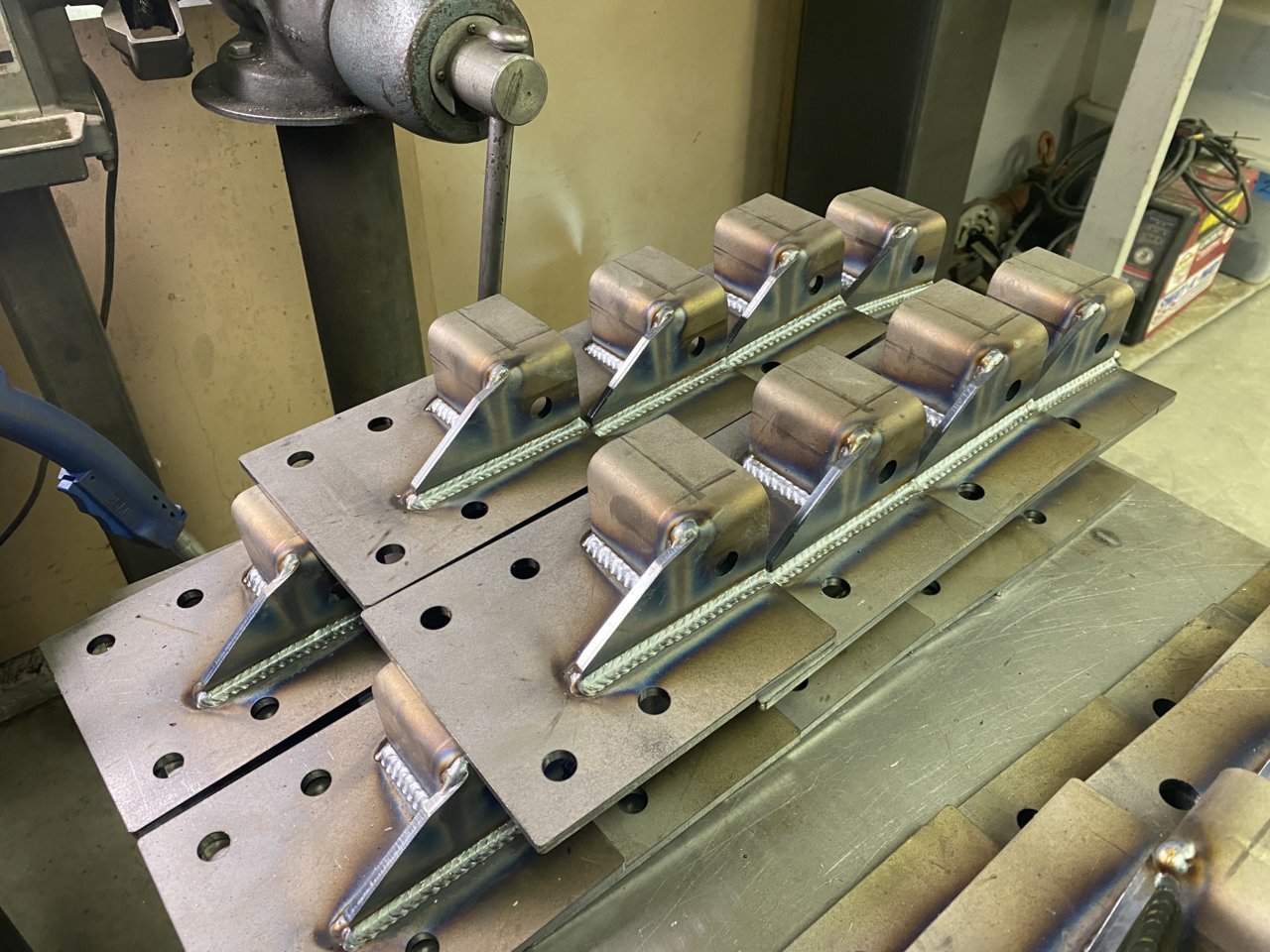

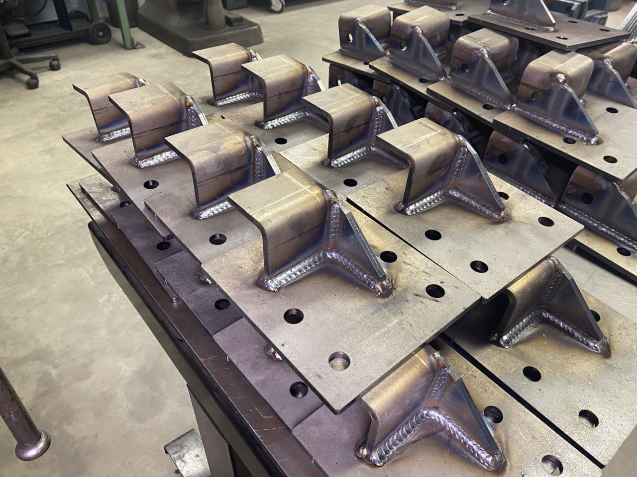

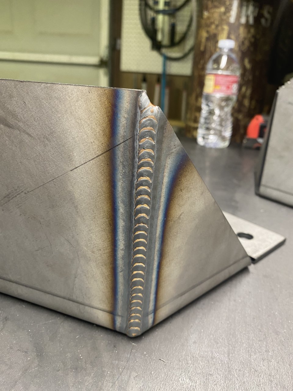

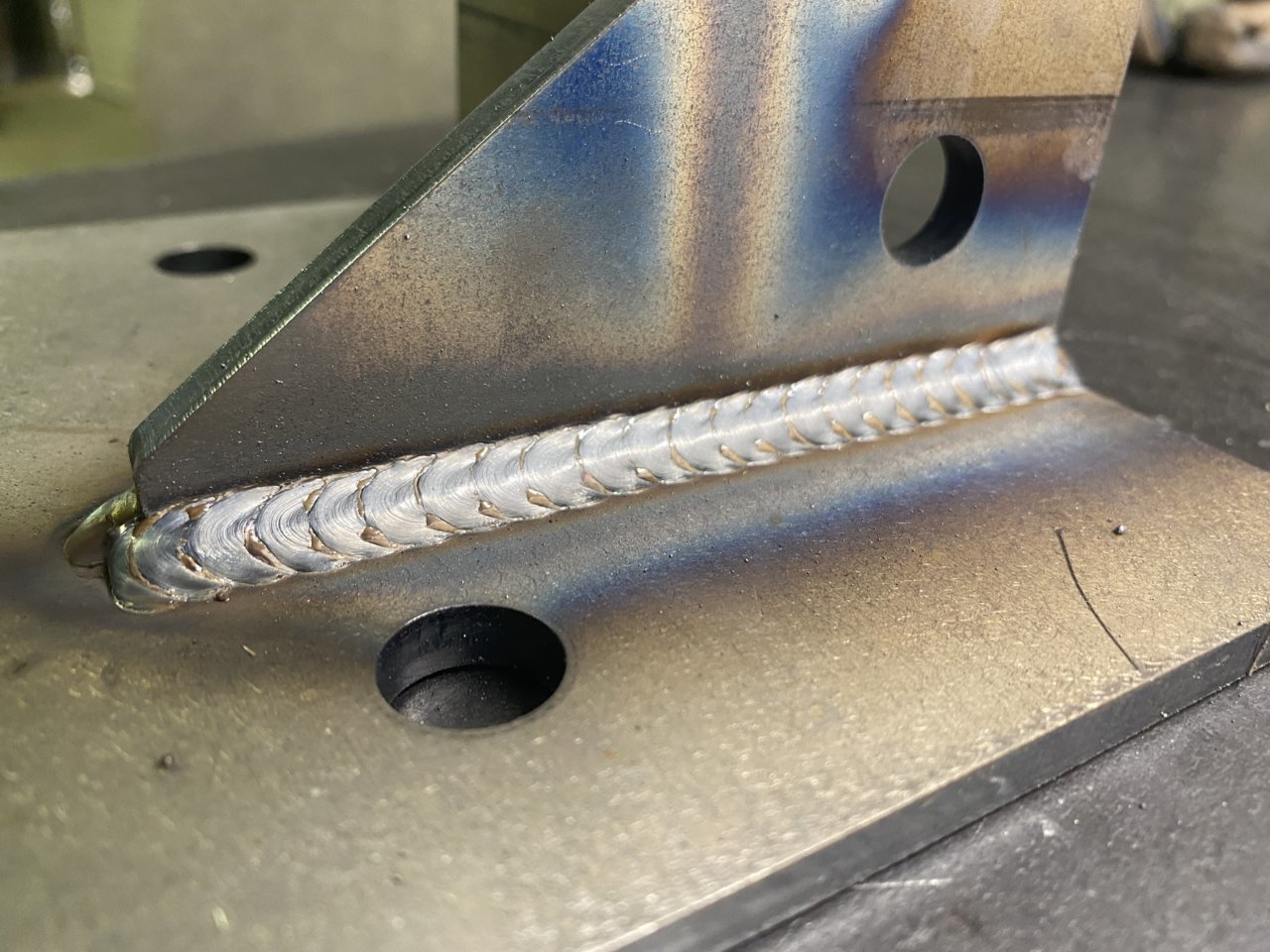

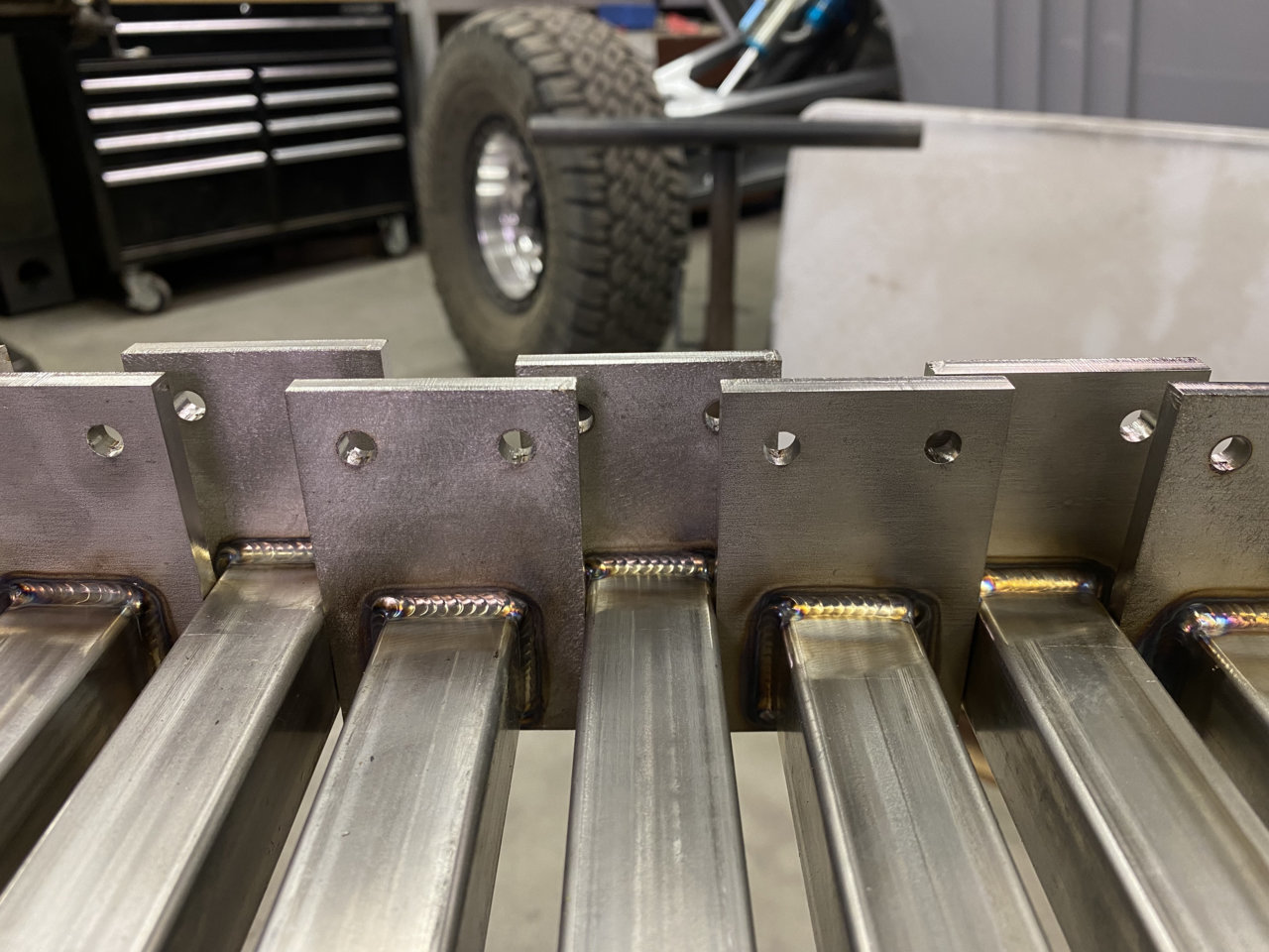

    Few pics from this weeks work. Glad I still remember how to tig… somewhat :rofl:

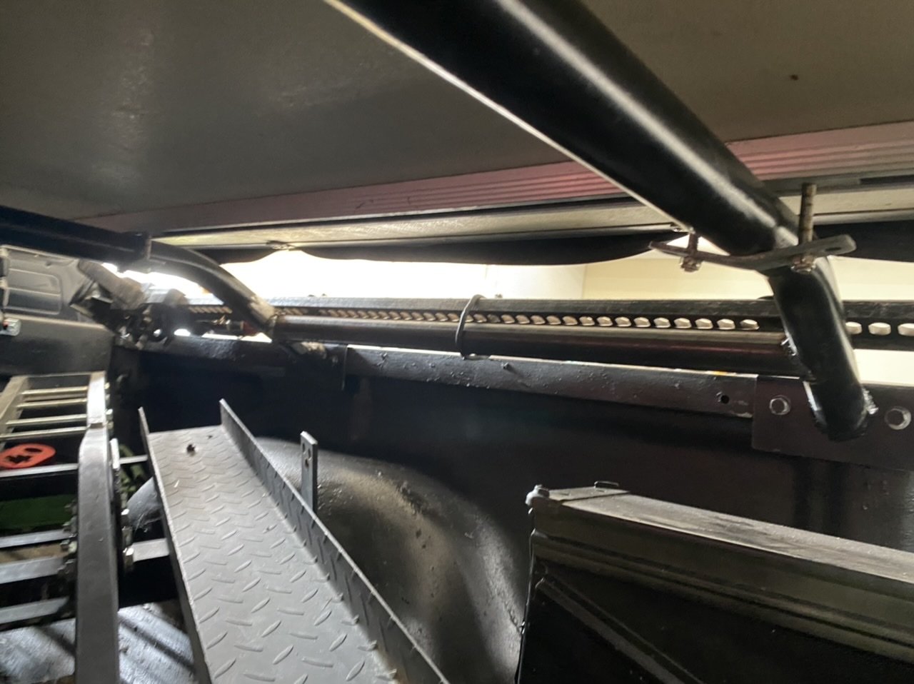

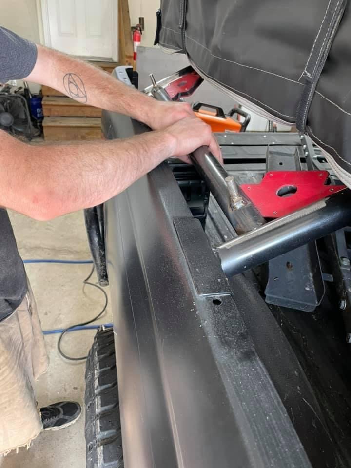

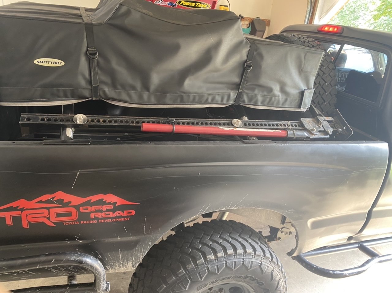

    Not the greatest pics but I got to play with my tube notcher some more today. I honestly don’t know why I ever bothered attempting to notch by hand when this is so much easier.
    I added a hi lift mount to my buddies bed bars using some carriage bolts. The square on 1/2” carriage bolts fits perfectly in the hi lift holes, keeping it from shifting around. He’s going to replace the nuts with some wing nuts from McMaster carr.
    The other option was to weld the bolts right to the bed bars, but they weren’t spaced correctly. I could have made some little tabs that hung off the bars but this is more elegant in my opinion.

    Humble brag lol!
    Those welds look frickin great man! Nice work

    I just threw all my shit out into the street, and ran over it............twice. Thanks....
    LMAO
    Nice work man.

    Much appreciated!
    Hundreds of hours of hood time, messing up, and learning from those mistakes. Thanks for a kind words. Now back to more welding

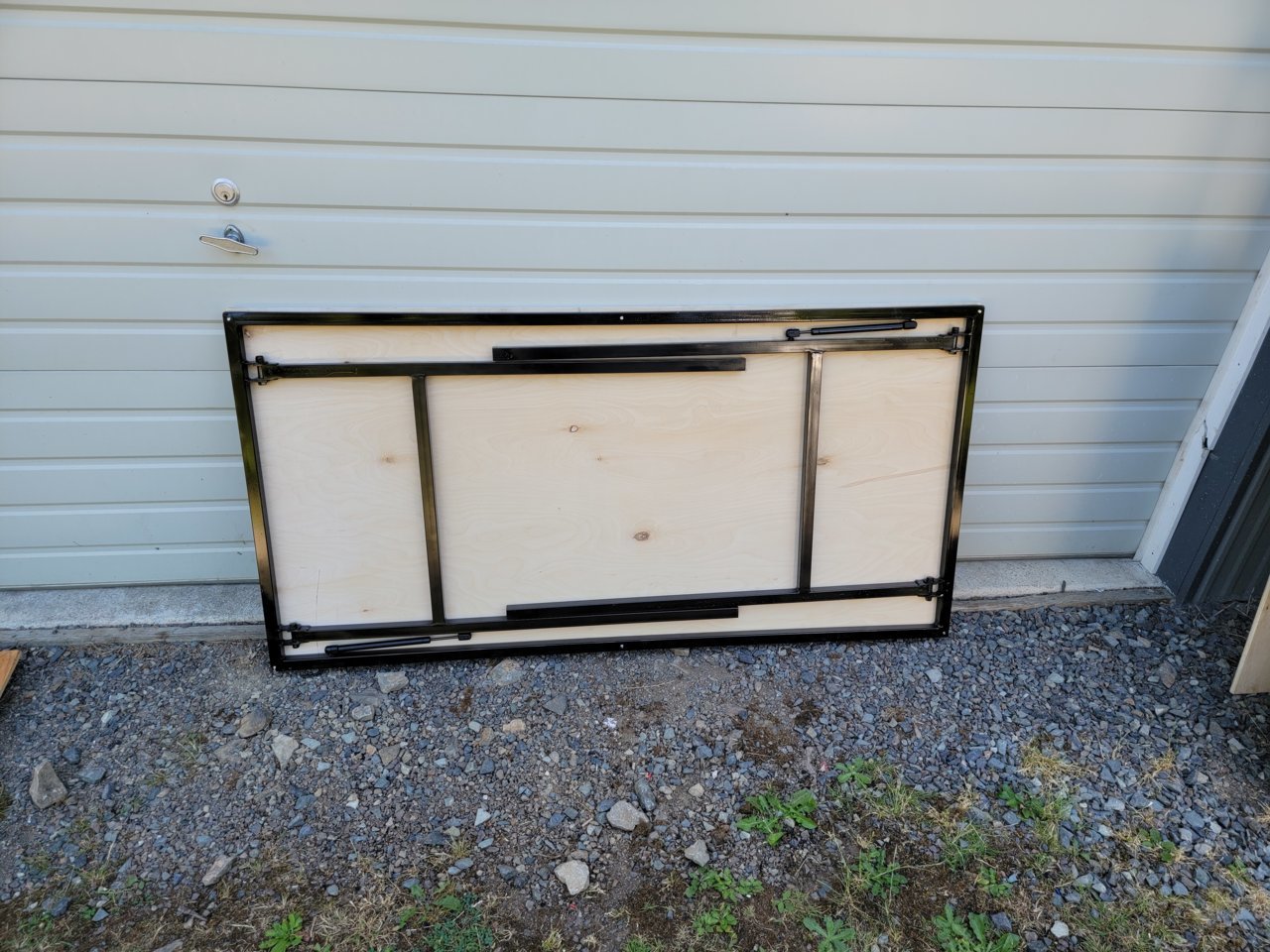

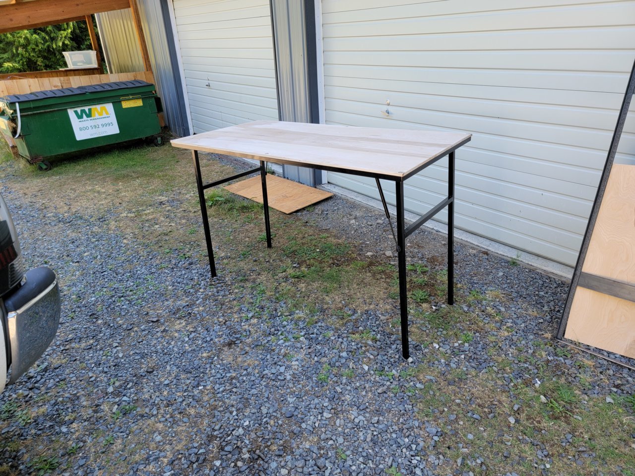

    Finished my table. Now I'm making a frame that will bolt onto my camper shell on a pivot/hinge so I can store it on the ceiling of my canopy. I'd really like to learn to tig aluminum cause this would be so much better about half the weight

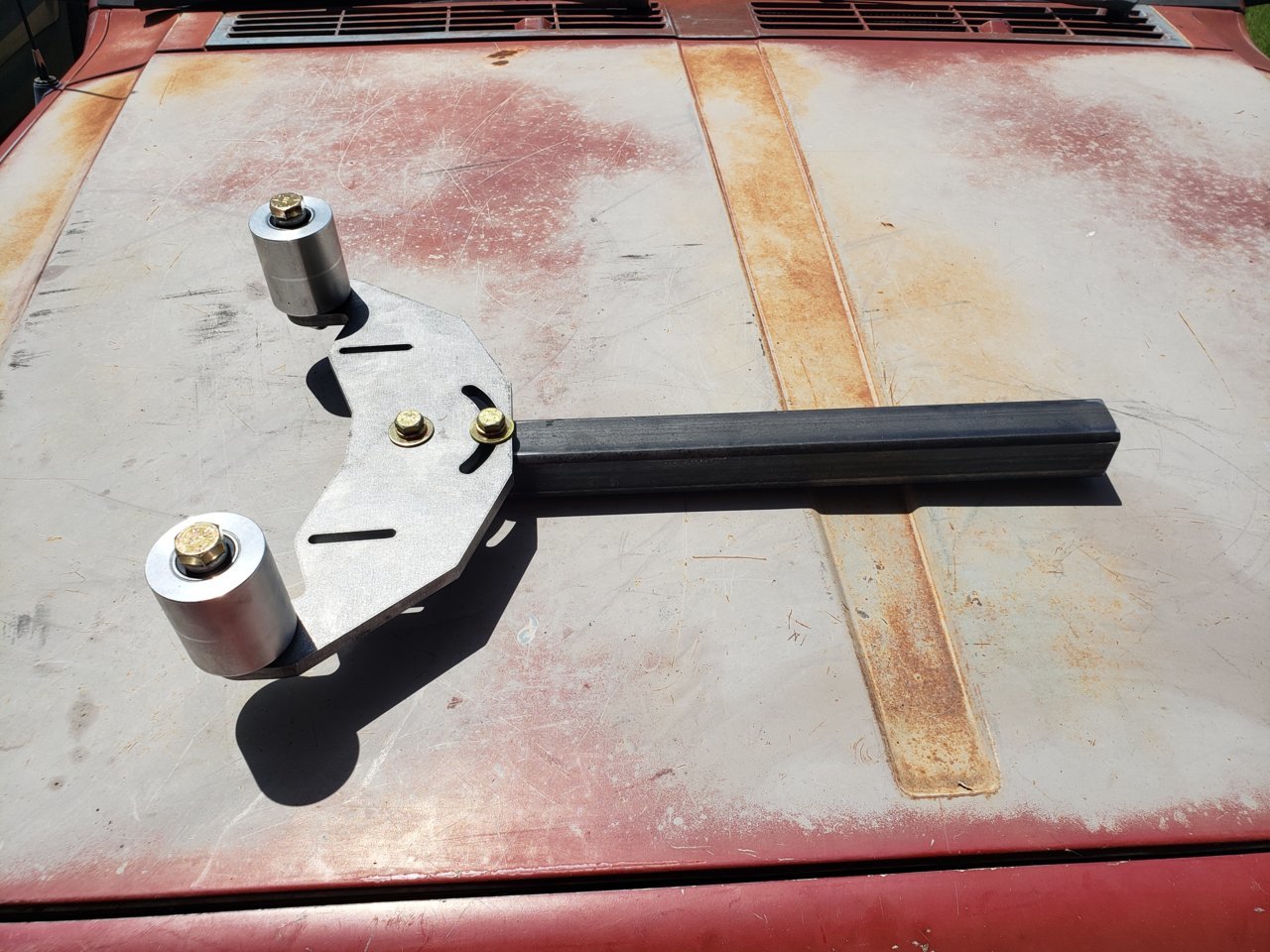

    The tool arm for the flat platen is nearly done. I need to pick up a piece of flat stock for the platen itself. And the hardware to mount it.
    I recut the tracking pivot, turned out much better the 2nd time around. I still have a bit of drilling and tapping to do on that piece.

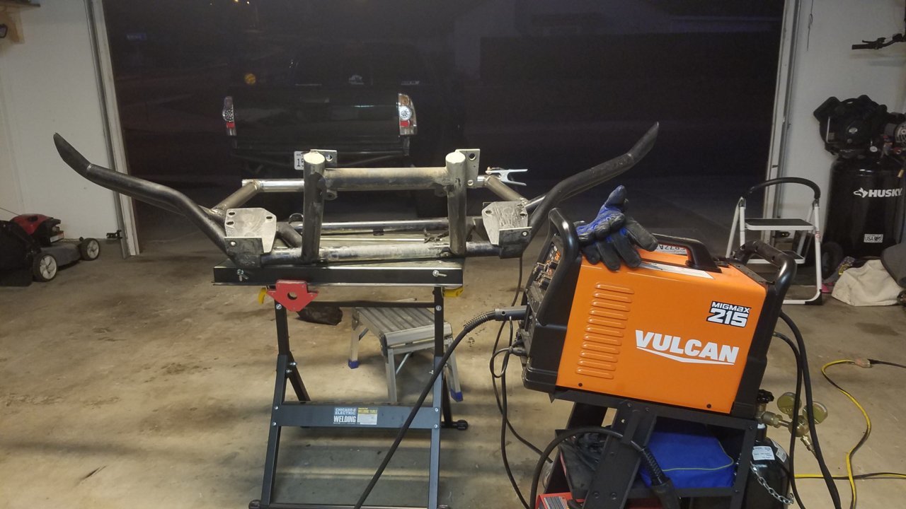

    Love my Vulcan migmax
