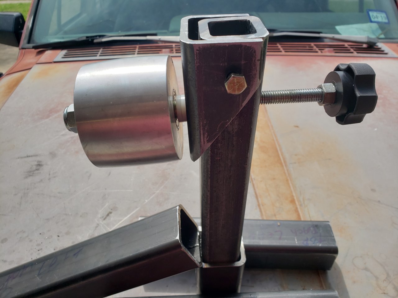

    I was not able to get the frame tacked up for the belt grinder. However, I did finish the belt tracking assembly.
    Took a bit longer than expected since there was an opening in the upright tube where the head of the bolt has to go into and since the tracking system has a bit of an arc the opening was.more than a simple round hole. But more an oval...

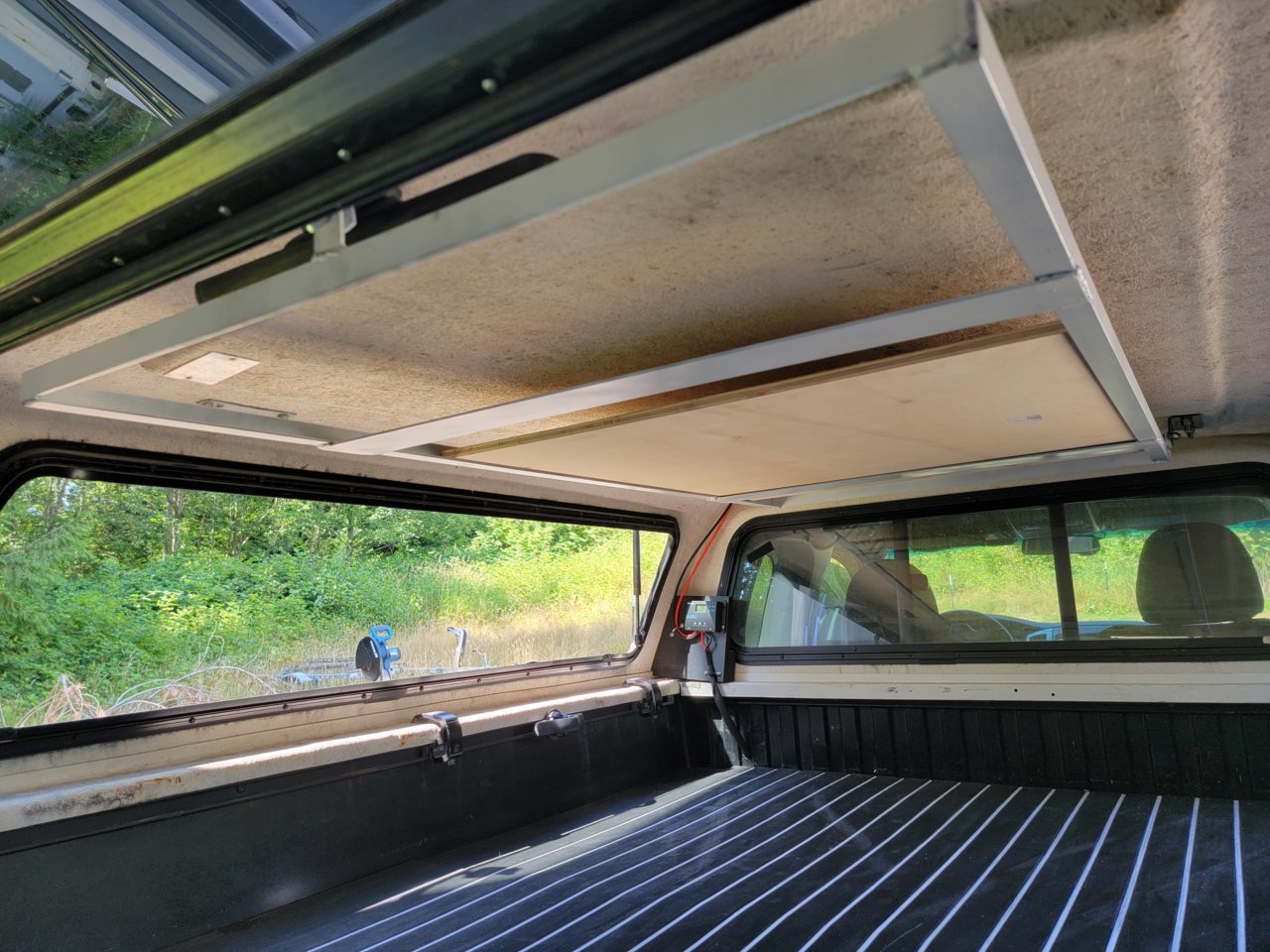

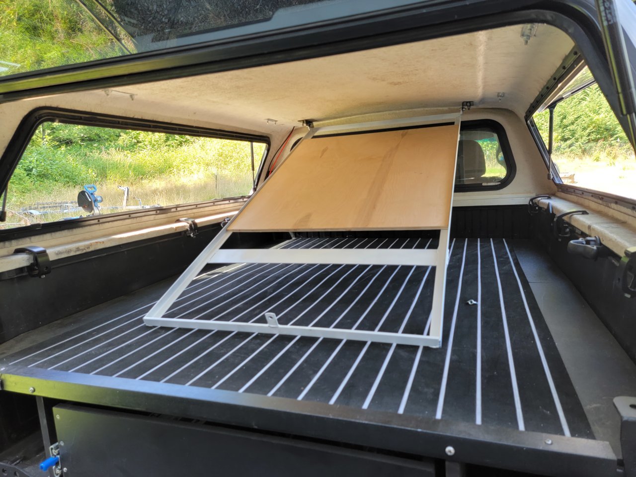

    Well, my table on the canopy ceiling didn't work out, too heavy. But I have another idea, so I mounted my fold down "shelf" and am still going to use it for a table, just not a steel one

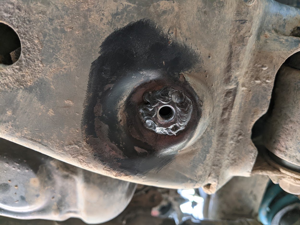

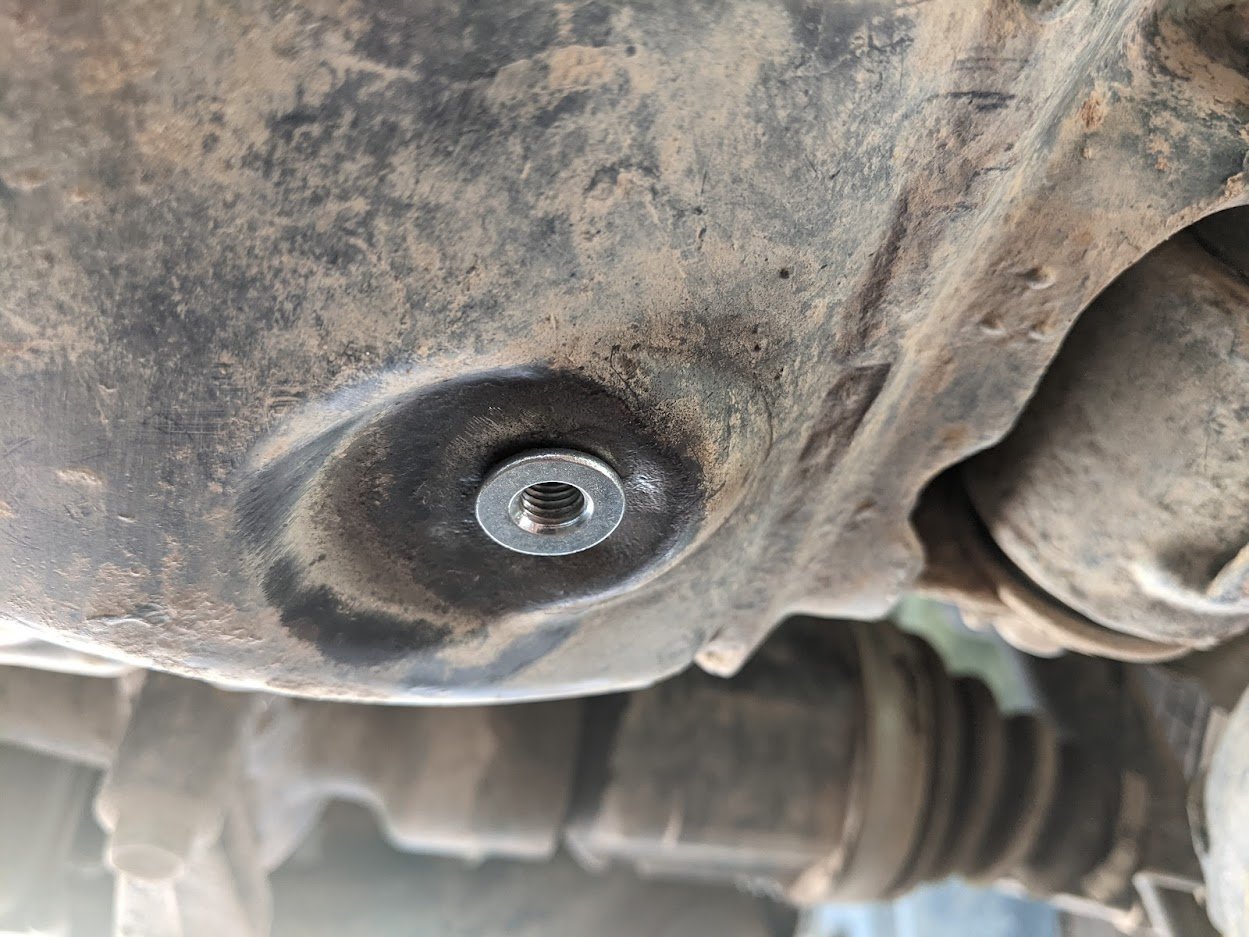

    Welded my first thing upside down today. One of my frame weld nuts decided it wasn't going to hold threads anymore, so I drilled it out and welded in an m8 flange nut

    Ear protection is a must for welding upside down. You get a glowing BB in your ear and it could pierce your eardrum. Even little foamy ear plugs are enough to keep your ear holes safe.

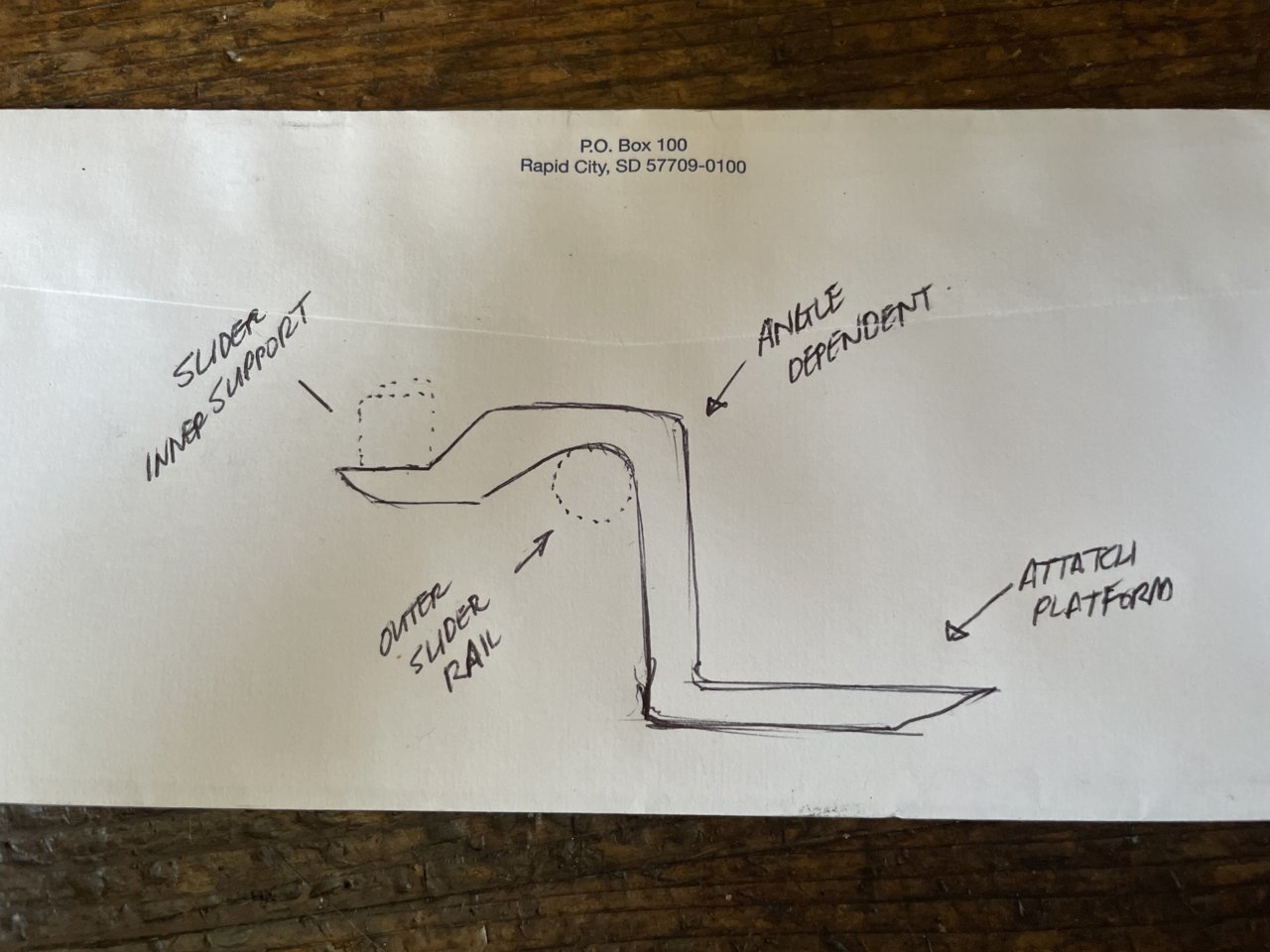

    right away I picture this:
    The tough part is getting the distance between the inner support tube and outer slider rail and the angle of the drop. It would probably end up being 70* to account for the 20* sliders so that the drop would be vertical.
    Make two of those with small tabs to attach the plywood and you’re good to go.
