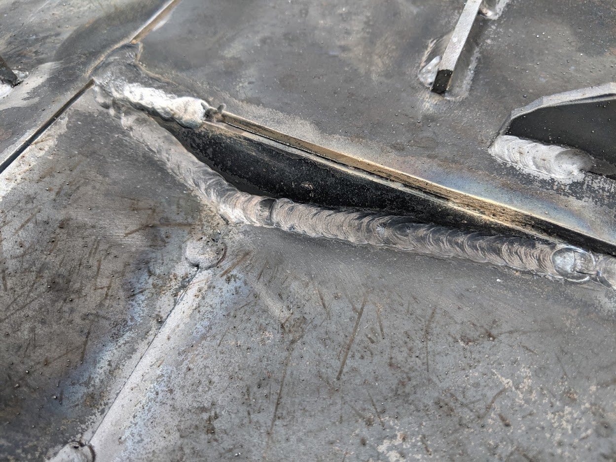

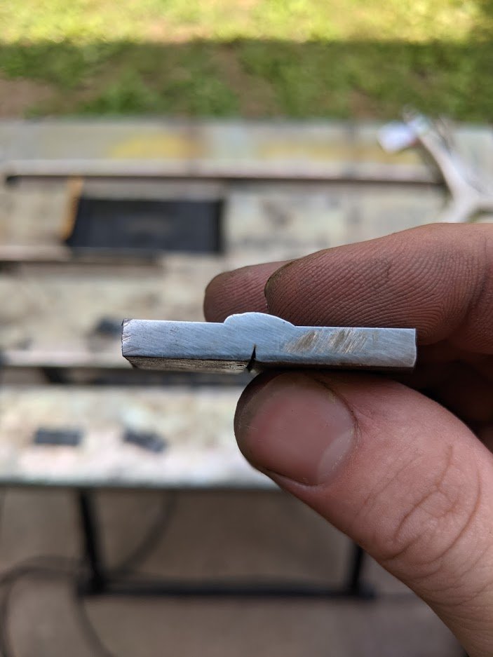

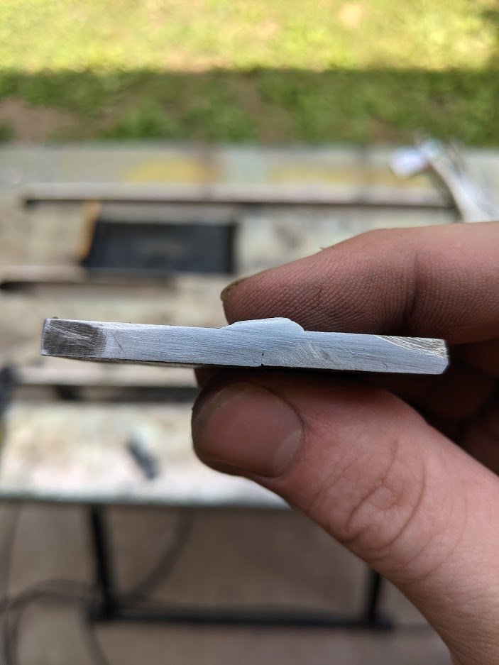

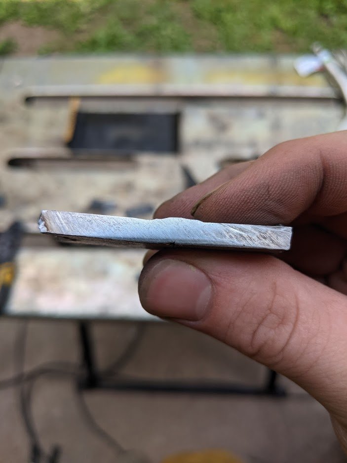

    Played around with some scraps of 3/16" experimenting with some butt welds. I've only got a 120v Flux welder, so welding thicker materials with proper penetration is more difficult. I did a little test of a straight butt weld, chamfer on one side, and chamfer both sides. Then I cut them in half and wet sanded them with 800 to get a better look. Of course chamfer both sides will have the best penetration, but I was curious what it looked like. These I also did with the work surface vertical and welding horizontal direction, since I was also practicing to weld something in that position
    I'm not an expert or anything, this was purely for fun and learning
    Straight butt, no chamfer. Voltage also wasn't as high as I would have liked. Hard to see, but the penetration is a smaller V shape in the center, and doesn't penetrate that deep. Also looks like the puddle biases one side, which is probably a product of welding them with the work surface vertical. I also have 1000 grit paper, so maybe I'll polish them further for a better look

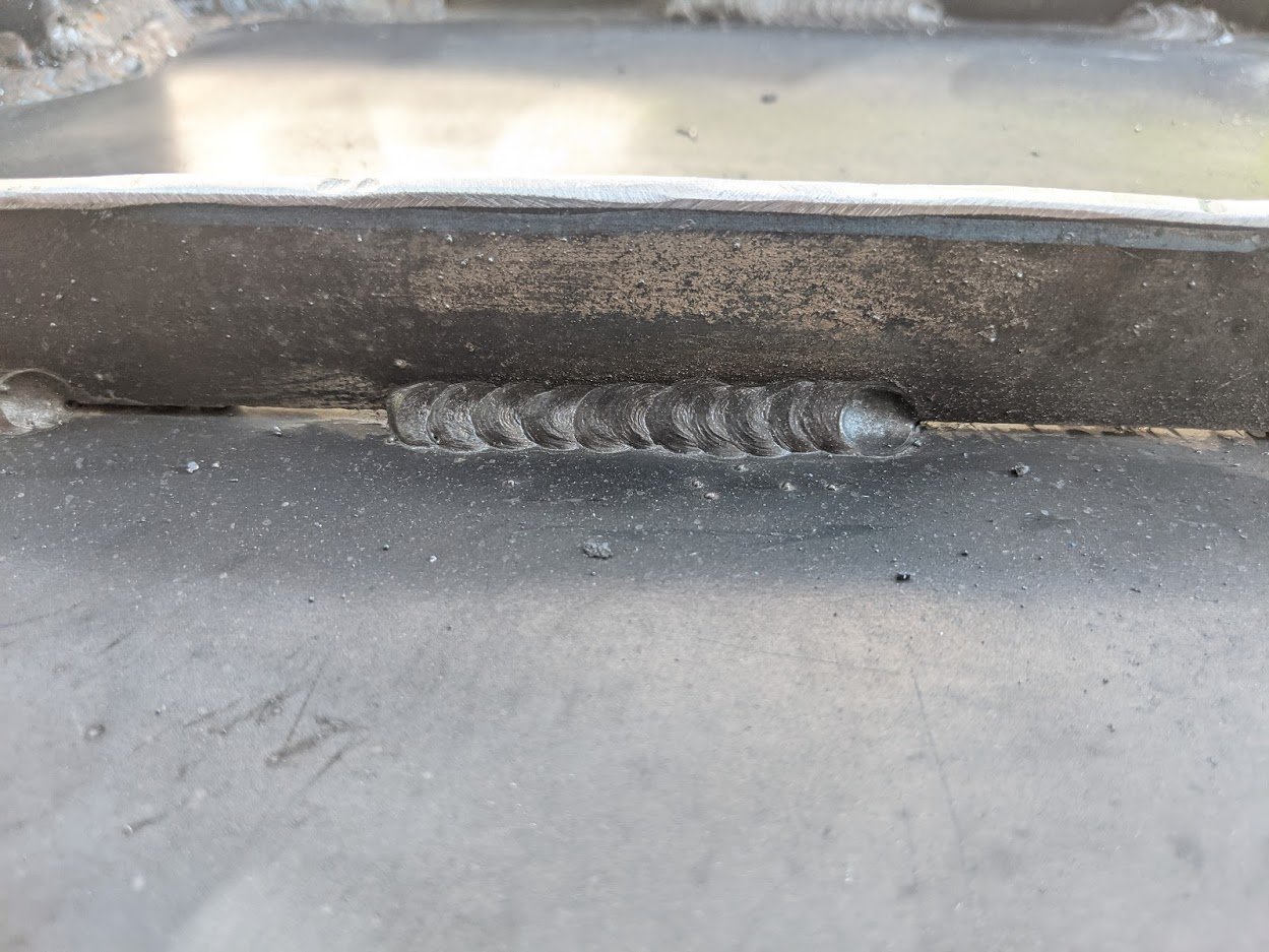

    Chamfer one side (left in this picture) about 1/3-1/2 of the way down the face. Voltage turned up a bit. Again kinda hard to make out, but the penetration biases the chamfer side (left) and is visually wider

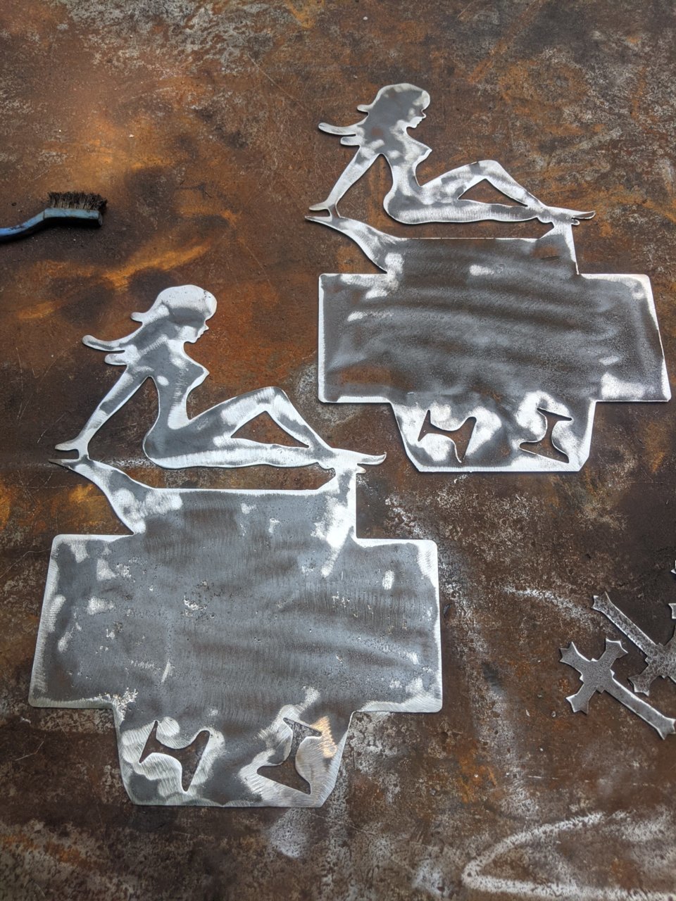

    Chamfer both sides. Penetrated almost all the way through. I also tried to be more even with my movement of the gun into the top and bottom pieces

    If I have to do a butt weld like that, I just leave about a 1/8” gap between the plates so the weld has somewhere to go. Helps it lay flatter rather than pool on top. No idea if that’s the correct way to do it, but that’s what I do.

    The last one I did also leave a little gap, which I forgot to mention. Probably not 1/8", but maybe closer to 1/16". Probably another reason it had better penetration. The top one was no gap at all and the lower voltage, intended to be a worst case in my head

    @y=mx+b ^ this. Flux core will tend to lay a hotter, although “thicker” bead. So you’d want to leave a bigger gap especially when welding thicker material. I’d say leave a gap wide enough where you can slide the welding wire between both pieces without resistance. That and chamfer the edges a bit. This way you can set yourself up to have good penetration and not leave a mound of weld over the connection that you’d be tempted to grind down (thus reducing the strength of the joint).
    I’m no expert either and I’m self taught but I watch the YouTube’s and read tech articles in car magazines.

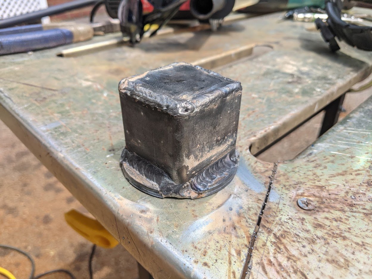

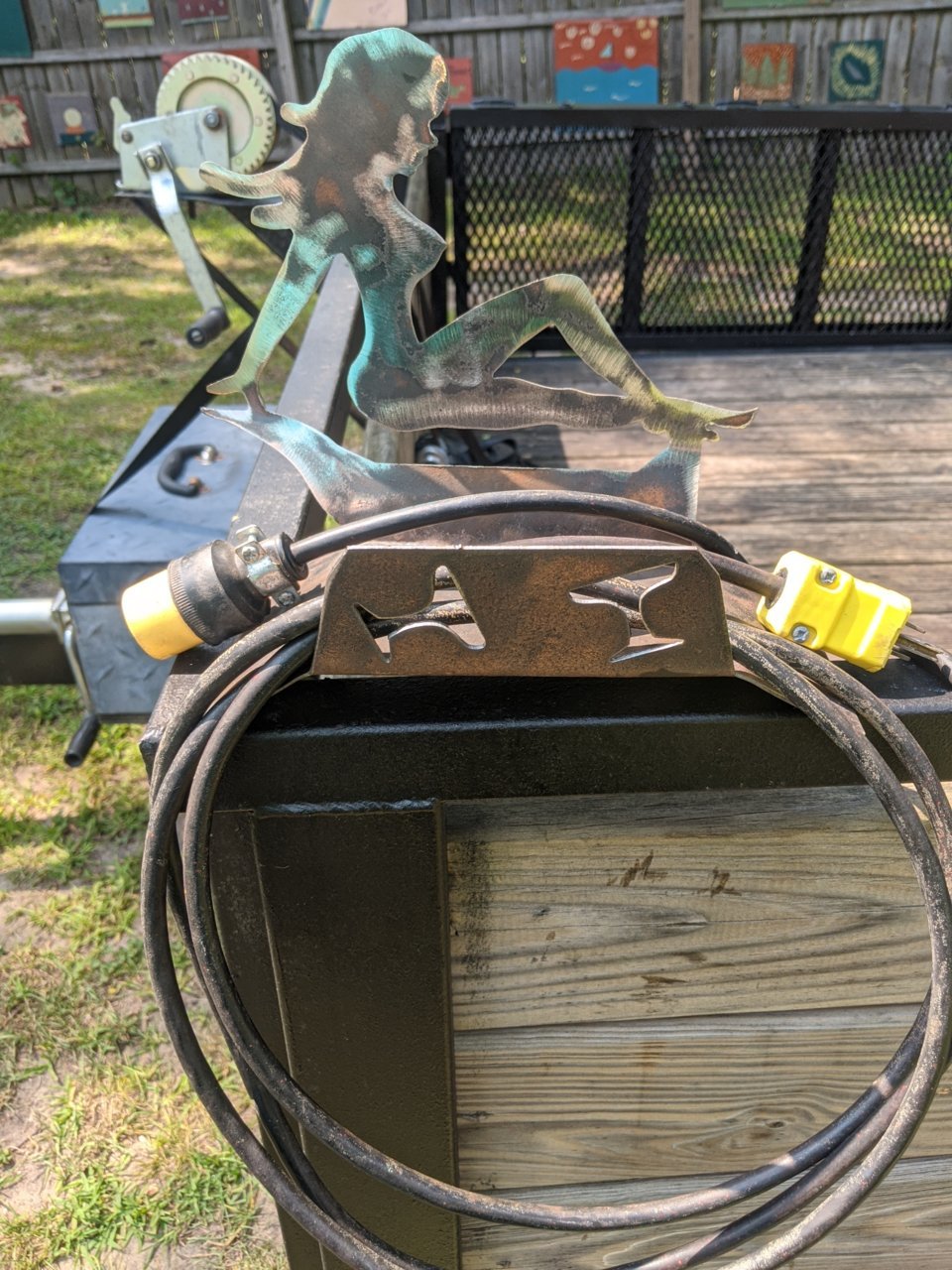

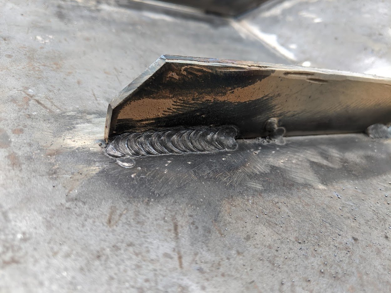

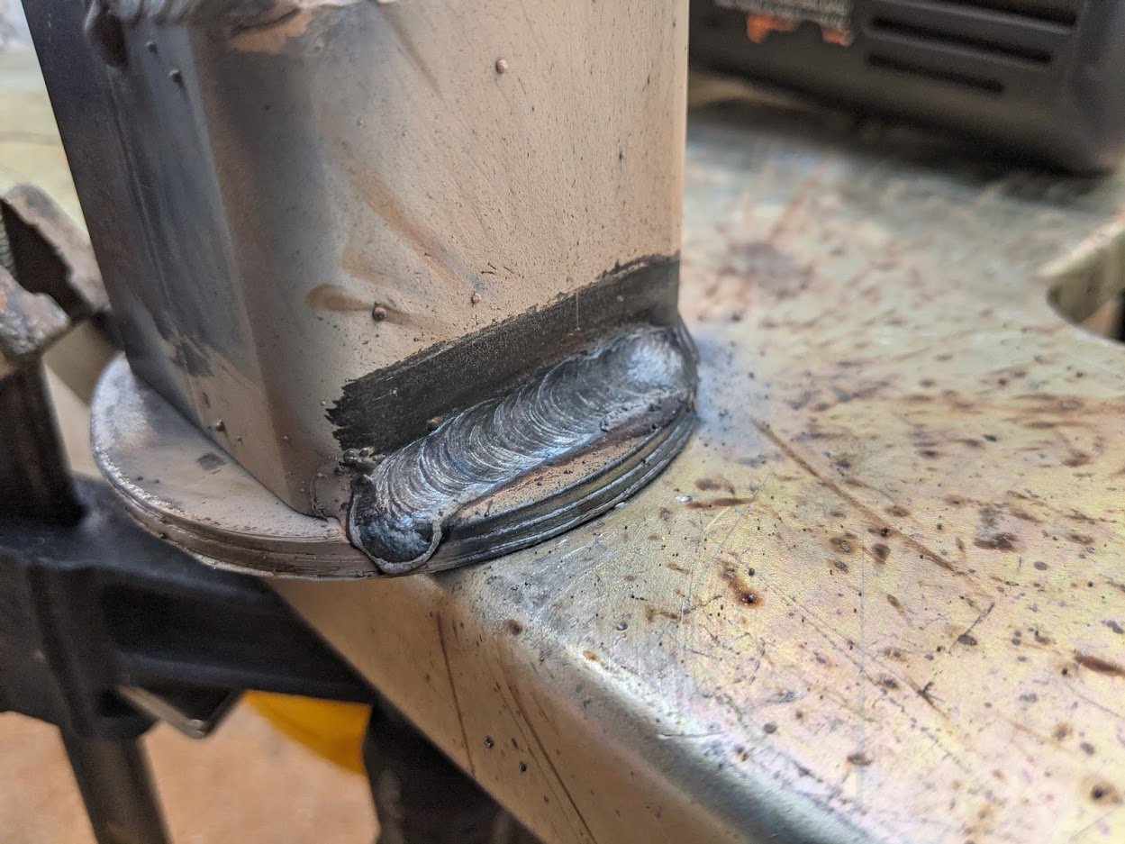

    Yep I've done a fair amount of T joints and open corners making my skid plate. I was practicing and experimenting with butt welds for a project that has a few of them, since they hadn't previously turned out how I would like them
    Here are some recent ones I've done, open to feedback

    Looks good to me. As others have said: slow is smooth, smooth is fast.

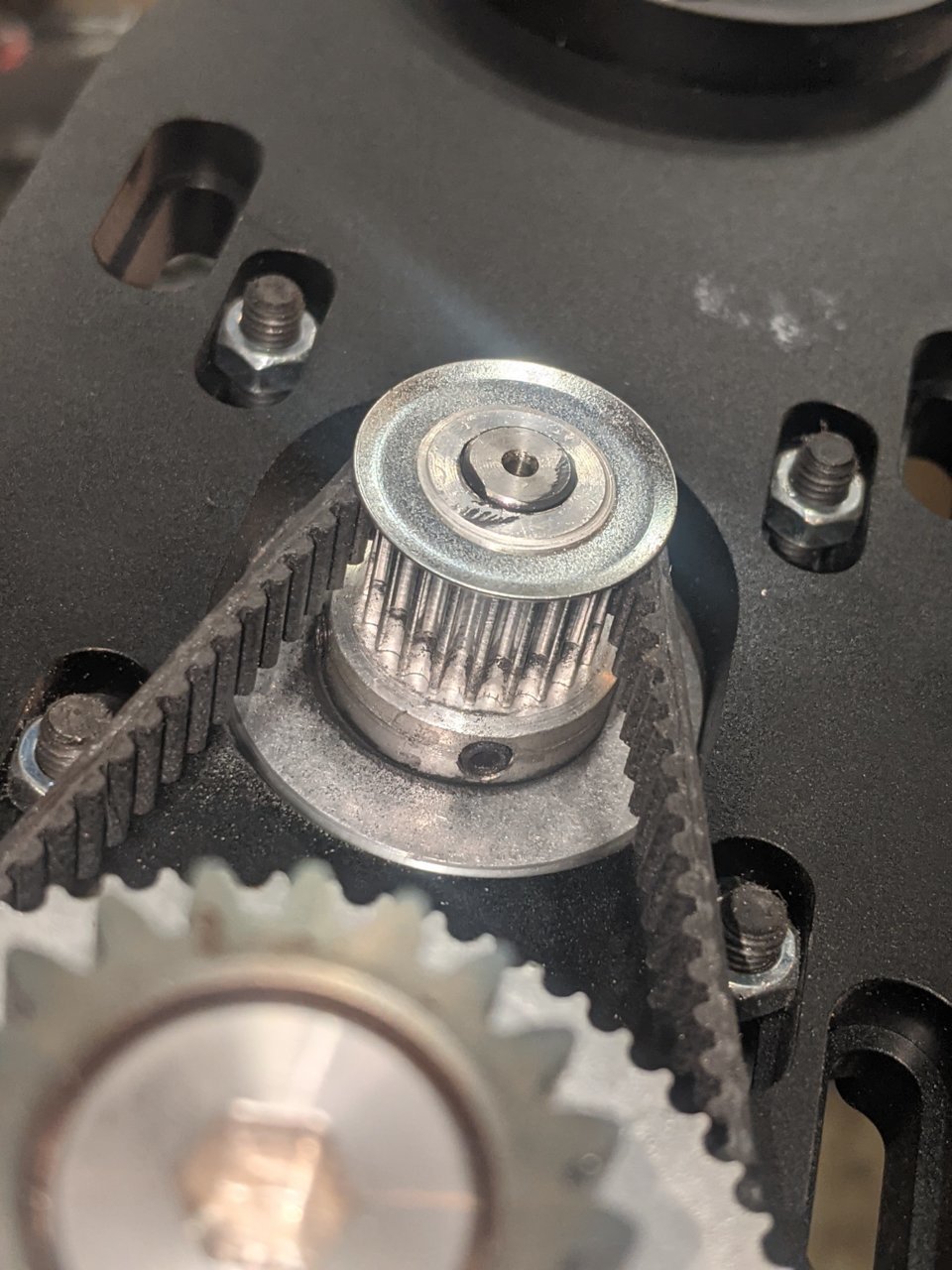

    Can anyone tell why my A axis stepper and Slave axis stepper motor would not stay syncronized?
    These home built plasma tables require constant attention!
    I have to fuck with this thing Everytime I use it!PXL_20210804_150210349.jpg
