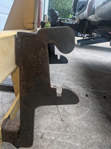

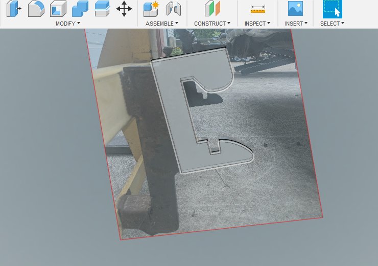

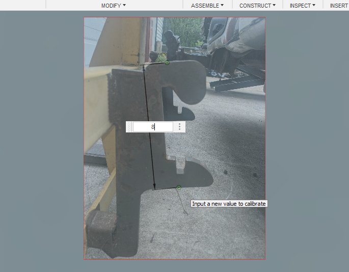

    Designing the quick attach bracket. Took a pic of the bracket on one of the existing brackets. The bracket is 8" long. With that info I was able to "calibrate" the picture to exactly what size the bracket needs to be.Tv2v02sPOVV7rw8UTKMBLFpSmC4kgO7YtCz6N5OO_ae7051efe9f8da878500ac7d28c840f1d4f5574d.jpg

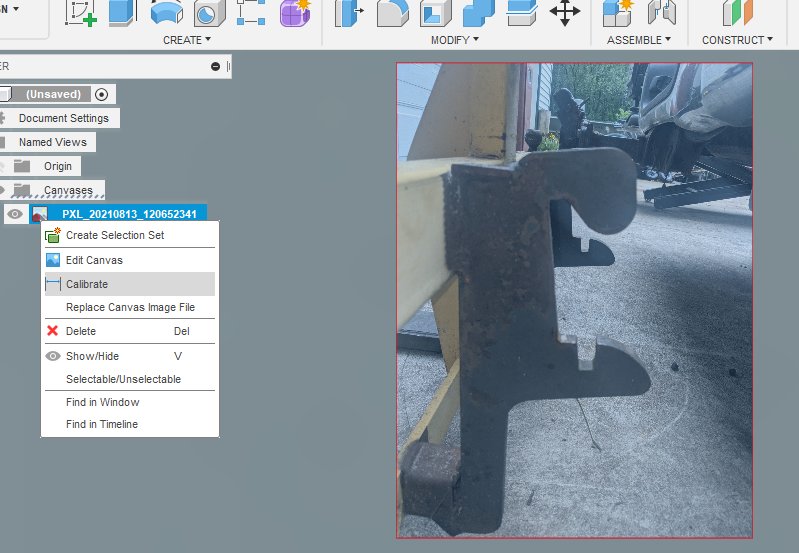

    When copying pictures to F360, you are inserting a "canvass".
    I used the measuring tool to tell the computer that the lengtn was exactly 8". Once I did that, the computer "calibrated" an enlarged the picture huge! I had to zoom in to get the picture you see and then I could trace it using the various "line" tools.

    Picture is now turned into a traced image. I still need to give it some thickness by "extruding" or using the "press/pull" command.

    I copied the original tracing and am pasting it to the position you see. Once I hit enter there will be 2 of the tracing. It works very similar to the copy/paste taht you use with your computer.
    I can now move over to the manufacturing section to create the Gcode (about 12 more mouse clicks).

    Damn!
    I forgot to round off the top of the bracket! That is called "fillet". Just takes a few mouse clicks to make that happen.

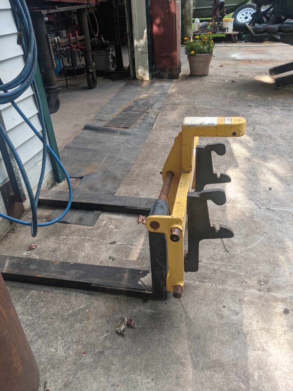

    Hi-lift?

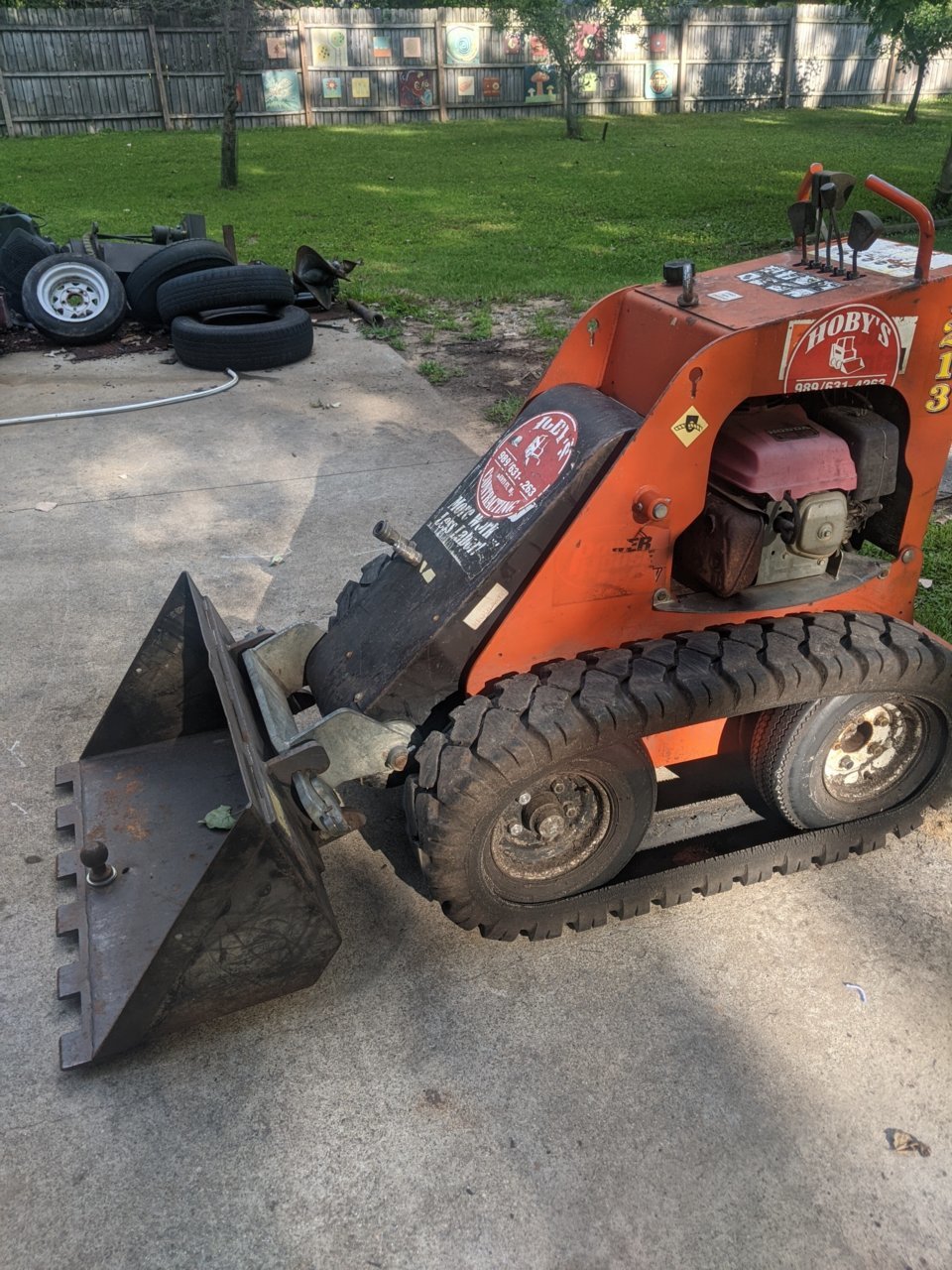

    Is a hi-lift another name for pallet forks?
    I'm making quick attach brackets for a claw bucket for this little guy.PXL_20210814_221034095.jpg PXL_20210814_221045678.jpg .

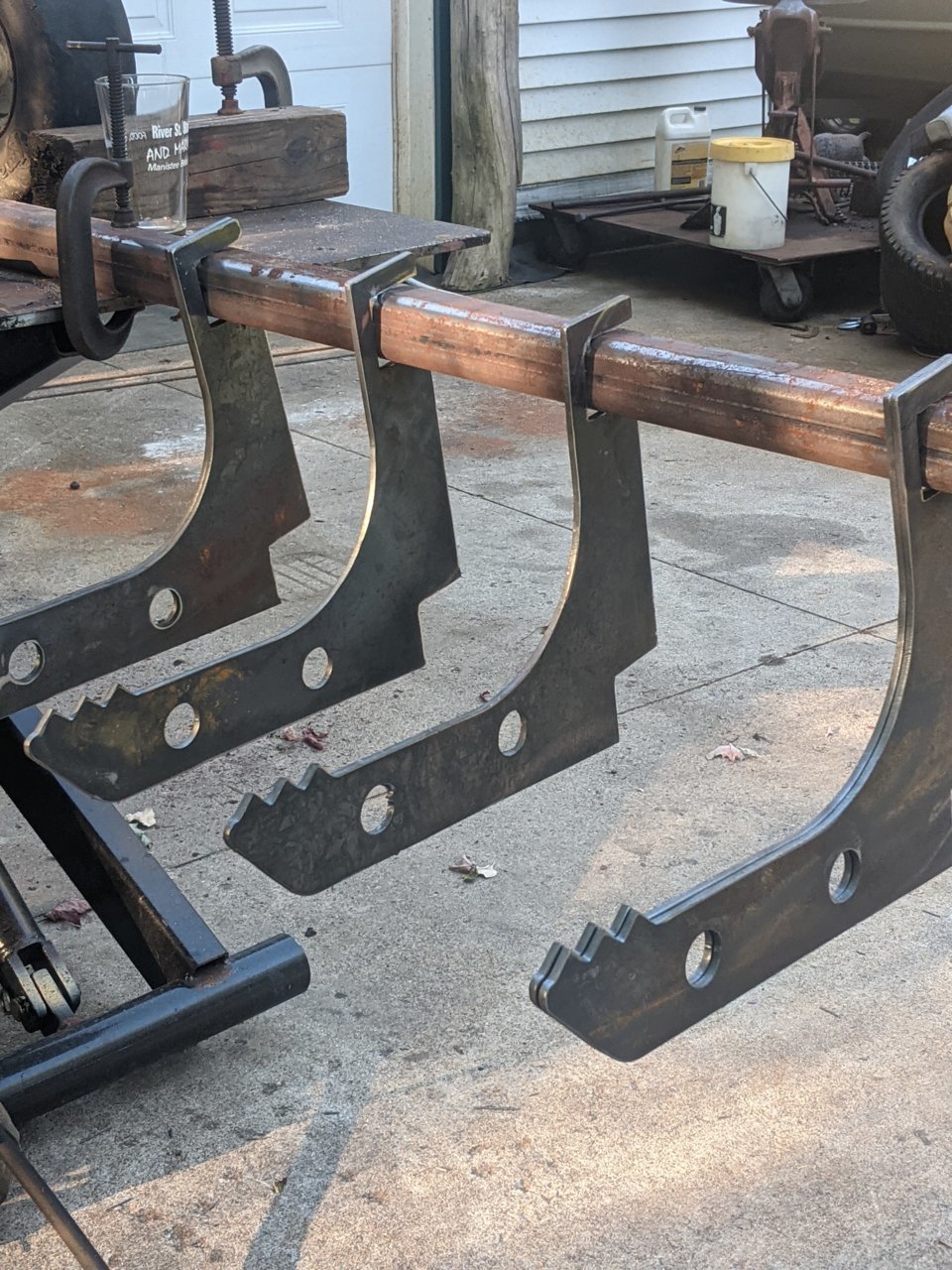

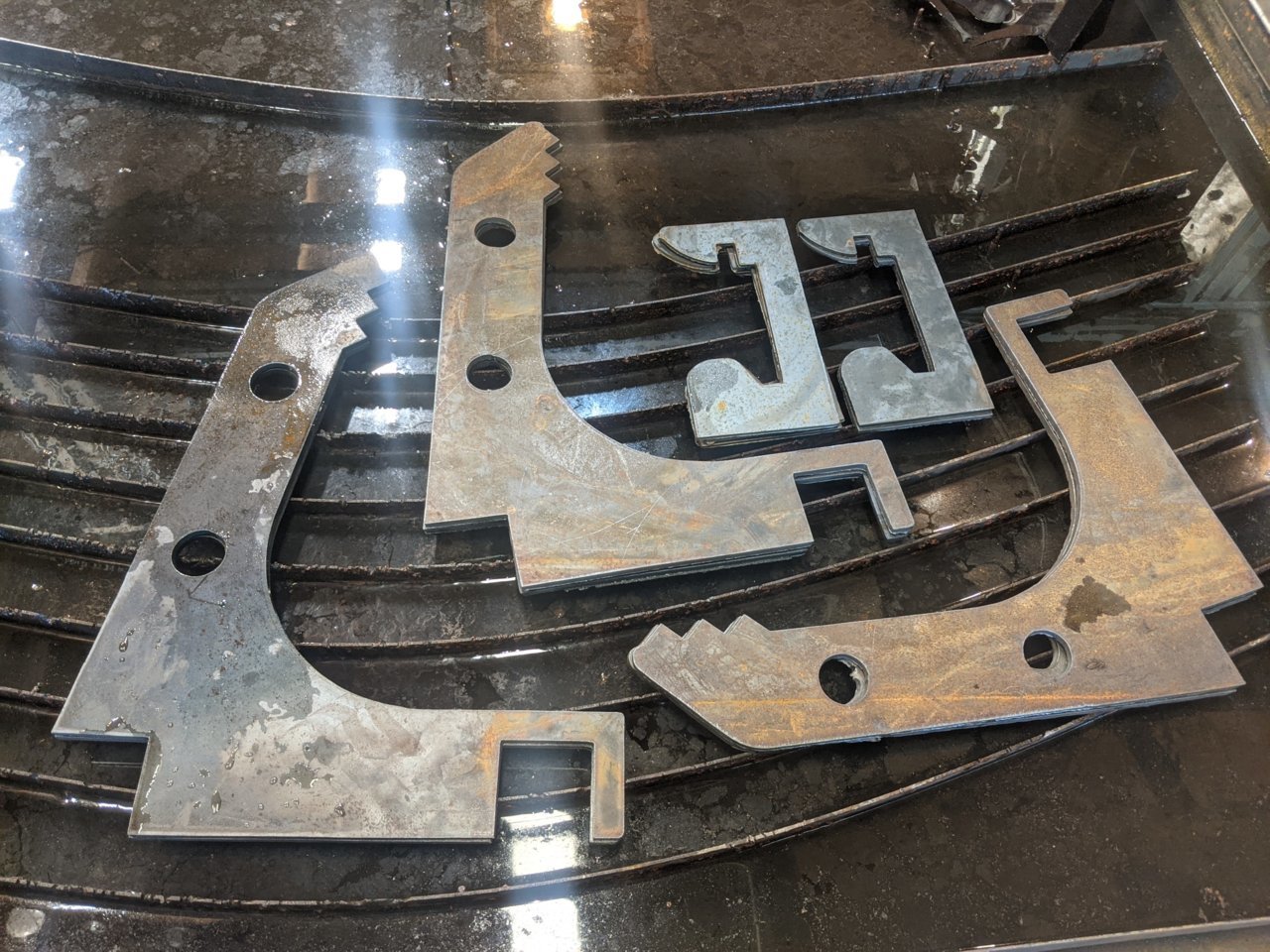

    I got the quick attach brackets and the lower bucket jaws cut out.
    Just need to weld the layers together and then weld them to the cross bars.
    I still need to cut out the upper jaws, but ran out of time.PXL_20210814_220927369.jpg PXL_20210814_220927369.jpg

    Parts 90% cut out.
    It takes much longer when you have to hunt for pieces of sheet metal big enough for the part you want. Still having fun.
    Chipped off the dross and quick flap wheeled the parts for a partial mock up.PXL_20210815_230257009.jpg
