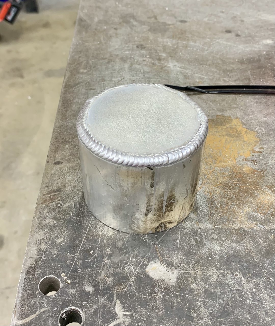

    Got a chance to test out the new hood today. Not my finest work but after being trapped in my bedroom for 14 days I was just excited to burn some rod, even if I did only have 5356.

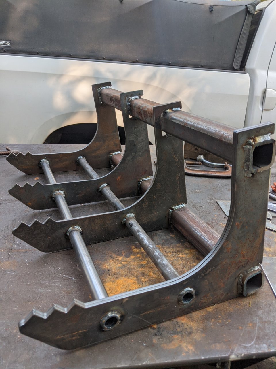

    Made a little progress with my jaw bucket, which I cut on my CNC plasma table. I think the cut of a plasma is amazing! Just knock off the dross and the part looks like it was stamped out.PXL_20210820_200806167.jpg

    ^^^ Man with a plan right there! ^^^ :thumbsup:

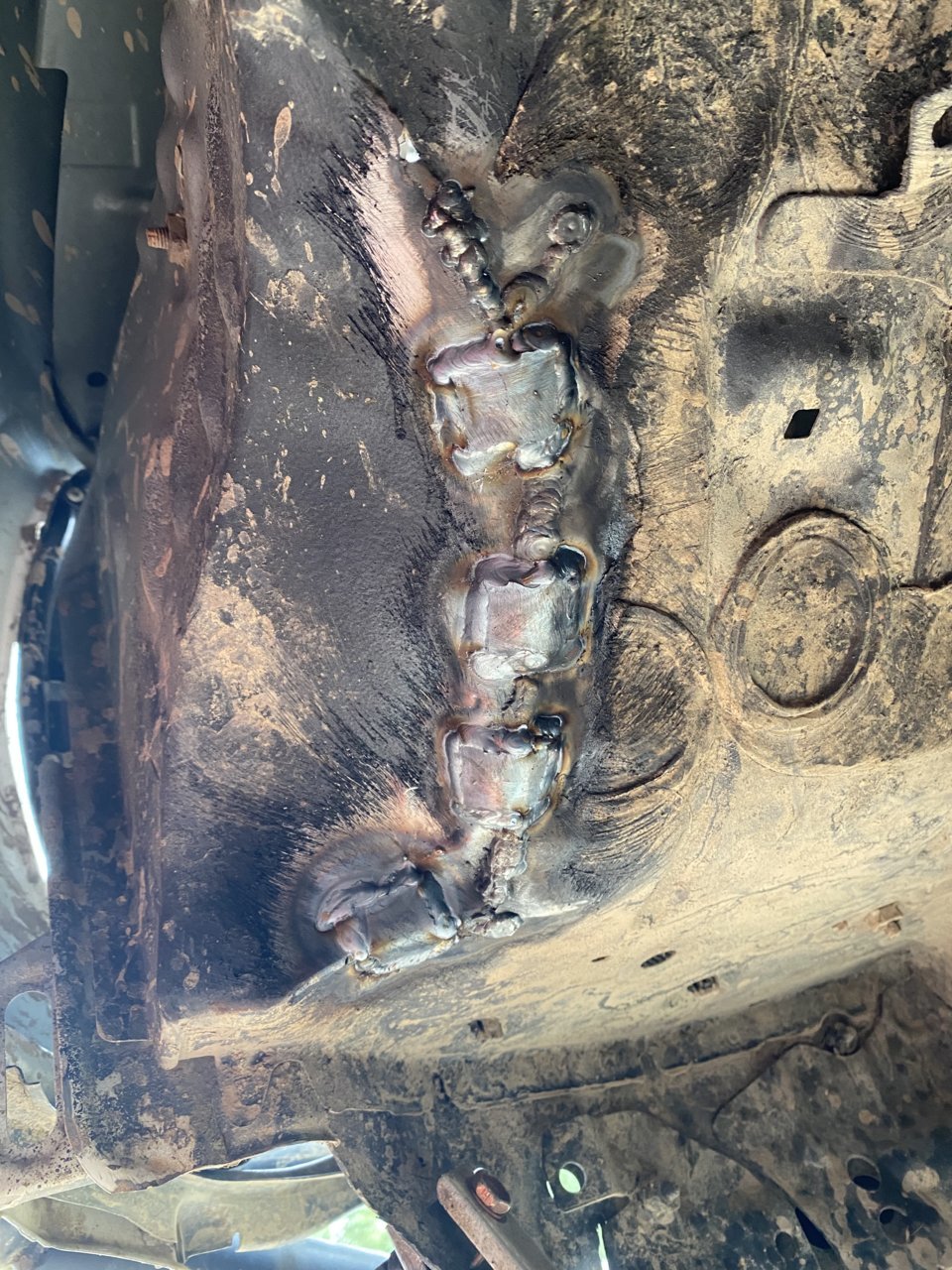

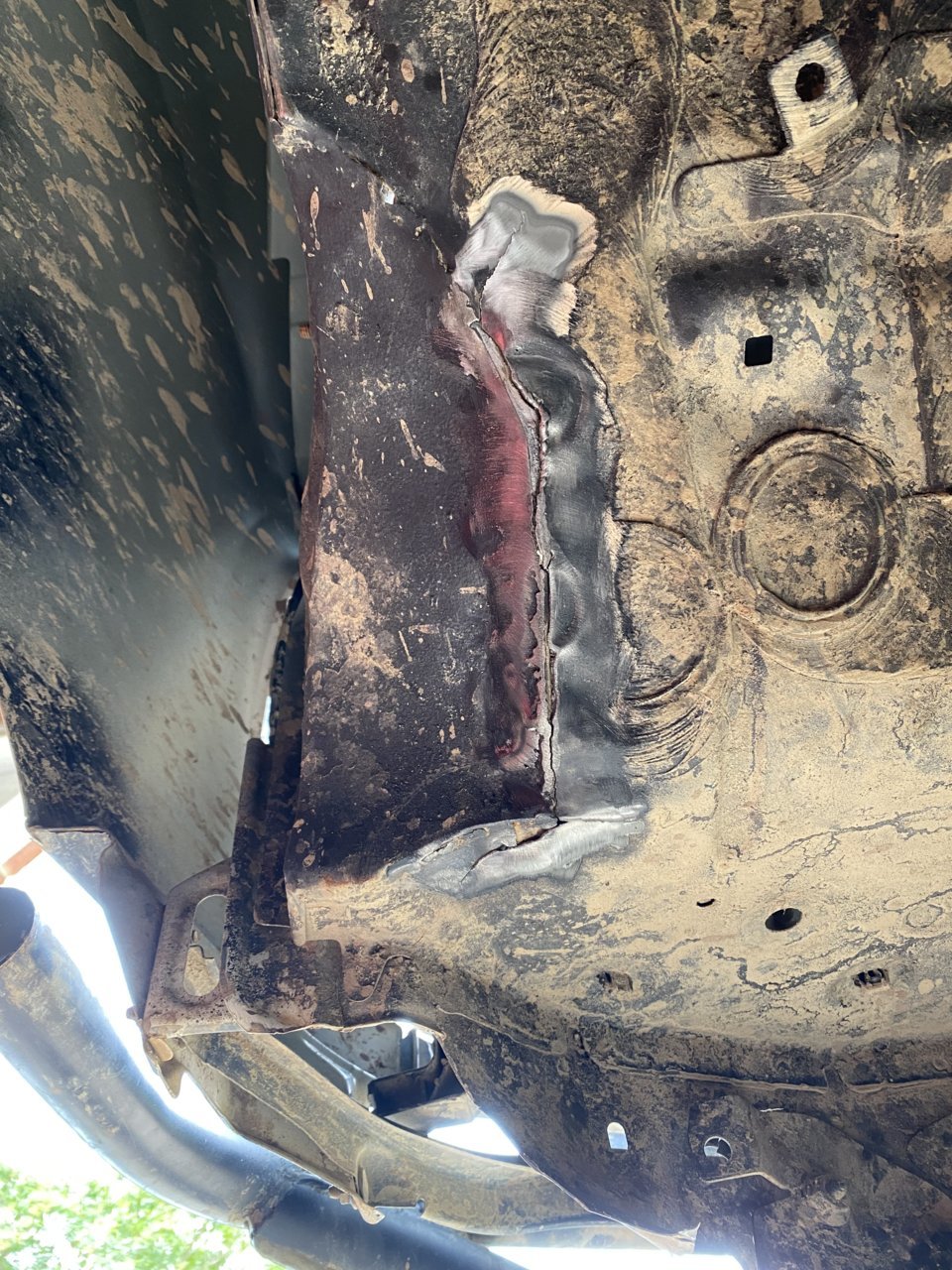

    We’ll see how long this holds. Drilled the ends, thin strip of 14 gauge as a backer, butt welded the whole length and added some 14 gauge “straps”. This is in a high stress area under the battery that can tend to crack with aggressive wheeling.
    still not a fan of mig’ing the thin stuff but I am getting better.
