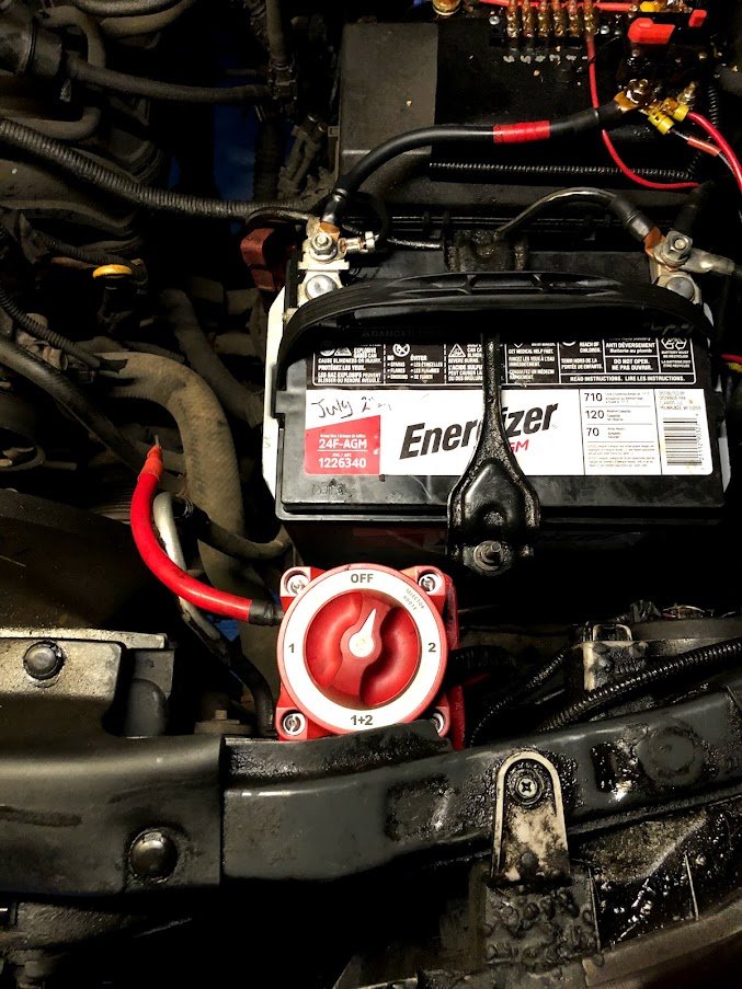

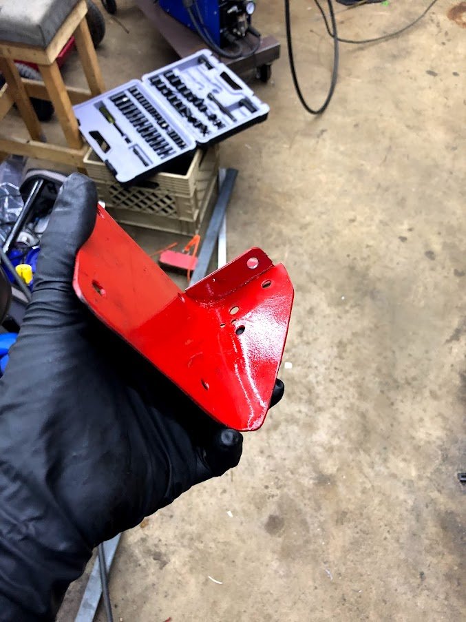

    fabbed up a mount for the winch on/off switch out of scrap 16ga.

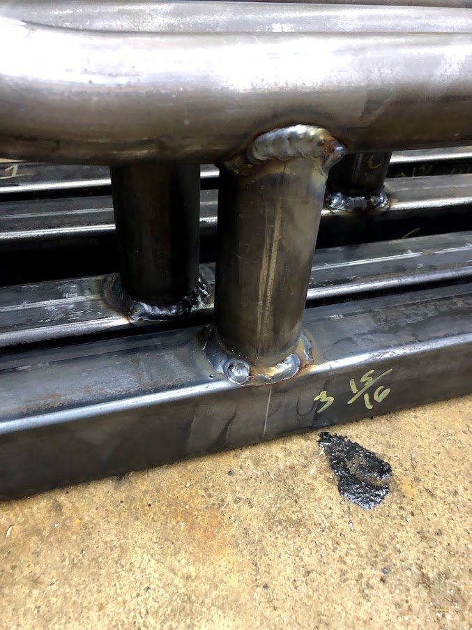

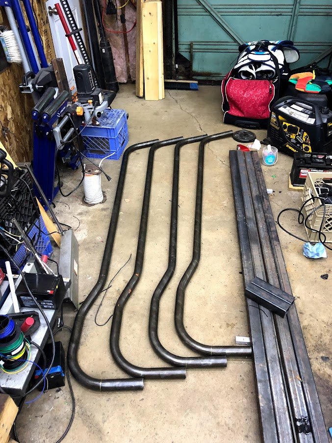

    and making some sliders for some friends in the NSBS thread

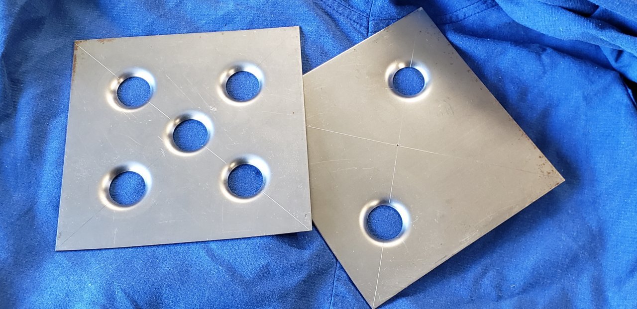

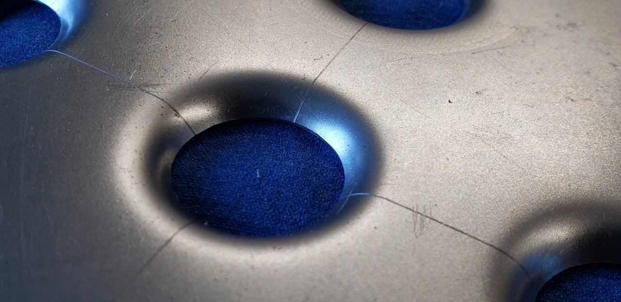

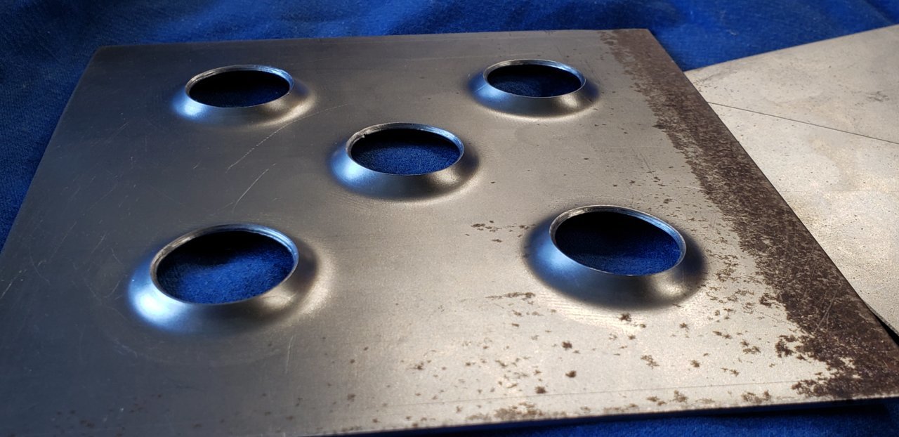

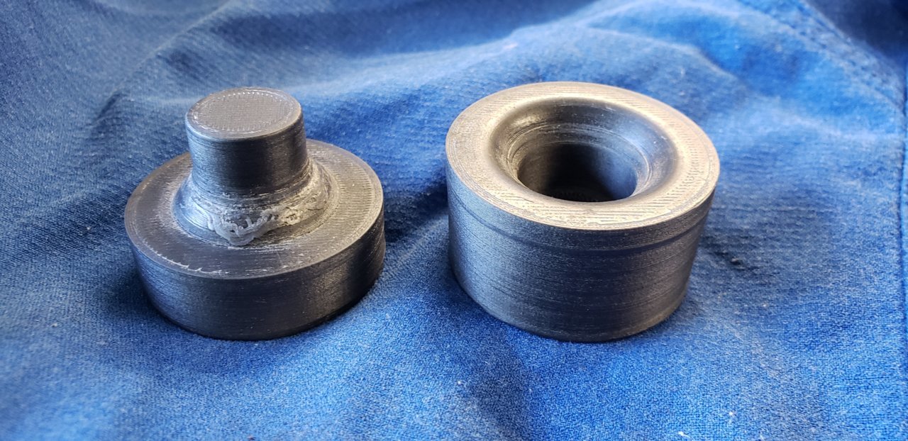

    I have always wanted a set of dimple dies. even though I never really NEEDED a set. After I bought my 3d printer, an I got comfortable with it, I started looking into some "exotic" filaments. I came across some Carbon Fiber Nylon. It is then I had an idea, why not print a set of dimple dies.
    I played around with a design and printed a 2" dimple die, and it worked, although I was not happy with the appearance of the print or the dimple it made.
    So I kept messing around and I came up with a design (ie google image search ...) I drew up a 3/4" die set and ran a print. Of course when it came time to test the die, I wanted to do something that could be somewhat useful. So I came up with a a pair of 6" dice faces. one with a 5 and one with a 2.
    You can see below the fairly even dimple

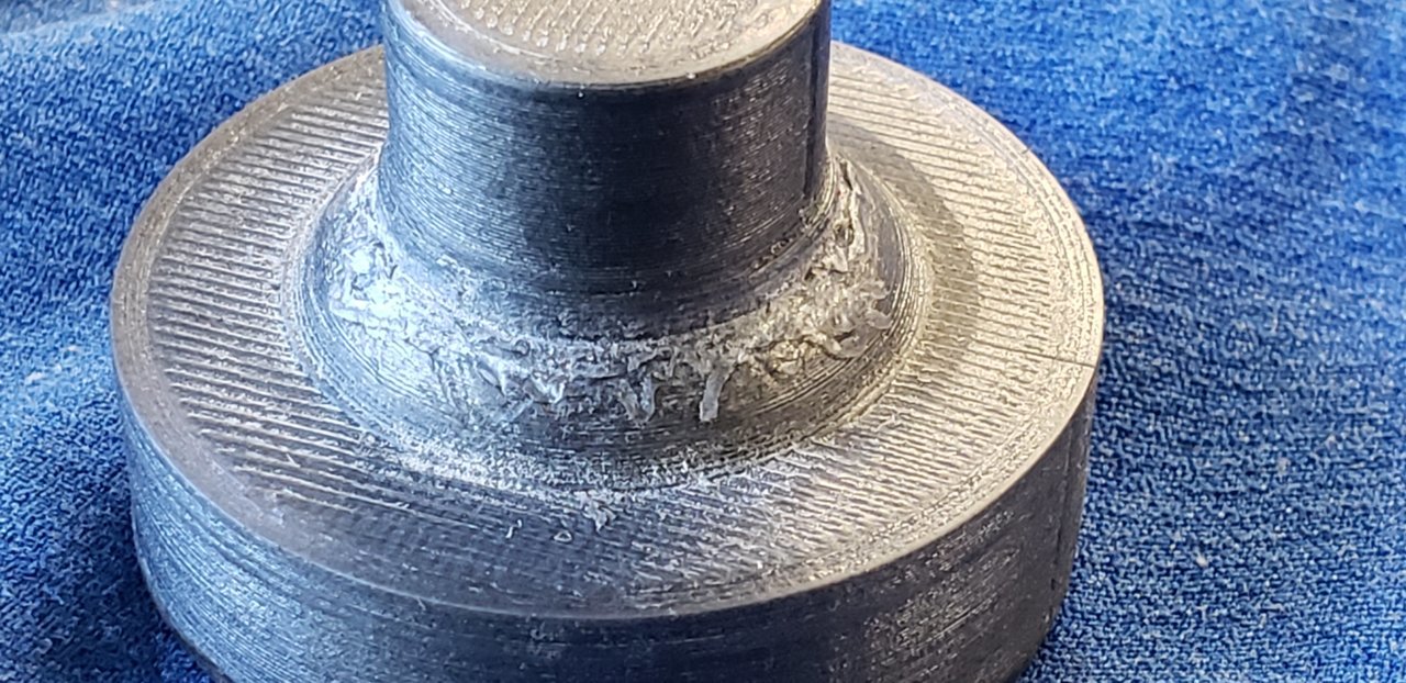

    The die after doing 7 holes.. you can see some slight wear at the point where the pilot section and the start of the dimple meet
    If I increase the fillet size at that location I suspect it may hold up better. but for casual use, and for something made of plastic I am very please with results, total print time for this die was about 9 hours.

    Nice work. Holding to .0625 tolerance is noteworthy on sliders.

    That's awesome, I love seeing 3d printing being mixed into fabrication stuff.

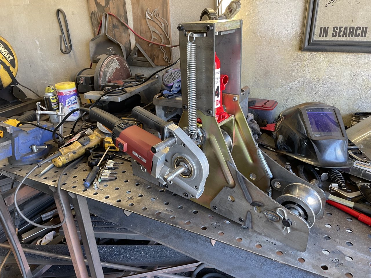

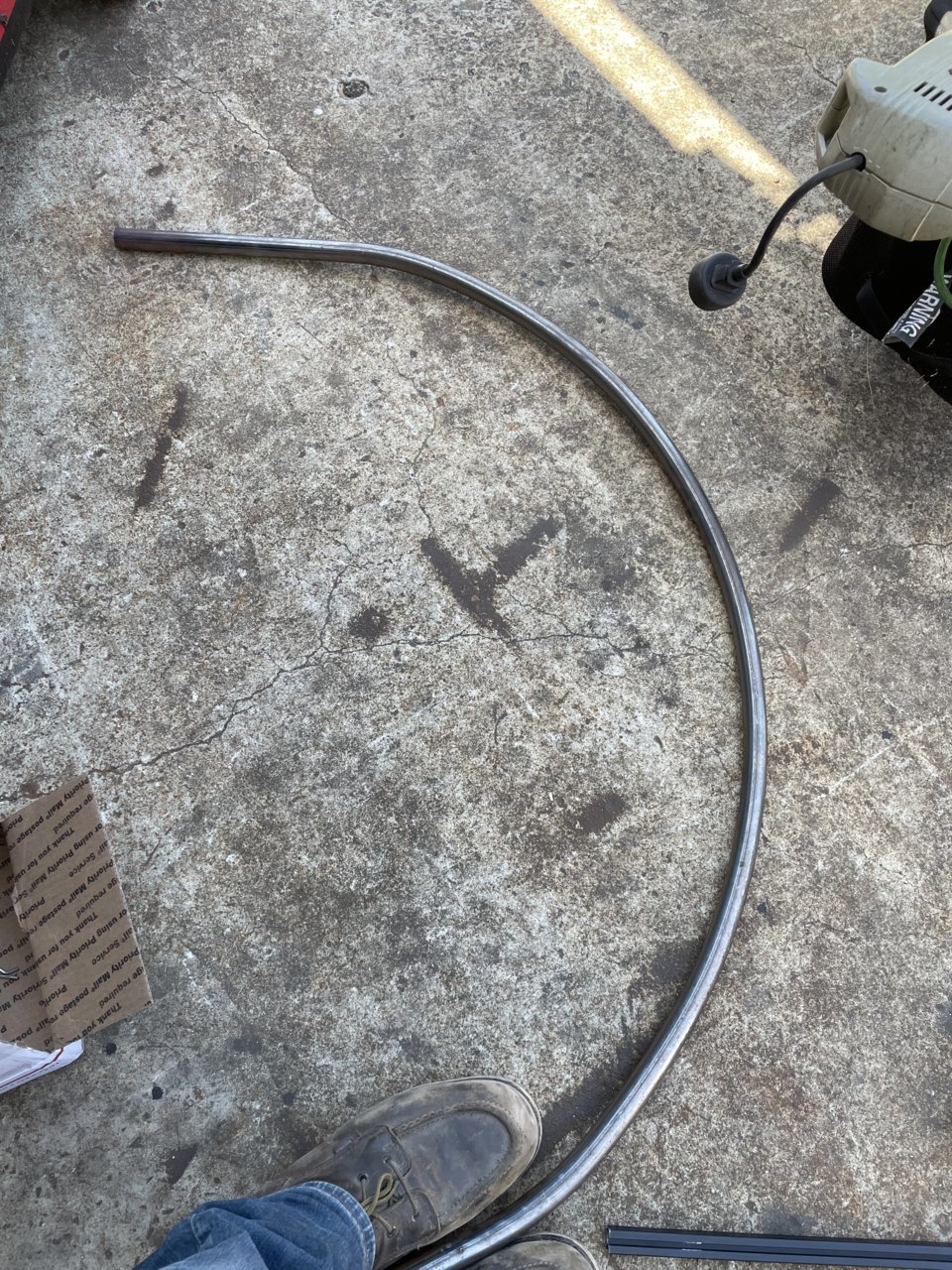

    Boss bought a harbor freight tube roller and the swag offroad kit to beef it up and make it electric driven with the pipe threader.
    put that all together today and did a quick test on a piece of 1” round tube

    That’s going to be my next purchase once they release another coupon.

    Looking good.
    I messed mine up when I installed the wings. I was in such a hurry to weld it I didn’t make sure all the pins sat perfectly level to each other. It made trying to keep your bends straight even harder than it already is with everything done right. I ended up buying pre cut sides to replace it.

    I’m probably gonna pick one up too now that I see how well it works haha. Don’t really need to roll a lot of tube but it’s America and I want one
    Thanks dude. Haha I wanted to bang it out quick but I decided to watch the video on YouTube of how to put it together and I made sure to watch each step, pause, weld the piece, watch the next step, pause, weld the next piece, and so on haha. So it wasn’t too bad! I love swag offroad. They make some awesome stuff

    Thanks... the idea of 3d printed tooling is something I find to be an amazing leap for the home shop. I am tempted to try that printed die on some 1/8 mild steel just to see of it will survive.
    I am going to try embossing a custom "license plate" next
