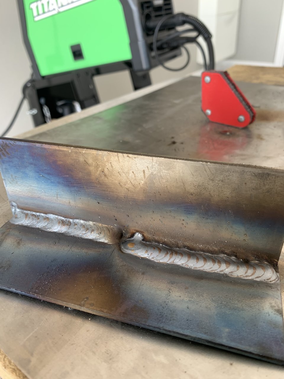

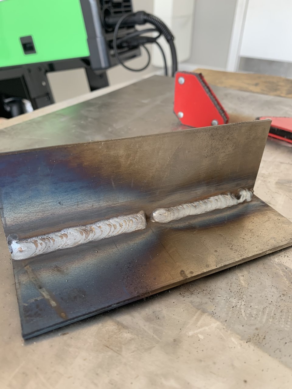

    Welded with gas for the first time this weekend and damn its smooth. Even flux is a lot smoother than on the titanium. The Migmax is really nice machine and i couldn't be happier. Just need to diel in settings a little more.

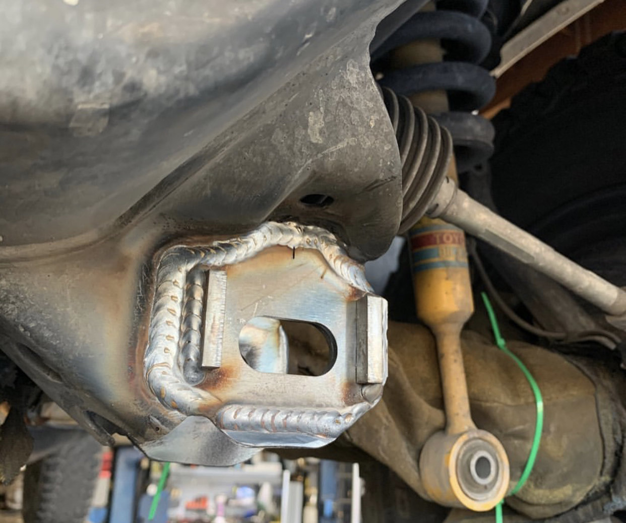

    cam tabs don’t have a ton of load on them. You’ll be fine with the flux core.
    I met a guy that had pelfreybilt weld a set of spindle gussets for him without removing the spindles from his truck. He told me pelfrey told him it was a bad idea, but he decided not to listen to their warnings, each of his cv boots had dozens of pin holes in them.
    I used a cut up old leather welding sleeve to wrap the axles when doing cam tabs. You can see it in the background of this pic. I usually zip tie it or tape it place to make sure nothing is exposed.

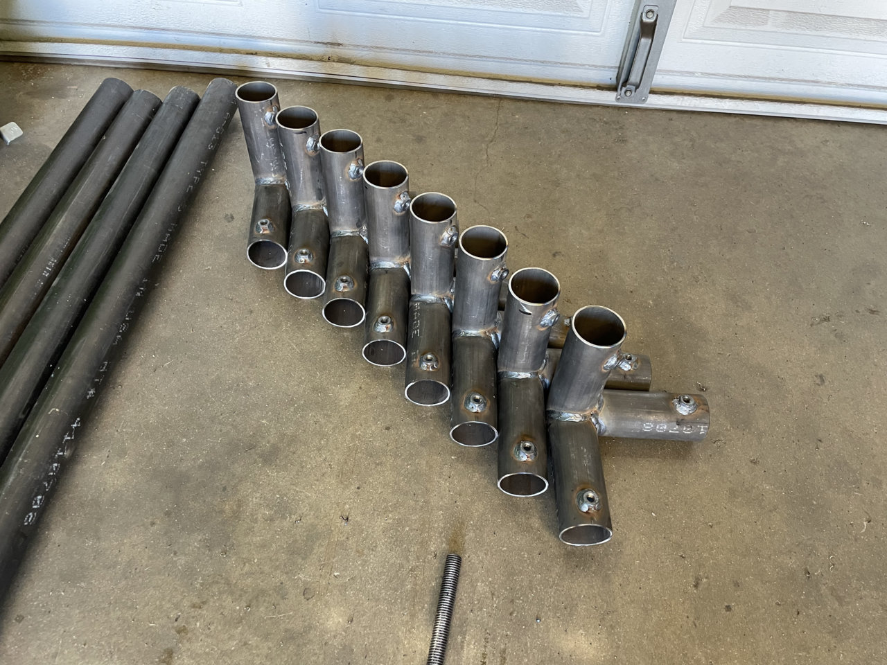

    Banged out a set of sliders today and made eight 3 way coupler corners for my boss. I have to make 32 more next week
