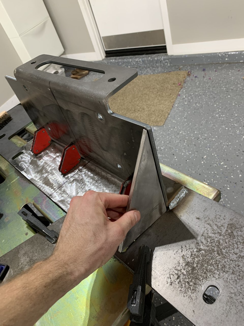

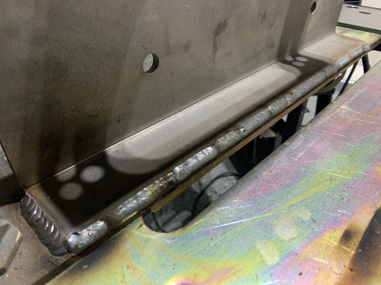

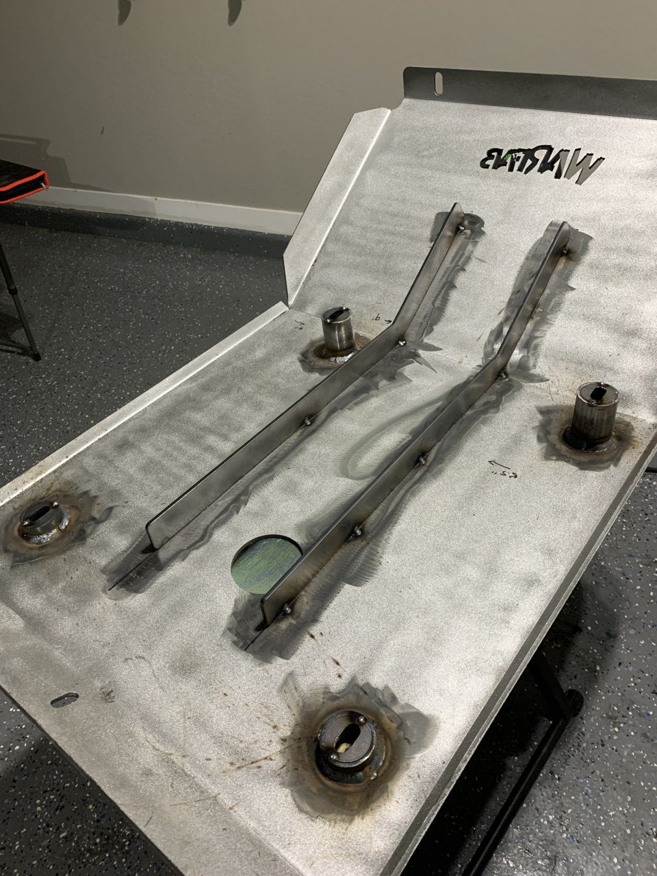

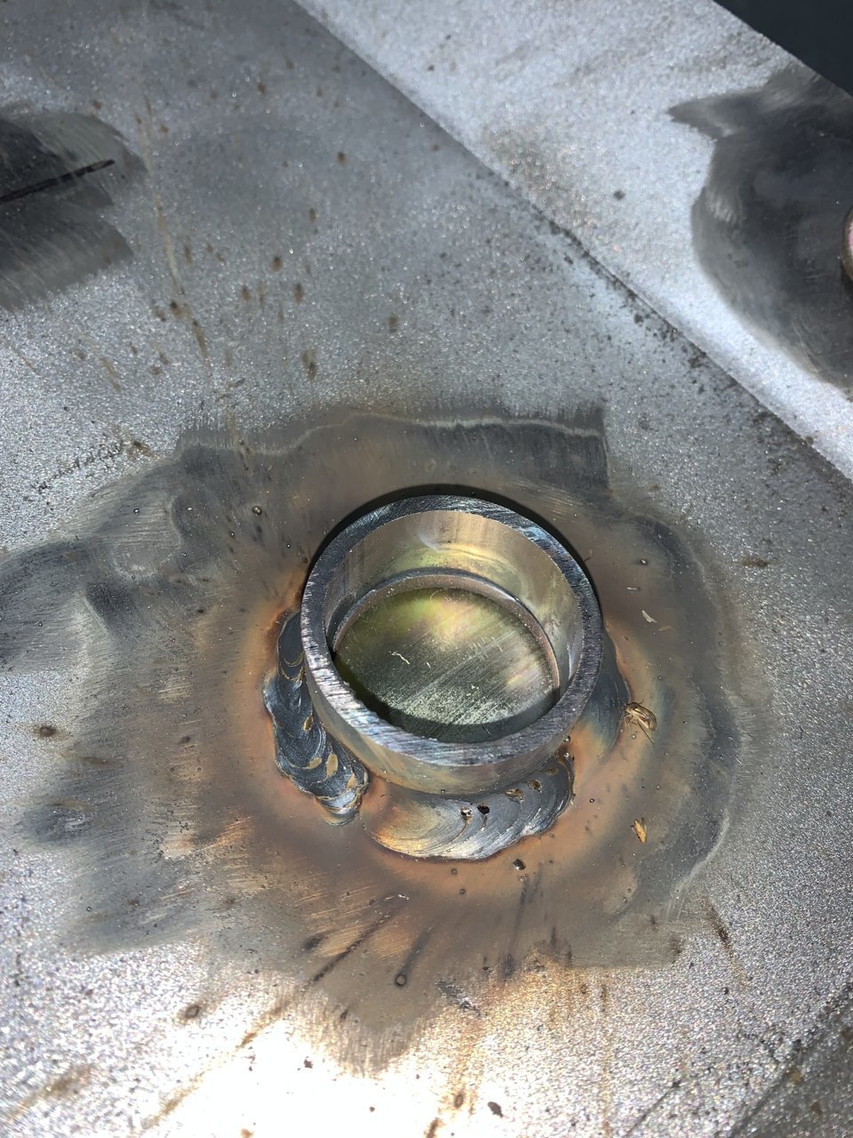

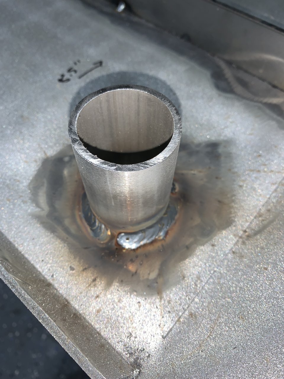

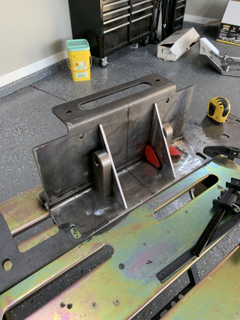

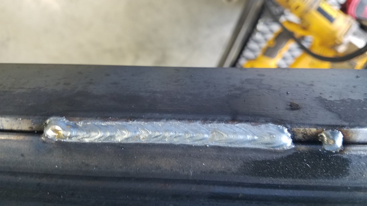

    Alright, finally started on my 1/4” winch tray. Definitely seeing some undercut & overall just feeling like I’m a bit too hot but the pretty colors weren’t out of control like I’ve seen before. I also was joining an awkward seam here so maybe this was expected given the sharp edges of the pieces I was joining. Cut some gussets out of 1/4” plate with my angle grinder. Fun times. Also welded the skid bungs & tacked the ribs and bolt coins in there. Will do a test fit before I fully burn in the ribs. Tomorrow I plan to cut 2 more smaller gussets for the tray. Now that I look at the long seam on the winch tray it looks like too much wire speed no? This was my first time welding around pipe/tube. I can see that I should have made my groups a little tighter perhaps

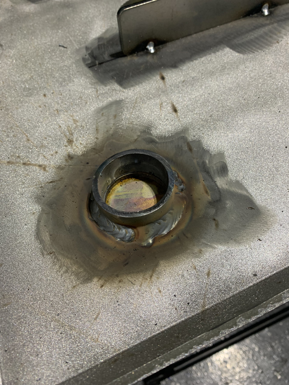

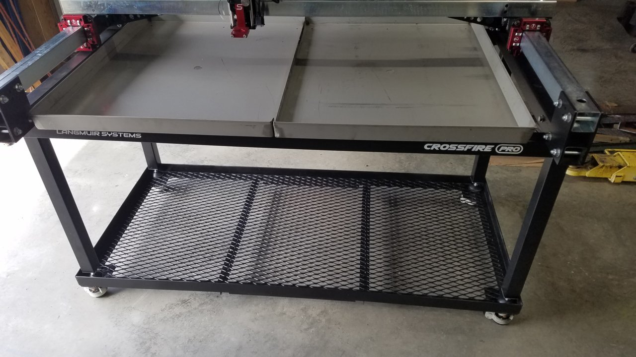

    Got started assembling my CNC table this weekend. I got the frame together, then stopped to build a dolly to sit it on.
    I used 2"x 2" angle. I made a rectangular re-enforcement under the center section of the shelf because the water tank will be there. Roughly 130lbs. I used a piece of garage door opener chain rail for the rectangular support frame. That stuff is pretty strong for it's size, but needed some serious cleaning before I could weld it half way decent. Used Acetone and flap disc.
    The expanded metal is tacked all the way around, across the center rails, and is the thicker variety. Probably going to sit my plasma cutter in under there too. I cut out the corners so the table legs were not sitting on exp metal.
    I got to some small self levelling casters based on a recommendation on Langmuirs forum. I'm hoping I don't regret not going with larger wheel size. I usually like 4" wheels so they don't react to every little piece of crap on the floor.
    I gotta get up the nerve to try and TIG the tray halves together. They supply sheet metal screws and sealer, but I spent the money to have a TIG welder, kinda feel :anonymous: if I don't try to weld it.
    My welds are never appearance brag worthy, but on clean steel, I am decent. I've only had one weld fail, and that was on a ladder rack on a truck. I think that was more harmonic vibration induced from a long length of 1" tubing vibrating while driving.
    Having poor eyesight sucks because I can never keep my glasses at the right angle for normal vs bi-focal vision. I mainly weld with my hands, not my eyes.

    You have nothing to be ashamed of. Those welds are fine.

    There is no reason you can`t bevel the joints.
    Even more you can bevel and leave a gap for even better penetration pretty much the normal once the material gets thicker and depending just what your working on.
    This comes with experience you know what needs to be done.
    Settings can be a trail and error and at times need some minor adjustments to the point you no longer even notice when you make them.
    If you feel you have a hard to weld joint move the weldment or your self to be more comfortable and be able to see.

    And, I am no expert, but your welds look great.

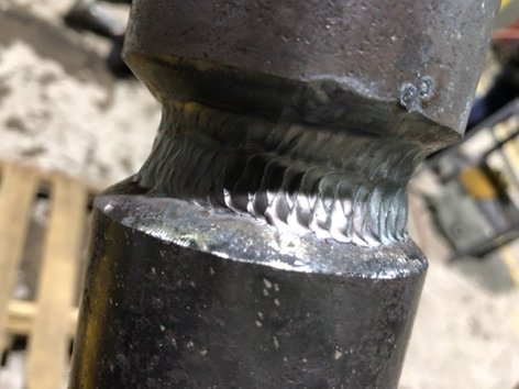

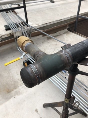

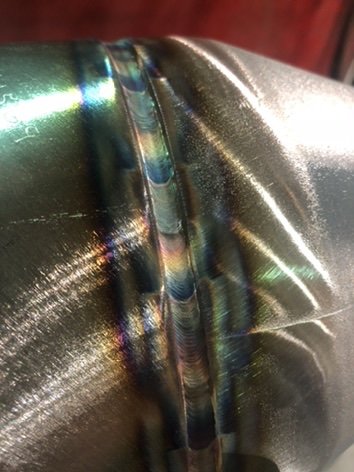

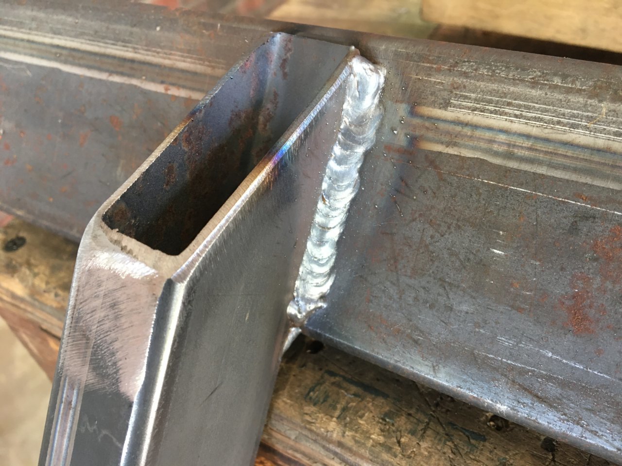

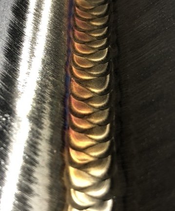

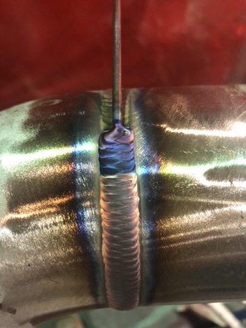

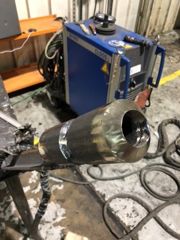

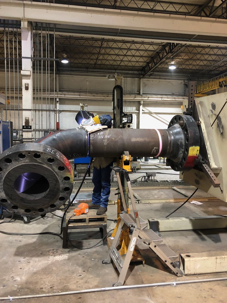

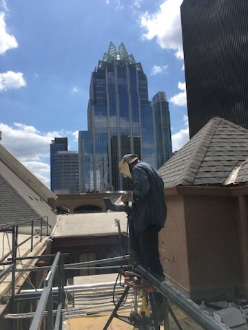

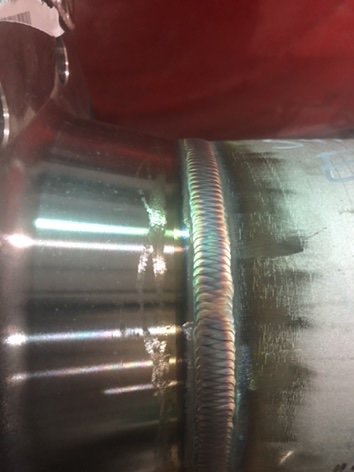

    IMG_0295.jpg ^Austin,TX
    IMG_1571.HEIC.jpg^the wife did these
    IMG_1625.HEIC(1).jpg ^little more to go
    IMG_1623.HEIC(1).jpg ^thick ass wall pipe

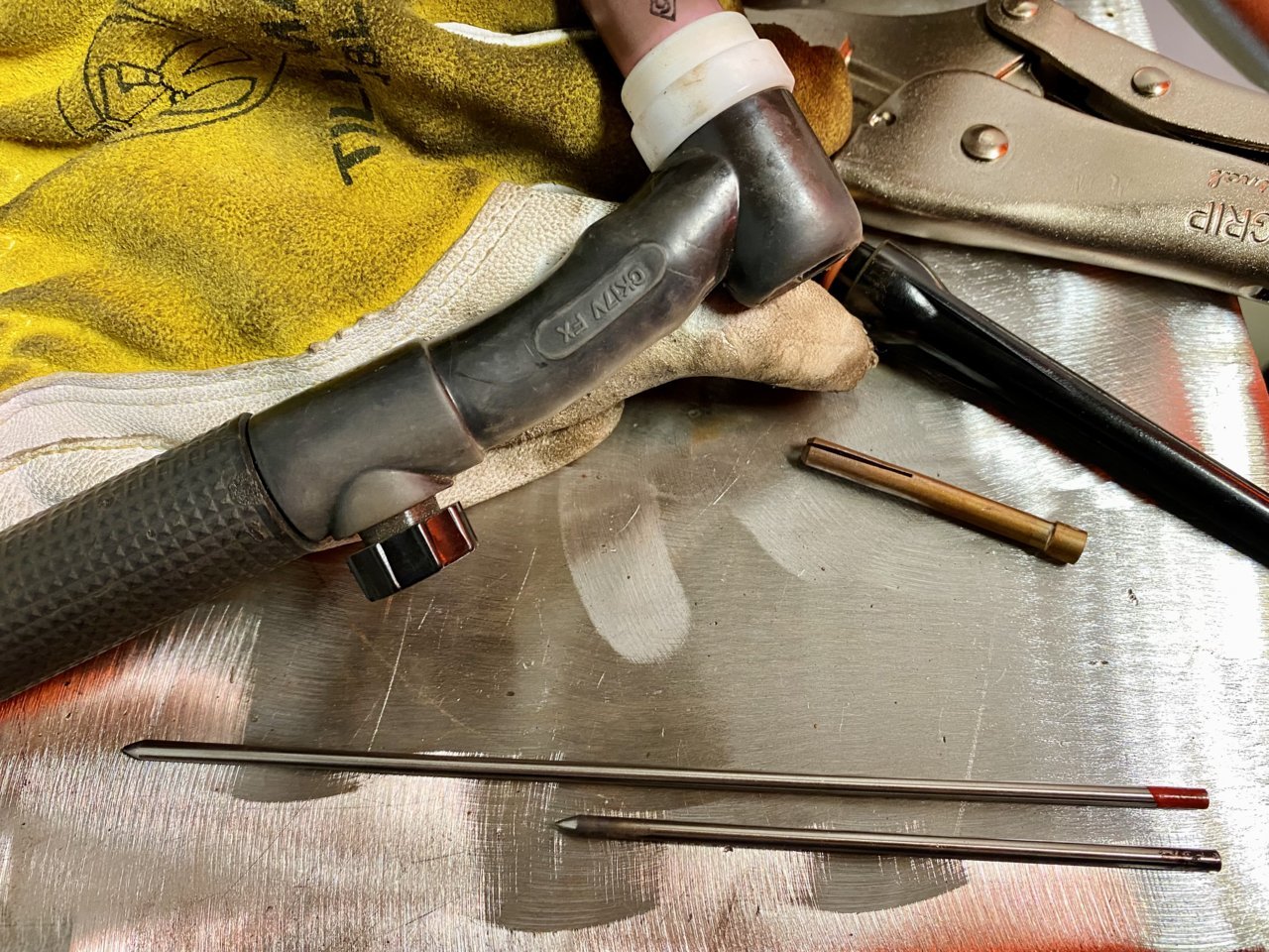

    I should keep track of how long have been using my tungsten before I bust out a new pack. The frugal in me hates to not use them until they’re too short to stay in place…
    Also the welding above. Goals!
