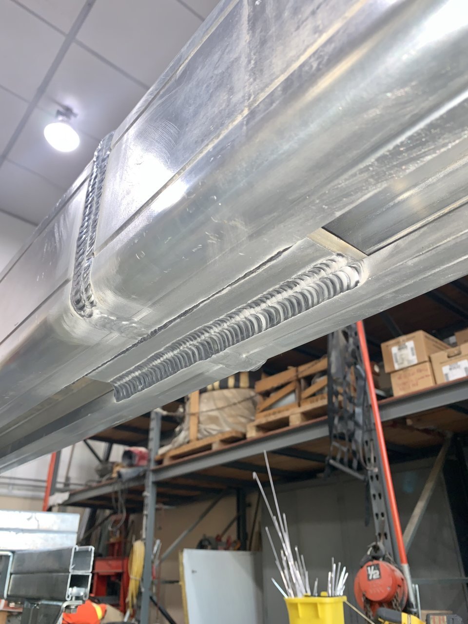

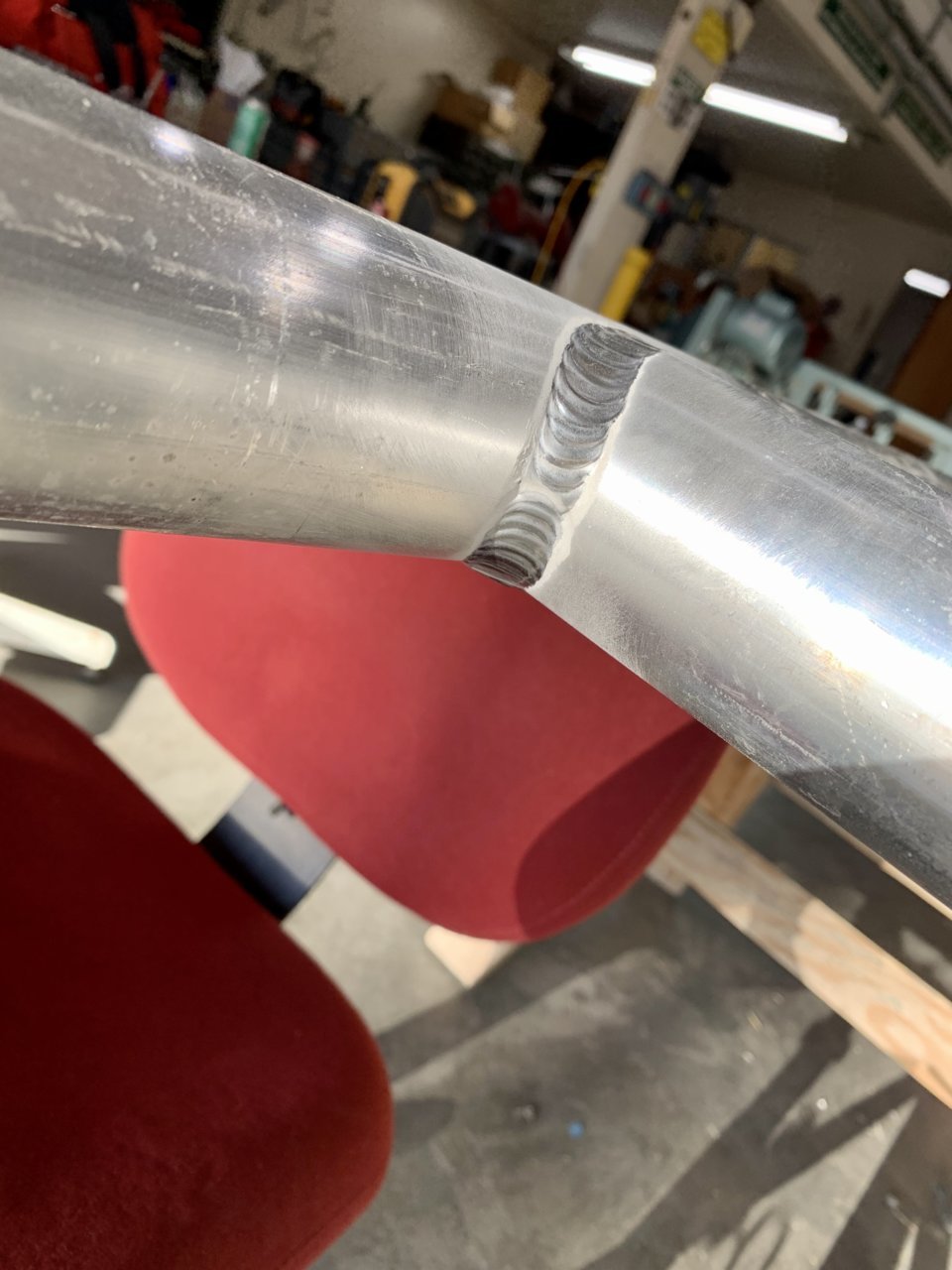

    I’ve been running a pair of 280dx’s at work for the past year or so. I’ve been running them wide open at 280a AC. The welder is undersized for our application, welding 1/2” to 5/8” 6061 extrusions. They are electrical bus energized to 13,800 volts and capable of 5500 amps of continuos current so each joint consists of a bunch of stringers totaling about 96’ of 4043 1/8” filler rod. One welder has been my main machine and hasn’t had a hiccup. The other welder took a shit on me after 2 hours of arc time, Miller repaired it under warranty and it’s been good since. I don’t think the failure was miller’s fault, the welder had been thrown in a bin (strapped down) and driven down 4 miles of bumpy dirt road at 40mph daily for over a year(not by myself). I know the drive was hard on equipment as it also caused a brand new aluma-reel setup to snap two reels off and fail.
    If I could afford it, I’d trade my 200dx for a 280 without hesitation. The failure at my work prompted the bosses to take the advice I’ve given from the start and buy a 400dx. Hopefully it will be here next week.

    Those are great welds for sure.
    Having said that, anything at a higher voltage, typically has a lower amperage, meaning those welds really don't have to be great.
    Having worked in substations for a large portion of my life, I would say that those welds are among the better ones that I've seen. Again, most utilities don't really care too much about quality from what I've seen (at least as far as welds are concerned).
    In my experience, they only care if "it works"...

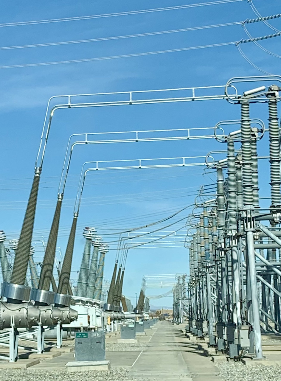

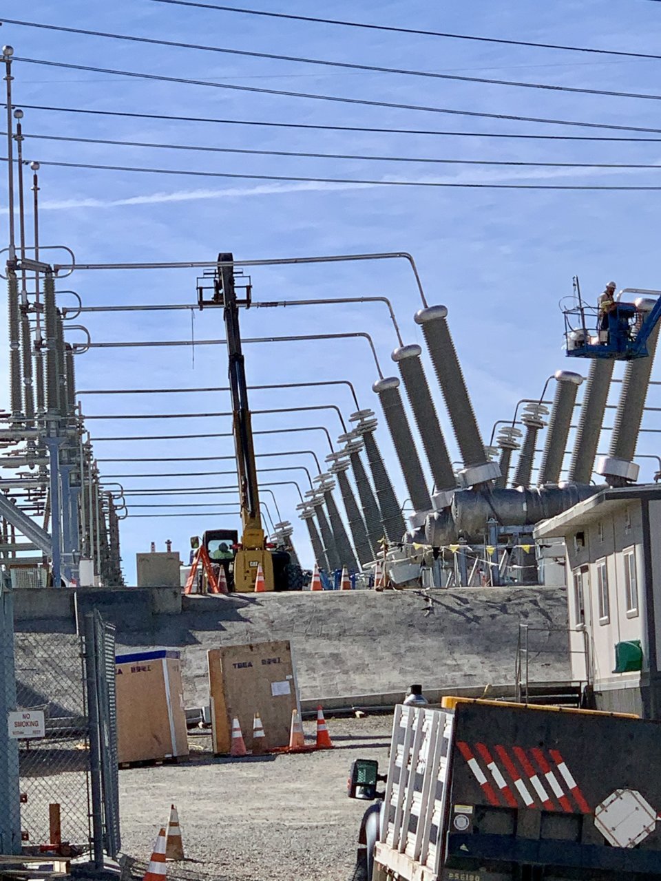

    Welding is a dying trade in the substation construction industry, especially with companies like dmc power making crimp on connectors for just about everything. It’s very common in the powerhouse buisness that the welder is just a wireman who learned welding on the job, especially with the contractors. I’m lucky to work for a municipality that puts quality far above production.
    This stuff really isn’t important from a structural standpoint, the bus I normally build is 2”ips ladder bus for 230 and 500kv breaker positions, it’s ampacify requirements are only 1500 amps per phase or so. That is a little more structural, and while working at one of our Vegas locations we found some bus contractors had done that failed and was just connected by gravity.
