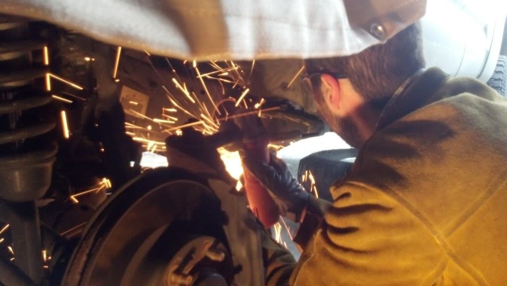

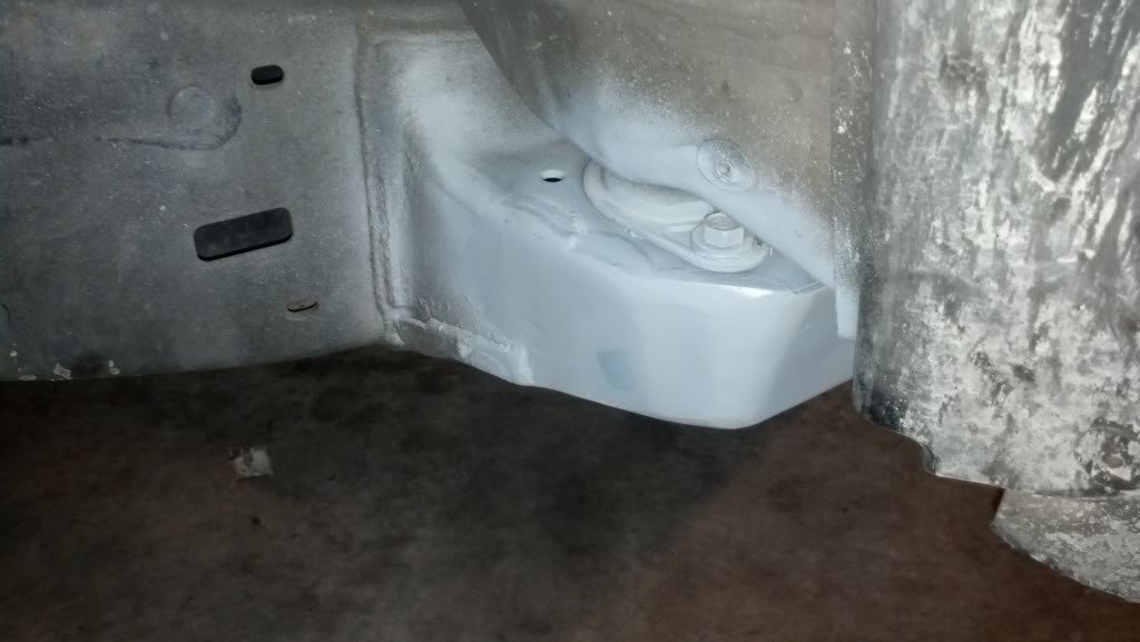

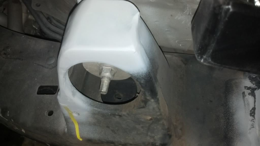

    Cab Mount Chop and Slider mount yesterday..
    Some parking lot bollards today..
    The perfect mix of residual cutting fluid/acetone/oxygen ignited halfway through one of the beads on a cap piece; blew my helmet off. Not fun..
