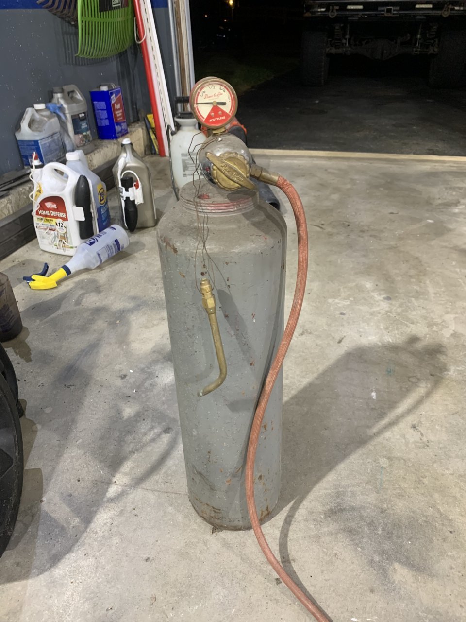

    Anyone ever trade an acetylene bottle for argon?
    Bivouac likes this.

    Depending on your distributor I have traded all kinds of cylinders for different ones.Customer owned cylinders !!
    My distributor will take any cylinders and also out right sell any size last I dealt with them
    It comes down to they buy your cylinder and you buy the cylinder you want that is how I have always done things.

    i'll def give it a shot!

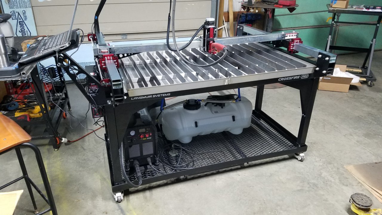

    I am getting close to being operational. I can drive the torch around the table with no problems.
    Still need to install my automatic torch height control electronics, and decide how to connect my plasma cutter to the ECU driving the steppers. Plasma unit has a CNC port, but the maker of the stepper driver ECU says my model, along with quite a few others, has reported some board failures if connected through the factory CNC port on the cutter. They recommend direct connect to internal points for the trigger control. That would likely void my plasma warranty, so I still need to talk to Primeweld and get direction.
    My base worked out well. Still rolling easily with the full setup and most of the water in the tank. I am going to add an outlet box for powering the ECU and my laptop. Might also throw some LEDs here and there for Winter when all the garage doors are closed.
    Also, I have some PICO Quench G water treatment ordered to prevent rust and algae. I bought a Rural King 15 gallon sprayer unit for fluid storage. Hooked up to the drains with PEX and used some braided flex hoses so it's easy to remove the tank lid. Each drain line has an in-line shutoff.
    Everybody in my family is getting a sign for Christmas. Eliminating 100% of that shopping will be worth the price of the unit!

    I still haven't hooked up my THC. I plan to do that when the weather turns.
    Your table looks awesome!
    Welcome to the club!

    Your ECU should have extra outputs for accessories. You will need a relay to fire the plasma torch. I found the 2 wires that activate the torch. I tied in my relay there at the plasma cutter board. This way I can still remove my torch from the CNC table and still use it as a hand cutter. I hope that makes sense.
