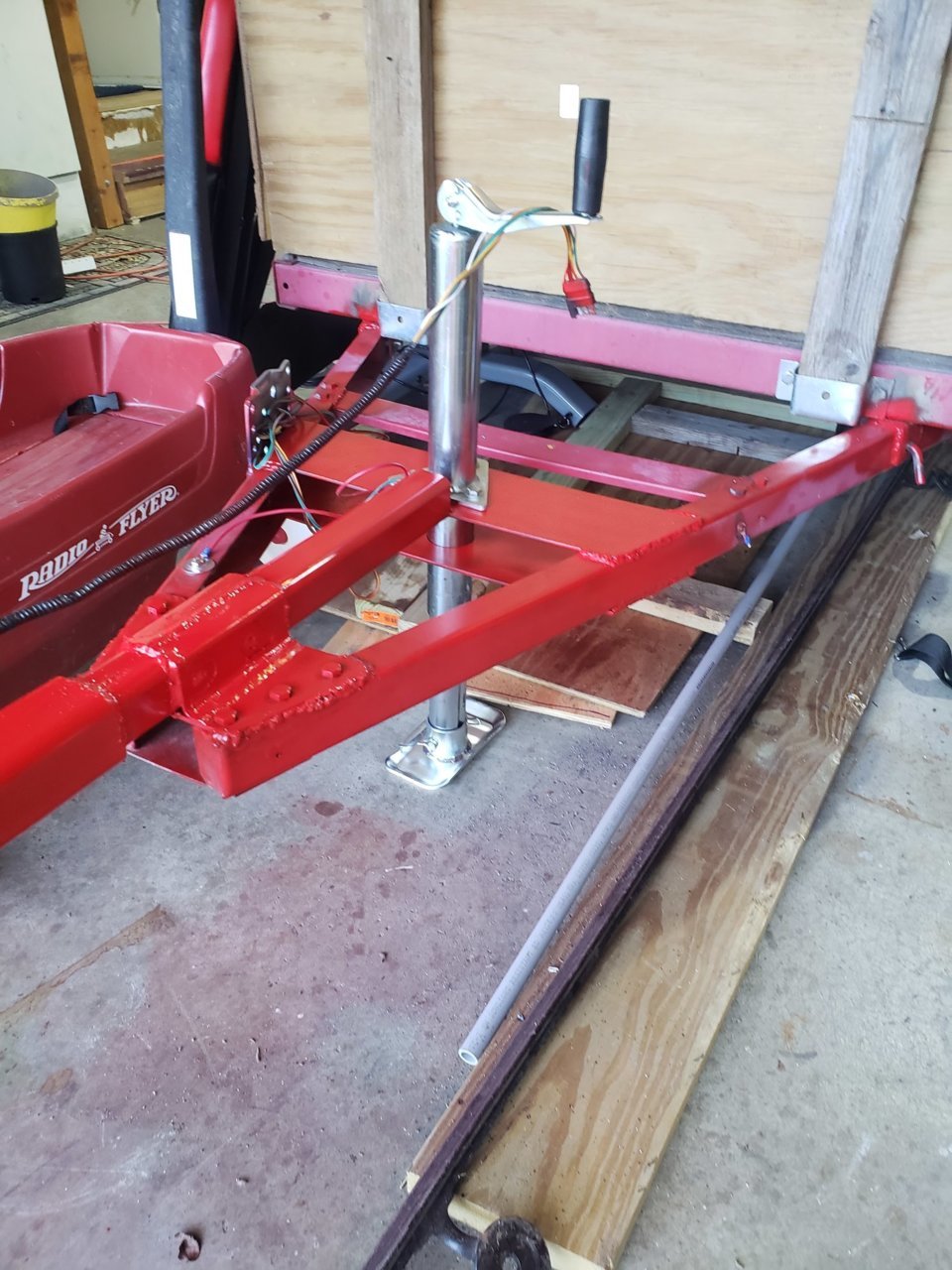

    Well it tracked straight so thats a win. New curt coupler is a huge improvement to the one that came with it. Before i had to pry the damn thing loose off the ball even when new.
    Also got the first hole widened so the jack will fit. Just need to drill the next one right under it. Then paint everything.

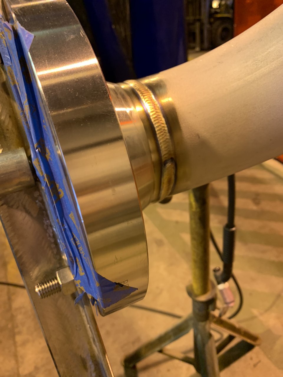

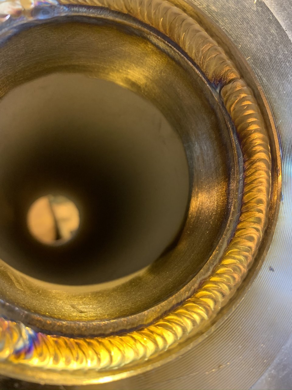

    Nice cup walking. I tried that on a narrowed 9" axle tube once, and failed horribly. LOL. Nice work Sir.

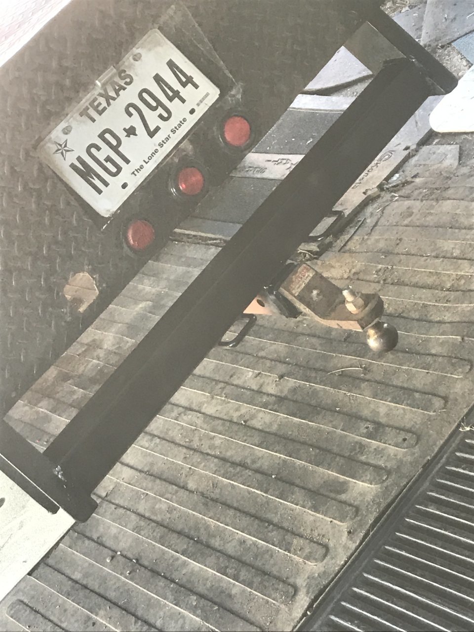

    3F924B5A-3158-4267-86CD-2DECBEE0042C.jpg By the time I had it done the old Systematics was dialed in pretty well and I remembered how to MIG weld decently. Ten times as strong as the farmer welded contraption he had on the truck.
    If he decides to keep the truck and gets a serious trailer we’ll be adding a couple of cross braces. Truck is set up for a gooseneck ball too for the real loads. Now he can haul the mower trailer and we won’t have to worry about the hitch ripping off the bed.
    ( Yes, the ball is upside down. He was getting ready to wrench it off and reposition it. )

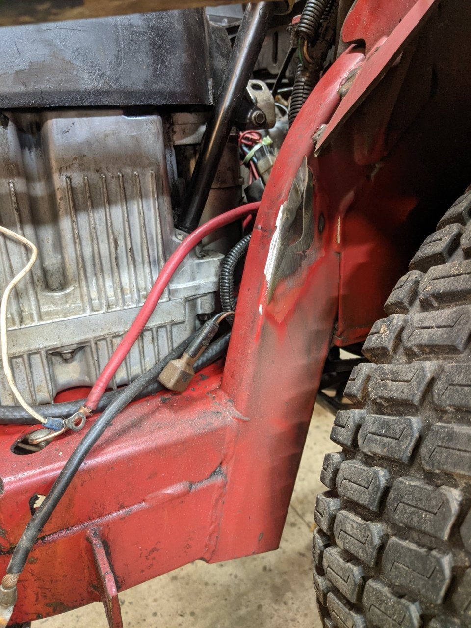

    New box needs to be mounted in this area. You can see where the original box broke off the frame.PXL_20211018_190324700.jpg

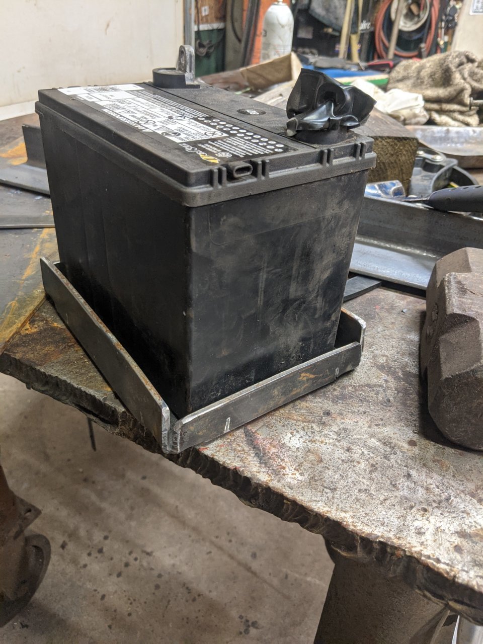

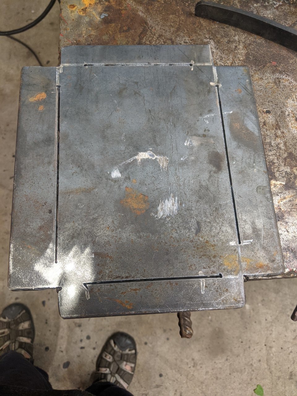

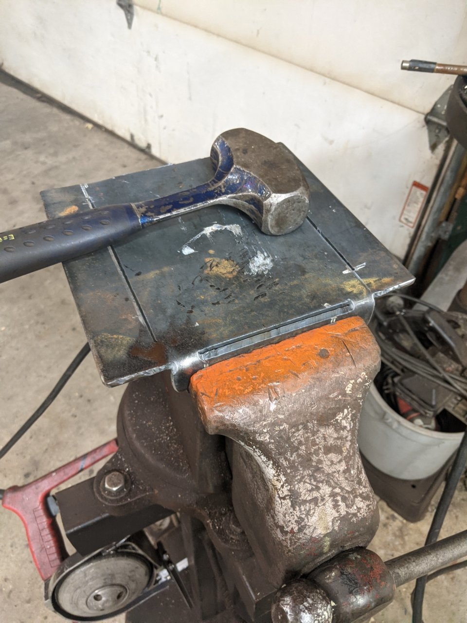

    I had some 3/16" plate lying around. Quickly cut it to rough shape with the plasma cutter.

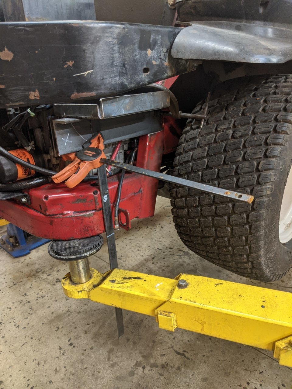

    Next I needed to fab up some brackets.PXL_20211018_193036750.jpg PXL_20211018_194439055.jpg

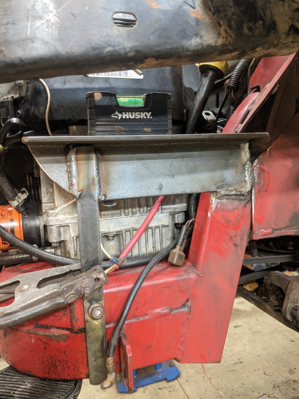

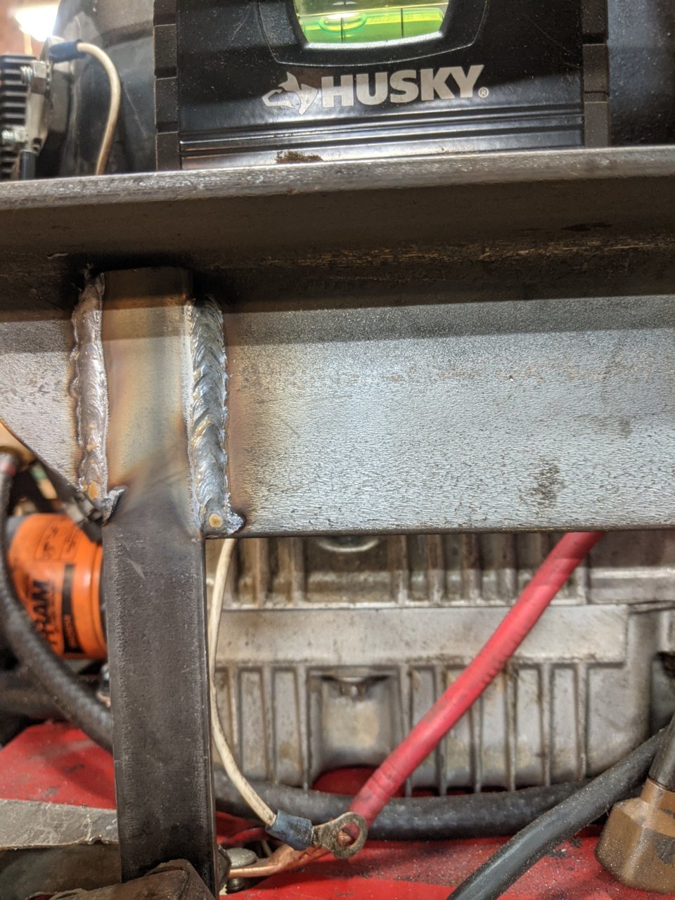

    Got the angle iron base welded up to the frame along with a rear support.PXL_20211018_201131041.jpg PXL_20211018_201126396.jpg

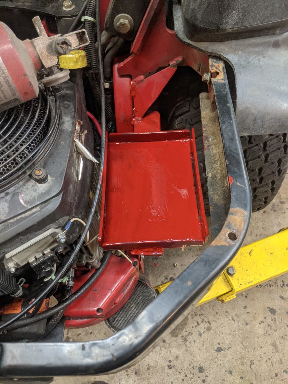

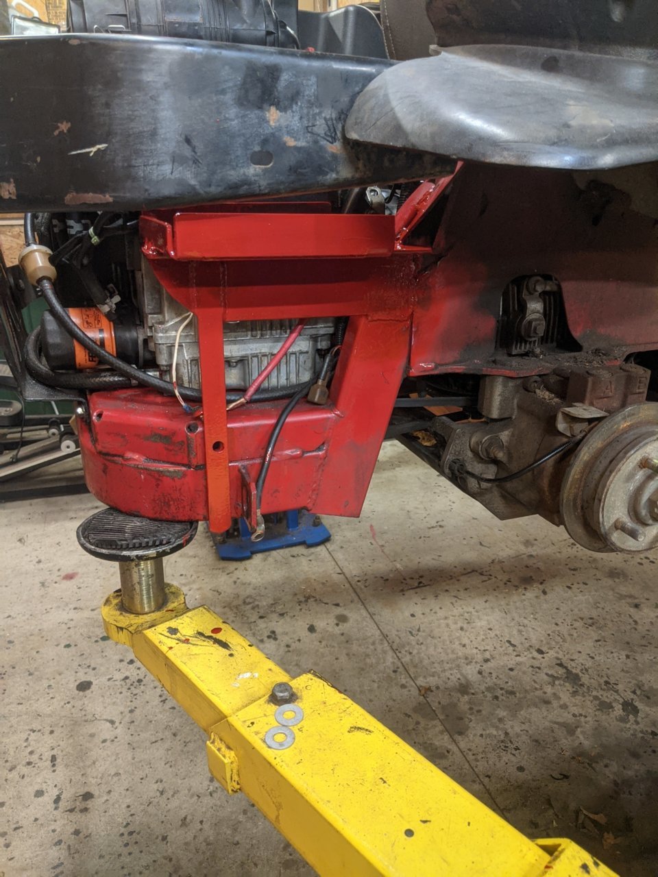

    Battery tray mounted to the base and all painted up.
    I'll drill the holes for the hold down clamp after it dries.PXL_20211018_204517279.jpg PXL_20211018_210115031.jpg

    Painted and a frame jack mounted. Pretty happy with the end result

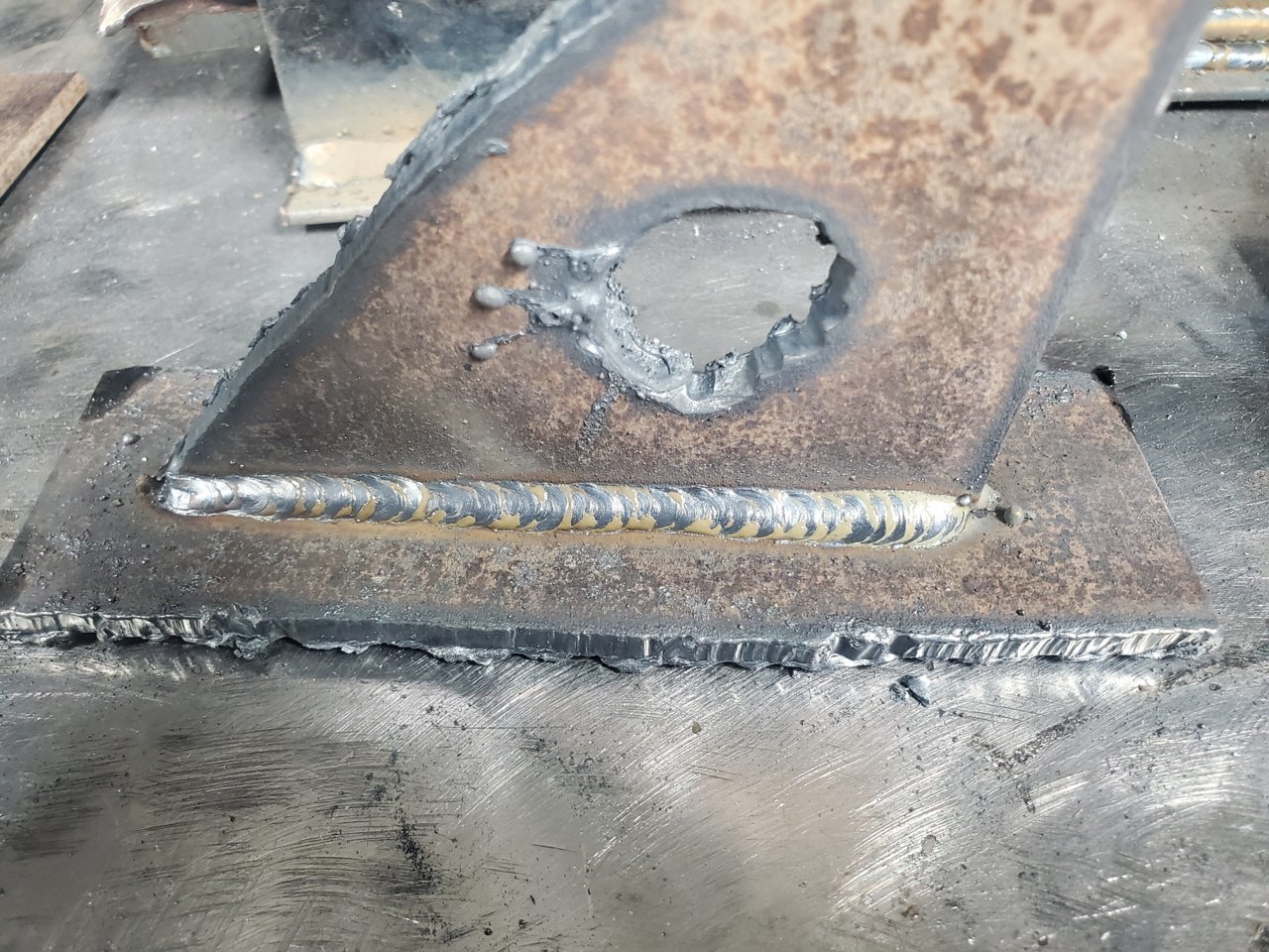

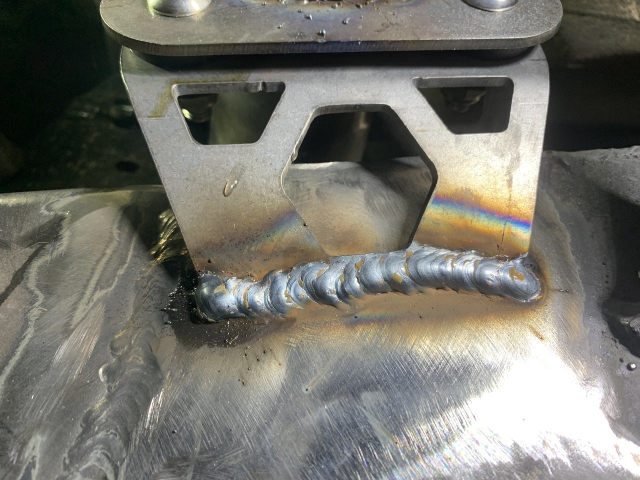

    Drop bracket lift and booger welds
    Haven’t burned some metal in a minute. Super rusty.
    But I’ll take it for lying on my back under the truck between the drive shaft and frame. I was more annoyed with the fact that I wasn’t close enough to see I was going off course.

    Not bad for breaking to of the most important rules for Welding Being able to see!! Being Comfortable!!

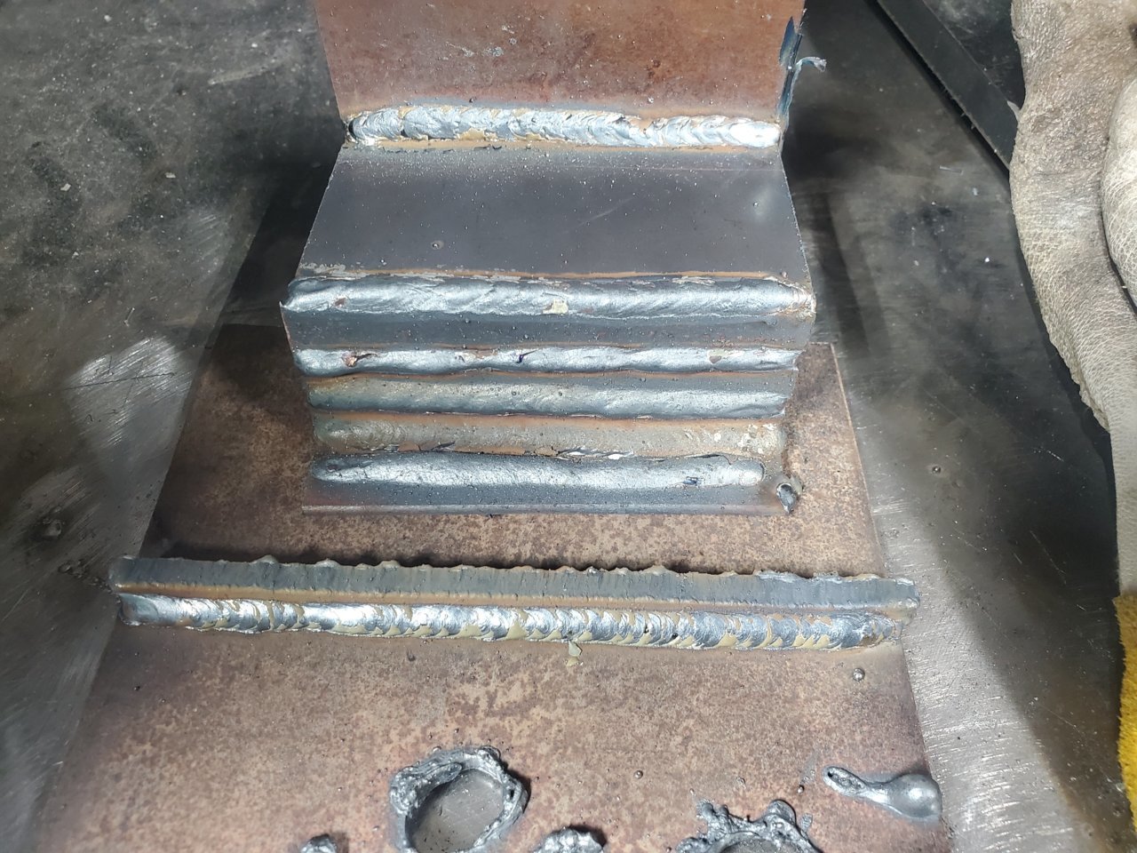

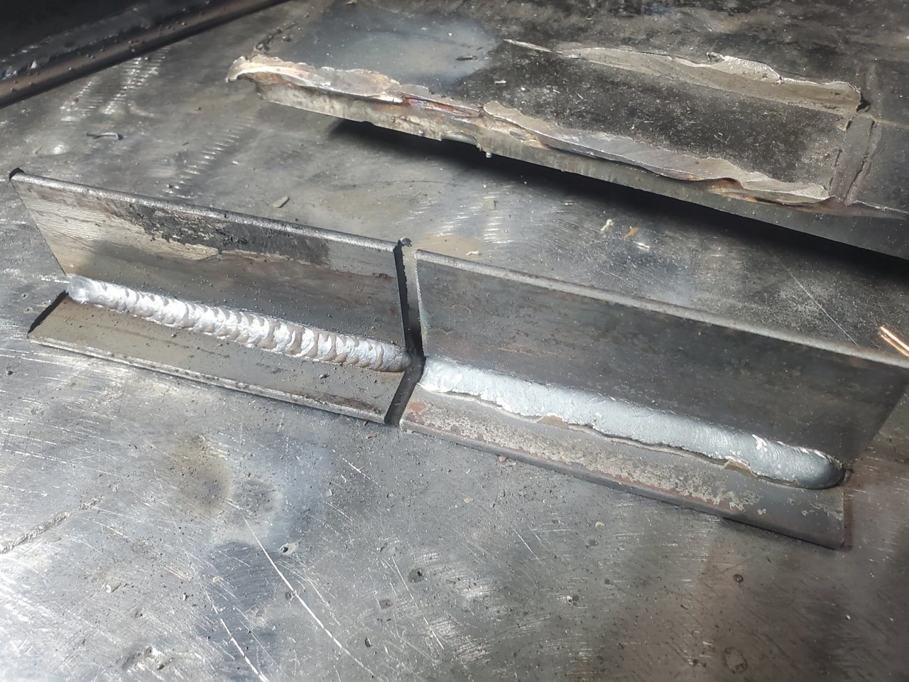

    First time laying beads and gluing stuff together!
    I put together 3 T's until I figured out movement speed, wire speed, voltage, etc -
    Was a little stoked about these since the first 2 T's were stringers -
