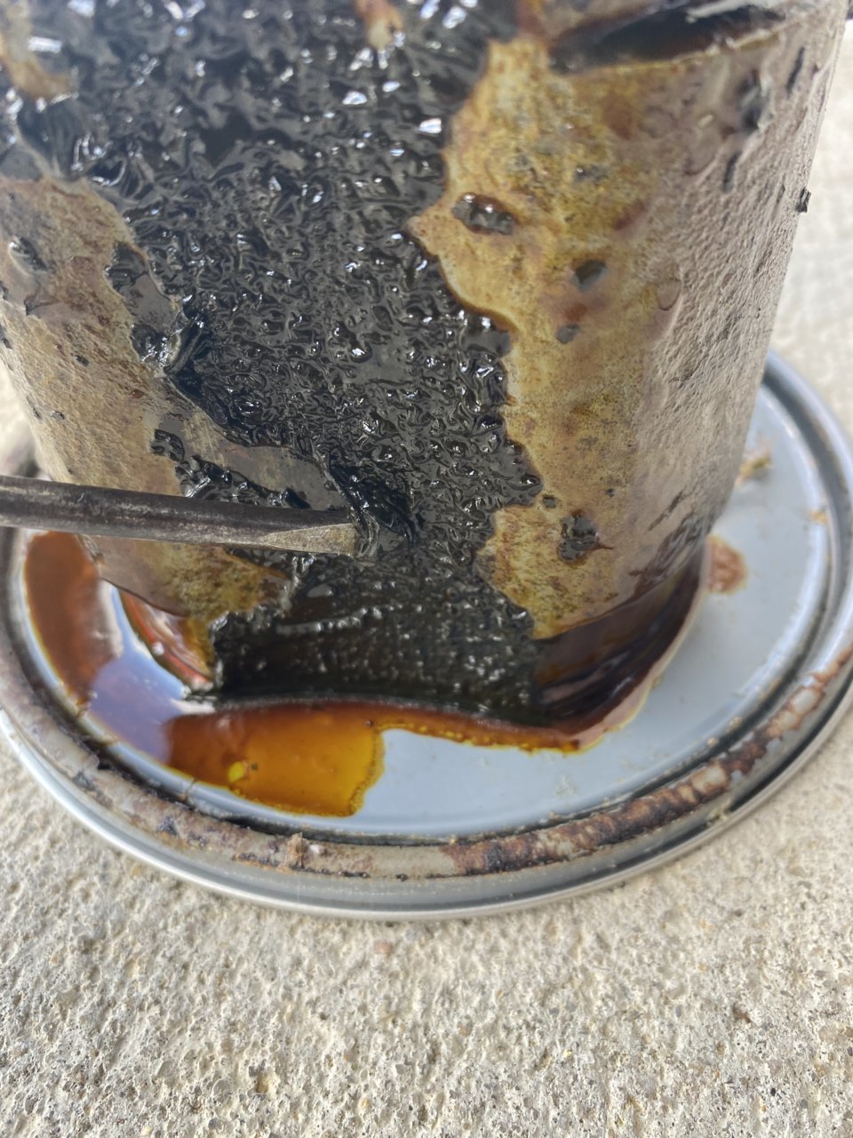

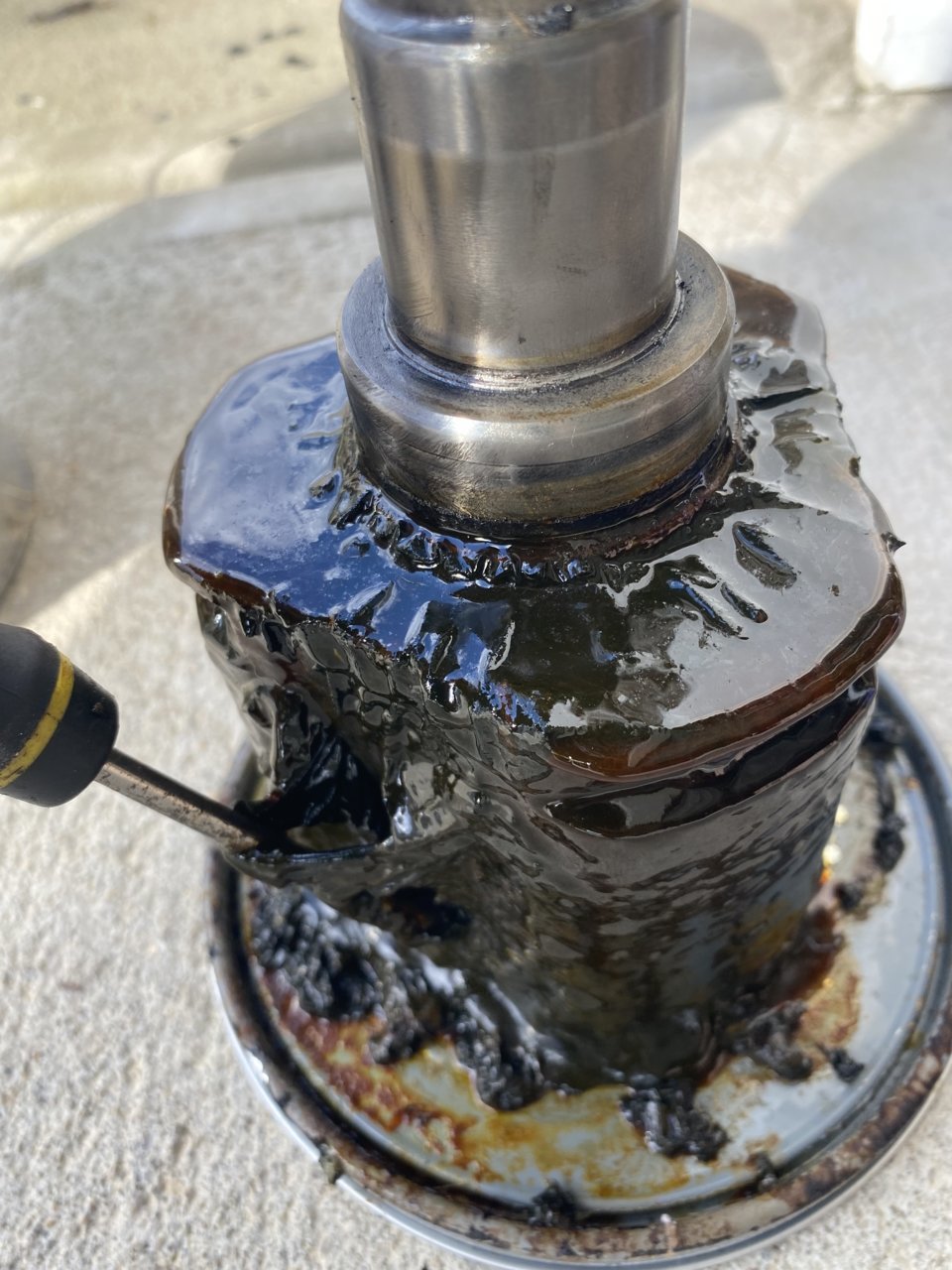

    I used to powder coat parts three garages ago, but for powder removal the best thing is Aircraft Remover. It is extremely caustic, yet water soluble. Just let it sit for about 10-15 minutes and the powder drops off like toxic ooze, just don't let it hit your skin. Use a tongs or S-hooks then water to rinse off the powder. I do this when rebuilding CVs on the cups. I don't have a strong enough bead blaster setup so it would take forever, the aircraft remover vat does the trick every time.
    Edit: Don't bother with latex gloves either, they will drip off your hands immediately. If you do get it on your skin, it won't tingle but just rinse off with plain water.

    Here some pics of using the Aircraft Paint Remover. I only do this for powder coat, but you can see it just bubbles up slides right off after about 10-15 minutes.

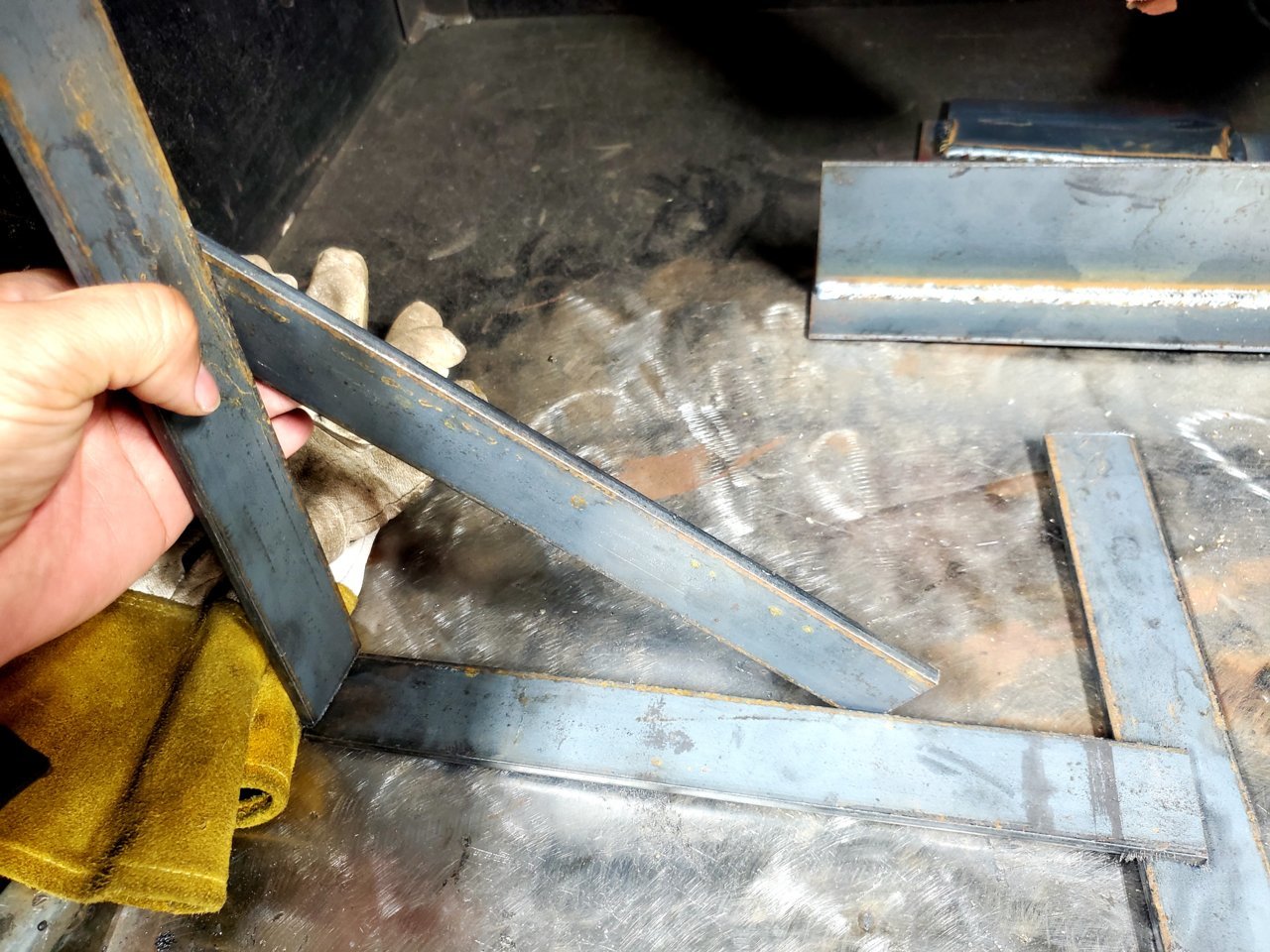

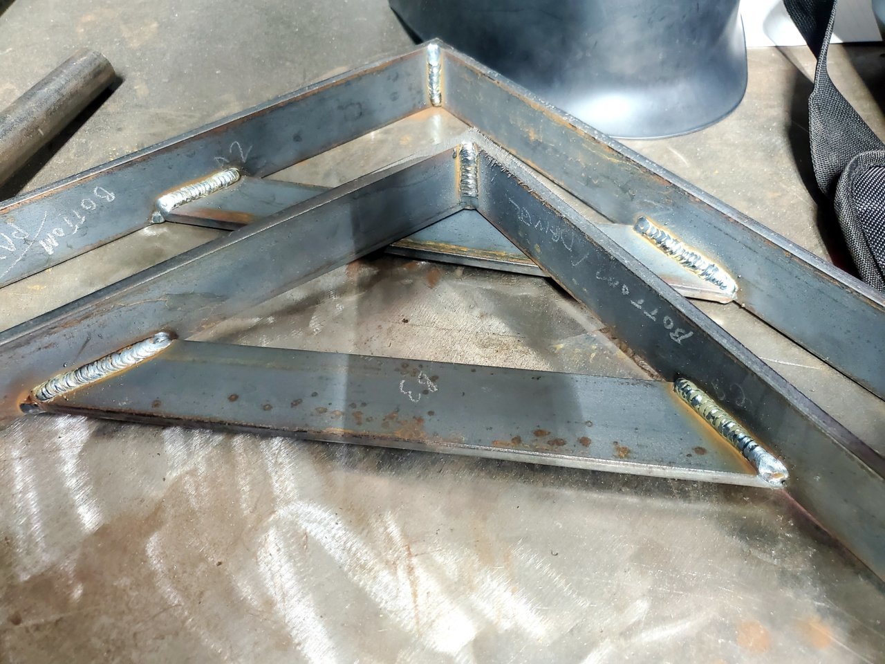

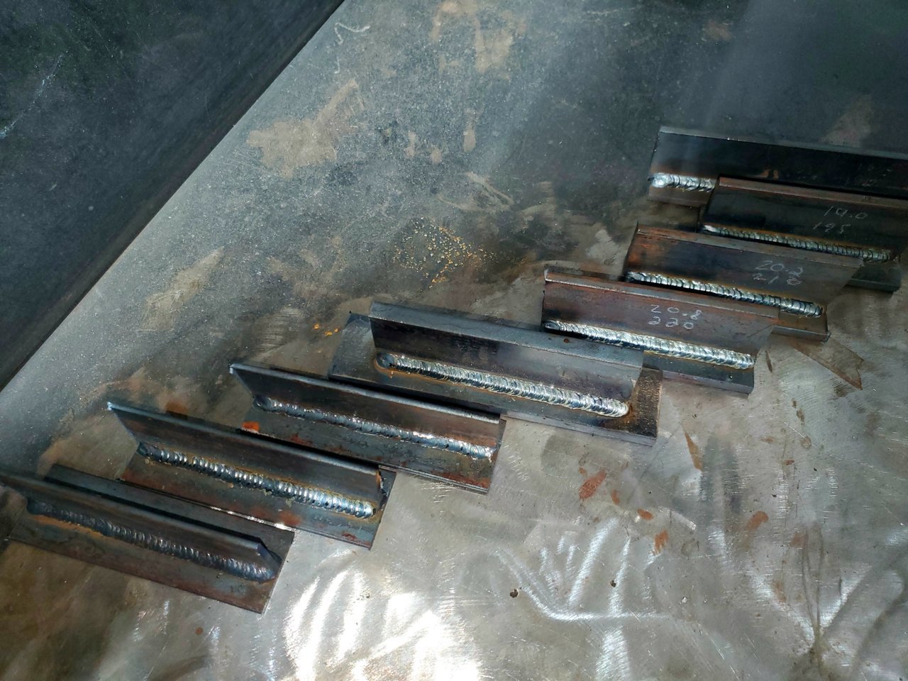

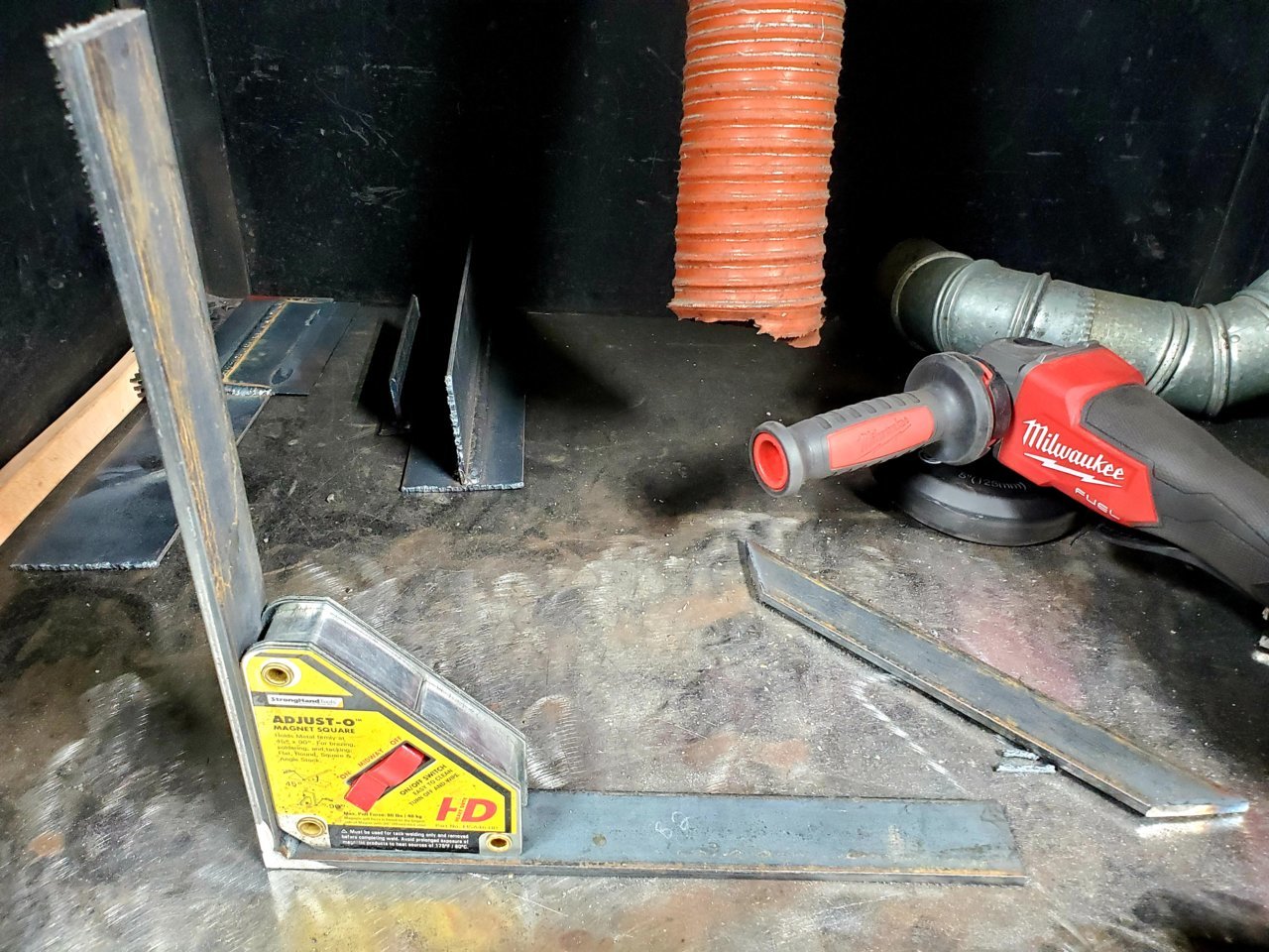

    I made some bed stiffeners, 4 days into learning how to MIG weld -
    Ran multiple T's on 1/8" up to 3/8" on my 5th day -
    I've got a thread tracking my progress, but since most of it was learning oxyfuel and such, I didn't start welding until a week ago.

    Just a hint always do any machine work before welding things to together.
    It is so much easier to fit things in the Drill press or Milling machine before then your to the point it won`t fit .
    So now your drilling many 1/2" holes through 3/8" material by hand

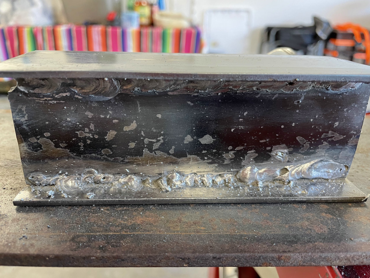

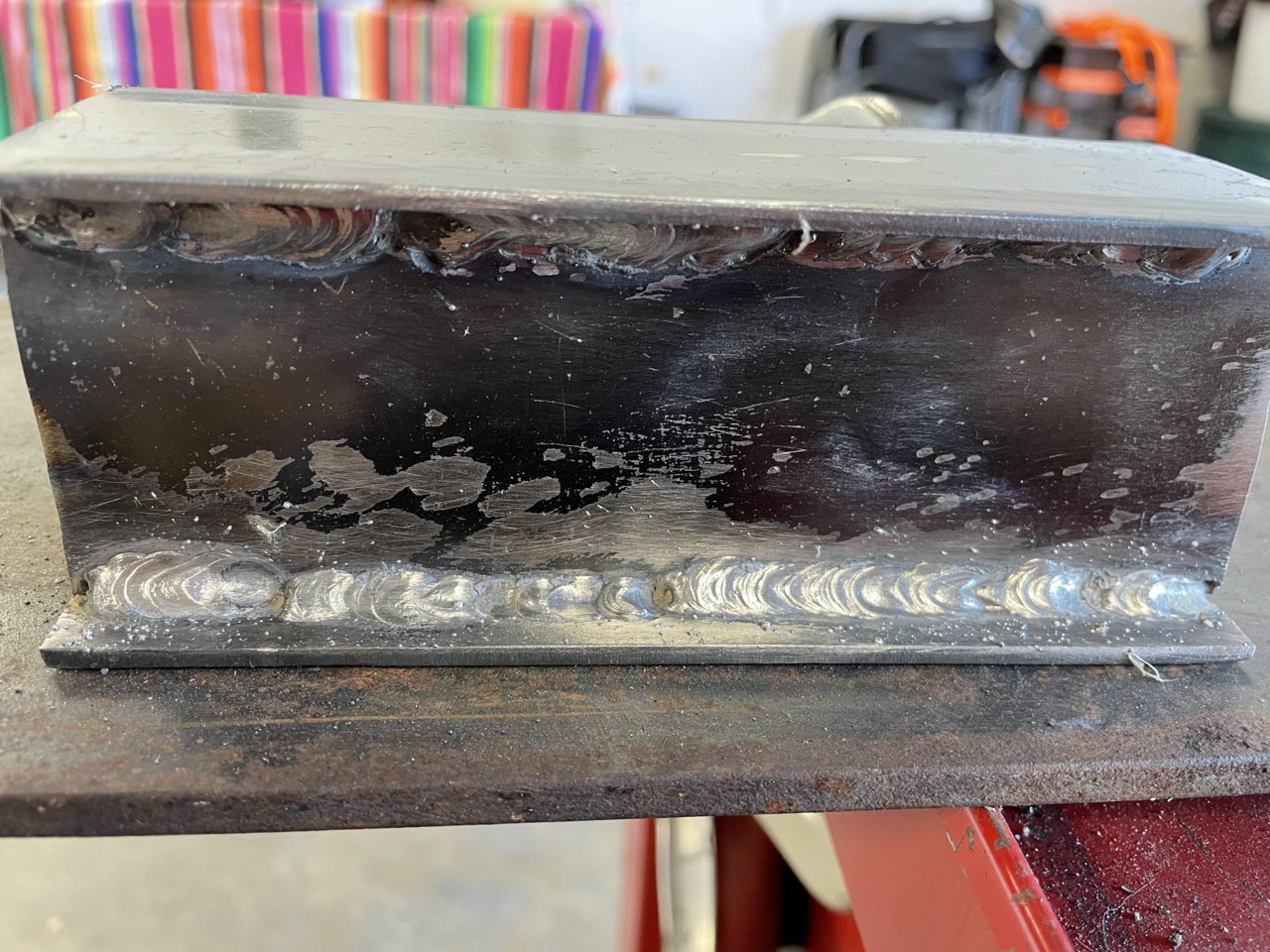

    Finally got a welder and put it to practice on some 1/8” with flux. I have welded for probably 3 hours total a few years ago and am REALLY looking forward to learning. Gas is coming this week so trying to improve bit by bit. This forum has been grate to peruse, learn and get inspired.
    1st attempt -- remember I have zero experience :)
    An hour later or so later ... improvement but A TON more to go. I'm going to go searching for plenty of scrap and continue the quest.

    Congratulations and welcome to the club. Were all just trying to get better, it's just some are further along than others. A lot of us are self taught before Youtube and other great resources. I have laid down welds that were way behind where you are already.
    Looks like 1st piece of advice is to try to maintain a constant speed of movement. Looks like you are varying your speed. Practice without pulling the trigger. Even guys like Jody on https://www.weldingtipsandtricks.com/ do dry runs to get speed/motion muscle memory kicked in before pulling the trigger.
