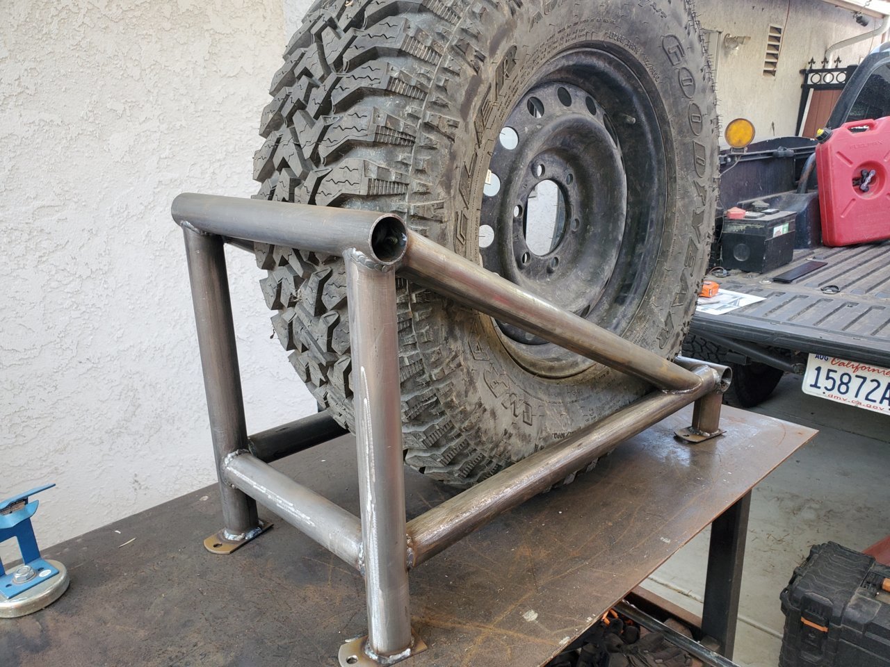

    Does anyone here notch tube with a plasma cutter?

    I have before, but I wouldn't recommend it for a cage build or any large project.

    I'll keep using a grinder I guess.

    It just didn't seem very efficient, not that was unsafe or anything like that. You could definitely make some large cuts first and then fine tune with the grinder.

    I notch a lot for my projects, I use round tube 90% of the time. I need a faster way to do it. Yeah I always use grinder to fine/fit finish

    Do you have a tube notcher? If so, why not use that? If not, why not just get one if you could use one so frequently? I was slow to get one and once I did, I wondered why I waited so long. Makes life a whole lot easier.

    I do have one. However I only do 90° notches with it.. Other angles are usually odd cuts/fits. Example: one tube end fitting into a perpendicular joint.

    The cut won't weld very good. You will end up with lots of porosity. You have to grind the cut before it will weld decent. Might as well keep using the grinder to do the notching.

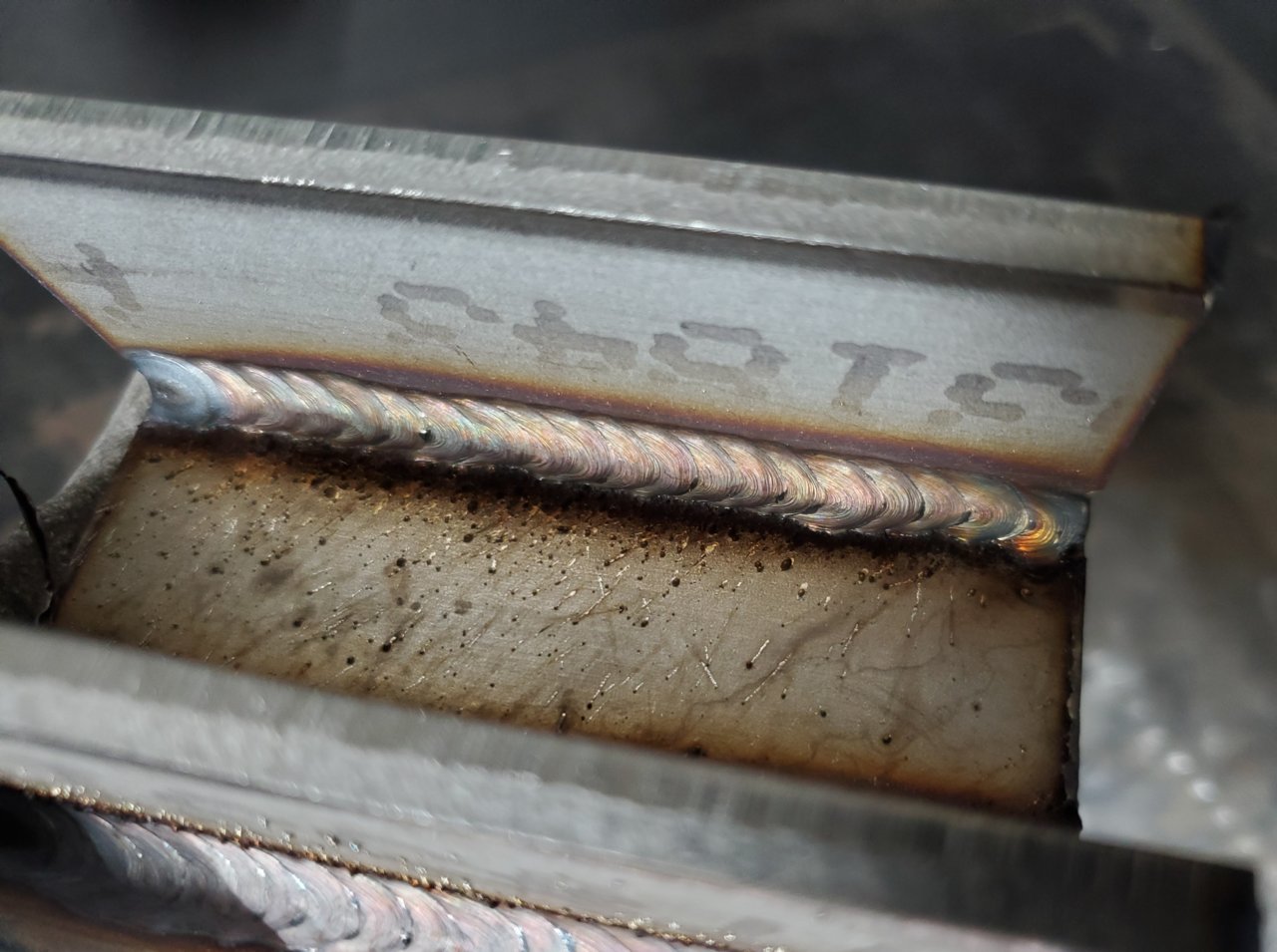

    First time running stainless steel; kind of figure out real quick that your travel speed needs changing after doing non-stainless
    The many non-stainless T's I was doing just before
    Still learning! :anonymous:
    Rakso, GHOST SHIP, Bivouac and 2 others like this.

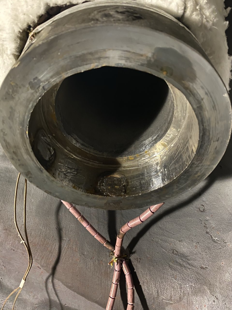

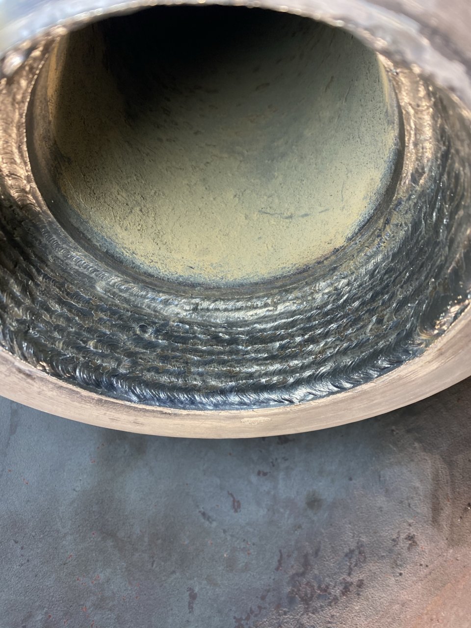

    Some bell seal repair in the case. Start with grinding out old threads, welding in material and then machining in new threads and sealing surfaces (I was already gone before they finished.)
    9018 1/8” 130a
