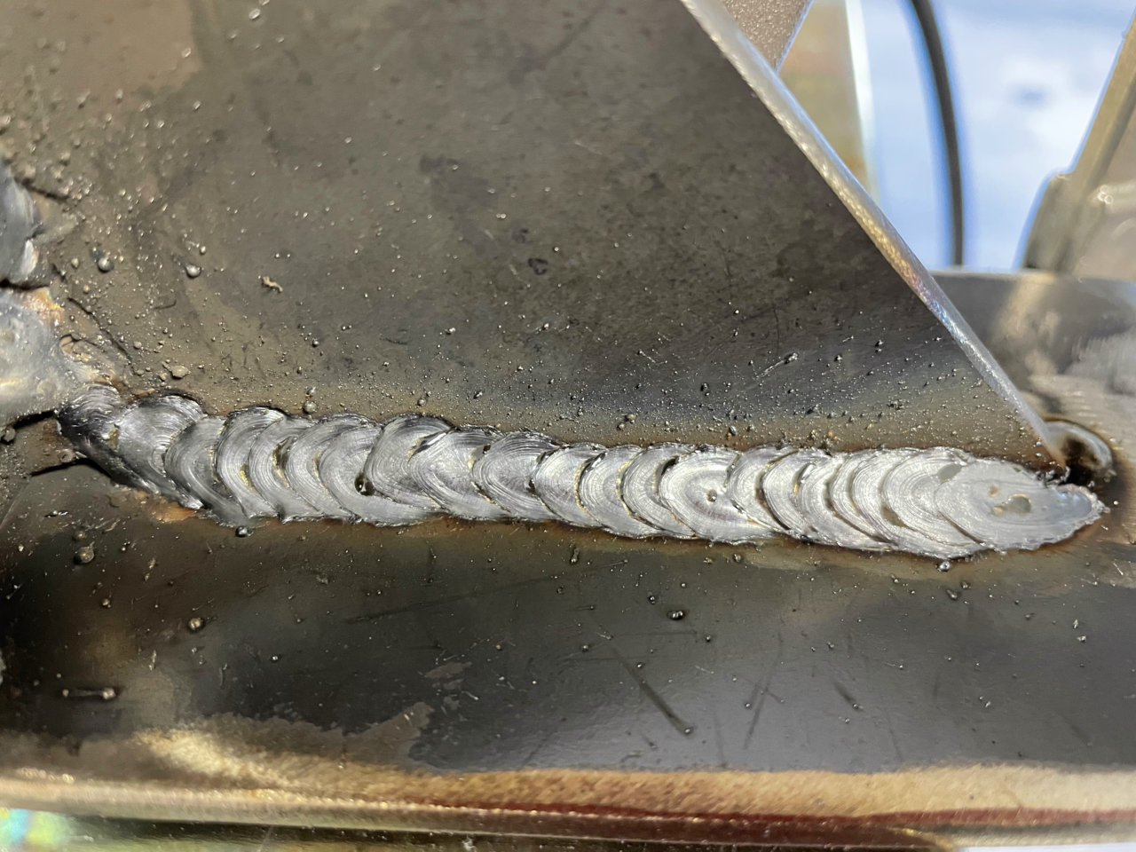

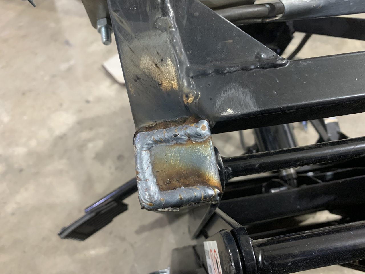

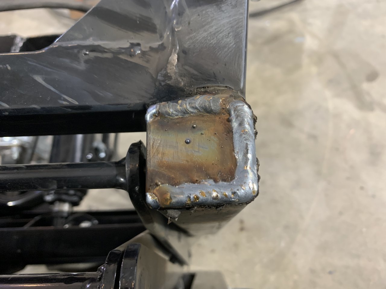

    Practicing. Maybe day 4 (~5-6 hours) behind the mask. I have a coastal off-road front bumper on order that I'll fit together when I get the nerve and many more hours of seat time — I’d love to hear any tips. I'm left handed and have found the easiest flow/direction is running horizontal right to left. 75/25 with the settings matching the recommendations on the box.
    .. and I went with the Hobart - I wired the garage with 220 so good to go for the high voltage.

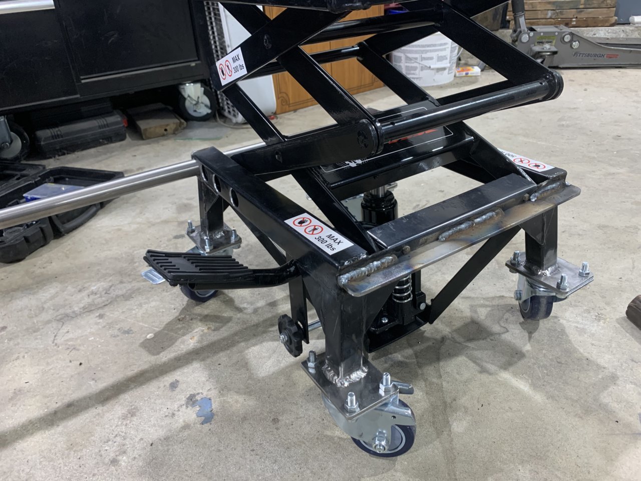

    Drop bracket lift and booger welds
    A working demo of why I made my changes:
    https://youtu.be/HsmBojOu_-w

    Have tried pushing the weld left to right?
    I push the weld 90percent if the time.

    You know I could not tell you which way I go then so much is out of position I think it comes down to in which direction I can see the best.
    Down or up vertical to me it depends on the thickness .
    dk crew change your settings feel what lower voltage and higher voltage feels like decrease wire speed you can only increase so far it bounces off the weldment turn the gas down see what lack of gas looks like to much gas can be just as bad as to little

    I can't comment on anything really other than maybe offer a little help.
    It looks like you're stitching (back and forth movement); I like to watch my wire/tip and ensure I keep it pointed at the joint as I drag back and forth. Being consistent in your movement and angle is key here.
    Watching your puddle will give you an indicator as to how far forward and back to move each time.
    I'm in school for welding so I'm learning just like you!

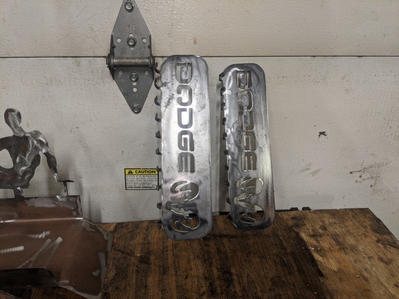

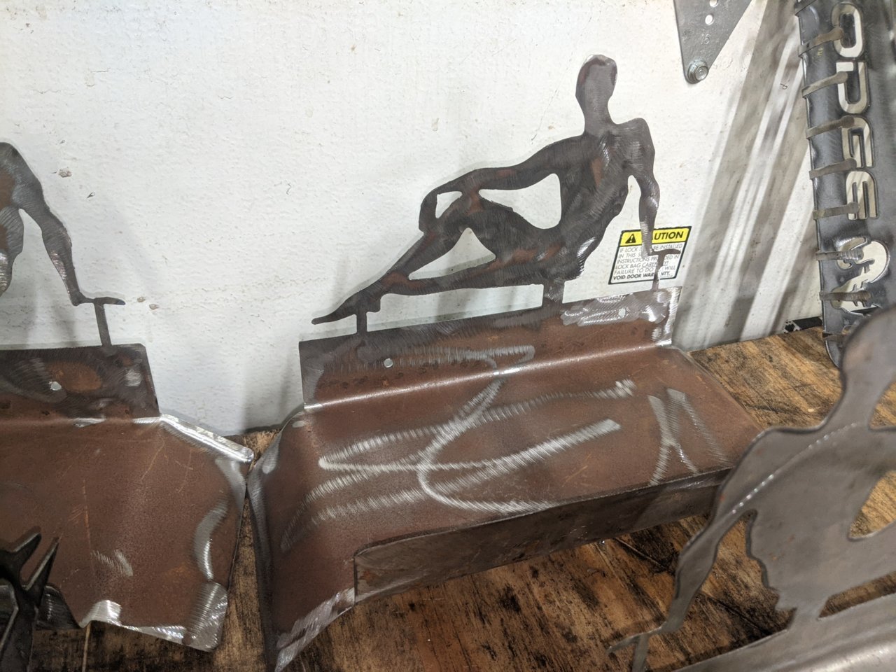

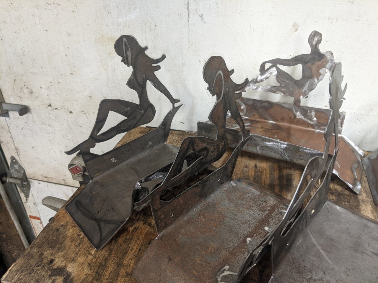

    I'm glad you are doing your own build. You learn more building it from the ground up yourself.
    I know I saved $500+ building it myself. I'm so glad I did.
    I just made a bunch of Xmas gifts for family members.
    The table hasn't made me much money, but I know it will soon.
    These are extension cord holders for the garage or the she sheds.

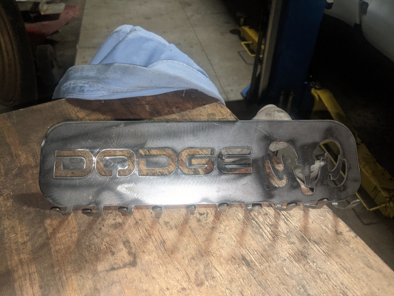

    Here is a better shot of the Dodge key holder I made for a family member. I'm still impressed at the accuracy the table and plasma cutter is capable of.
    I still have lots to learn, but am enjoying every minute of the learning curve.PXL_20211125_021842336.jpg
