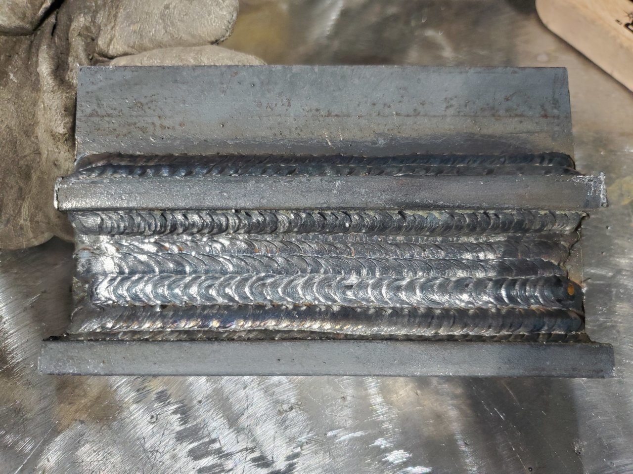

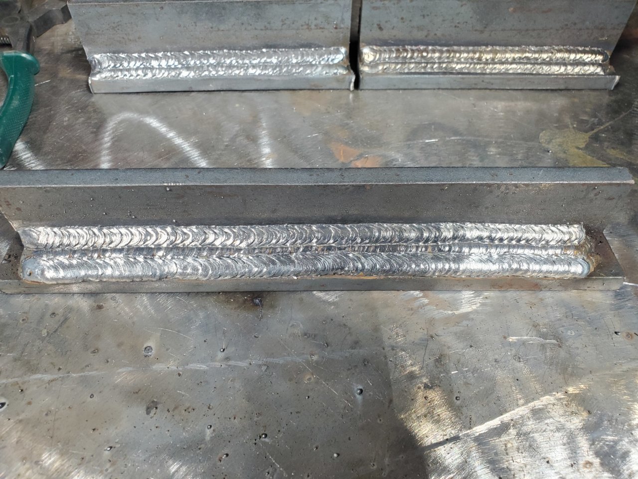

    I'm only 3 days into learning stick and man it's tough because we're doing 5G on pipe; 6010 root and 7018 hot/fill.
    Since it looks horrible, I'll post up my last MIG welds :rofl:

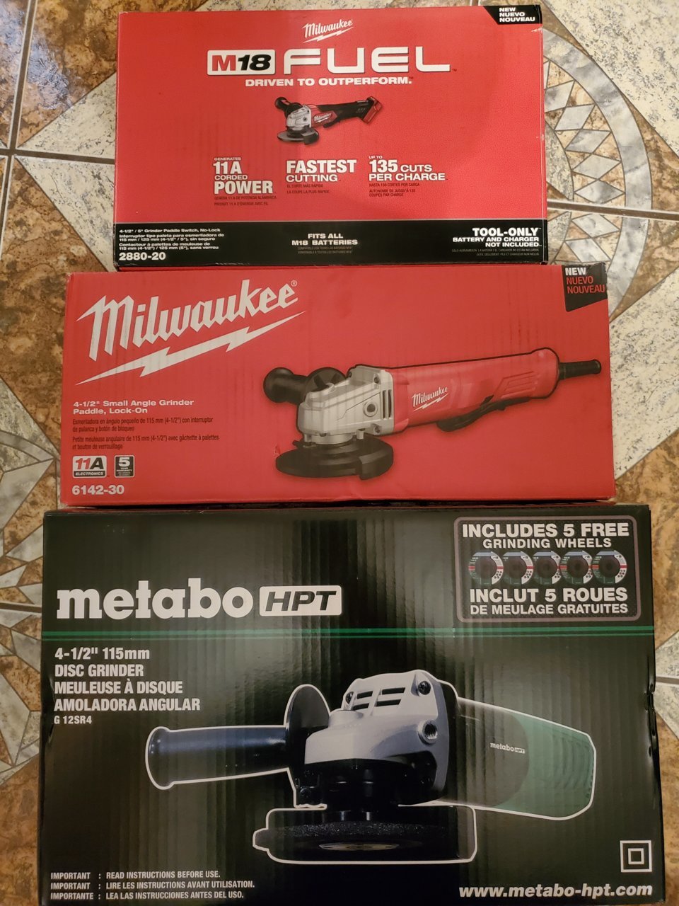

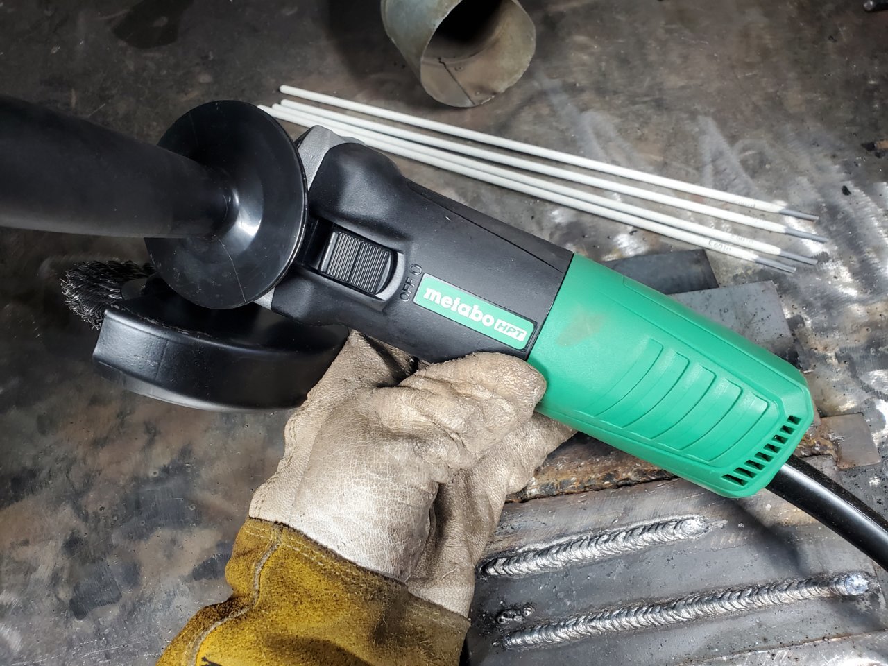

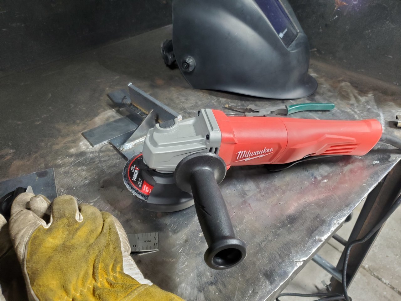

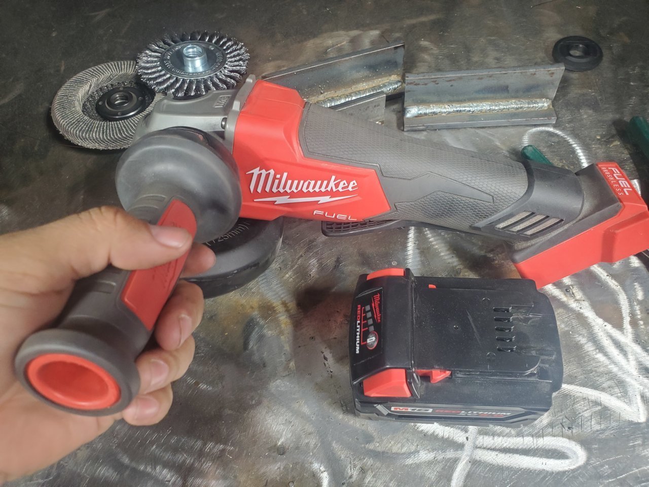

    I went through this myself just over the last 4 weeks; I'm in school for welding and rather than use the supplied grinders I bought my own.
    My Milwaukee Fuel M18 had a nice feel, but was a little heavier than I'd like.
    My real complaint came from the loudness of it, like a shriek almost as it would make my tinnitus want to act up even. It also felt really numbing after using it for a short bit so I really disliked it.
    Thinking a corded would work better, not to mention the simple fact that it'd be convenient to own multiple grinders, I bought a Milwaukee corded grinder.
    I didn't buy the cheap one either, as I'm a buy once cry once type of guy.
    The corded grinder was slightly quieter, and a tad less numbing, but not where I'd like it to be.
    I did forget to mention, I was comparing these 2 to an old, class-owned DeWalt XR that has seen better days. That thing is so smooth and quiet, you can easily grind away too much metal that's how smooth it was.
    Fast forward 3 weeks and I told my wife I'm just going to get a cheap Metabo HPT (Hitachi rebrand). Granted it's what...4A less than the other 2, it's so much quieter and smoother that I returned the 2 Milwaukees 2 days later.
    Think it's pretty awesome that my wife insisted on paying for it; was only $40 at Lowes with hard case and 5 grinding wheels.
