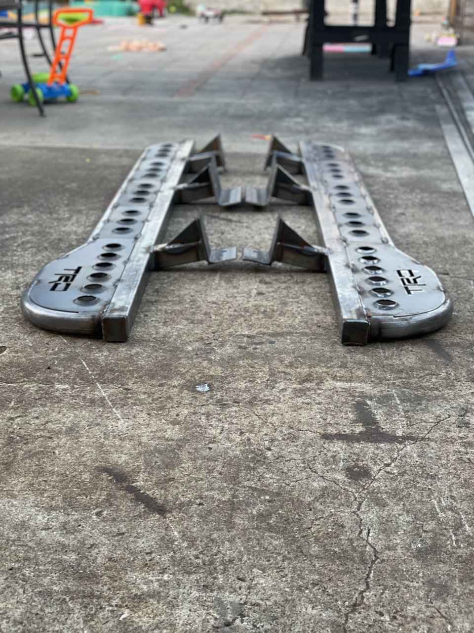

    I promise someday I’ll post a picture of something else besides boring sliders. But finished another set today :anonymous:

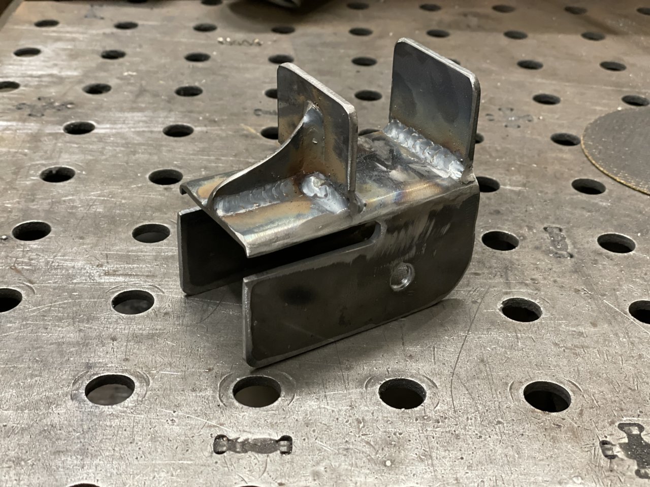

    Whipped up a Hi Lift rock slider adapter really quick for one of my TWSS gifts

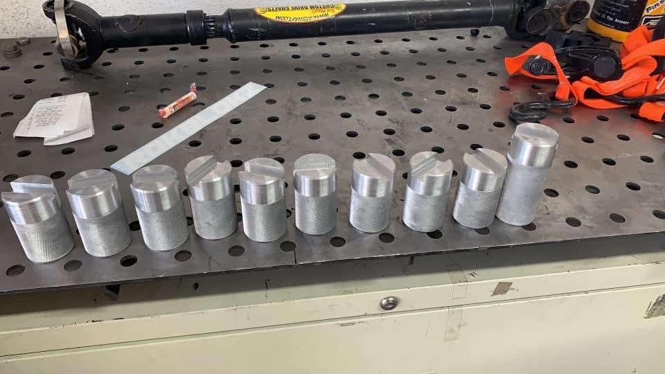

    Not exactly welding related but it is fabrication related.

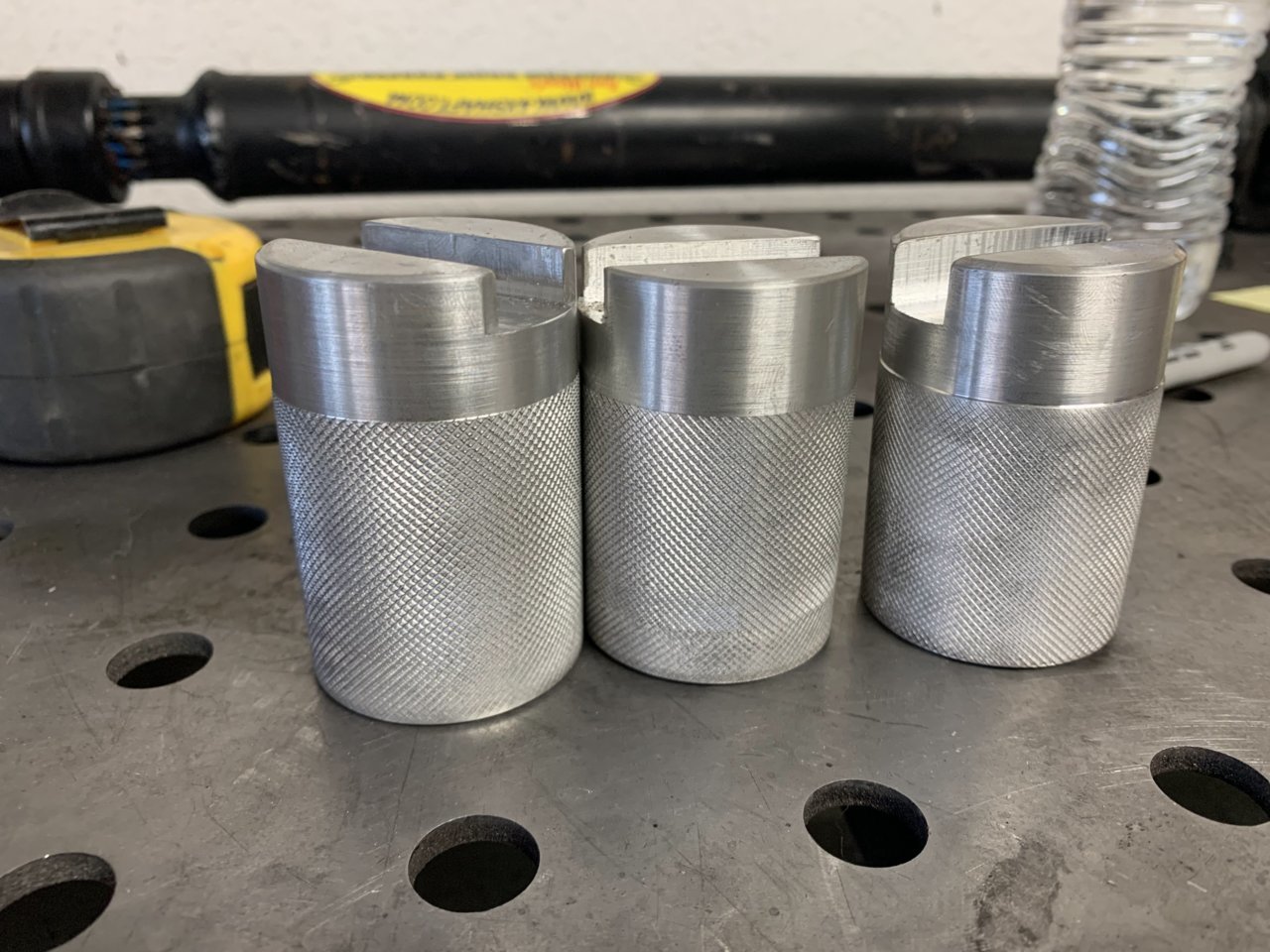

    my girlfriend says buying tools gives me joy and I’m good at spending money on old junk I don’t need so I’m making these “hub tools” to help pay for more tools and car parts lol. Something I made for myself but ended up getting a ton of interest from people asking me to make more.
    I know Toyotas don’t typically have hard to turn hubs but yukon hubs are notorious for being hard.
    They are made from 1 3/4 6061 Aluminum bar stock. They’re roughly 3 inches tall with 2 inches of knurling and a slot big enough to go into the locking hubs and turn.
    If anyone else runs hubs and they’re hard to turn and needs one let me know. Or if your Toyota hubs are hard to turn or get frozen in the winter etc, shoot me the measurements and I can make some for Toyota hubs.
    Otherwise just a cool project I’m having fun making and practicing on.

    That’s dope! Great idea. Did you just turn them on a lathe or something?

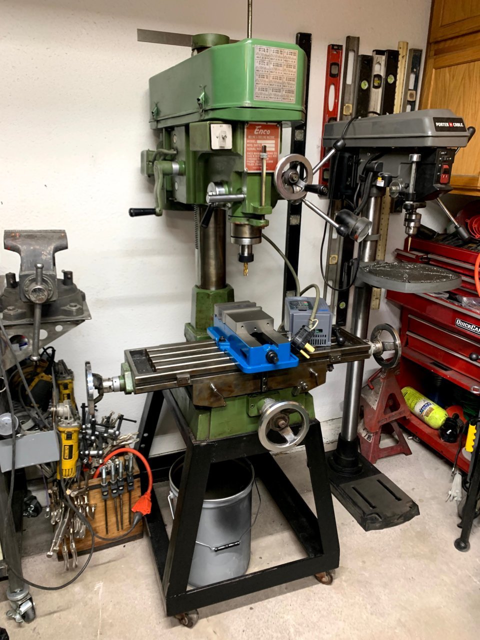

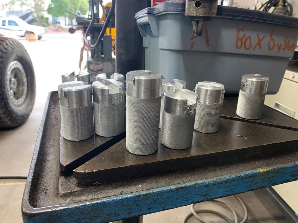

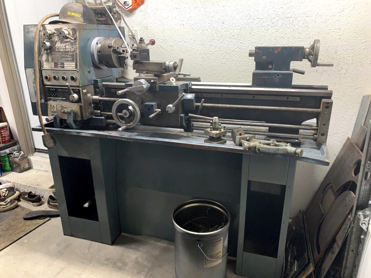

    Turned them on the lathe for a good finish. Added the knurling. Then went over to the mill and milled a slot for the locking hub.
    pictures of the lathe and mill
    129803E2-202B-4E87-9FF8-E63ACF960FC8.jpg 8A95055A-9824-47D4-9178-9DDC94747F85.jpg

    Badass man. I don’t have room for a lathe or mill but definitely want one of each.

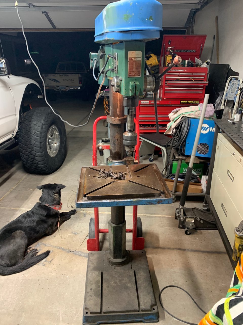

    I wouldn’t say I have “room” for them but I rearranged the garage a bunch and made them fit. I just picked up a marching drill press as well with no real place to put it lol. I need a bigger garage or a shop for that matter really

    After making a dxf file for them on the plasma table they only take around 20 mins to make from start to finish now. They’re pretty easy. Post pics when you make yourself one!
    hahaha! I just keep moving stuff in the background to make it look like it’s a different day/time lol
    Thanks man, I appreciate it. I realize it’s the same product over and over again but I’m still enjoying it the same because I’m just continuing to try to get quicker and better at the process and it’s a project that helps me hone my skills to get better at fabricating in general

    Is it 1/8" steel? I don't have access to a plasma table so I figure making it out of square tube would be a much easier jump off point.
    Shmellmopwho[QUOTED] likes this.
  17. Dec 3, 2021 at 8:48 AM
    Shmellmopwho
    Shmellmopwho Well-Known Member Vendor
    Apr 10, 2014
    #127399
    11,682
    Lomita CA
    2013 White DCLB TRD sport
    Bunch of stuff
    Yeah it’s 1/8” steel
    I used to make them just like that out of square tube. It’ll work just as well :thumbsup:
