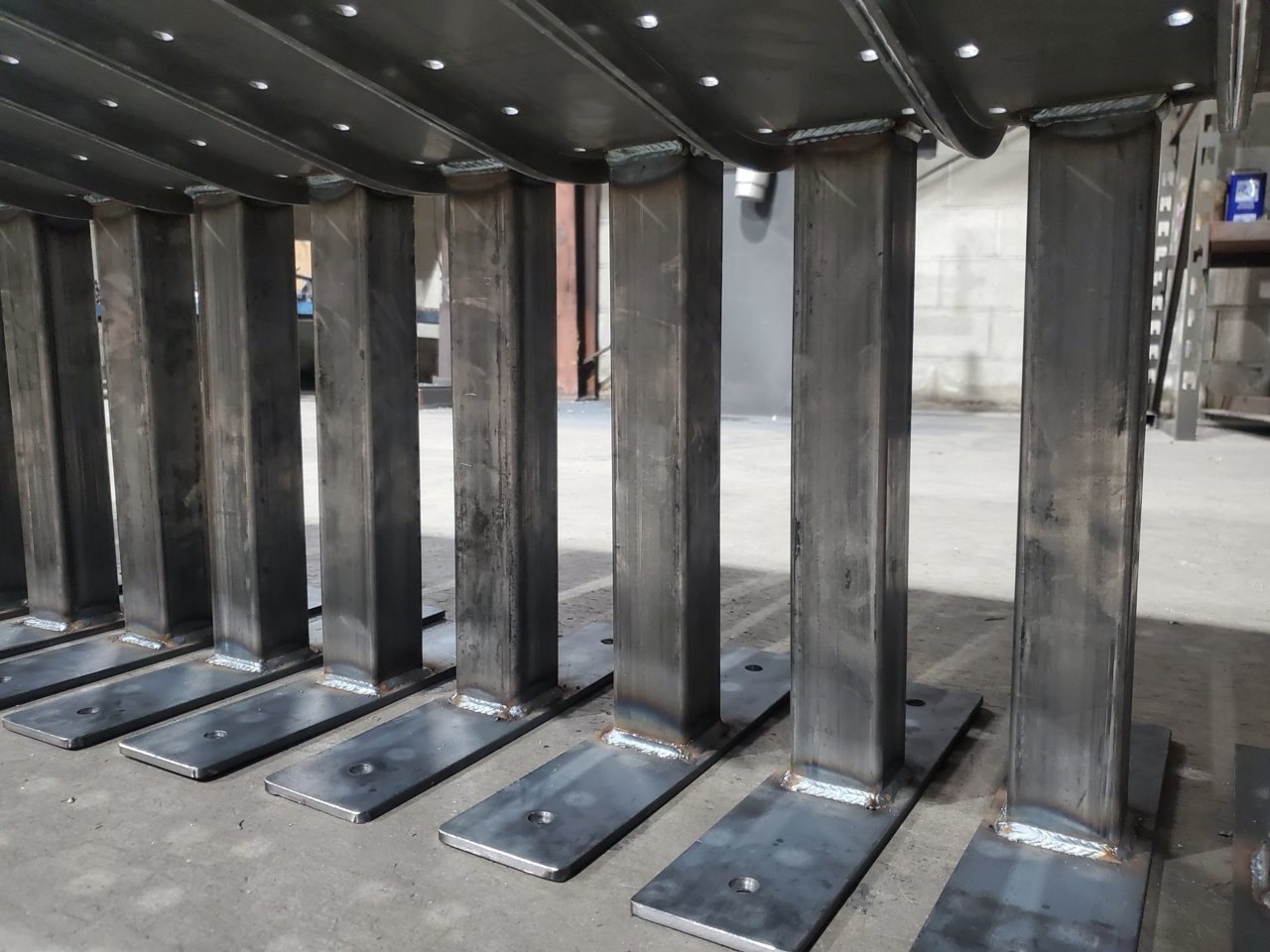

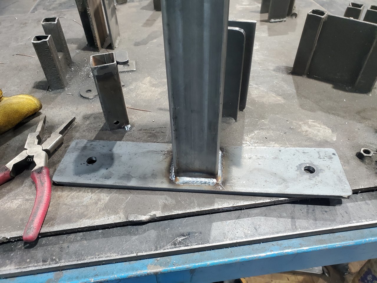

    4 run, 2 don't
    2.5 months into welding school
    12x 4hr days of actual MIG weld practice

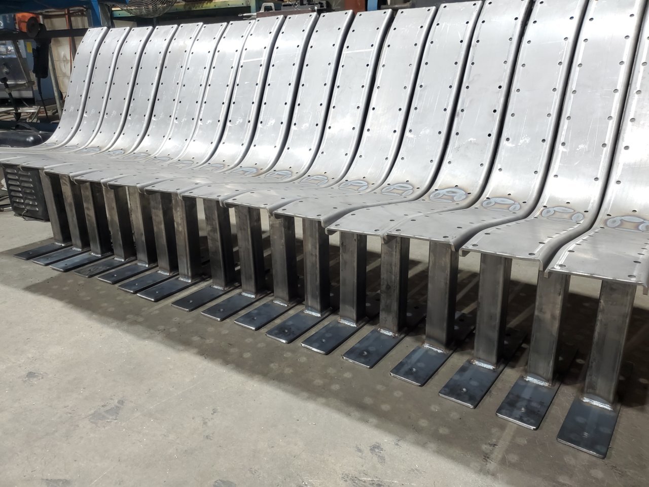

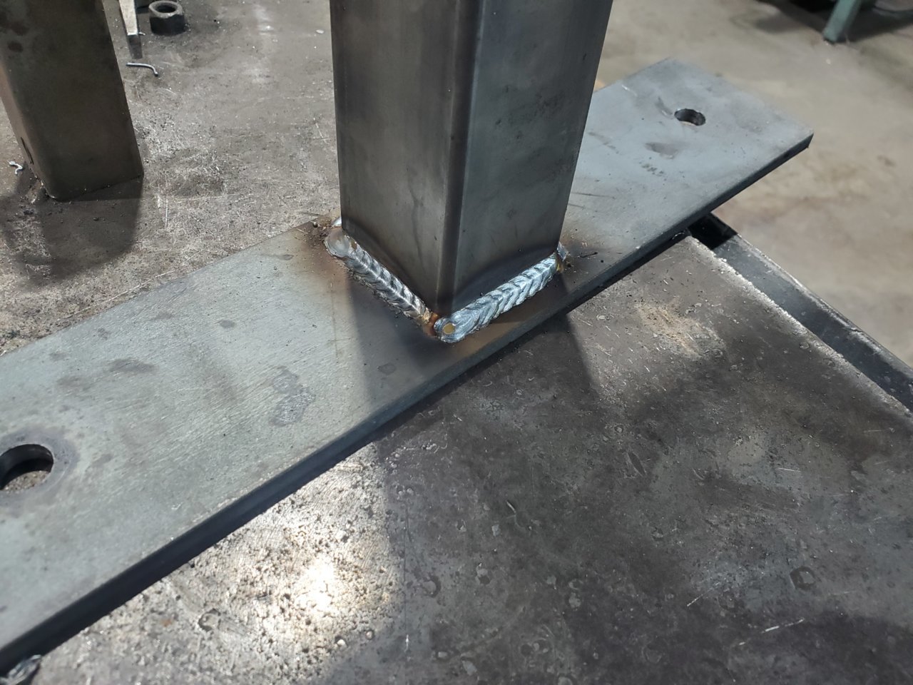

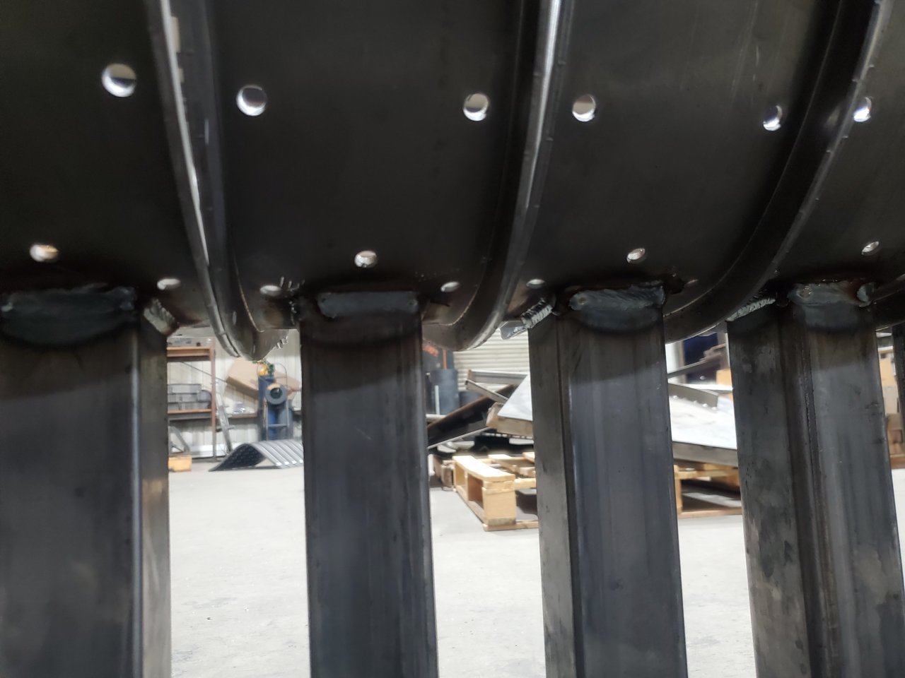

    Just picked up a new job last Thursday at a fabrication shop, and though they know my only experience is in school, I welded these up today -
    Mind you, I've only ever welded with a Miller 255 (inverter based) with Bernard gun so dialing the settings on the CP-302 (transformer based) welder with Tweco gun was a challenge for me :anonymous:
    3Six, buyobuyo, RustyGreen and 11 others like this.

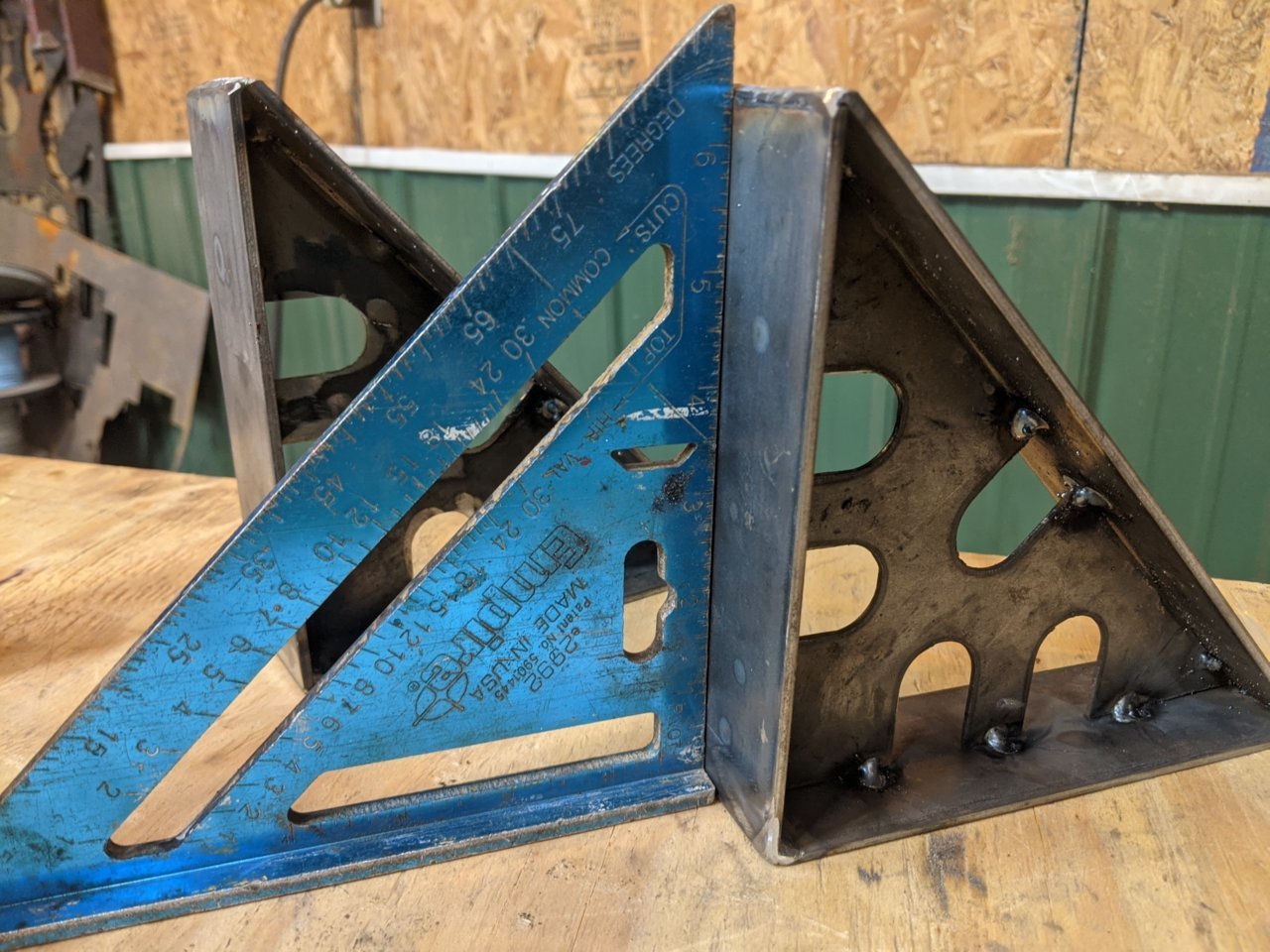

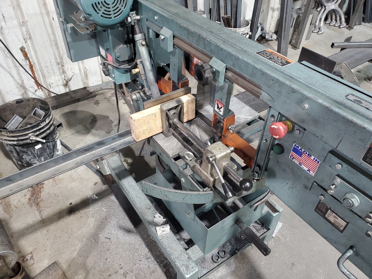

    This past Summer, I bought an Evolution 14" metal cutting saw. Don't remember exactly what I paid for it, but it was close to $350. To trade paper money for corners like this, no comparison!
    I had been using a hand held band saw, and/or 4.5" wheel of death. Man, satisfying as hell to be able to have perfect corners.

    I would like to see the miters before you weld.
    Maintaining a 45* angle while welding is pretty tough. Most times the weld will pull the angle out of true.
    I still have trouble with the metal pulling.

    I hear ya. There was literally no gap and the angle was what you see in the pic before I welded it. That saw makes perfect corners. Then, like you said all I gotta do is my part, which is not draw/warp anything.
    That's 2" angle and I had it flat side down on my Klutch welding table. Clamped and tacked in 5-10 places, then flipped and welded the bottom (in pic).

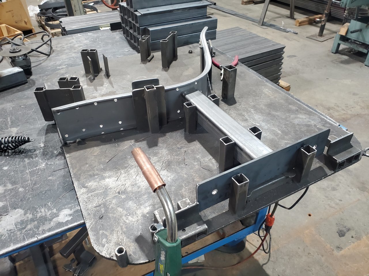

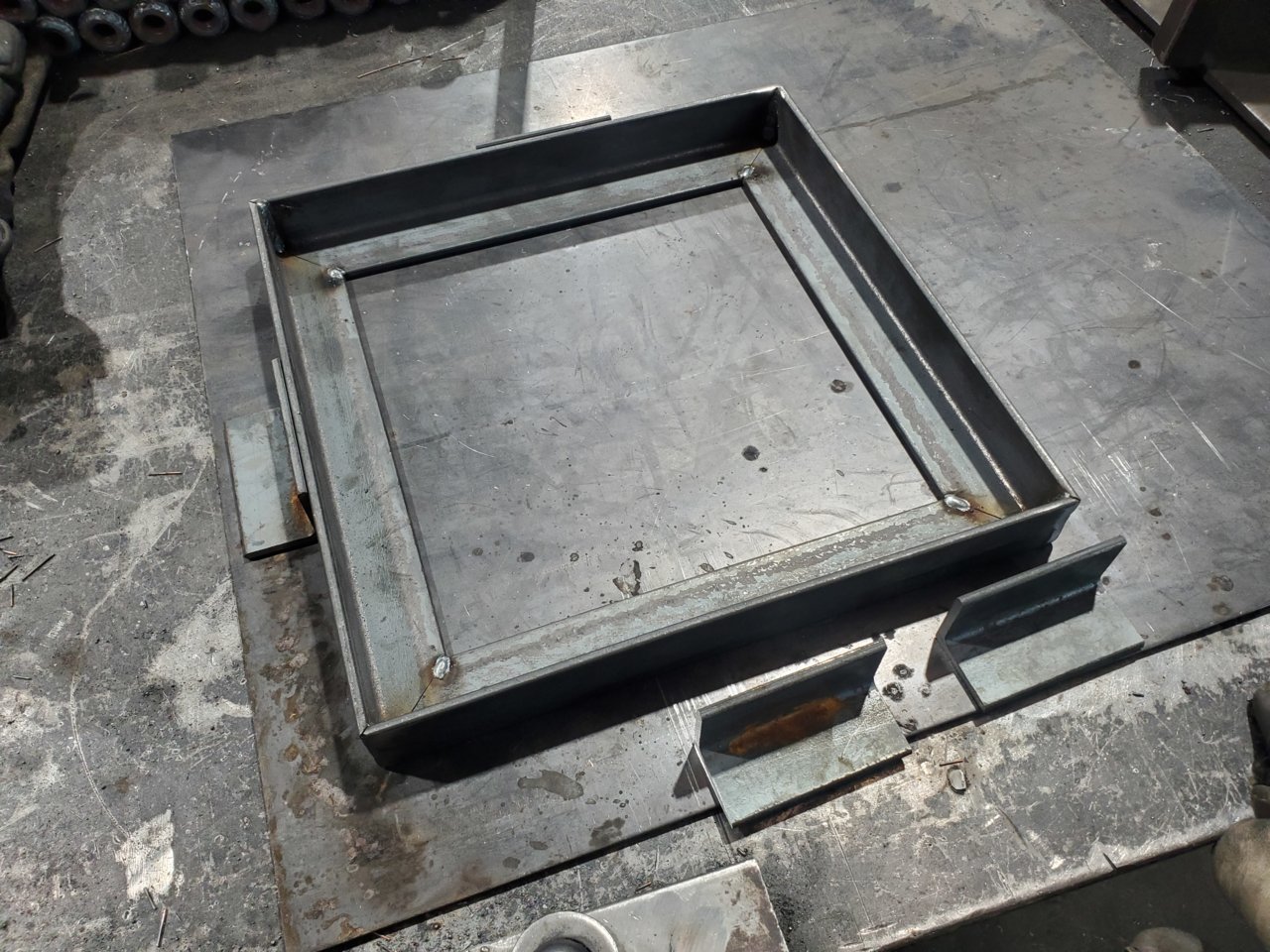

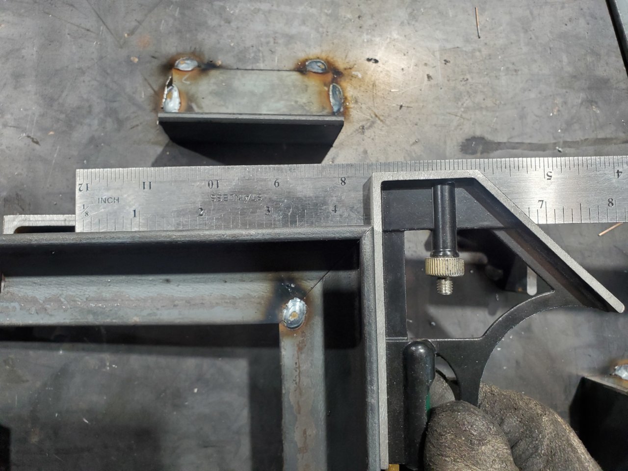

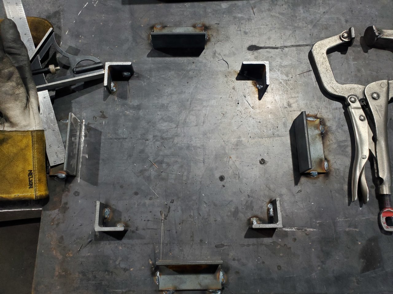

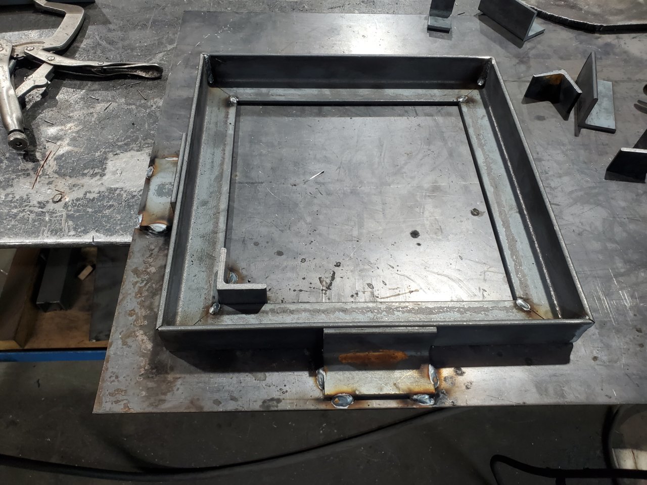

    Made a jig, cause I've got some 30 brackets to weld up that need to be square -
    Laid some pieces out after having pictured it in my head
    First pieces glued -
    All done -
    Because the cuts aren't perfect, I'm hoping this jig would help me keep everything square.
    So far so good -
    la0d0g, dk_crew, Shmellmopwho and 4 others like this.
