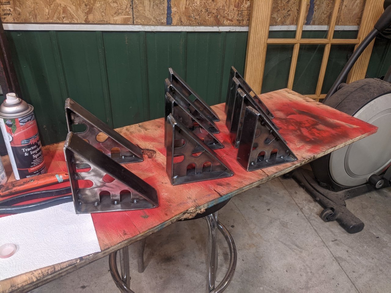

    Drop bracket lift and booger welds
    Congrats on the new job! Do you know what those parts are for?
    Pretty awesome you are getting on the job experience while in school. What did you do before you switched careers?

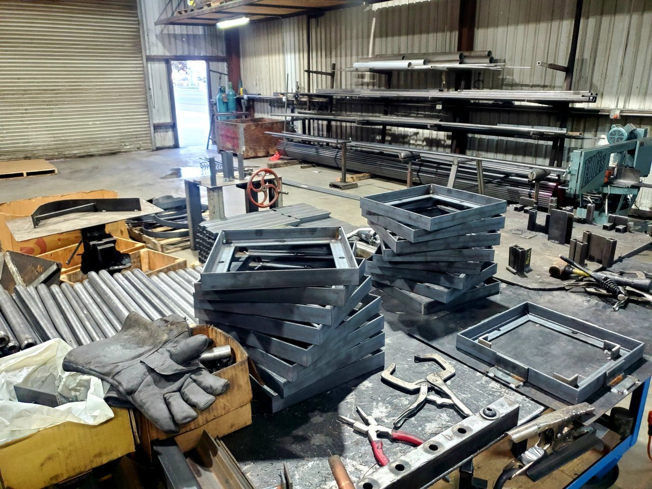

    Thank you!
    The shop offers everything from outdoor grills (the kind found at state and national parks), benches, street lighting, tables, and more.
    Those I made are bench frames and they'll get surface mounted with an oak backseat installed. We've got a large woodshop just next door to mine.
    The company also has 2 foundries for pouring/casting aluminum and they've made a ton of benches for cities.
    Military (usmc, disabled vet), law enforcement, car business, and now welding. Been around the block you can say :rofl:

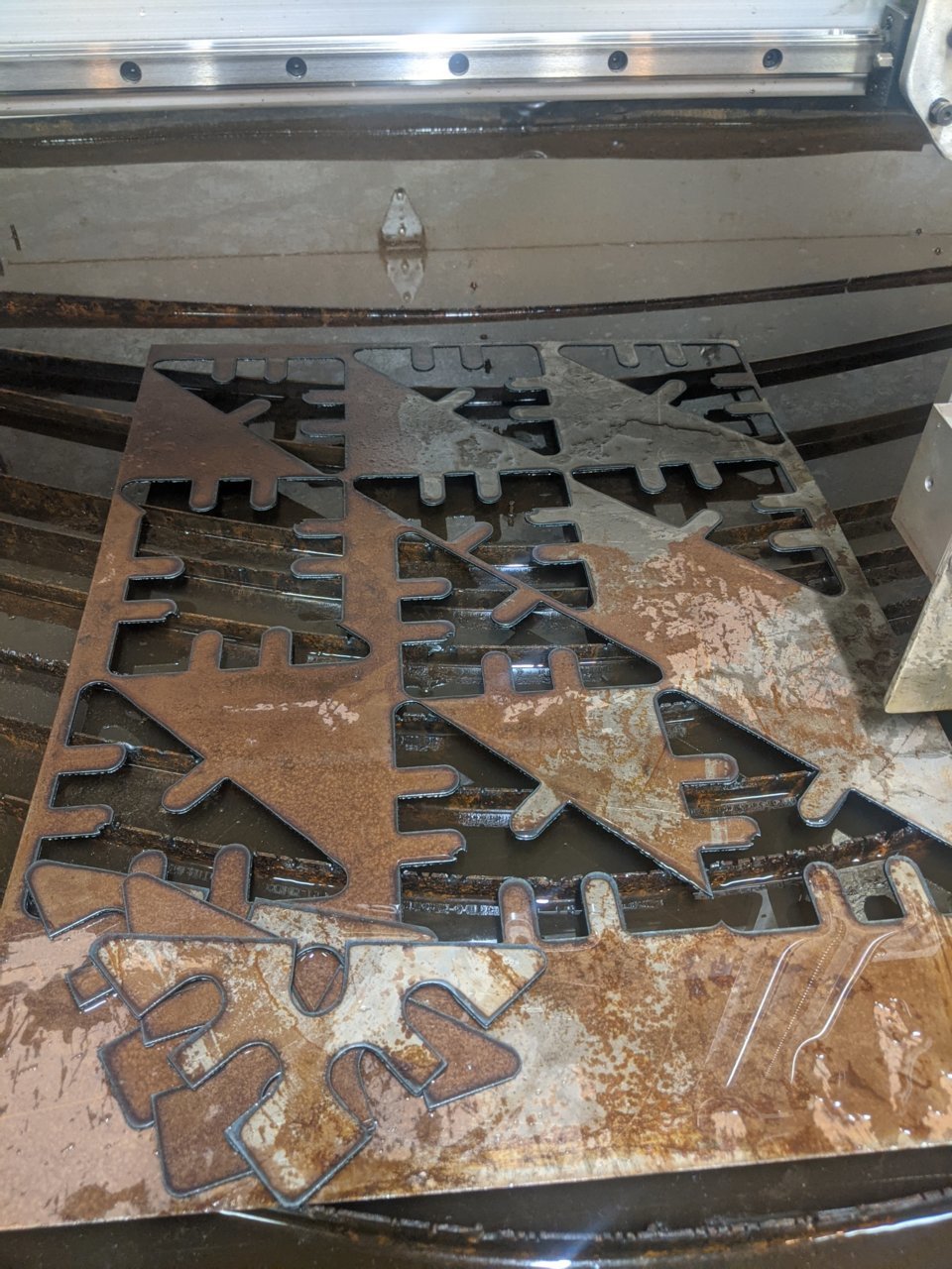

    I think I paid $1400 or it may have been $1700, 20 years ago.

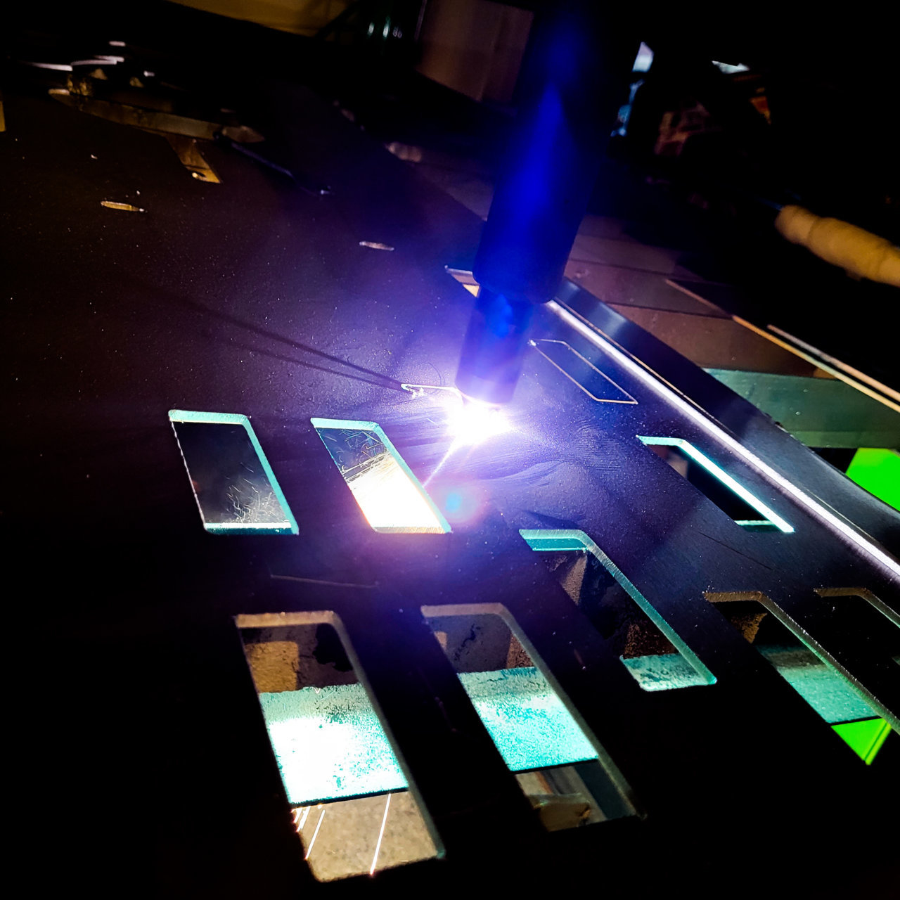

    The plasma cutter gets used alot. I think I may be on 10 set of consumables.
    I cut these this morning, I can't remember when I changed tips.

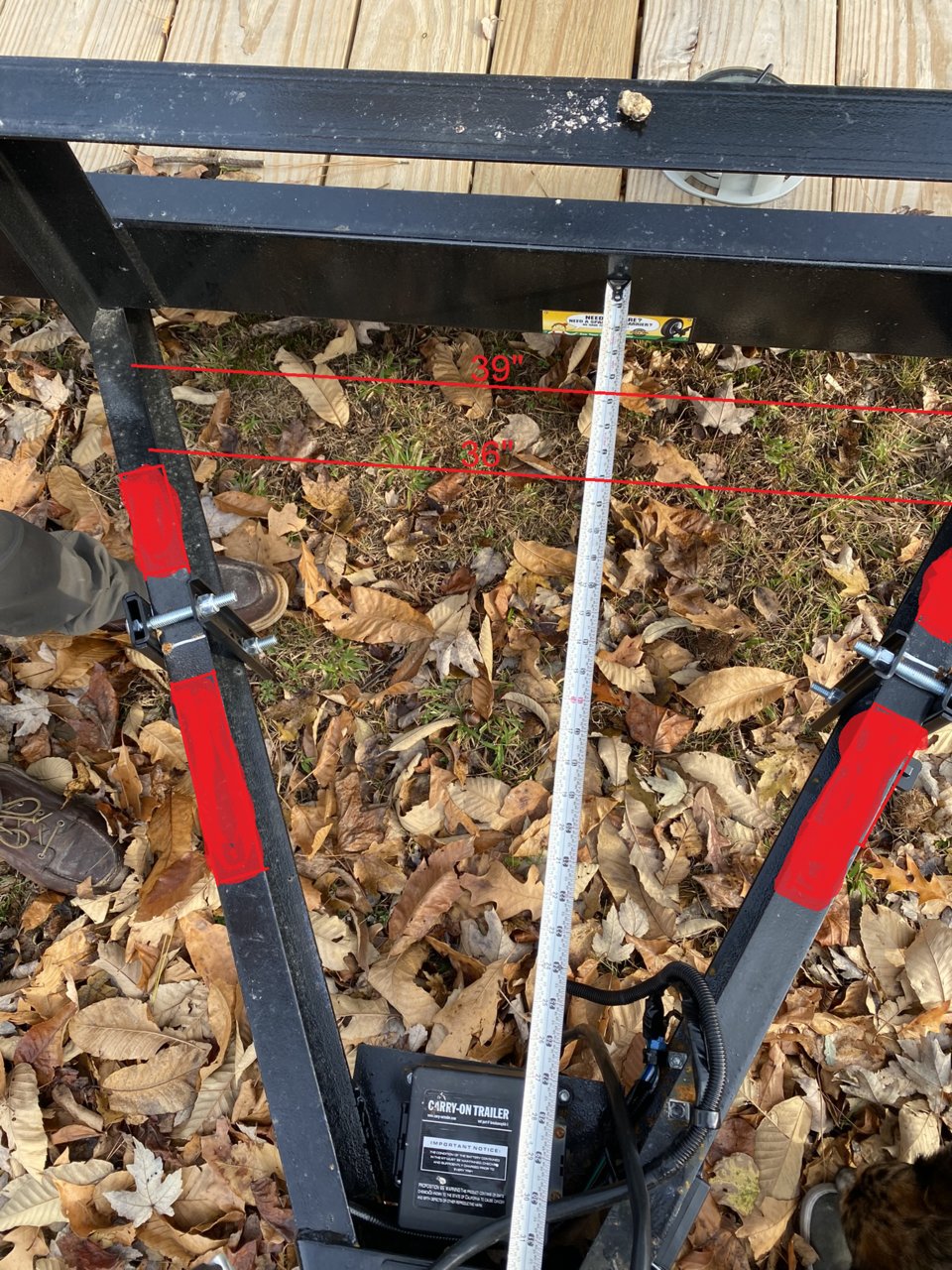

    That won't hurt the strength at all.
    The stress is mostly up and down. You arent touching the web part of the tongue at all.
    You should drill over sized holes in the box you are attaching to the tongue and just use large washers. There is some flex and it could cause the box to get some of that flex. Might make opening the box difficult after a while.
    I've only seen it once and that trailer was beat like a rented mule.

    Forward is better.
    The weakest point is at the 65 degree junction where the tongue legs meets the front of the main frame.
    If someone doesn't balance the load properly and puts all the weight forward, that point is always where the tongue bends/breaks.
    I just cringe when I see the overlander trailer builders but weld their tongues to the front of the trailer frame. I gave up commenting some time ago.
